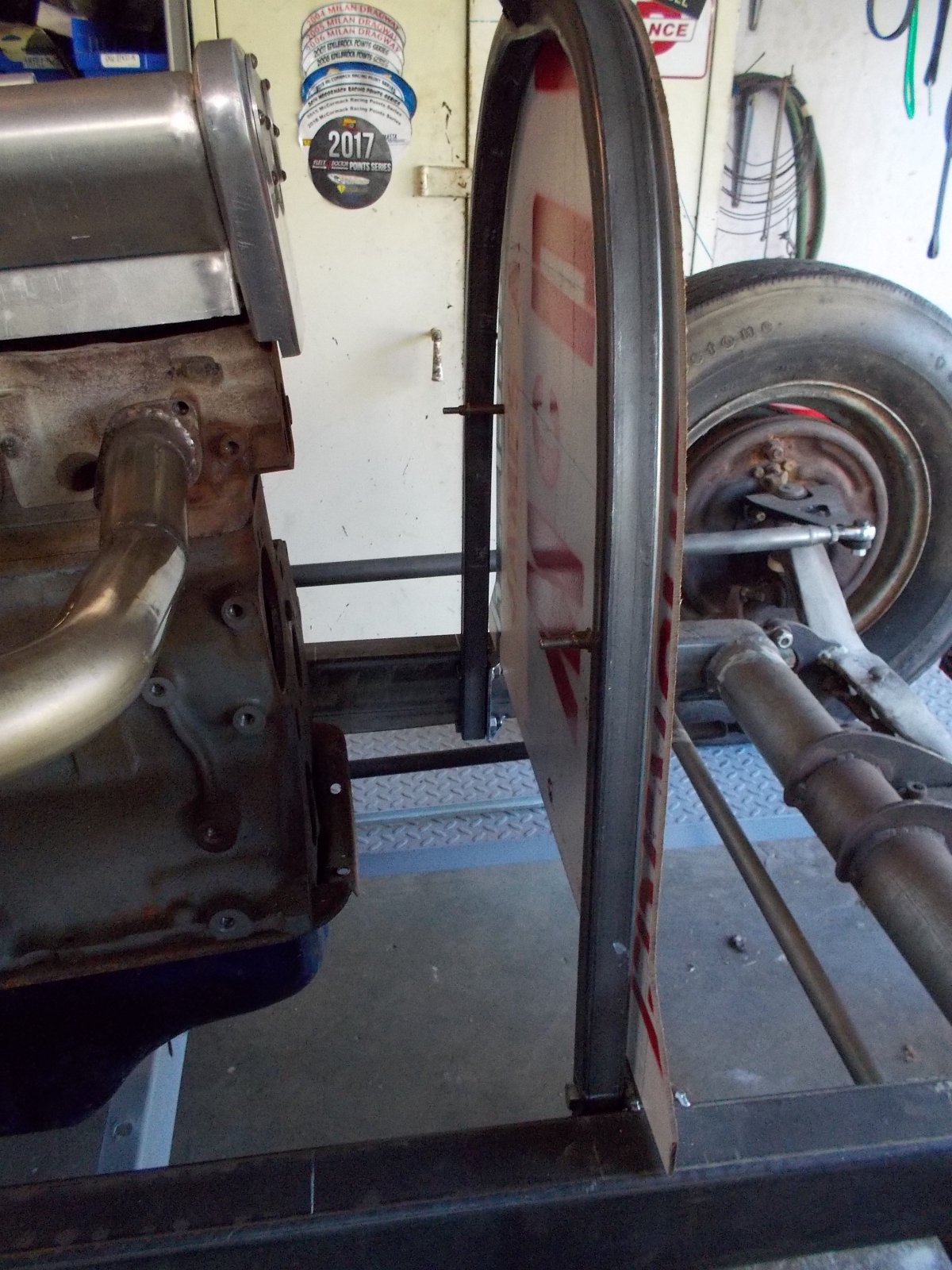

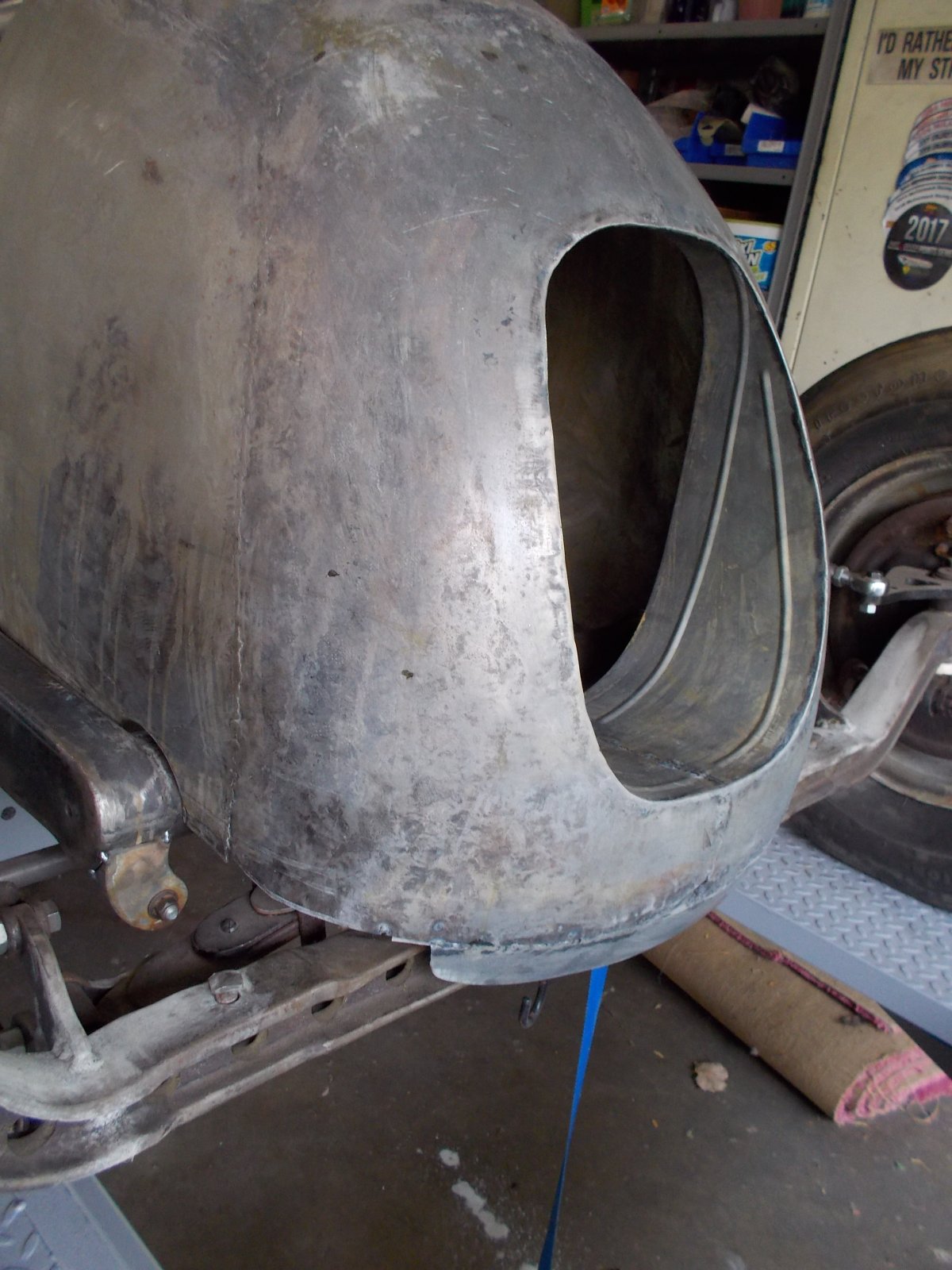

  8. THE FRENCHTOWN FLYER
    Joined: Jun 6, 2007
    Posts: 6,082
    from FRENCHTOWN
    I'm confused.
    I need help.
    In virtually all of the champ and sprint car pics I've seen there is no visible means of fastening the nosepiece to the frame. Clearly there was an effort made to hide the fasteners and keep the front clean visually and aerodynamically.
    I have not decided how to fasten the nose, but I don't want to have visible fasteners. Moreover I want the nose and hood lines to match up so the rear edge of the nose needs to be firmly attached to the radiator hoop to match the front edge of the hood. Any suggestions are welcomed. Here's the area I'm talking about. The radiator mounting hoop is where the two will meet. I was going to add a flange to the rear of the hoop like the one on the front of the firewall. I just need a way to fasten the nosepiece without visible fasteners and make it match the hood lines.

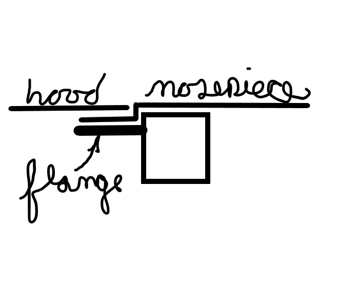

    [EDIT - 15 min. later: Maybe an extension off the back edge of the nosepiece with an inset flange? Then the hood front can lay on the inset flange? Then underneath it all do the hoop flange to hold the nosepiece inset with countersunk fasteners??]

  9. HJmaniac
    Joined: Jun 11, 2006
    Posts: 5,388
    HJmaniac
    Here is a thought. Slot the hoop from the front. maybe a keyhole or a T-Slot. Maybe 2 on a side. Weld threaded studs on the inside of the nose piece. You can then slide the threaded studs into the slots. Fasten with a nut, washer, and lock washer or use a small castle nut and pin for vibration sake. You can use Zeus fasteners on the underside. PIA I know because of experience.
    Another Idea is to put a interlocking flange on to of the hoop. One half on the hoop, one on the nose piece. Make one position adjustable for and aft. Slide flange halves together. Once flanges are interlocked fasten underside with Zeus fasteners.
    Just my 2 bits.
  10. THE FRENCHTOWN FLYER
    Joined: Jun 6, 2007
    Posts: 6,082
    from FRENCHTOWN
    Thanks HJ. I am still thinking this through but I am leaning toward adding a flange off the back of the hoop and another offset one off the nose and nesting the hood down on the nose. The nose will be held down with countersunk screws.
    Secure the hood with leather straps and maybe a tube across the bottom edge of the hood for rigidity.
