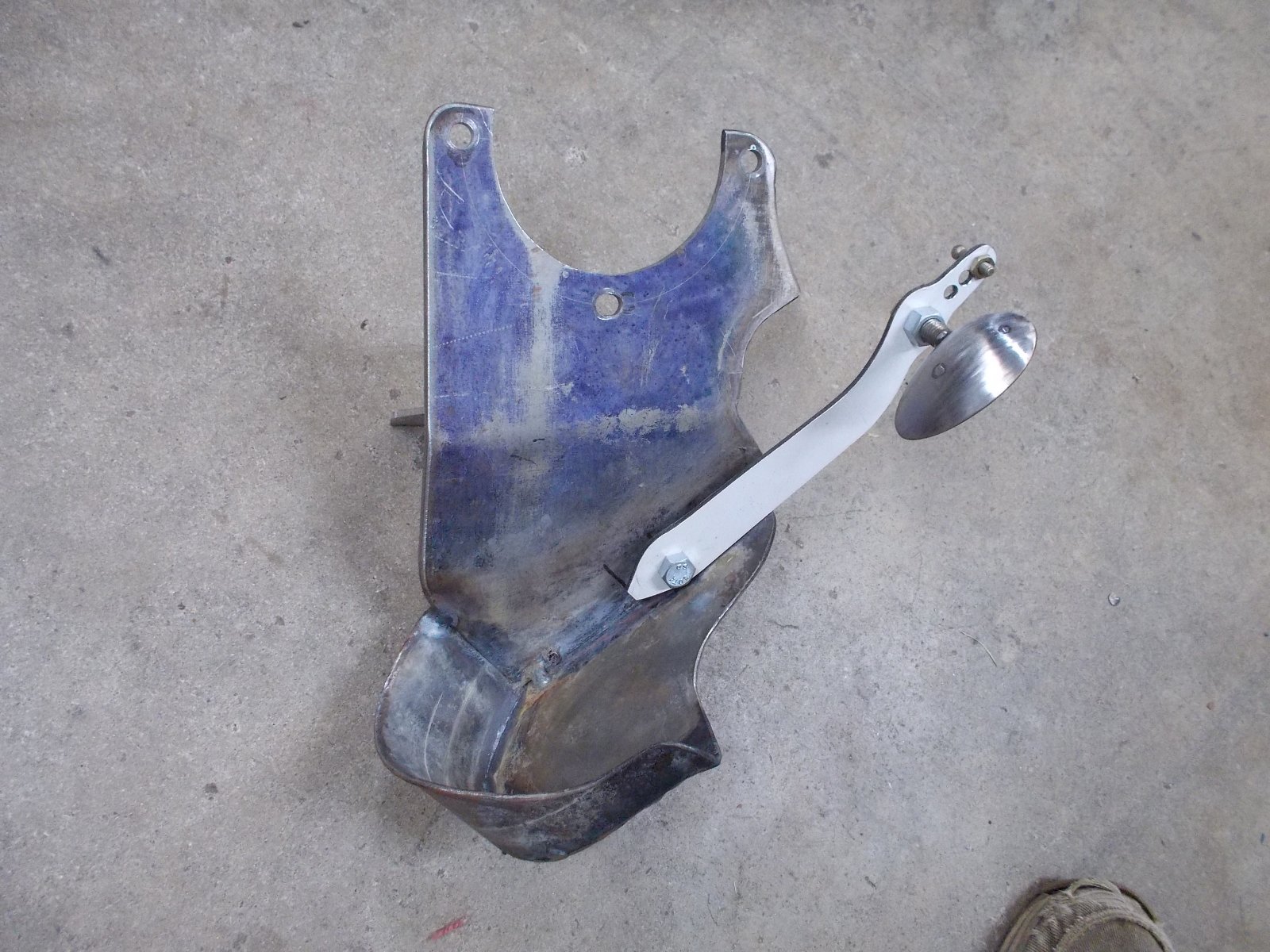

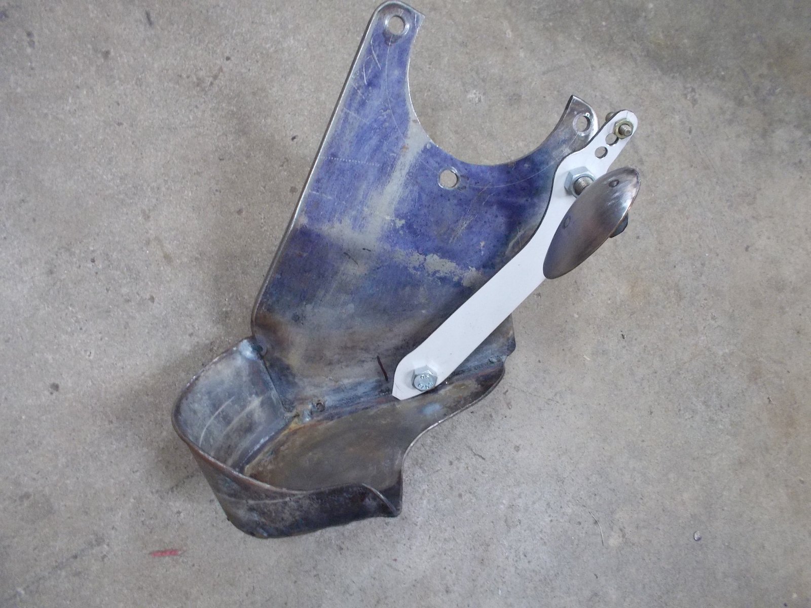

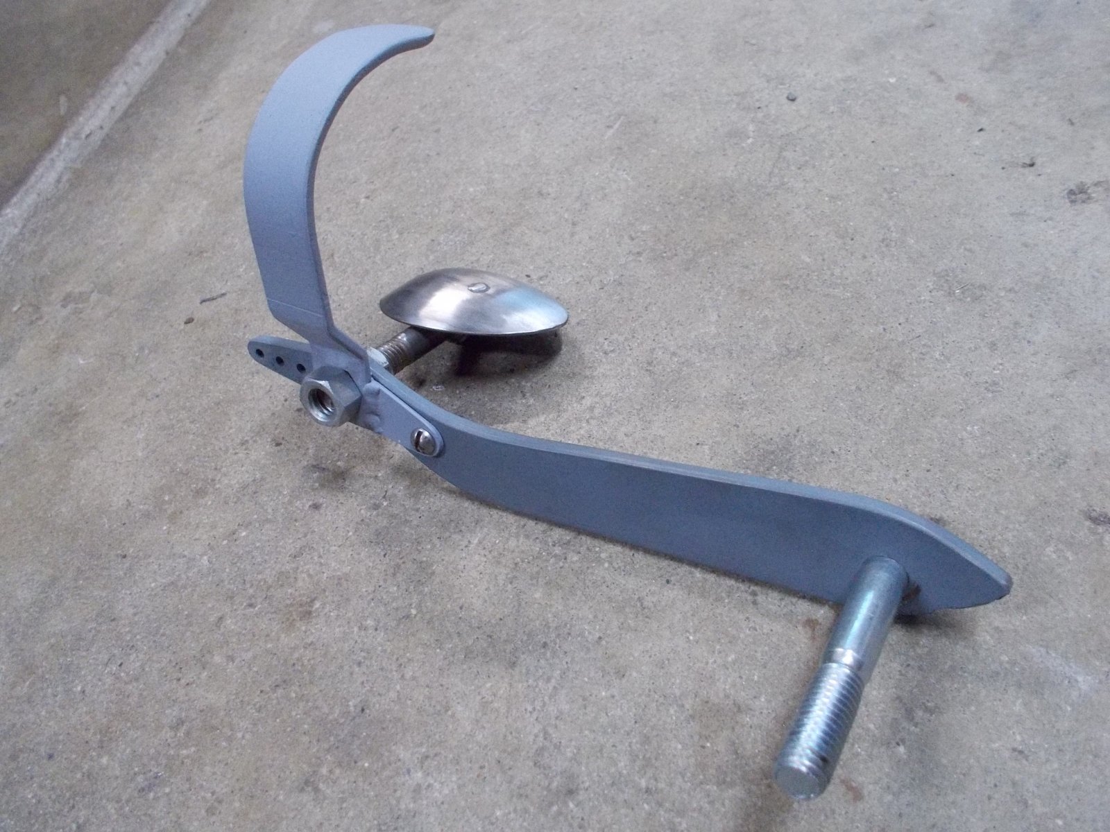

    The gas pedal in metal. It needs a return strap which I will form fit sitting in the car with someone measuring a pattern.
    Next comes hand and foot brake placement.
  11. Dave G in Gansevoort

    The more I look at that pedal the more I like it. I'm thinking that it could be mirror imaged sort of, by putting the pedal on the other side. That way I can get my right foot on the brake pedal that will be right beside it. Your car being like our old (or for that matter new) dirt modifieds, where the brake was on the left side of the transmission and the throttle pedal on the right. I'll be sitting on the side of the car and the pedals will all be next to each other. So more plaigerizing...

    Thanks Dave. I am going to find a torsion spring to mount on the backside over the pivot boss to act as a self-return spring. That and the return strap should wrap it up.

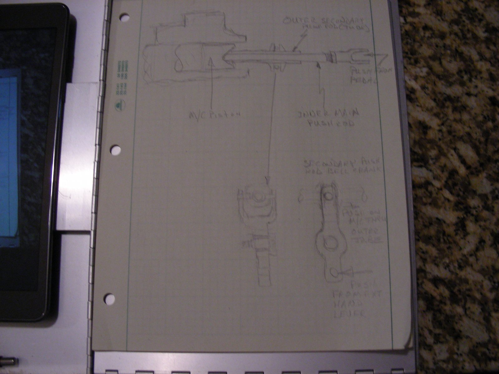

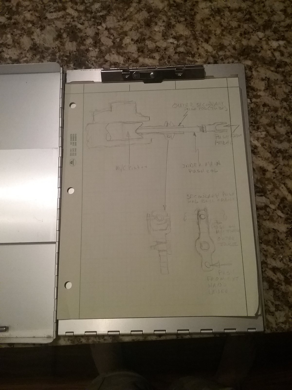

    This sounds like some sort of dual push rod. Say like a rod inside of a tube. Both can independently push the master. I can see it in my mind's eye but I can't describe it. If you like I'll try to sketch out the idea festering in my mind.
    One more thing I may use on the Whatever project...it would be neat to have something like that on a track-ish roadster.
  14. Dave G in Gansevoort
    Joined: Mar 28, 2019
    Posts: 3,803
    from Upstate NY
    So here's a poor attempt to draw a dual pushrod thing/bell crank for dual independent m/c operation DSCN1198.JPG 20210810_111031.jpg I took pictures 2 ways, because I can't scan stuff. Hopefully it will be good enough for you to get the idea.

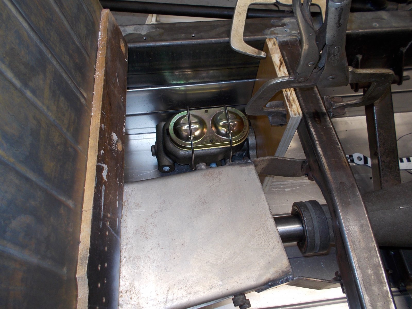

    I did acquire a new master cylinder that a friend donated to the cause. It has a 1" bore. I was thinking a 7/8" bore would be best but maybe I can juggle the linkage ratios to make it useful.

    I plan to use four-wheel brakes to make the car street legal. But your cable idea raises a possibility - hook the hand lever to the emergency brake levers in the drum brakes on the rear wheels only. That way I could use the hand brake to throw the car sideways into a turn by using the rear brakes only.
    This of course, raises the question of the use of a (adjustable?) proportioning valve and how to tie it in to this mish-mash.

    I made the gas pedal return clip. Mandatory in NHRA drag racing - dunno about circle sanctioning bodies. Useful for all applications.

    I like it! Mirror image it and I have a gas pedal too... thanks!

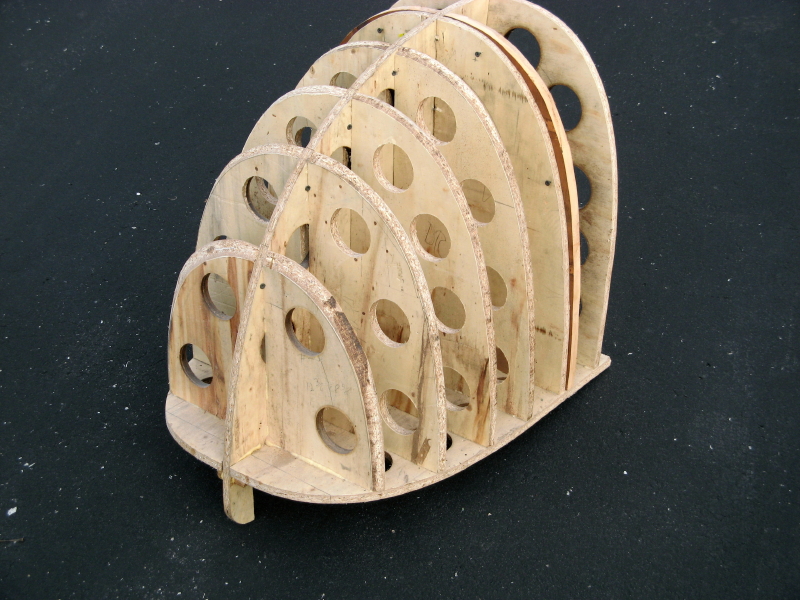

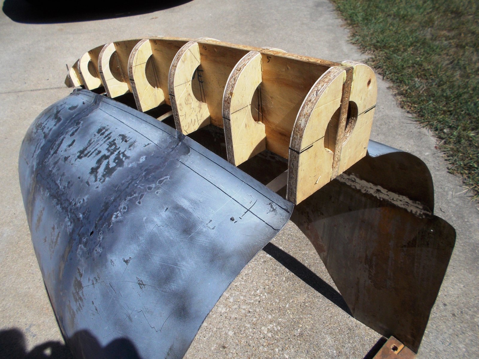

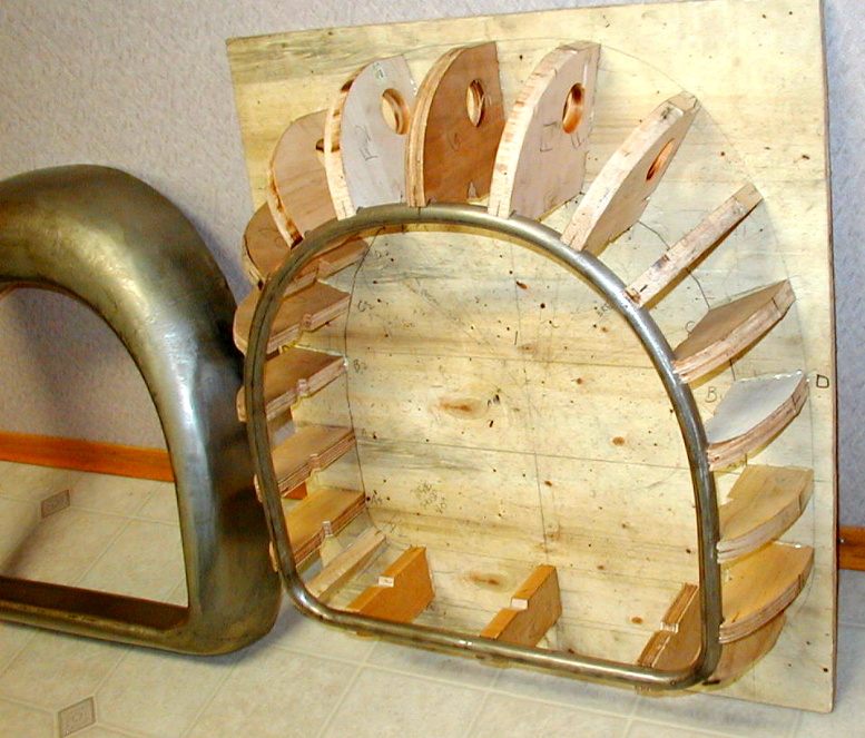

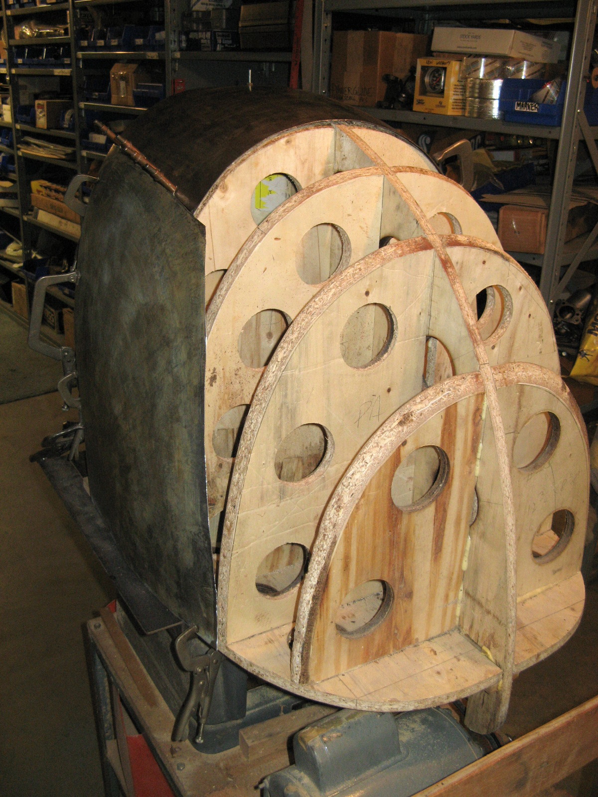

    I have decided to sell all of the wooden body bucks I built and used to build this race car body. This will be the only car I build off these bucks. Somebody else may need them. I will post a "for sale" ad in the HAMB cl***ifieds.

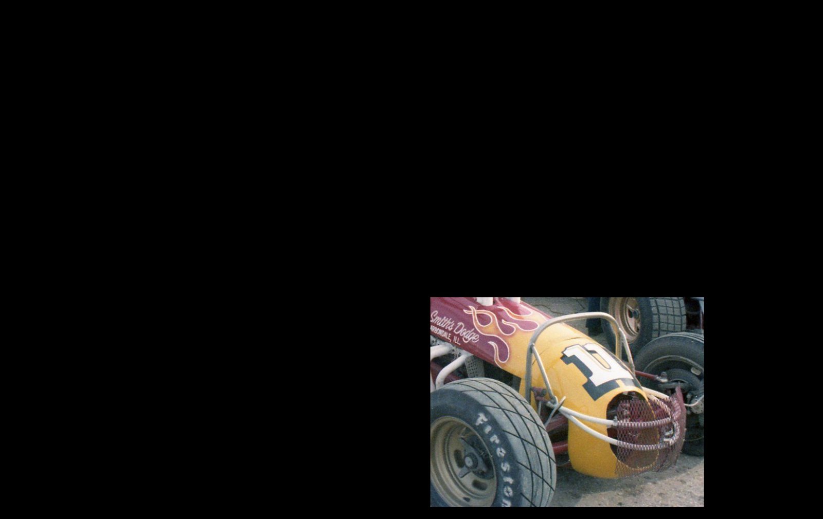

    What grill are you using on this nose buck ?
  29. jaracer
    Joined: Oct 4, 2008
    Posts: 3,058
    jaracer
    The nose piece on my first sprint car was flanged so that the hood rested on the flange making the leading edge of the hood flush with the nose. There were 4 dzus fasteners in the flange which attached the nose to the radiator hoop nose.jpg . You can see that the nose extended behind the axle with a cut out for the front spring. There was also a piece that went below the nose and under the axle. It attached to the pan under the engine.
    loudbang and HJmaniac like this.

    Thanks jaracer, I will do something similar except I don't want any Dzus ****ons to show so I'll fasten the rear offset flange to the rad hoop with countersunk fasteners, covered up by the front edge of the hood.
