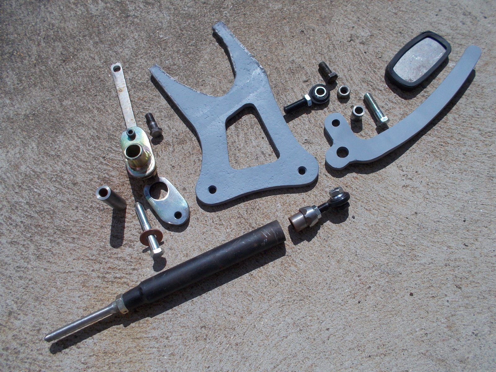

    from FRENCHTOWN
    Through a confluence of unfortunate events I trashed the tailshaft housing and driveshaft on my '46 pickup truck. But I will try to salvage a foot of this old driveshaft and add a new yoke for the C4 to use on the champ car.
    I also made some mounting brackets for the master cylinder and a bushed connector link for the pedal.

    from FRENCHTOWN

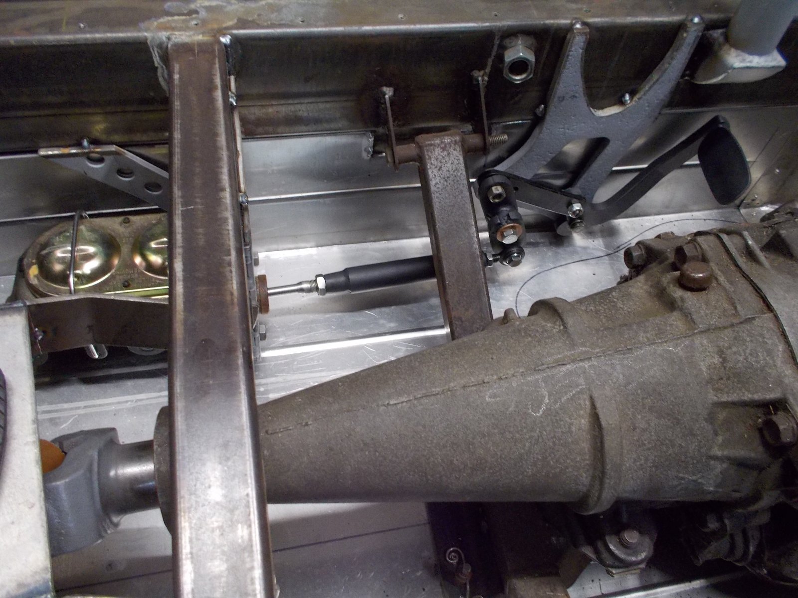

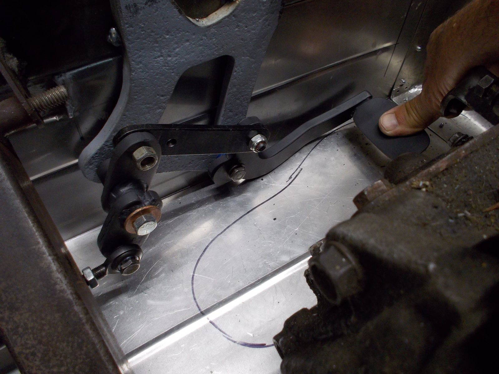

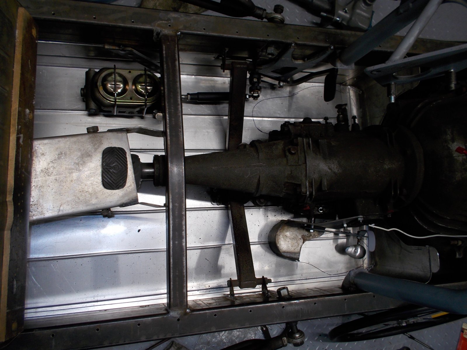

    Here is the completed brake ***embly - minus stoplight switch - welded into the ch***is. Now that I have gas and brake I will turn my attention to the 3-speed shifter. The existing shift lever will be cut off and a new lever that fits tightly to the contour of the transmission case will be fabbed along with a rudimentary shortie shifter.

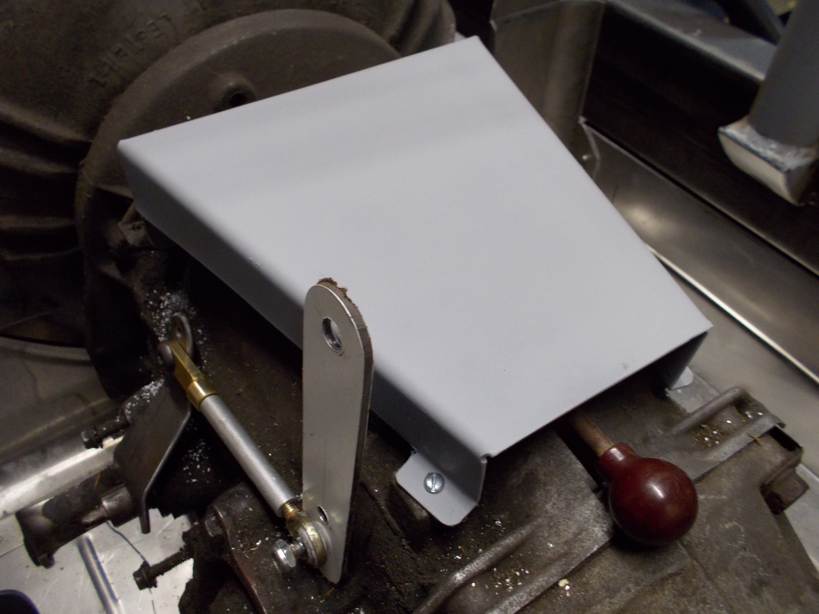

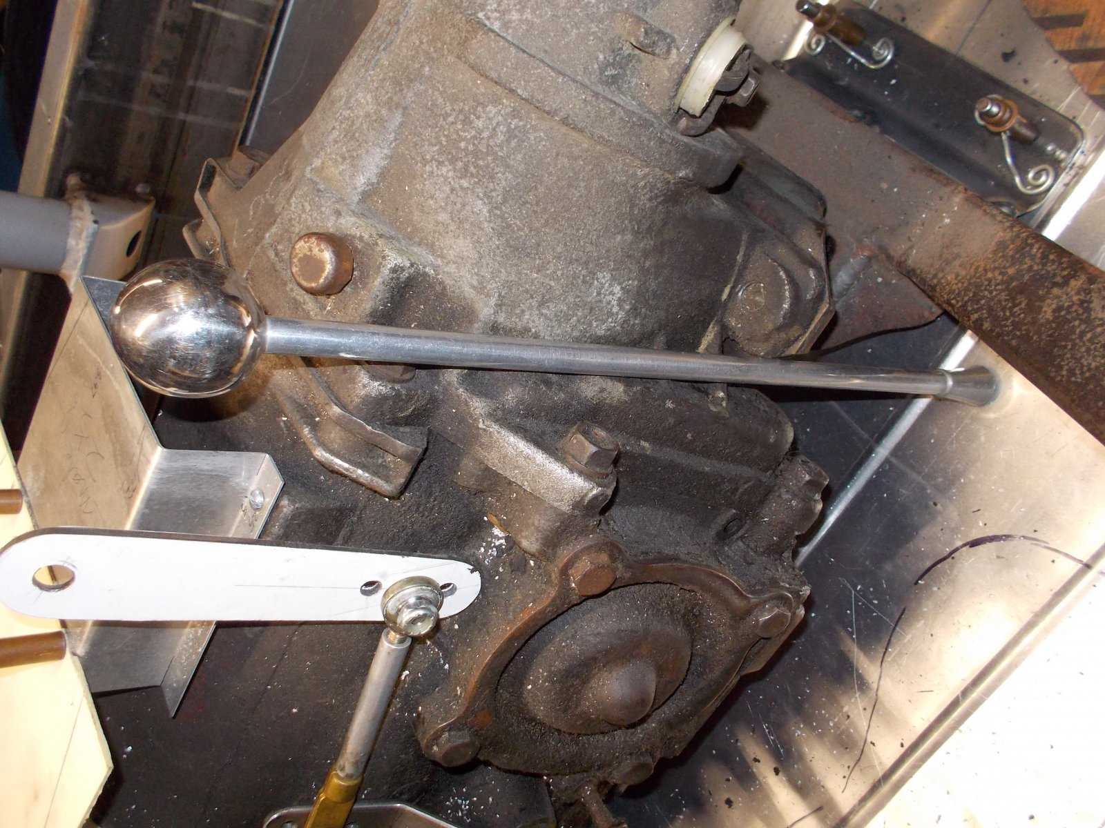

    from FRENCHTOWN

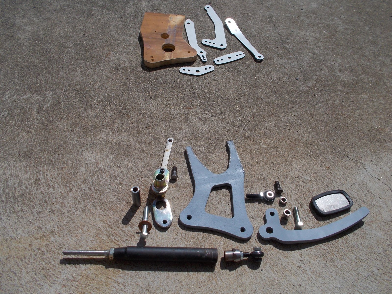

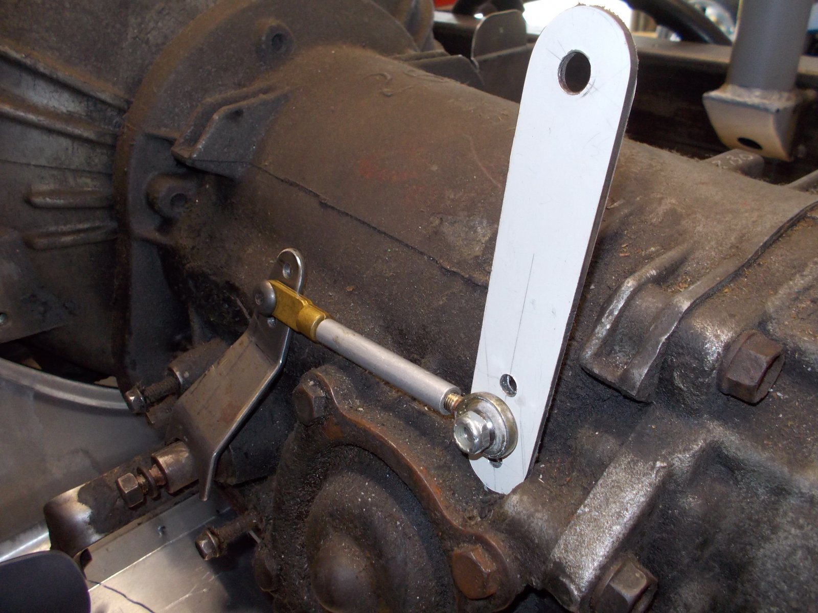

    I made a shift lever for the C4 trans. The hole spacing is roughly the same as the original lever I will be cutting off - plus or minus. This dummy trans is frozen up so I can't cycle the lever but I can get started on the shifter mechanism. I think it will bolt to the machining lugs on the case.

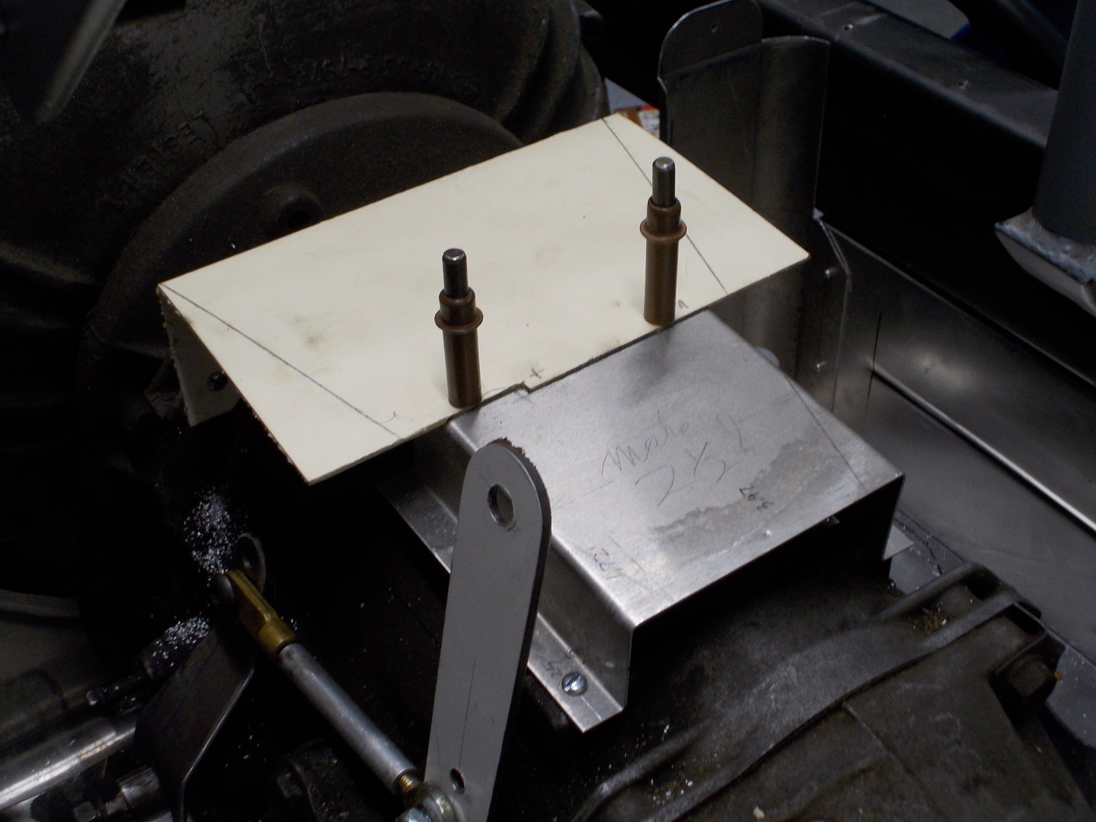

    from FRENCHTOWN

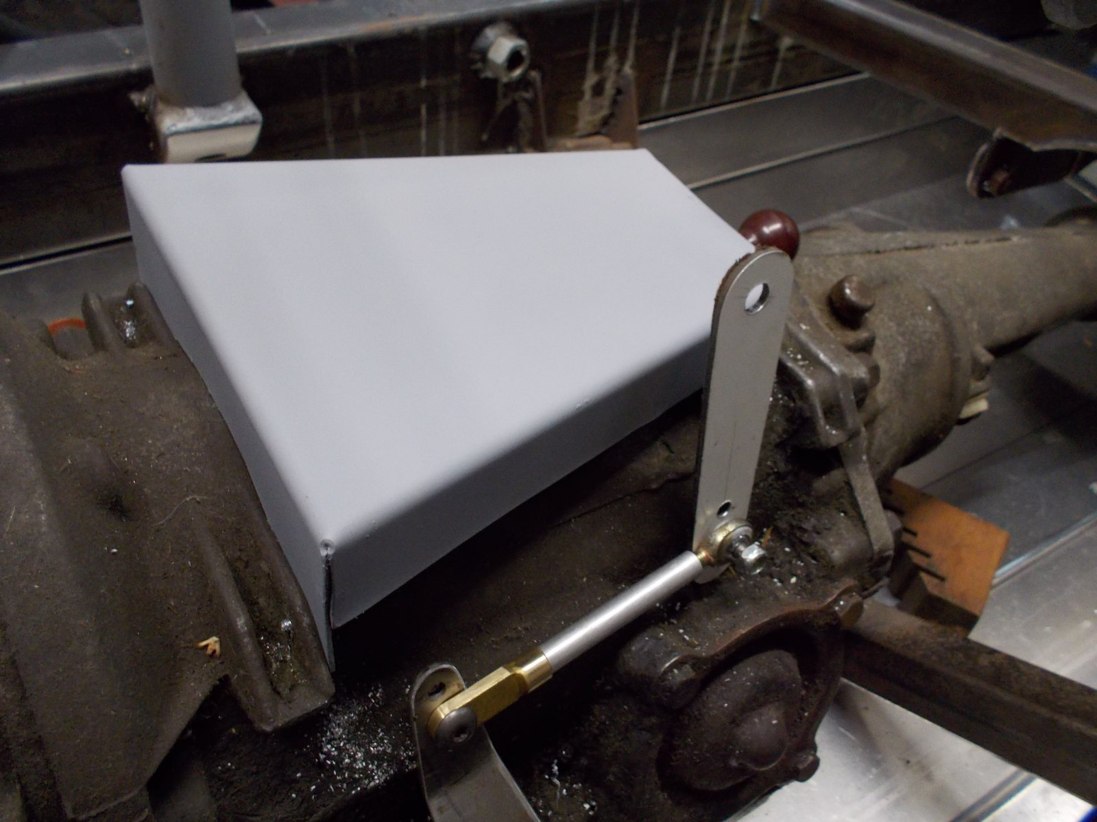

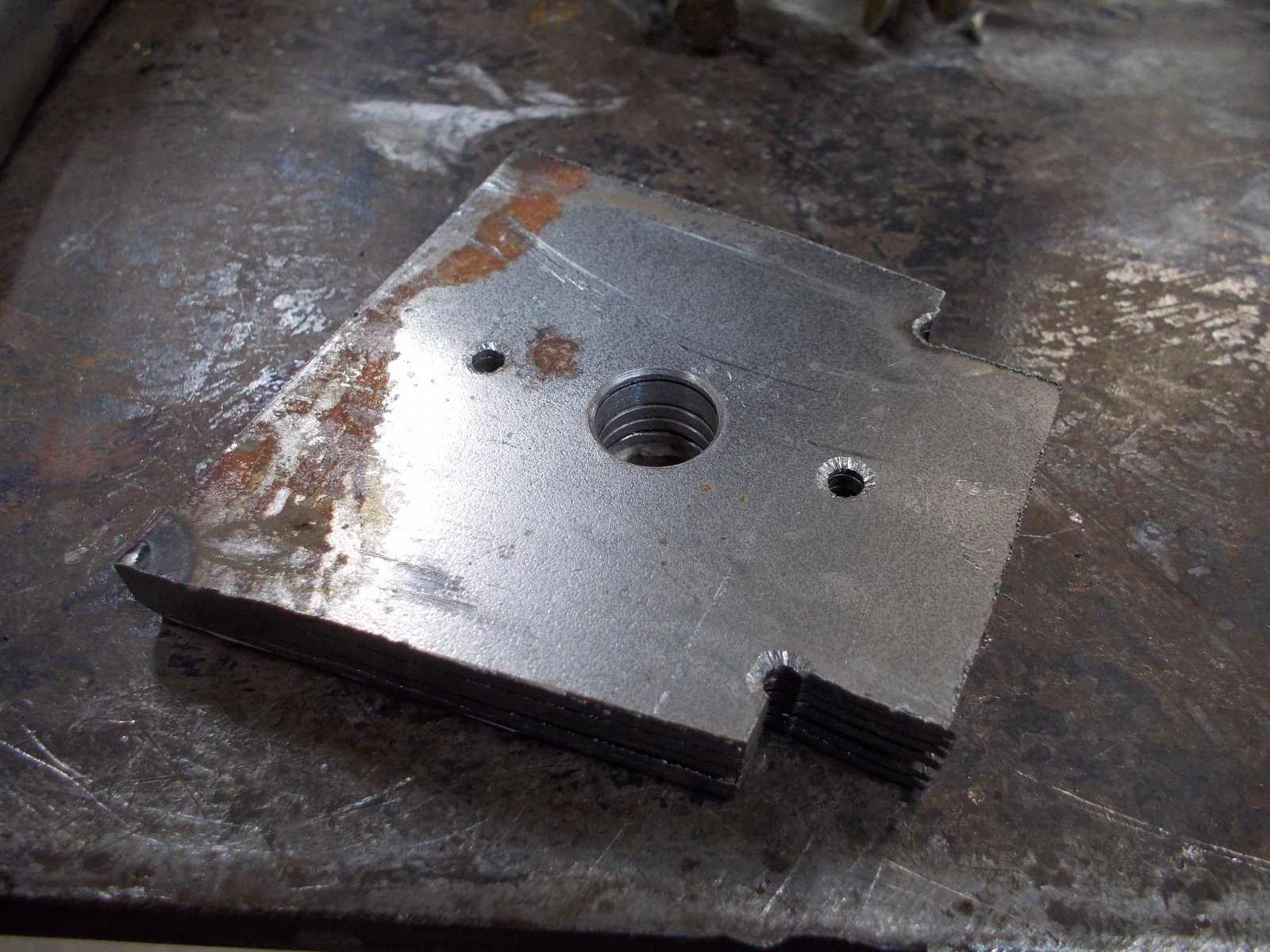

    There are four machining locator lugs on the top of the C4 trans just begging to be used to mount a shifter. I'll fab a plate to hold a shifter.
    The rear two lugs are not at the same height.

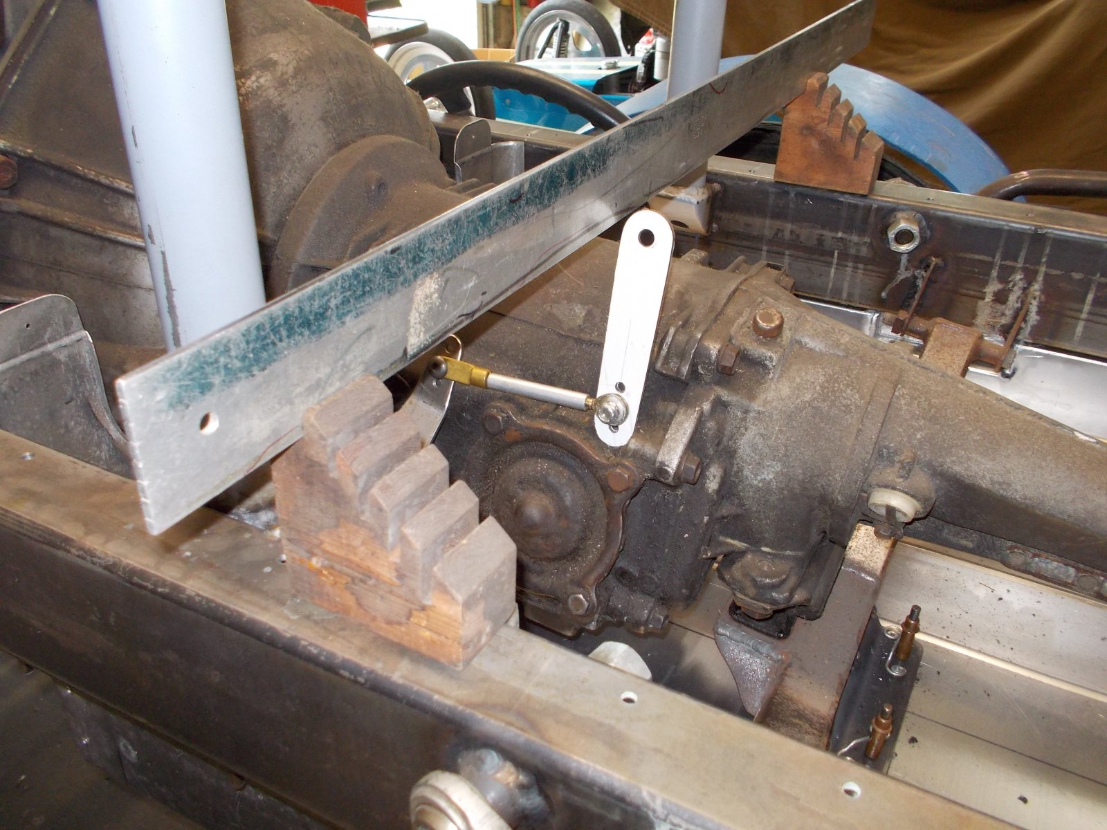

    TECH TIP: I use these "pyramid blocks" to establish a horizontal and sure enough, the right side was .080" lower than the left. I'll compensate when I build the plate. These pyramid blocks came in handy when I was building interior tin for racers and rodders. These homemade pyramid blocks are especially useful for determining tunnel heights and conical tunnel taper.
    Note that the plate sits level after making one tab .080" longer than the other.
    The front two lugs get tapped for mounting tabs.
    A friend donated this elegant little shifter handle. I'll shorten it to suit.
    I may hide some additional switches and gauges on this panel under the dash. They are needed for street operation, but I want the dash panel to be relatively austere - Tach, Oil pressure and Temp gauges and a kill switch - that's it.

    from FRENCHTOWN
    This is the base of the shifter. I will make the trunnion support for the shift lever / handle after the transmission lever is fitted on to the real transmission. That way I can see how long the linkage rod has to be. Switches and possibly idiot lights will be fitted in front of the shifter handle. The lever with the maroon knob will actuate the PARK / REVERSE spring loaded lockout plunger. Since the shift mechanism is short, direct, and substantially strong the shifter handle will have no detents, relying on the internal detents in the transmission. The slotted machine screws will be upgraded to 1/4-28 NF socket head cap screws on the real deal. Smallish screw holes help me precisely locate the tapped holes when there is little room for error.

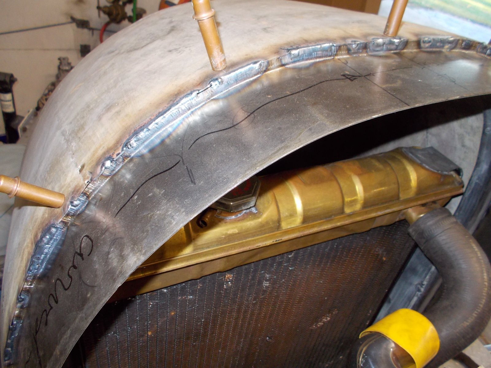

    from FRENCHTOWN

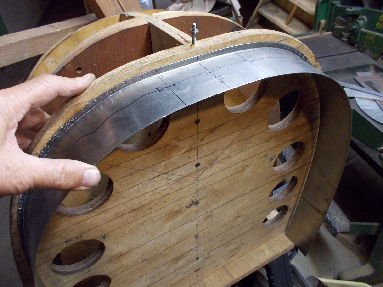

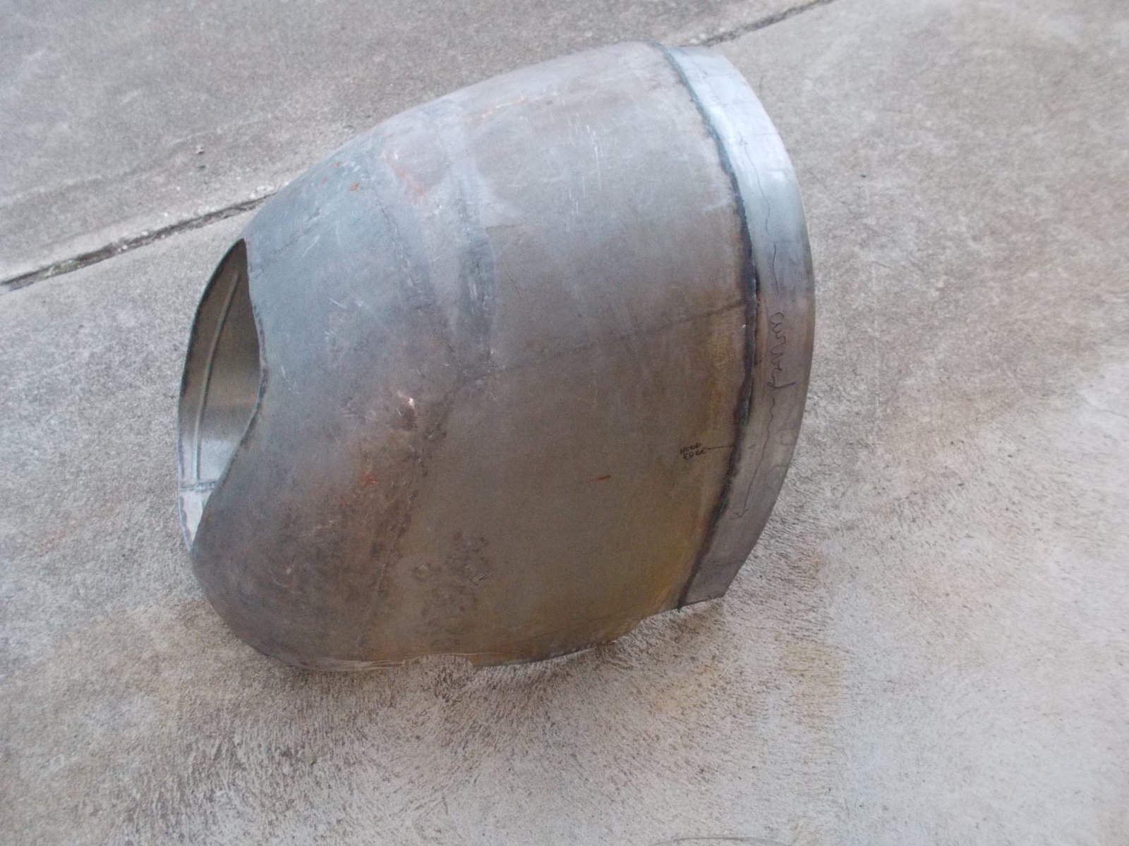

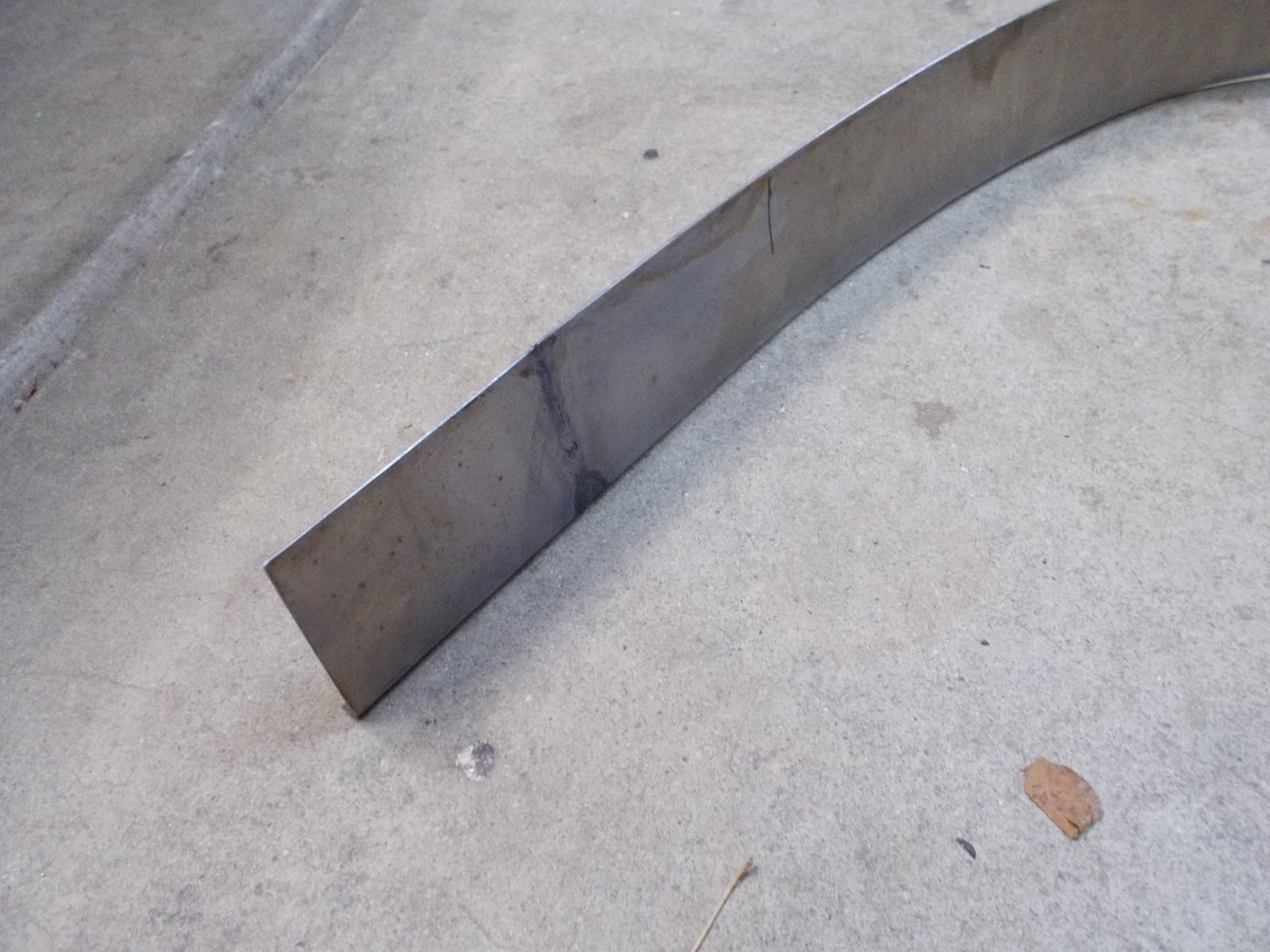

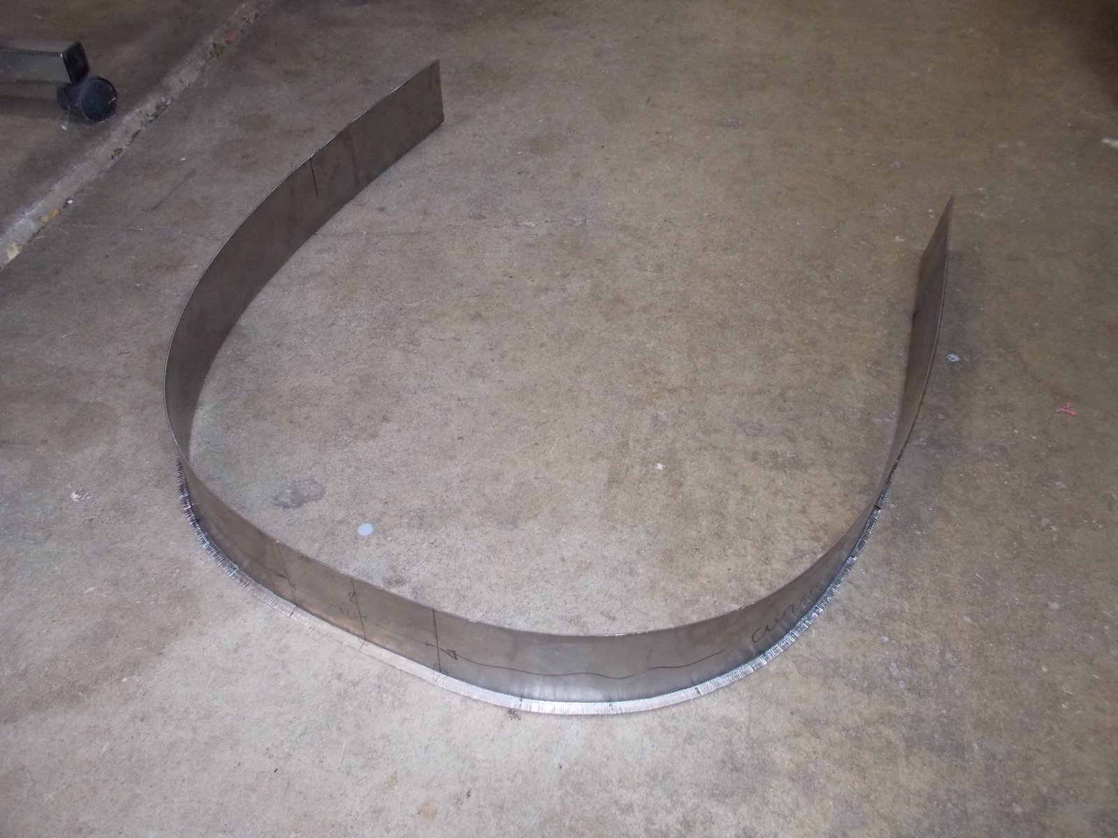

    The offset nosepiece flange was a bit tricky for me. I wanted to make it in one piece but it was just a little too long to be bent in my 4-foot brake. So I made a short extension piece to fit on the end of one of the legs. I put a little over-bend into it to compensate for the expected warpage that will tend to pull the piece back straight when it gets welded to the nose.
  25. THE FRENCHTOWN FLYER
    Joined: Jun 6, 2007
    Posts: 6,084
    from FRENCHTOWN

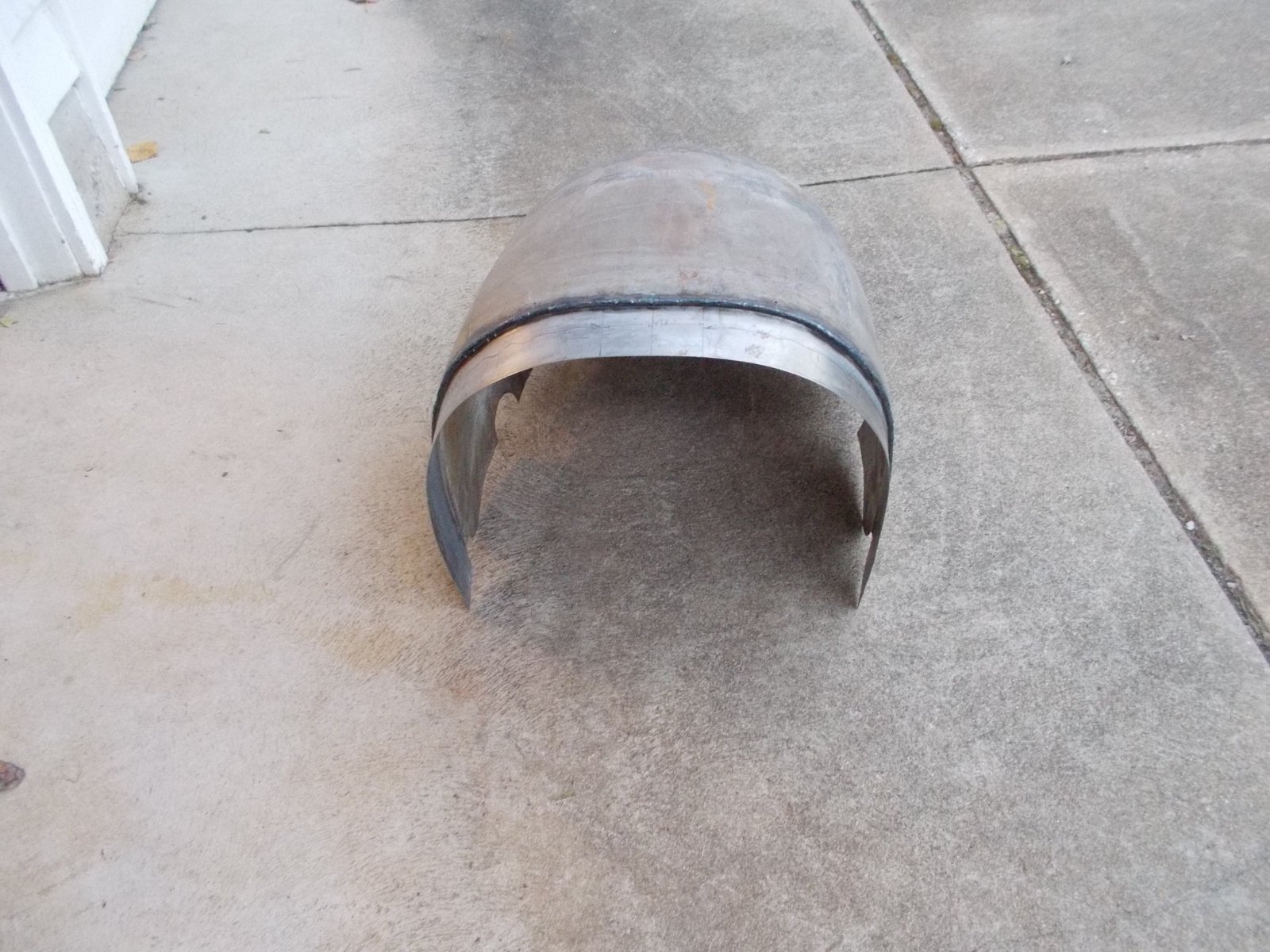

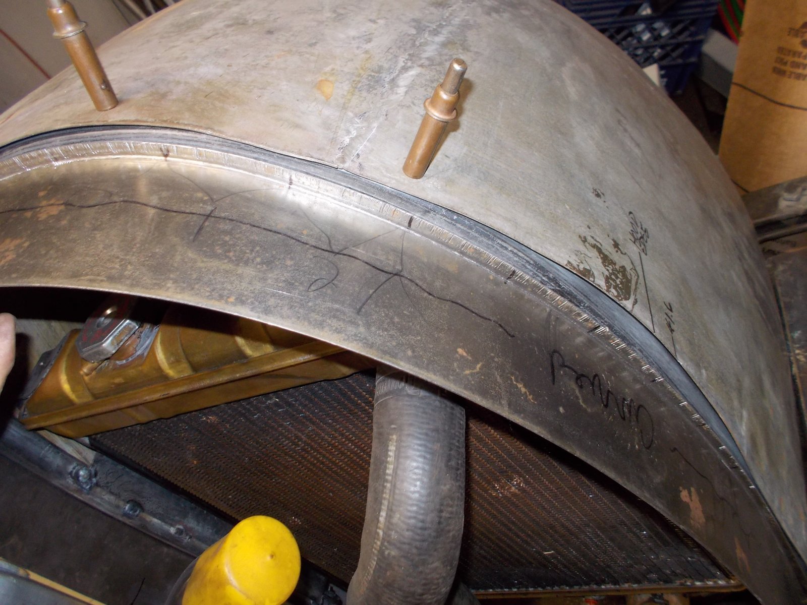

    I clamped the nosepiece down on the rad hoop and tack welded the flange on to the nosepiece.
    Then I skip welded it permanently. It will need a little metal finishing, not much, very little warpage.

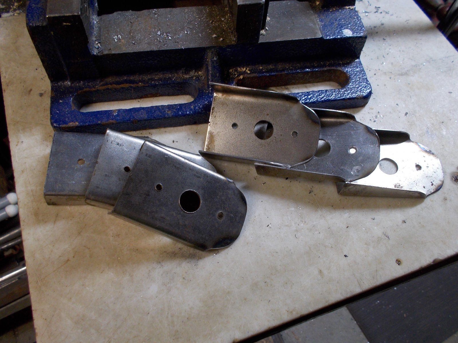

    from FRENCHTOWN
    To affix the nose to the rad hoop I made up six tabs for the hidden Dzus fasteners. I will probably make another attachment point at the front lower edge of the nose to keep it firmly put. Somebody probably stamps these but I decided to cut and bend to suit. Logghe Stamping where are you when I need you?

    from FRENCHTOWN
    Next tabs got welded to the rad hoop and the nosepiece got fitted up to measure for the Dzus holes.
