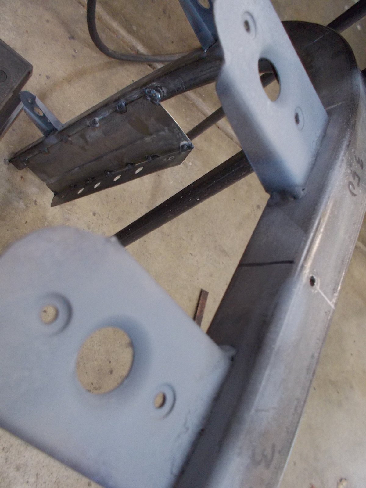

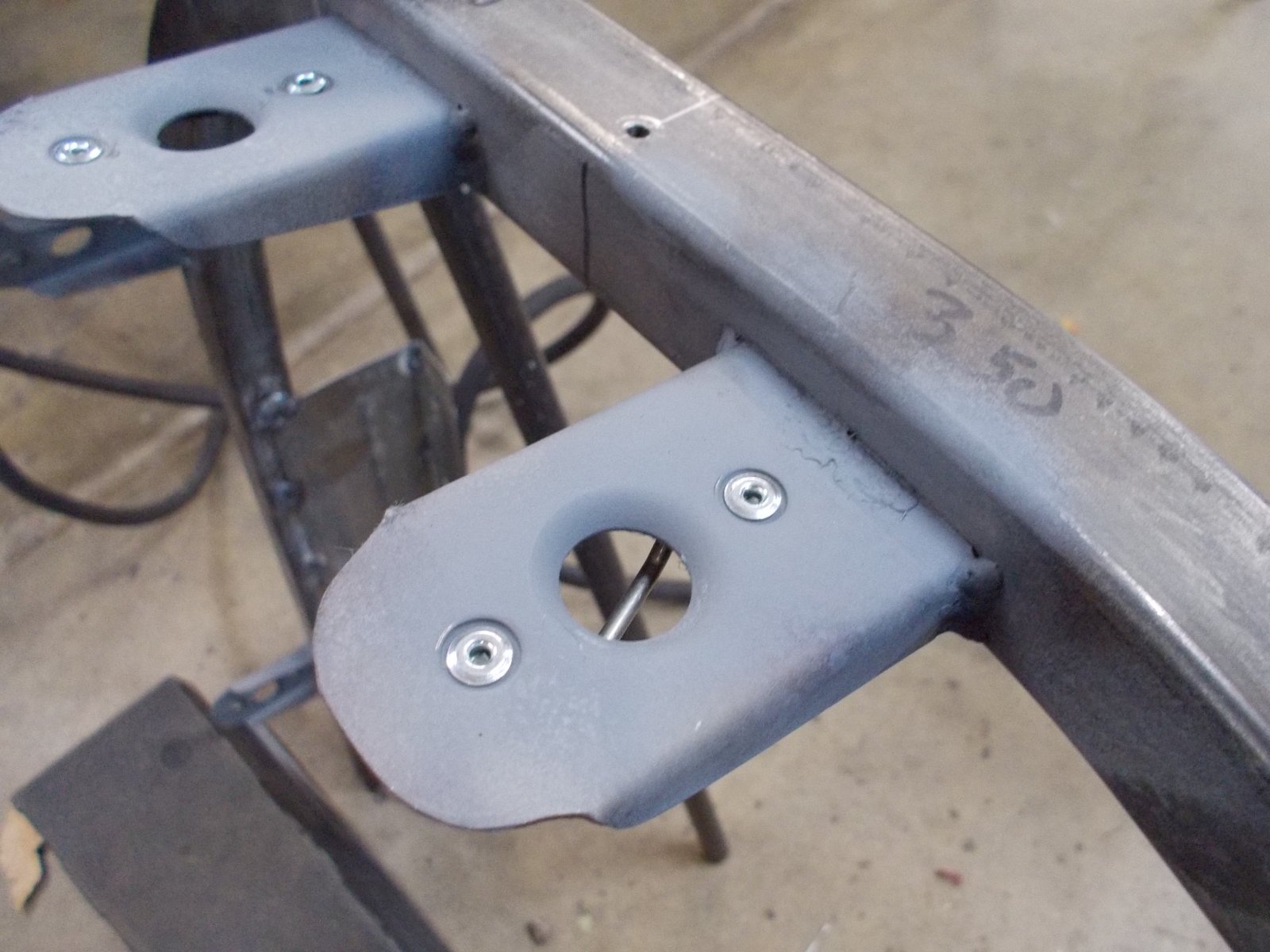

    Before marrying the nose piece to the rad support hoop a few details need to be done.
    The rivet holes for the Dzus springs need to be recessed.
    The center hole needs a bevel.
    The nose holes need to be located, drilled, and recessed so the Dzus buttons do not rub the underside of the hood.
    I squirted a little rust preventative primer on the tabs before attaching the springs.
    Everything fit up perfectly.
    The hood will lay on top of these fasteners, covering them up. A piece of welting will cover the mounting flange. Holes will be punched in the welting to access the Dzus buttons with the hood removed.

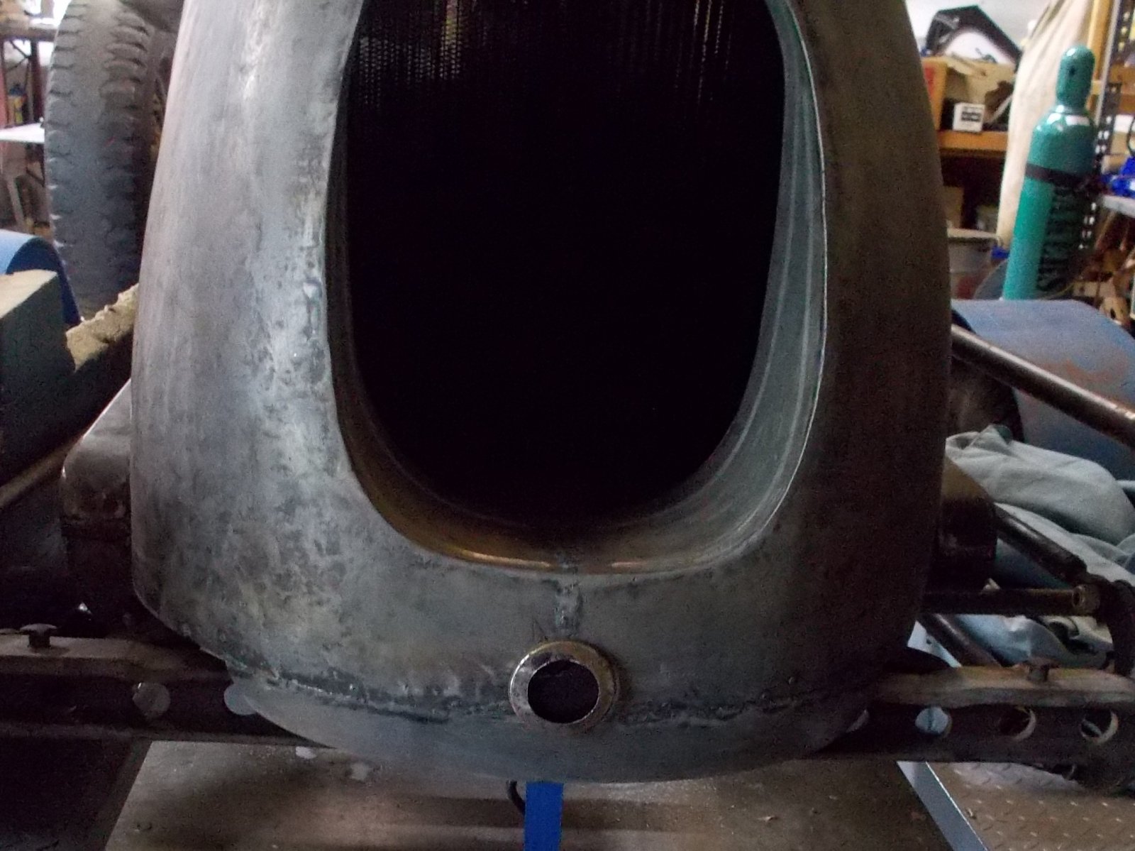

    As far as an attachment point at the front of the nose I just got an idea. Make a hidden fastener behind a removable starter crank hole. That way the Dzus button at the front of the car will also be hidden.

  4. If you put a blind removable recessed cover over the crank hole, Hasn't the crank hole been removed, which is removing a visible fastener needed to remove the removable nosepiece?

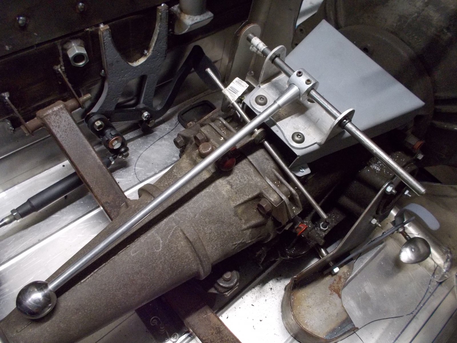

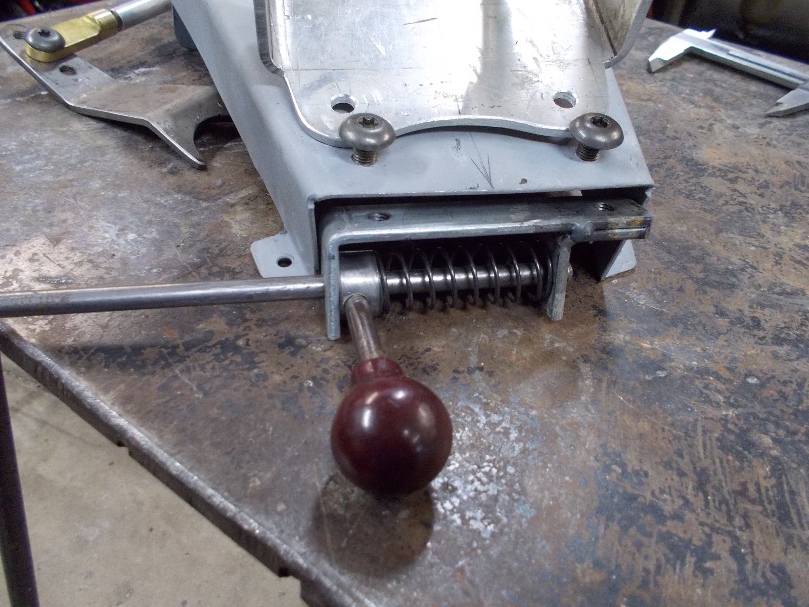

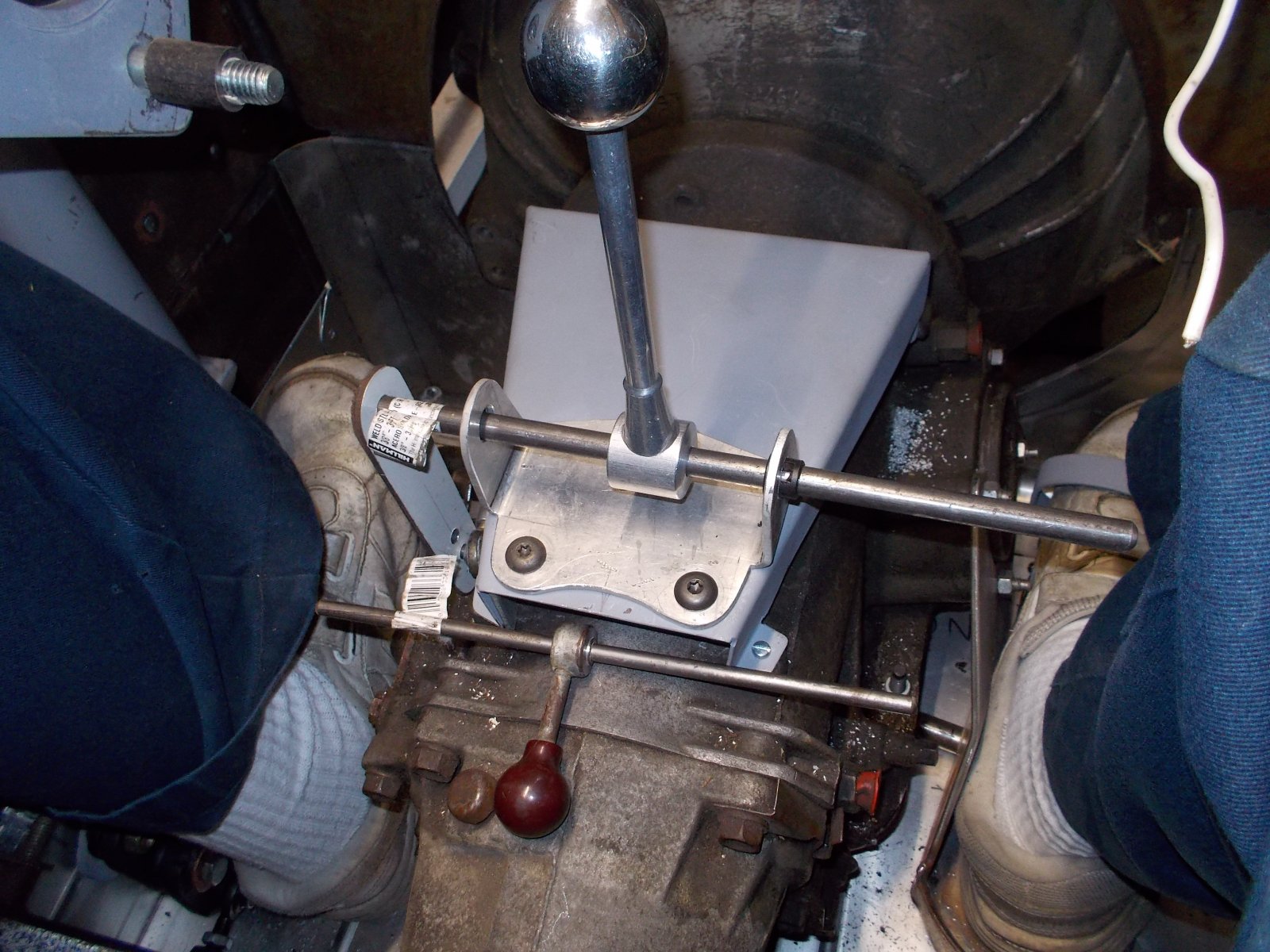

    More pieces of the shifter are done. I reinstalled the body cowl and shortened the shifter handle so it is clear of the steering wheel but still within reach.

    Thanks. I did not want a modern looking shifter designed to be used with a console so I tried to keep it simple - what it might have looked like back when.

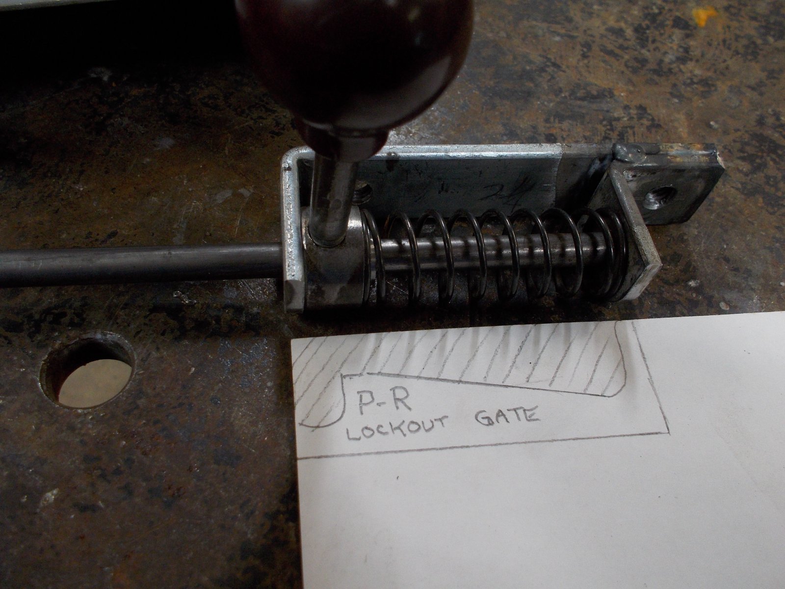

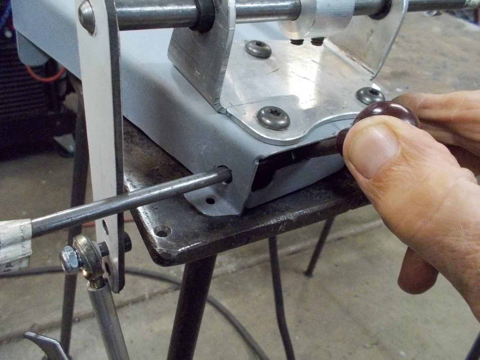

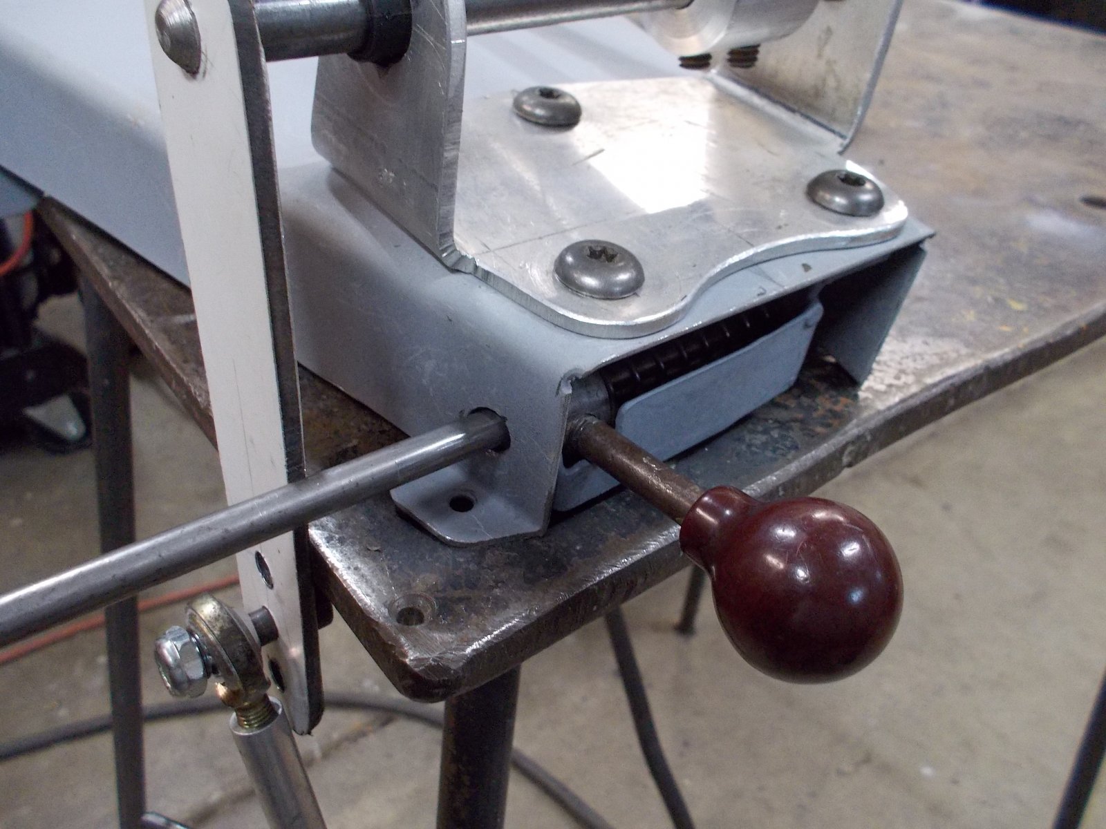

    The simple Park - Reverse gear lockout is next. The handle with the Bakelite knob is from a 1940 Logan lathe. Very period correct. I may substitute a chrome ball for the Bakelite knob to match the shifter. Also thinking about adding a lockout gate for the lever so it doesn't get snagged by an arm restraint or glove.

    Park / Reverse lockout installed. Pushrod will be trimmed to length later.

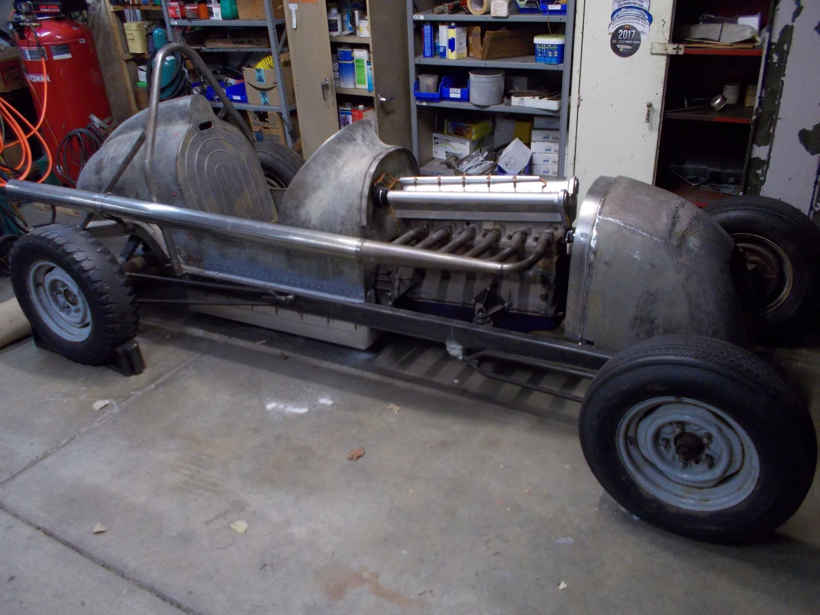

    I took the car off the trailer in preparation for putting this project to bed for the winter. Over the winter the only things planned are a rebuild of the carbs and an aluminum hood. I plan to make the hood pattern so that I can fold over the outer edge - three inches - into a double thickness, so that I can maintain enough stiffness even after scalloping the edge for exhaust header cutouts and the carbs, as well as having a stout surface on which to mount the leather hold down straps. Thanks for looking. Stay tuned.
    The car sits real low. The footbox is less than five inches off the ground. I may add an additional leaf to the springs to bring things up a bit.
    Notice the new Craftsman air compressor? I bought it used at an auction. I took the unit apart to inspect it to make sure the cylinders and rings were good. They looked like new! I paid only a fraction of the price of a new one. The only drawback to this unit is it an oil-less type. They are noisier than ones with an oil sump compressor. That's OK - my neighbors are not too nearby.

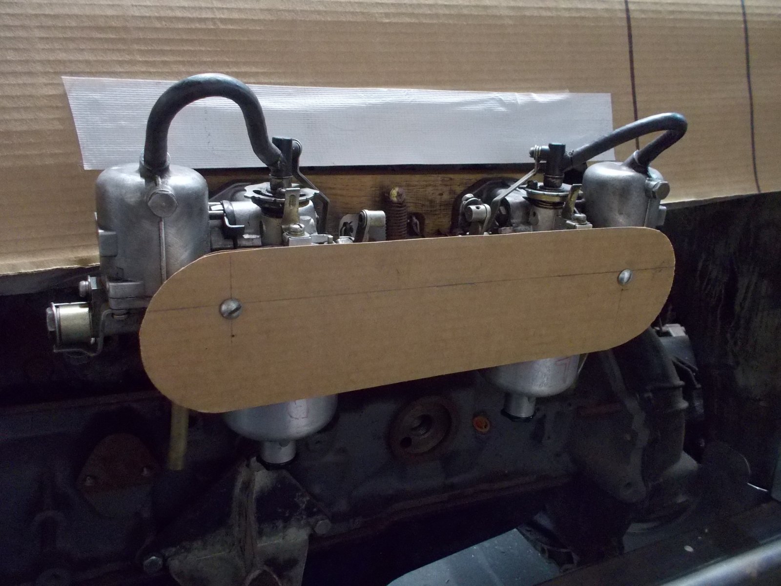

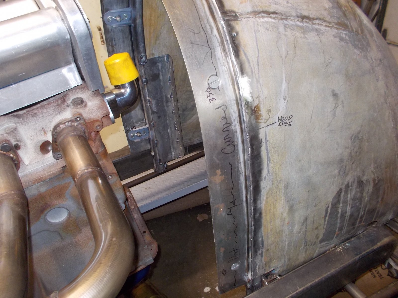

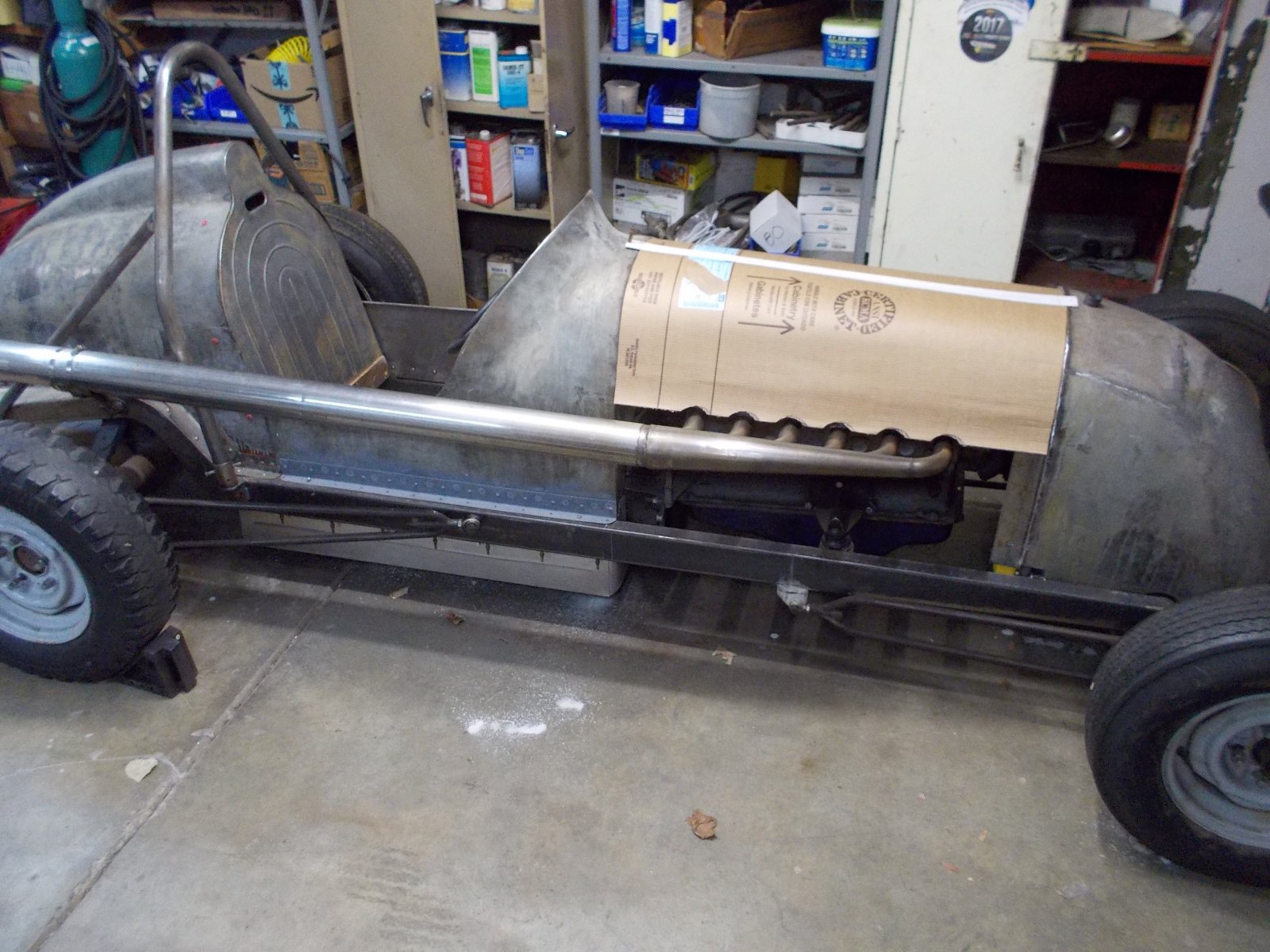

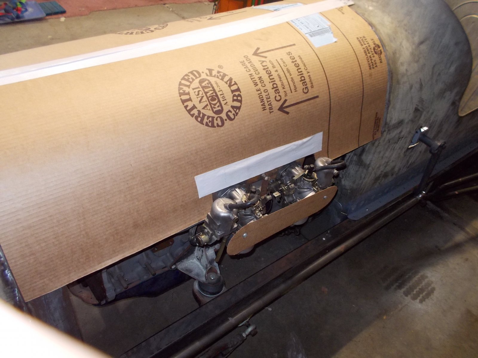

    The hood will need clearance for the carbs. I may rivet a doubler to the backside so I don't get cracking. I can't decide if I like two air cleaners or a single one. Somewhere in the recesses of my mind I filed away the fact that an early Ford Escort has an oval air filter element. I'm sure there are others like it out there too. Short velocity stacks with screens over them would look good too. But I like the idea of filtered air - especially on a dirt track.

    You might want to turn the SUs over. They work better right side up. (I know, you we're just seeing if anyone was paying attention.):rolleyes:
