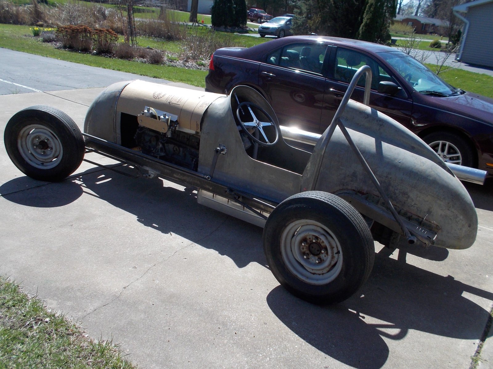

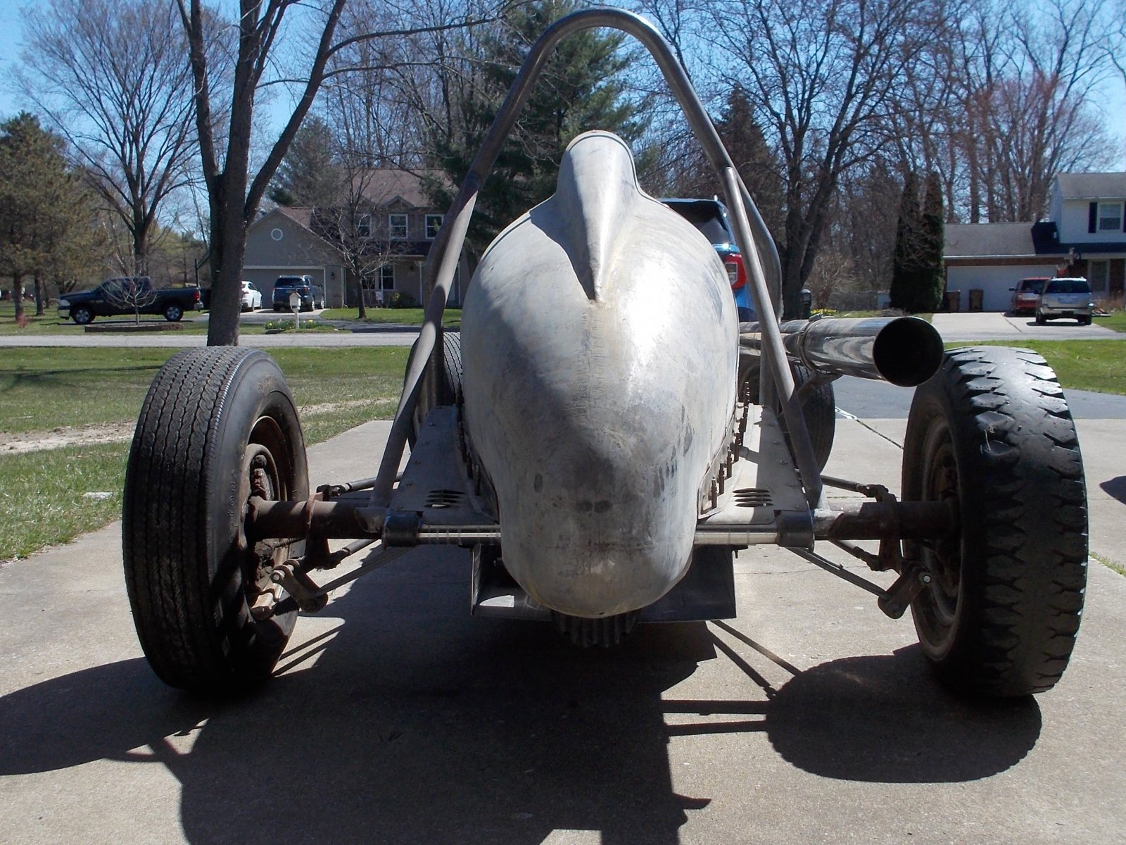

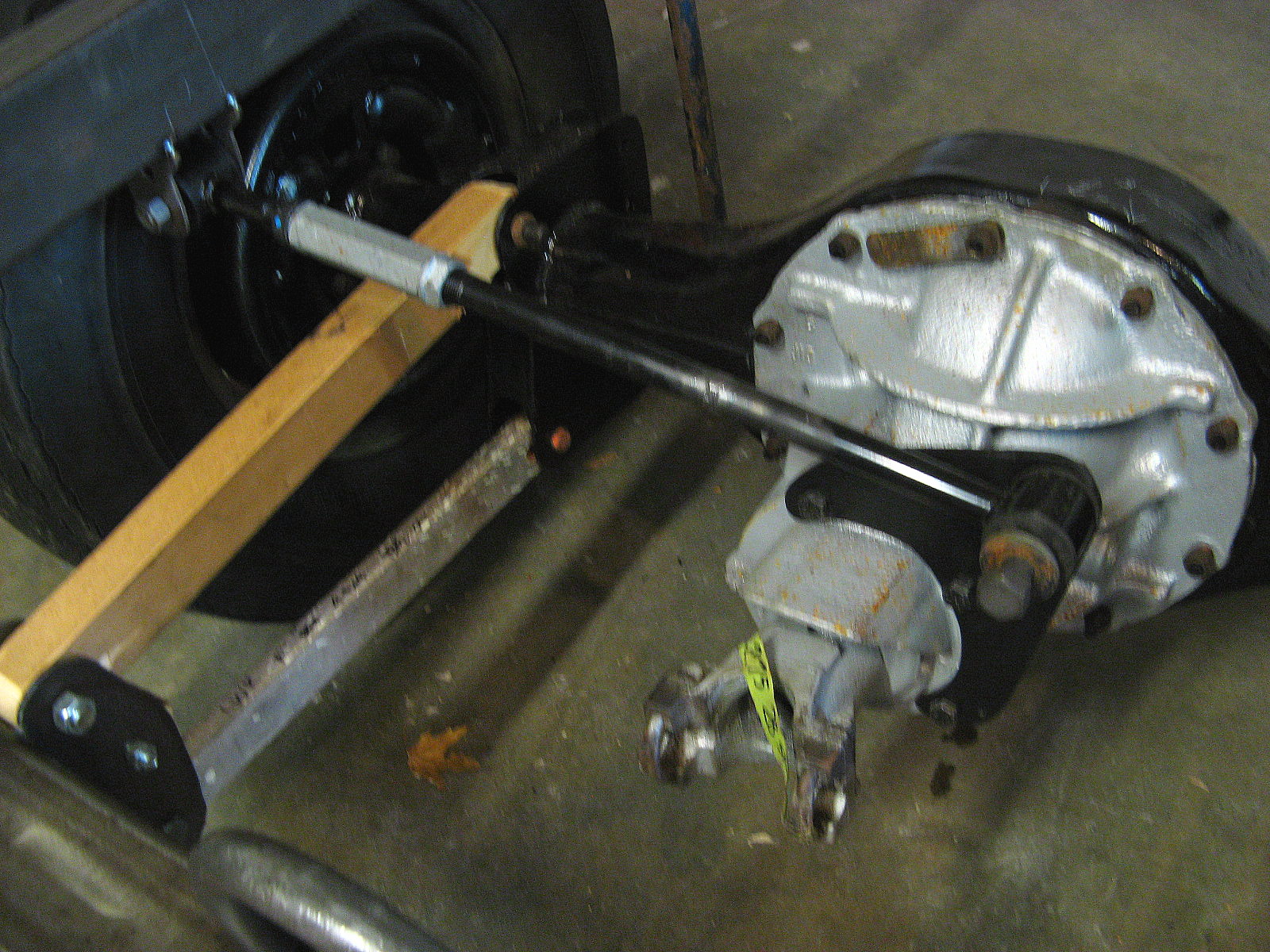

    After the long winter hiatus I rolled the beast outside to ***ess where do I go from here. My "To Do" list is very long. Looking at that list I realized it was about this point in the build of Dad's TQ midget that it got sold. Sixty years ago.
    I will not let that happen - it will get completed.

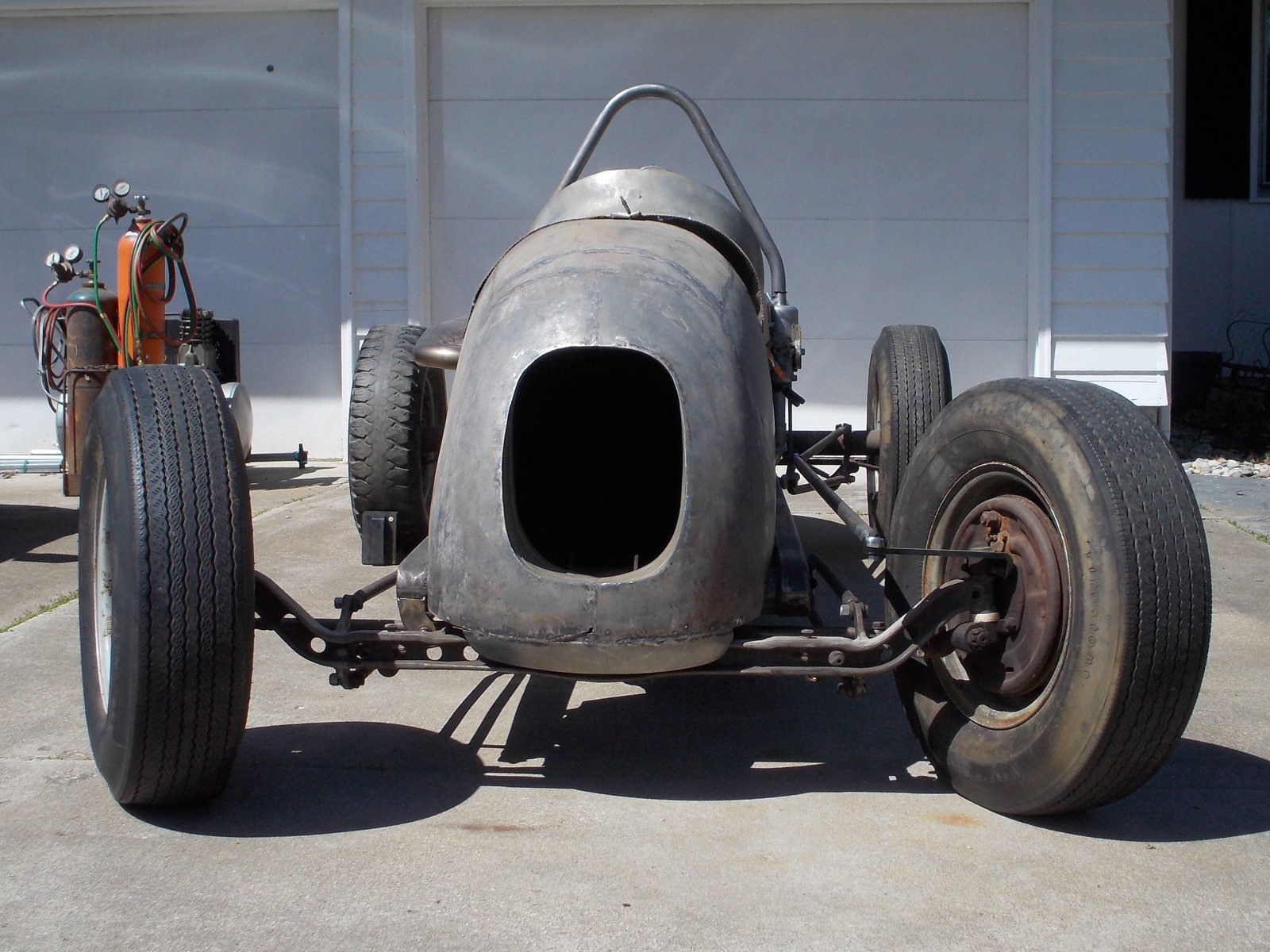

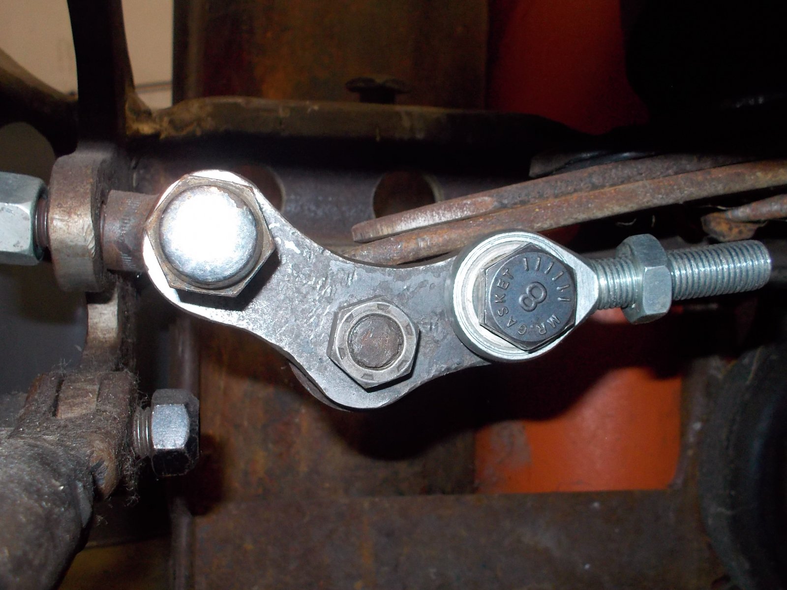

    To reduce the possibility of bump steer and drag link harmonics I am going to split the drag link and make it two-piece. Initially I thought of putting a pivot boss through the frame but looking more closely it seems if I put the boss through the rear hairpin mounting boss below the frame rail it could be longer (better) and closer to the hairpin pivot. It was just happenstance that by initially using a hunk of 2 x 3 tubing for the mount that there is now enough space to do that.
    Another advantage to this piece is that the steering ratio can be easily sped up or slowed down by adding multiple Heim end mounting holes.
    One aspect of the task that I need to resolve is what to use for the pivot bearing. I'm thinking a welded in sleeve reamed to accept an Oilite bushing, or a bronze bushing with a Zerk fitting on the backside for lube.
    Any other suggestions? Or is there a readily available bearing that will fit in the small space available?

    Here is an idea.
    Cut a hole through both walls of the ch***is tube to x dia. Cut a piece of tubing to the length that is the same as the width of the ch***is tube. Machine the I.D. of the ends of tube for a press fit of the following bearing or something similar.
    RBC Heim Rod End Bearing - Series COM, 2 Piece - Metal to Metal On Roller Bearing Company Inc. (rbcbearings.com)
    Chamfer O.D. of tube, weld in frame rail on both ends and grind flush.
    Maintenance free option
    DuraLube™ II Maintenance-Free Spherical Plain Bearings On Roller Bearing Company Inc. (rbcbearings.com)
    FK Rod Ends HIN8T FK HIN-T Series Rod End Receiver Bearings | Summit Racing

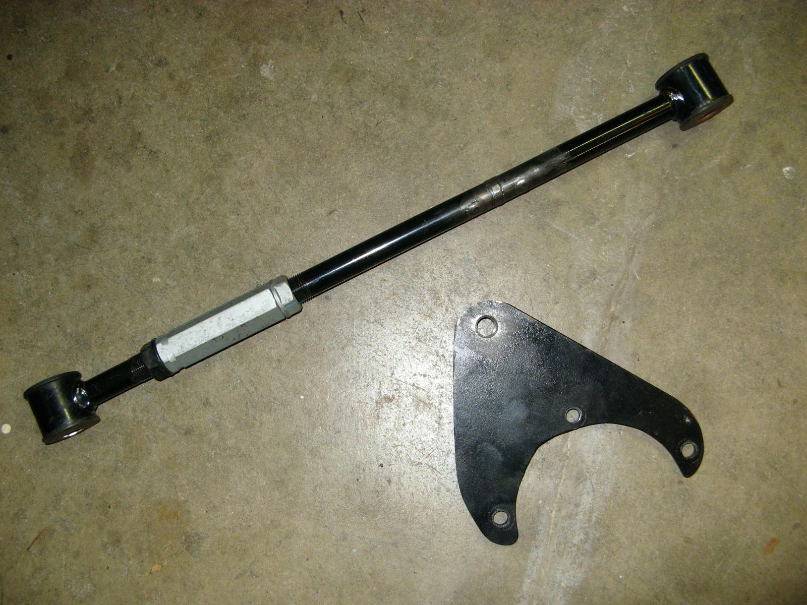

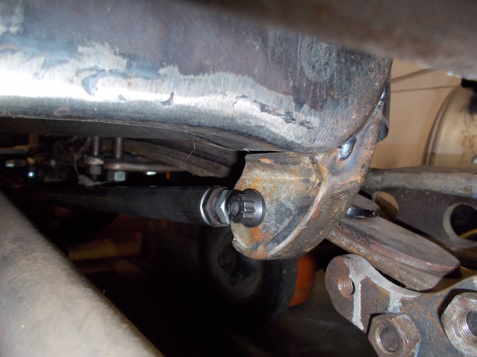

    FRONT PANHARD BAR:
    I need a front Panhard Bar to keep the front axle stable. Somewhere in a long-forgotten hot rod parts catalog I saw this mounting bracket, so I copied the design and torched out a couple. I decided it would fit this car and take up little room. It wasn't until I gave it a closer look that the genius of the part became apparent. By attaching the Panhard bar to the curved piece I was able to see that if that tire hit a bump the spring deflection would flatten and extend the end. That would twist the shackle which in turn would rotate the end of the Panhard Bar downward, to counteract the upward moving axle, thereby keeping the Panhard bar horizontal and eliminating any bump steer from the Bar moving in an arc.
    Clever

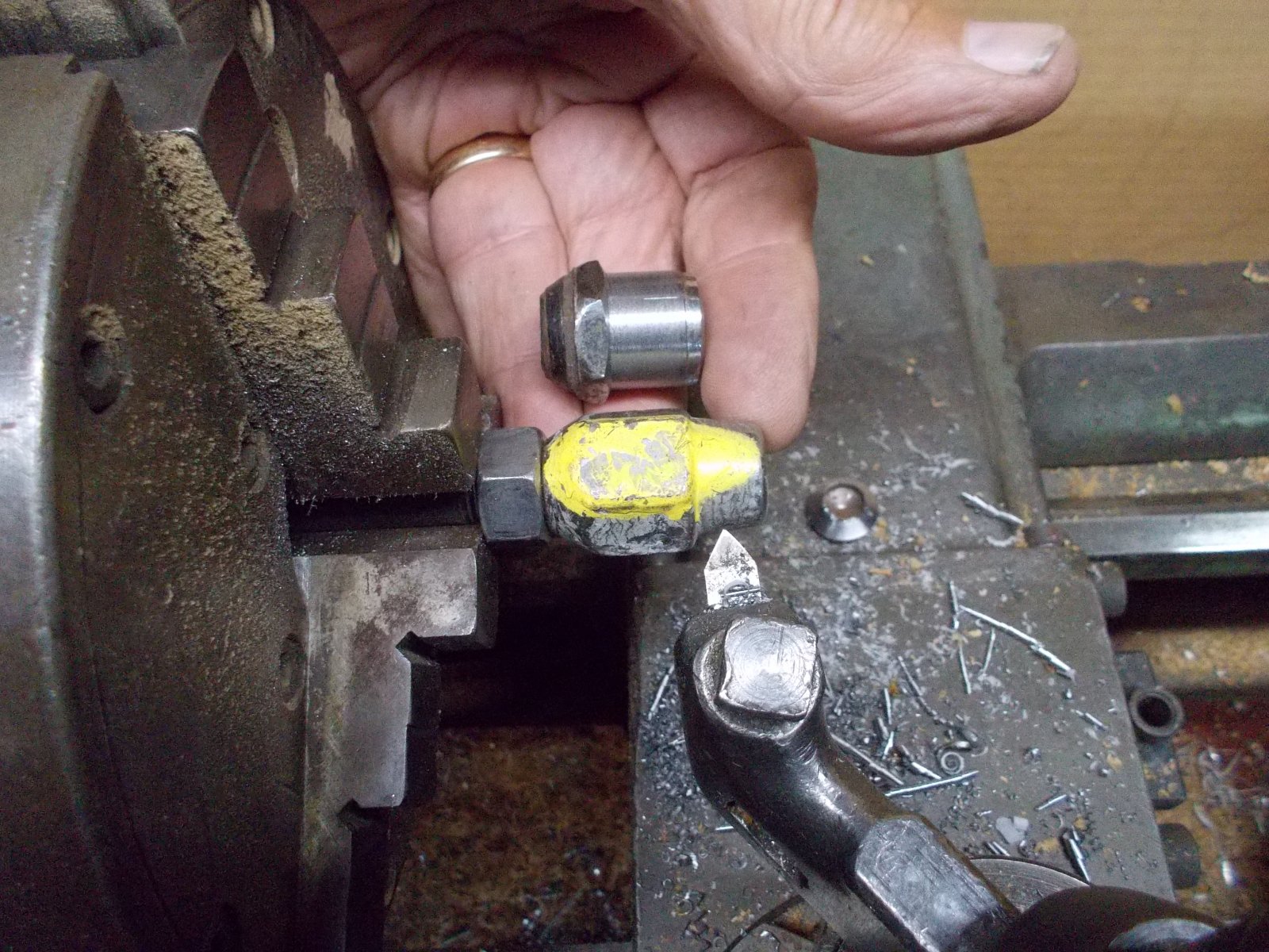

    I made the rod end bungs from 7/16-NF mag wheel lug nuts.
    Front Steering06.JPG Front Steering07.JPG Front Steering08.JPG Front Steering09.JPG
    Shadow Creek likes this.

    Sorta the same principle as a CalTrac traction bar, no?
  26. THE FRENCHTOWN FLYER
    Joined: Jun 6, 2007
    Posts: 6,084
    from FRENCHTOWN
    Yes, I guess it is a similar principal.
    In future builds, like my Attic Anglia, I may see if I can apply it to the rear, where I installed a more conventional Panhard bar. It would require reworking the mount on the center section. But practically speaking it is probably sufficient as-is for a rear stabilizer.

    Nice! When we made an arm for the dirt cars way back when, we used oilite bushings, and they worked just fine. Easy to make the support tube, and simple, hardly any maintenance. I just kept them clean, and a light wipe of oil when re***embling. And another consideration, they support the load better, and there's no point contact with bushings.
  28. THE FRENCHTOWN FLYER
    Joined: Jun 6, 2007
    Posts: 6,084
    from FRENCHTOWN
    So I looked through my junk drawers and found some bits that I used to make up the bearing boss for the steering idler arm. A piece of 1.25" OD .120" wall for the shell, a couple of Oilite bushings that I reamed out to .625" ID and a grade 8 5/8"-NF bolt that I turned the head down and gun drilled for a Zerk grease fitting.
    I love Zerk fittings. I will probably never need to grease the shaft once installed but the next caretaker of this machine may want to someday so why not make it easy for him/her?
    I will wait to press in the bushings until the final welding is complete, when I will size the bushings for the final bore ID. In the mean time I'll just turn a temporary bushing from wood or plastic so I can size up the steering arm Heim holes. My plan is to put an offset bend in the arm just to keep the two sections of the drag ling in alignment, then drill it full of pretty lightening holes after the offset bends are made.

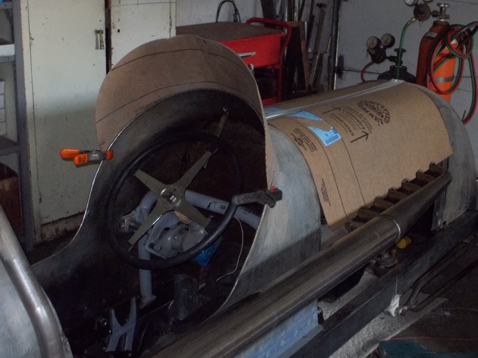

    Just for grins I made up a windshield pattern before calling it quits for the night.

    I guess I misunderstood, I thought the pivot was in the frame rail.
  30. Mike Lawless
    Joined: Sep 20, 2021
    Posts: 731
    Mike Lawless
    I've never really looked at cowl steer cars much. That seems like a solid solution to a common problem. Good thinkin'!
    And for the limited movement, the bushing arrangement would work out great in my mind.
    If you wanted to be really tricky, your shock arrangement might be able to be employed here as a steering stabilizer.
