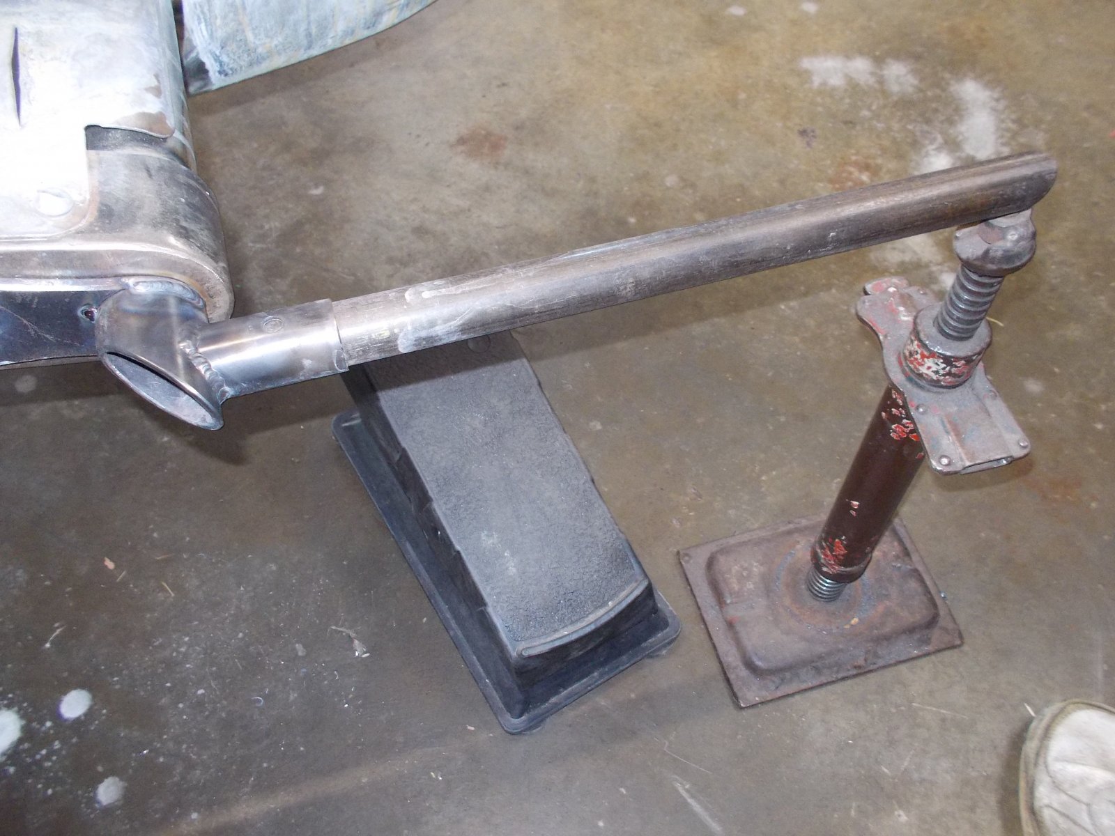

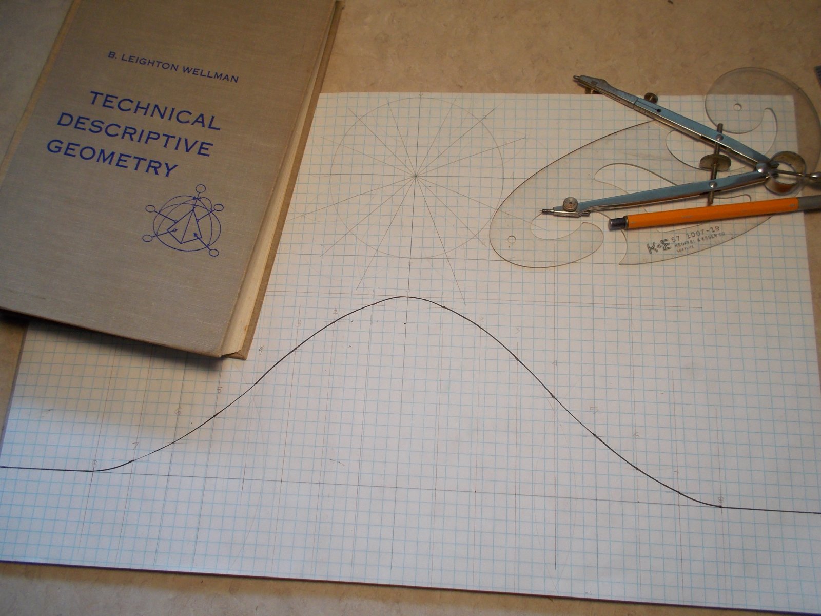

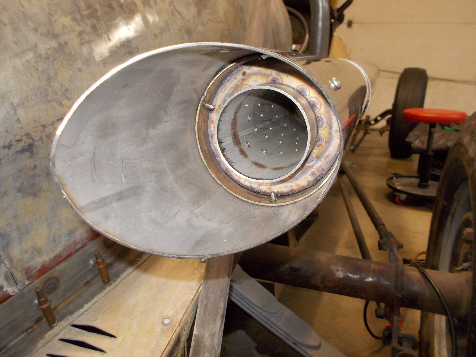

    The exhaust pipe needs attention. It needs to have the rear of the outlet skived on a 45 degree cut.
    Does anybody know for sure why this was done on many cars? I can think of two possibilities.
    First - it looks pretty cool. Many exhaust pipes of the '30s aircraft were sliced as they left the fusalage that way, probably for aerodynamics. Racers may have been imitating that.
    Secondly - and more logically - is that a straight cut tube will create a distinct backpressure wave as it hits the opening and reverberates back toward the engine. If this reverse pressure pulse hits at the wrong time, RPM wise, it could create a flat spot in the engine's torque curve, To mitigate that effect somebody sliced the exhaust at an angle so the pressure pulse got dissipated from no distinct tuning length of the pipe. If it worked then other racers may have done a monkey-see-monkey-do copy job and it got used elsewhere. This is purely conjecture on my part unless somebody can set me straight.
    I don't have a good machine to make the 45* cut so I decided to lay out a path on paper to trace and use a cutoff wheel to do it. I decided to shorten the pipe a little too. If I ever back the car into the wall I do not want the exhaust pipe to be the first thing to hit. I made a paper pattern and stuck it on the pipe and cut the angle. Then, using the same pattern I laid out three attachment points for mounting screws and three additional holes at the rear to hold the muffler insert. Finally I tapped the muffler insert for three 8-32 screws and fastened it inside the pipe with vibration proof (troicho-centric) screws.
    Now I can drill the front of the pipe to join it to the header and then weld on the heat shield for the driver.
    exhaust 01.JPG exhaust 02.JPG exhaust 03.JPG exhaust 04.JPG exhaust 05.JPG exhaust 06.JPG

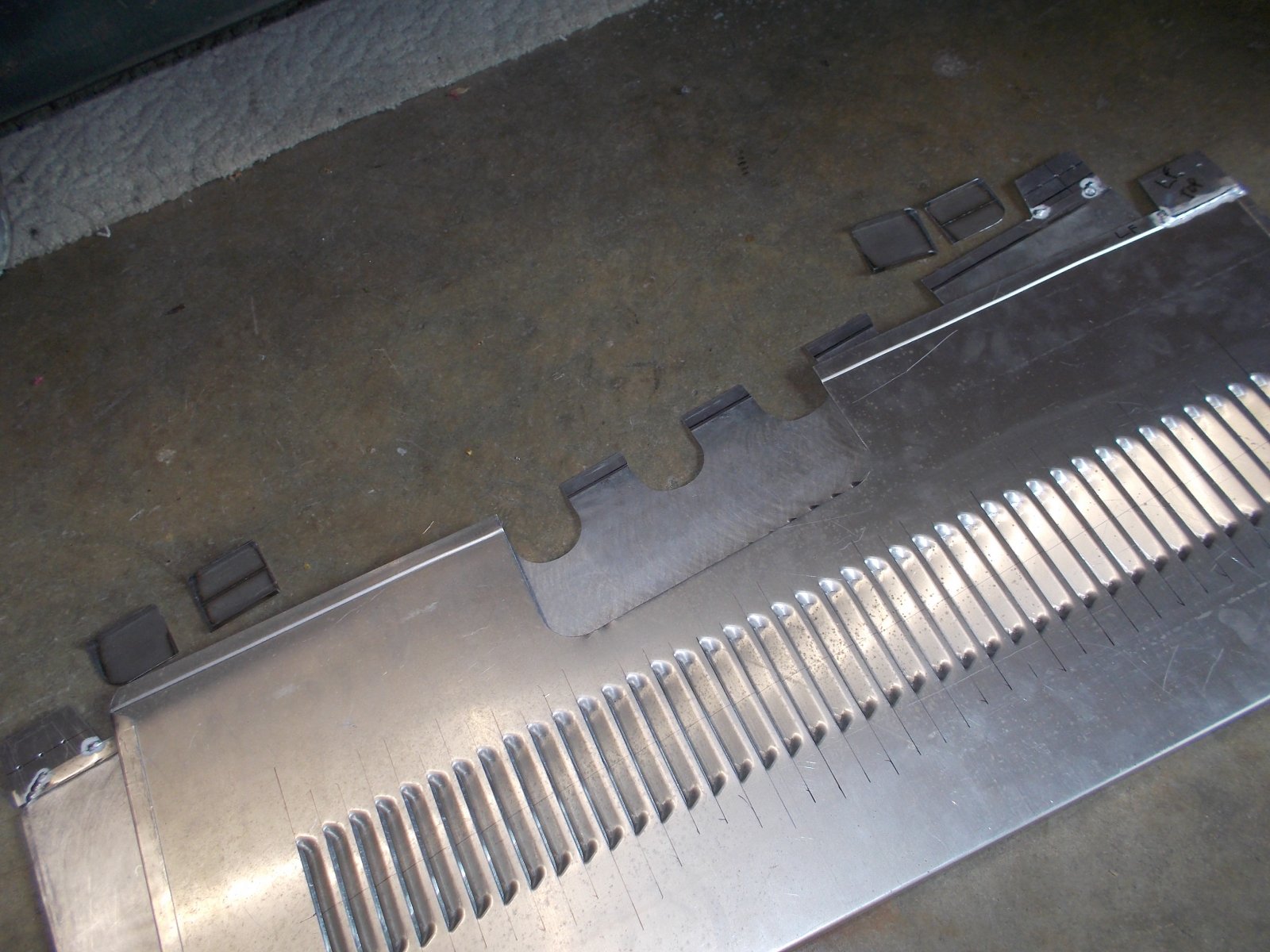

    I'm tired of looking at the cardboard engine cover. I'm going to skin it in aluminum, starting with the side panels.
    I made the p***enger side. I had made a set of louver dies for my DiAcro press so this looked like a good place to use them. I wonder how much 42 louvers cost these days?
    I also drilled and tapped the header collector three places to hold the exhaust pipe on. That job did not go well. I broke the tap off in the stainless header. Now what? I couldn't access the broken off tap from the inside. Fortunately the gods of rodding smiled down on me and I was able to shatter the remaining tap bits with a couple of chisels and punches, making the removal of the tailpipe possible.

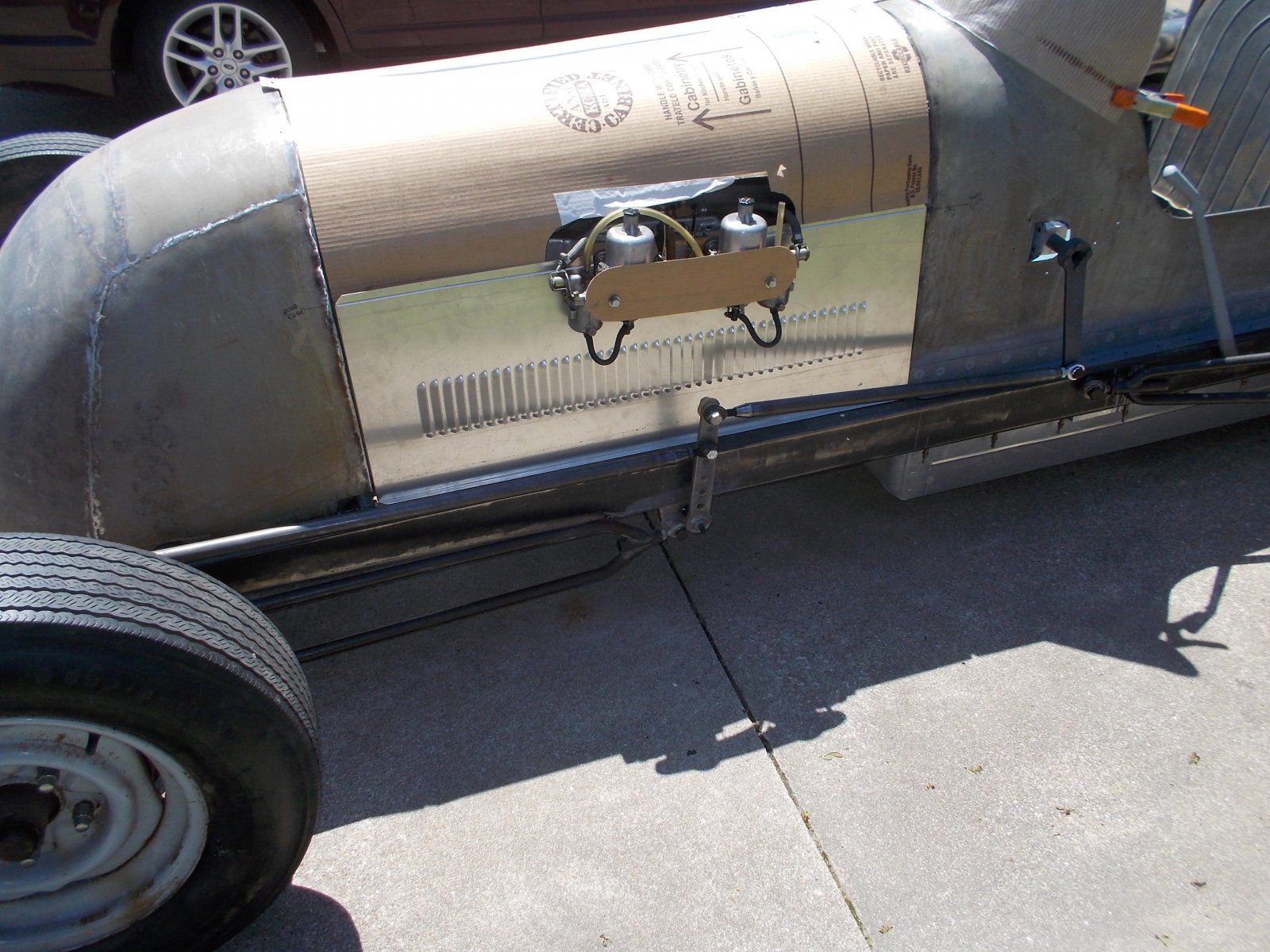

    I finished the drivers side hood side panel and rolled the car out into the sunshine for a couple of glamour shots. Now I'll need to do the hood. It seems like it should have a slight bulge in it. After I roll it and form it I am going to see if it will fit under my English wheel to roll in a little convexity.

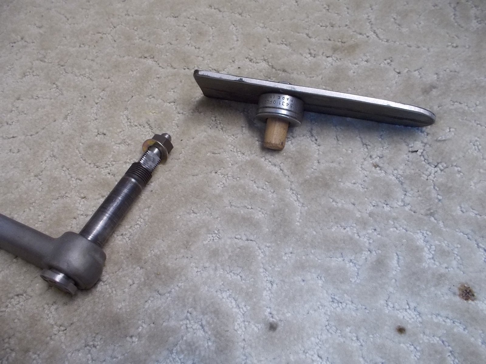

    A friend donated an unused socket (who needs a 31/32 socket?) to use for the hand brake bell crank. I'll weld it all together. The part of the crank that sticks up above the pivot will be left temporarily in case I need to affix a return spring or brake light switch up there.

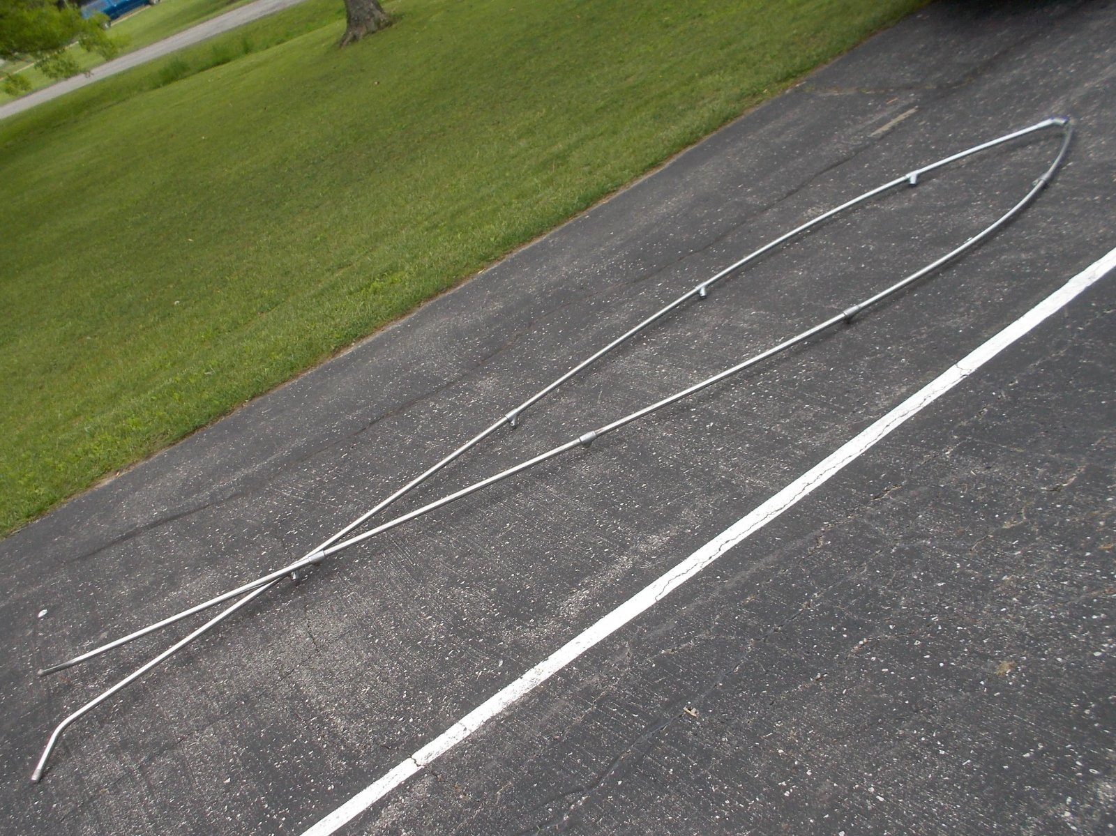

    Here is the 7/8" polished stainless steel boat railing I plan to use for crash bars. I have to knock off all the cast stanchions first. There already is some curvature in the tubes which should make fitting it up to the car easier, except I have no good way to put symmetric gentle bends in the tube. I may try to coax it in a #2 Diacro bender with homemade shoes and die.

    Thanks GHQCE. I remember as a tot watching my dad bend up a go-kart frame using sand filled tube and a torch. I am a little anxious about trying to do a sweeping gentler bend around the tailpiece. Ironically enough I have benders that will do a tight radius, its the sweeping arcs that are commonly done on a ring roller type of machine that I am struggling with. I may try doing gentle sweeps on a press but I'll still need to turn a 7/8" roller die or some such.

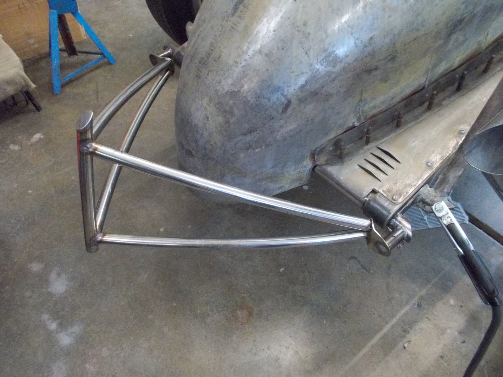

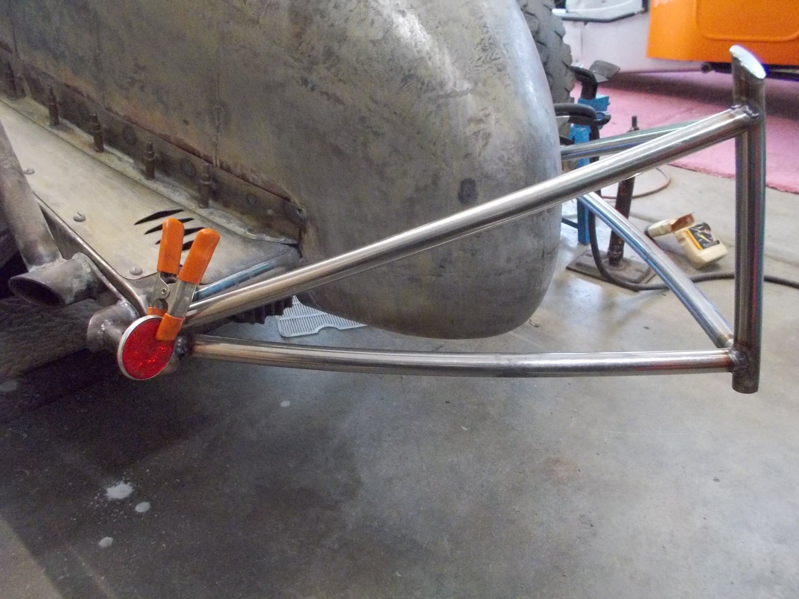

    Well, here's what I came up with for a crash bar. While I am not completely happy with the look it is the best I can do for now with my current technology. I may do something better in the future. One happy accident in all this is that I now have a convenient place to put plug-in tail/brake/turn lights.

  21. chessterd5
    Joined: May 26, 2013
    Posts: 903
    chessterd5
    from u.s.a.
    Maybe some strategically places gusset plates may enhance the look or Maybe some faux aerodynamic cover plates at the attaching point to the body.
    Just ideas out loud.

    Maybe chessterd5.
    It could have worked out better had I chosen to pinch in the rear of the frame rails. But I still have plans to attach a '27 T body in place of the champ body, thereby ending up with two cars - a roundy round champ car and a center-steered nostalgia altered with the same rolling ch***is. I wanted the full frame width for mounting the '27T. We'll see.

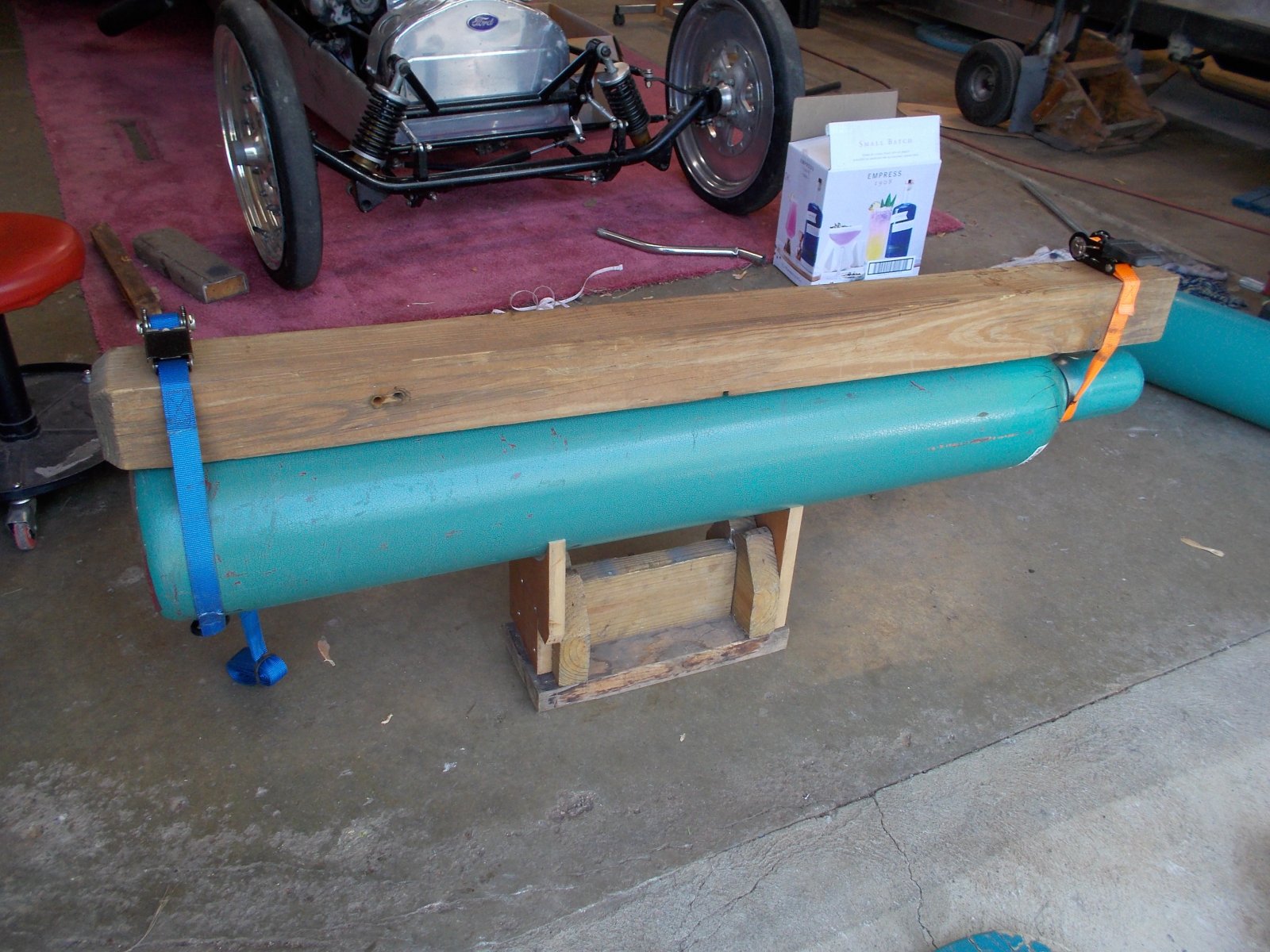

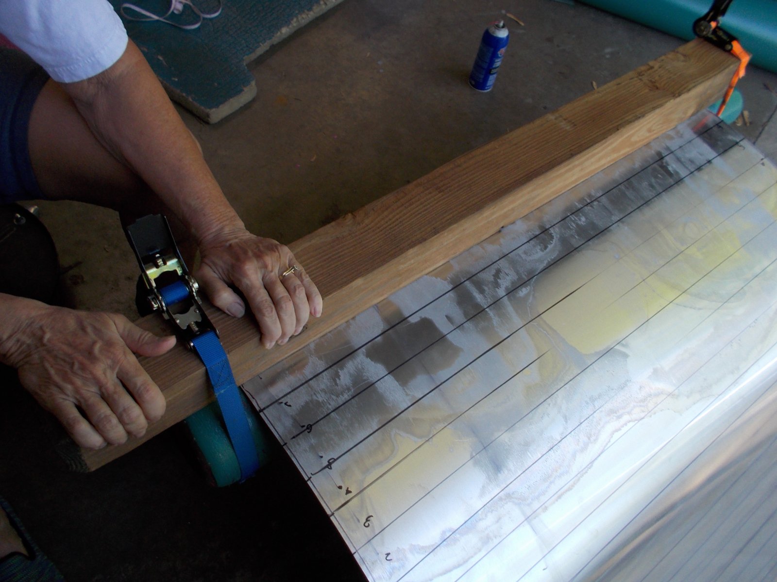

    I went to the shop to do some work. First I made a couple of brackets to hold up the front edge of the seat pan. But I ran out of argon so I tack welded them in with a MIG. I also put some arch in at the front to clear the tailshaft, and drilled holes for Clecos until I can install Dzus ****ons.
    Then since I had an empty argon tank to play with I jury rigged a crude radius brake to put the curvature in the hood top. The lovely Ms. Frenchtown Flyer was kind enough to help on the ratchet straps. We slid the hood in, pre-marked with tapered guidelines, and she clamped the blue strap tight, then I placed a piece of angle aluminum against the panel and pushed. We took it easy. Then she loosened the blue strap, lifted the landscape timber, re-positioned the hood and did it again. The first try did not give enough curvature, but we now have a system that will work and we can continue to add curvature until there is enough. Then a trip to the E-wheel to add some dome and done. seat 03.JPG Hood 13.JPG Hood 14.JPG Hood 15.JPG

    We continued to roll curvature into the panel until it had about the right amount. I need to order hood a strap kit. The edges will all need to be further defined. I'm thinking of rolling the front and rear edges under for a clean look. The sides may get reinforced with thinwall square tubing.
    It still looks to have a concave surface. It is an optical illusion. That is why I have to do some E-wheel shaping to bring up the center of it.
