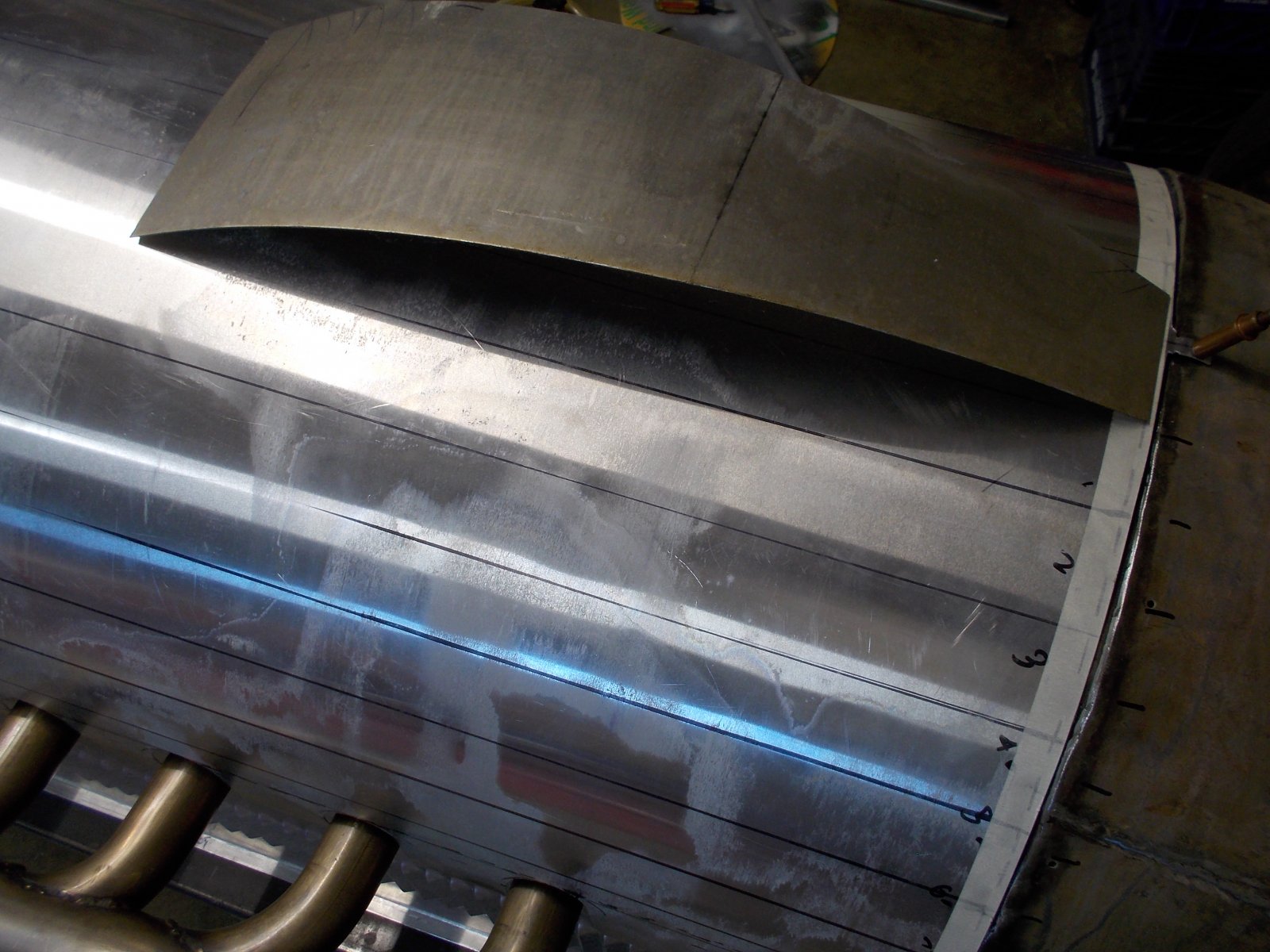

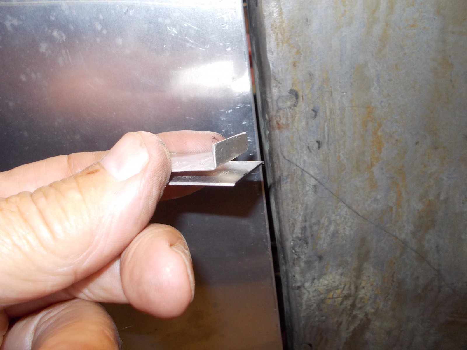

    Further fit-up of the hood meant enlarging the exhaust cutouts to get the hood to come down. Next I had to trim the front and rear edges. I made a clearance tool to register on the edge of the hood recess and marked a line to give me 3/16 body clearance. One suggestion: If you want 3/16 clearance cut it for 3/32, as things will likely shift as the hood settles into place. More clearance can then be added as necessary.
    Clearance tool -

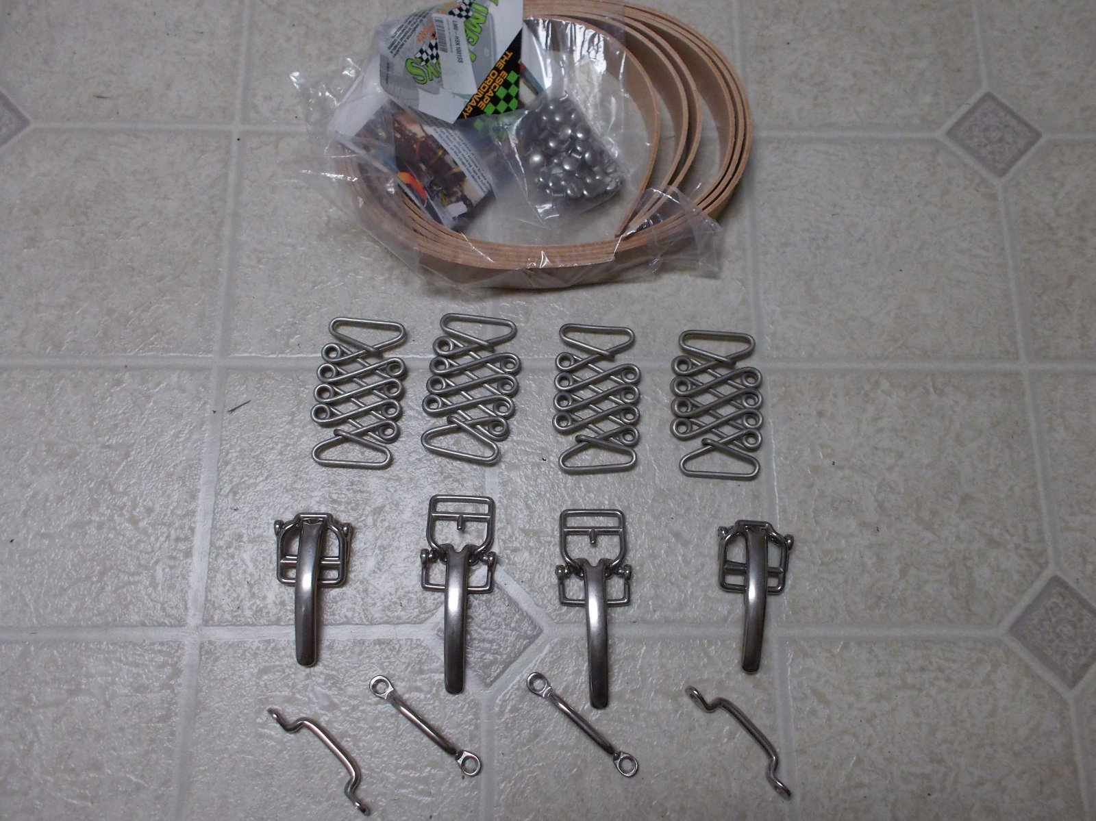

    My hood strap kit arrived from Lime Works.
    I did have to chuckle a bit as I read through their instructions. It said to "wear cotton cloves when handling the leather straps so as to keep oily fingerprints from staining the leather."
    It's going on the hood of a racing car for goodness sakes - not in a museum. It will likely be surrounded by oil.

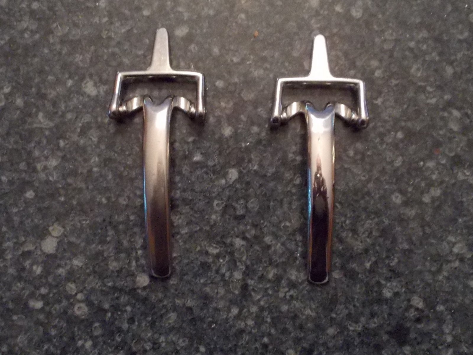

    I think I'll buff out the latch handles further.

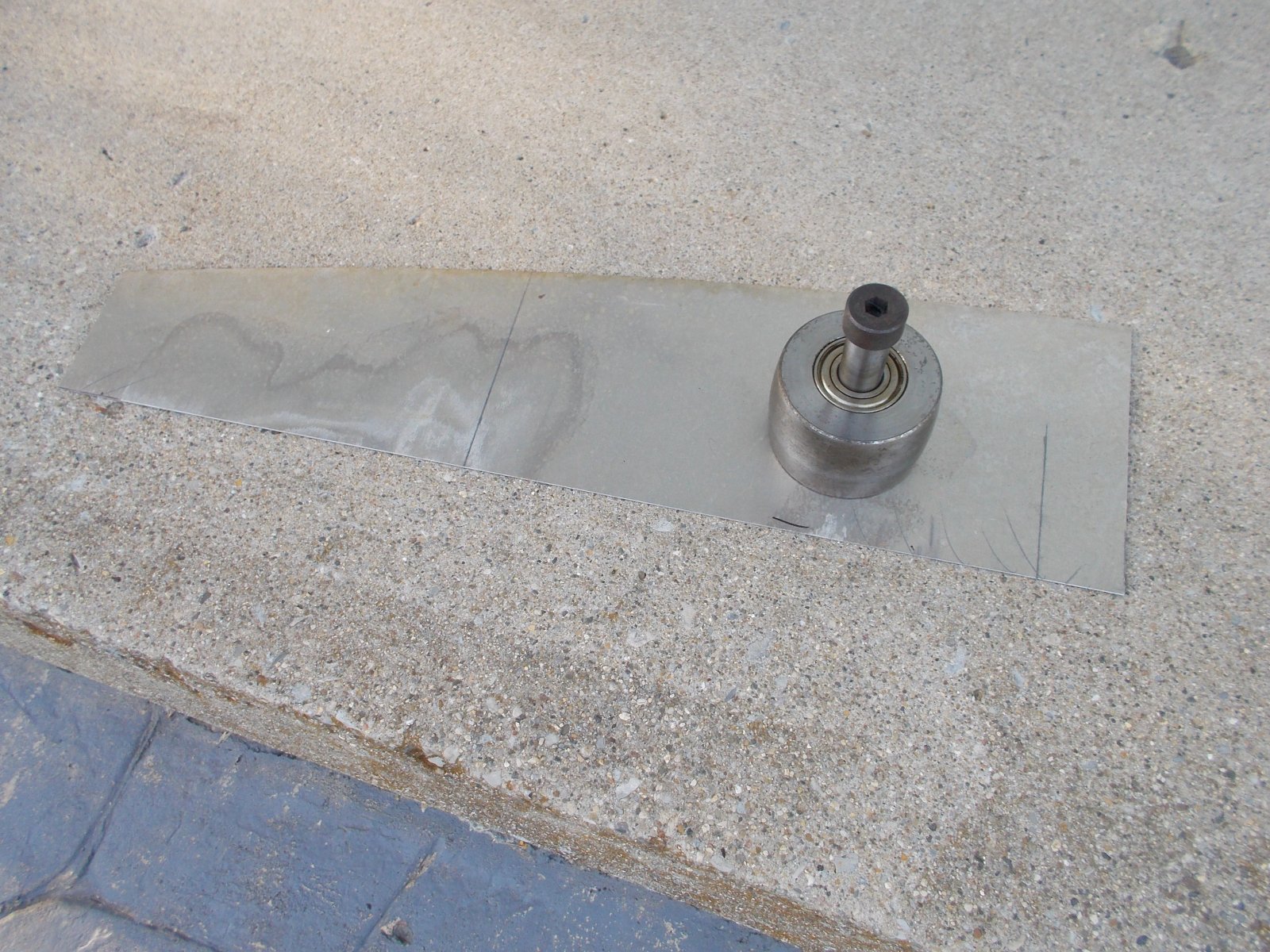

    I am seeking advice from experienced E-wheel users. Before tackling putting a dome in my hood I tried a piece of s**** material of the same thickness to see how much pressure was needed and in which direction I should be rolling it - longitudinally or laterally. It was then that I came to realize that I am better at making E-wheels than using one. I discovered I was only going to need to preload the die by about half a number. (Tech tip: Have some way to repeat the pressure setting on your E-wheel. Mine has numbered toe-kick legs - DRO would probably be even spiffier.) I first made a series of p***es in the lateral direction - back and forth. The metal arched up but did not put a lot of crown along the spine of the hood. Bear in mind the sides of the hood panel still need to be straight to align with the bottom panels. I don't want this thing to come out looking like The-Python-That-Swallowed-The-Pig, just a gentle arch along the middle of the hood.
    All suggestions from those who have solved similar forming projects are welcomed. Hood 30.JPG

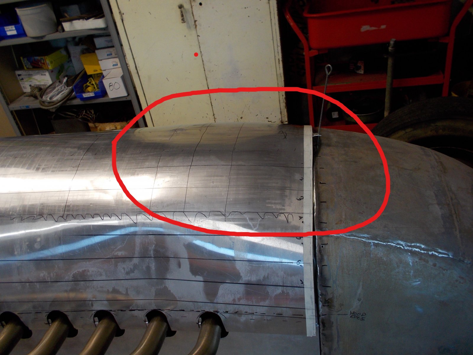

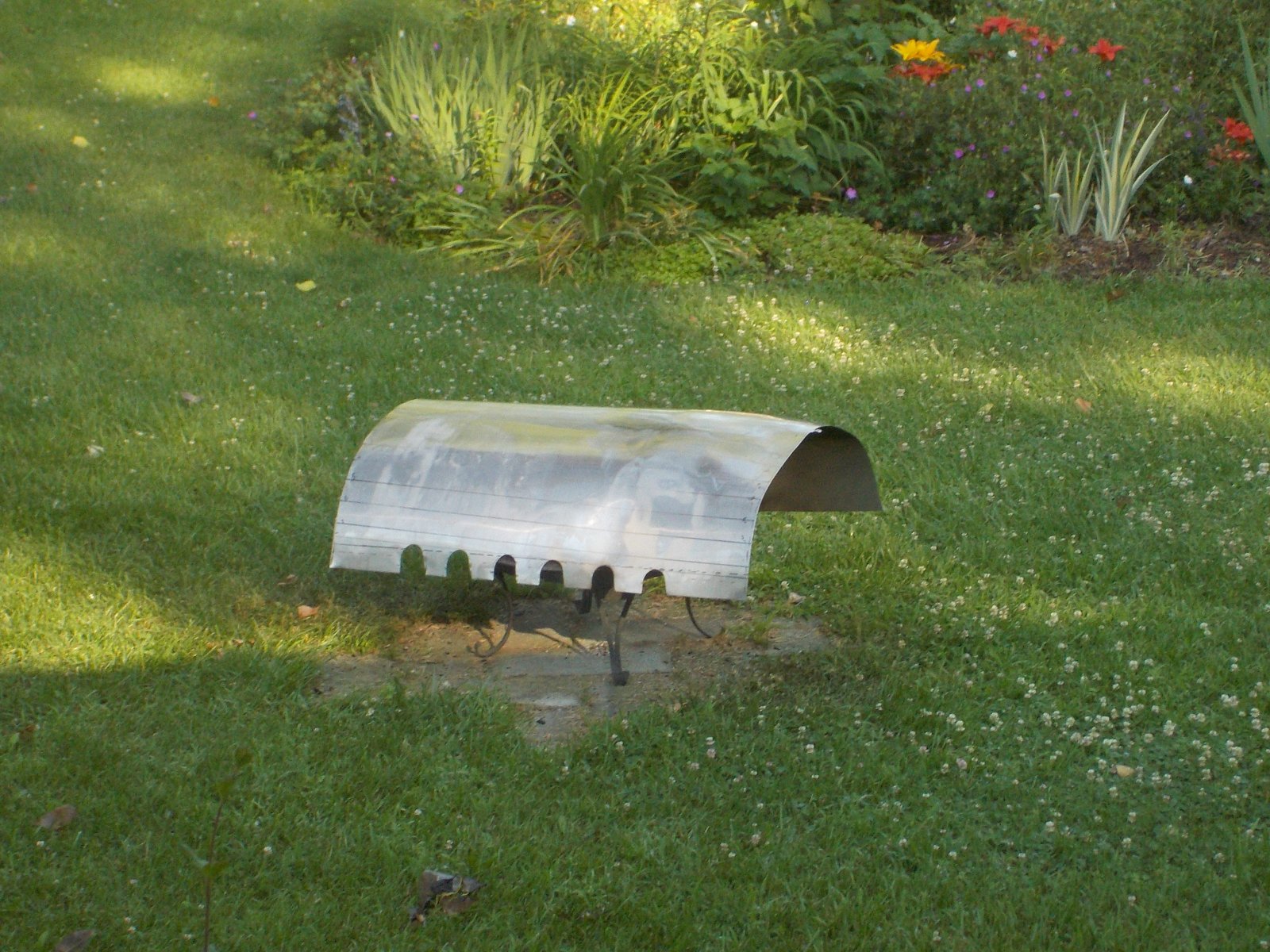

    Well I tackled the domed hood.
    Results: not so good.
    I did not get a consistent dome. I am hoping to do more work on it. After watching several youtube videos I decided to see if I could get the proper shape by just E-wheeling it. I haven't given up - just stopped after about an hour of wheeling. The only part I was satisfied with was the part circled in red. I hope I do not end up having to pie-cut and weld. I may have to start over if that is the case.

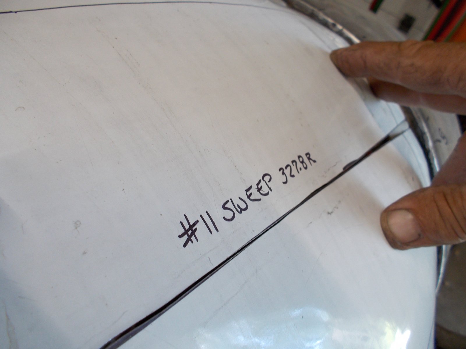

    Well, after working it under the E-wheel some more I am starting to like the results.
    This was an interesting aspect of this car project. From doing this hood I would like to share some Lessons Learned from making a part this big.
    Lesson 1. It would have been easier to make the hood top in three sections, then weld them together. A piece this big barely fit into my E-wheel and it did not fit into my planishing hammer, meaning lots of hand hammering was needed. Three pieces welded together would have been easier.
    Lesson 2. Get a friend to help hold the panel under the wheel. It was unwieldly at first, but as more shape was formed into it the stiffness increased and made it easier to roll through.
    Lesson 3. Anneal it as it work hardens. The sooty acetylene method works, but so does slow roasting it on a fire. I will probably anneal it one more time before final planishing and paint.
    Lesson 4. It looks HAWRABLE!, HORRIBLE!, Horrible!, horrible!...and then it doesn't. Progress on an E-wheel happens exponentially. Don't quit.

    In the mean time I polished up a latch handle to a higher luster. It went well, must do the other three.

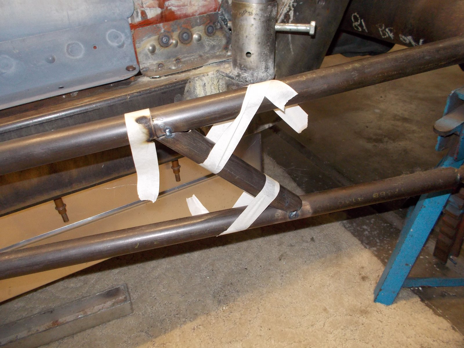

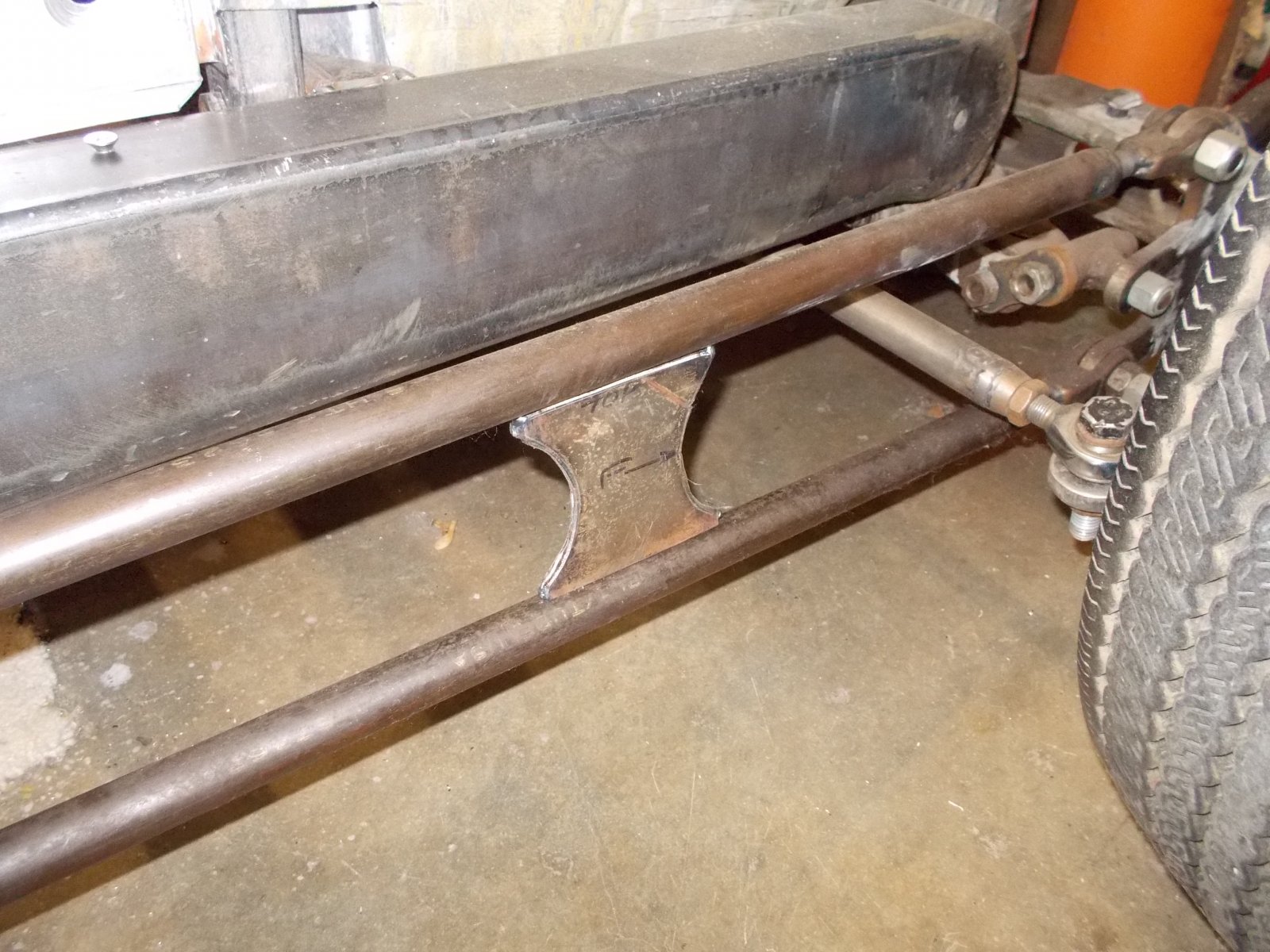

    If the devil is in the details this project is full of the devil.

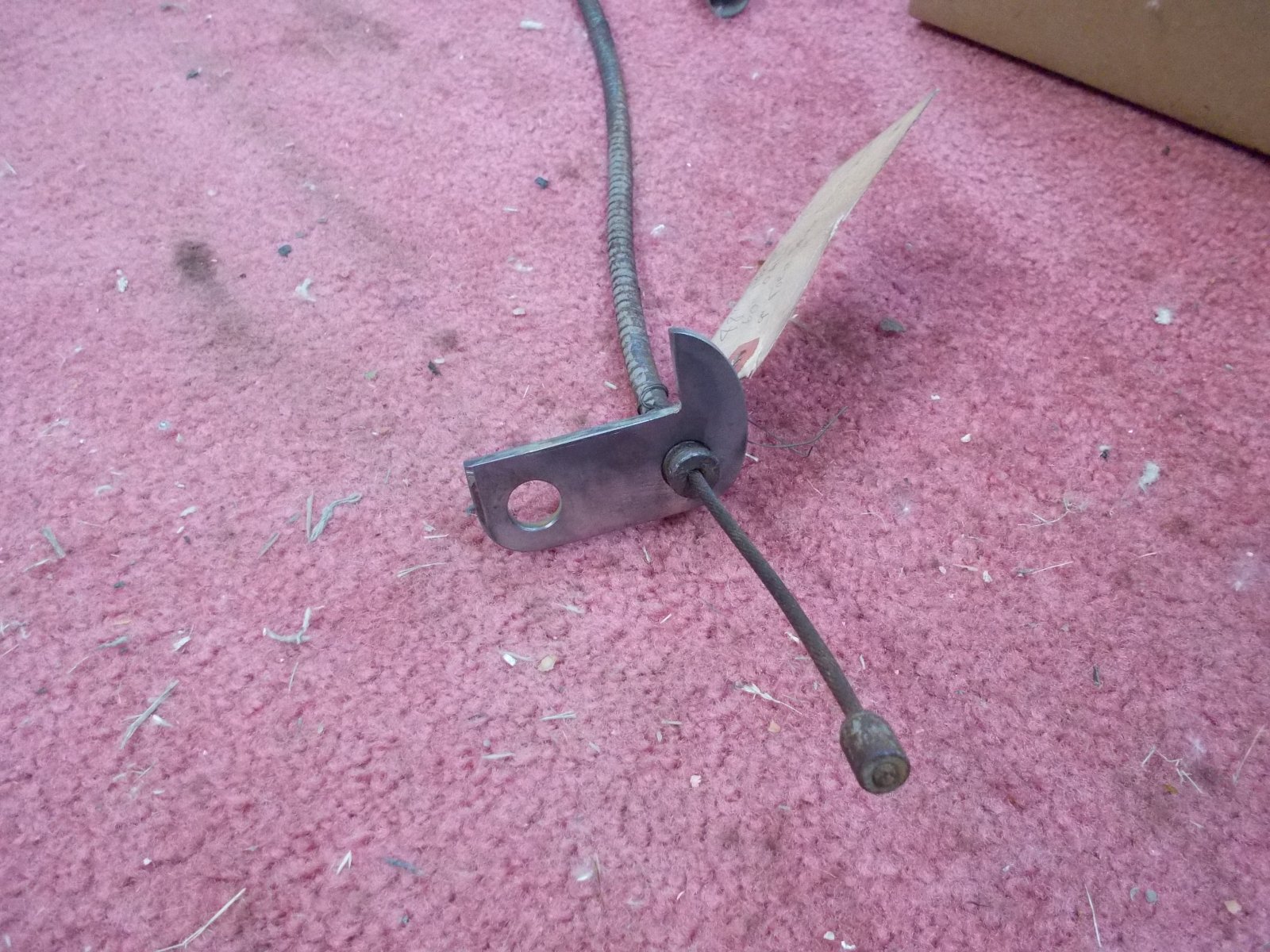

    I made a bracket to hold the rear brake cables. These will be used to drift the car on the track. It gets welded on under / inside the frame.
    Then I triangulated the rear radius rods and roughed out the spacer gussets for the front wishbones. Sometimes when I need an extra hand to hold stuff I rely on masking tape.

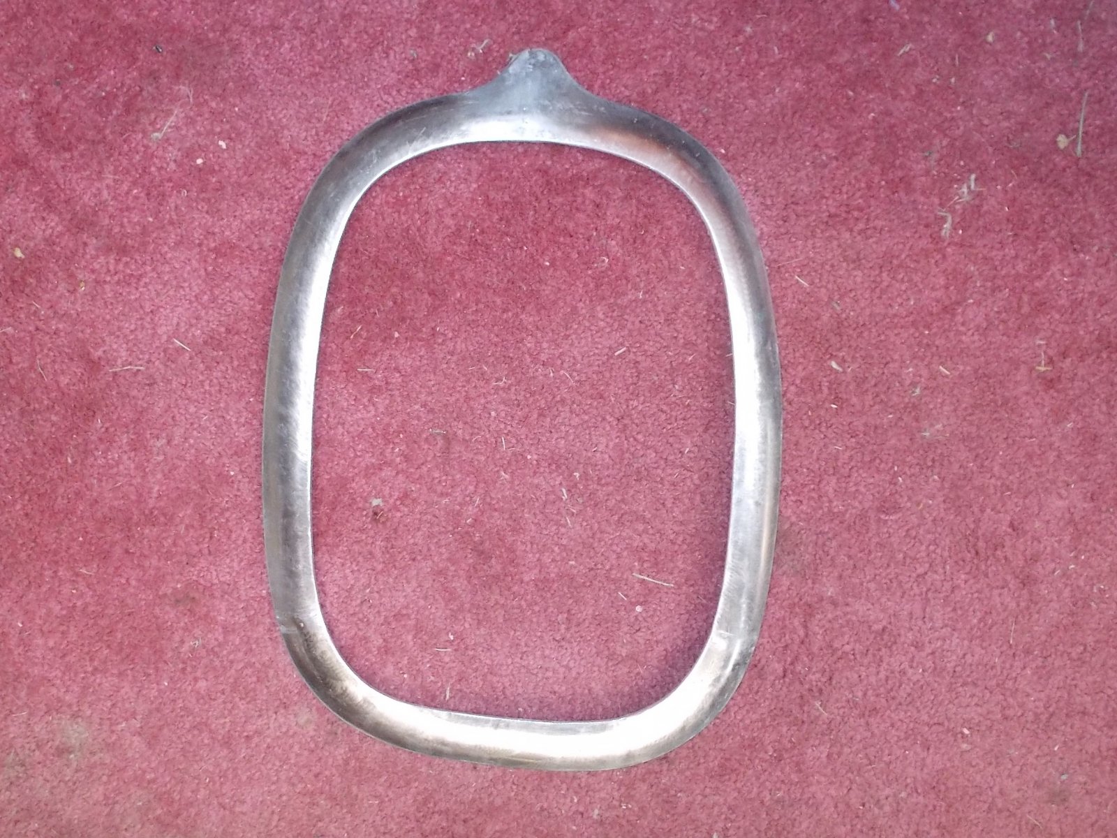

    I made a paper pattern. I want to put some crown in it. I think I will try to make a press die set from hardwood, since it only has to shape 1/8" soft aluminum, one-time use grille 01.JPG grille 02.JPG grille 03.JPG .

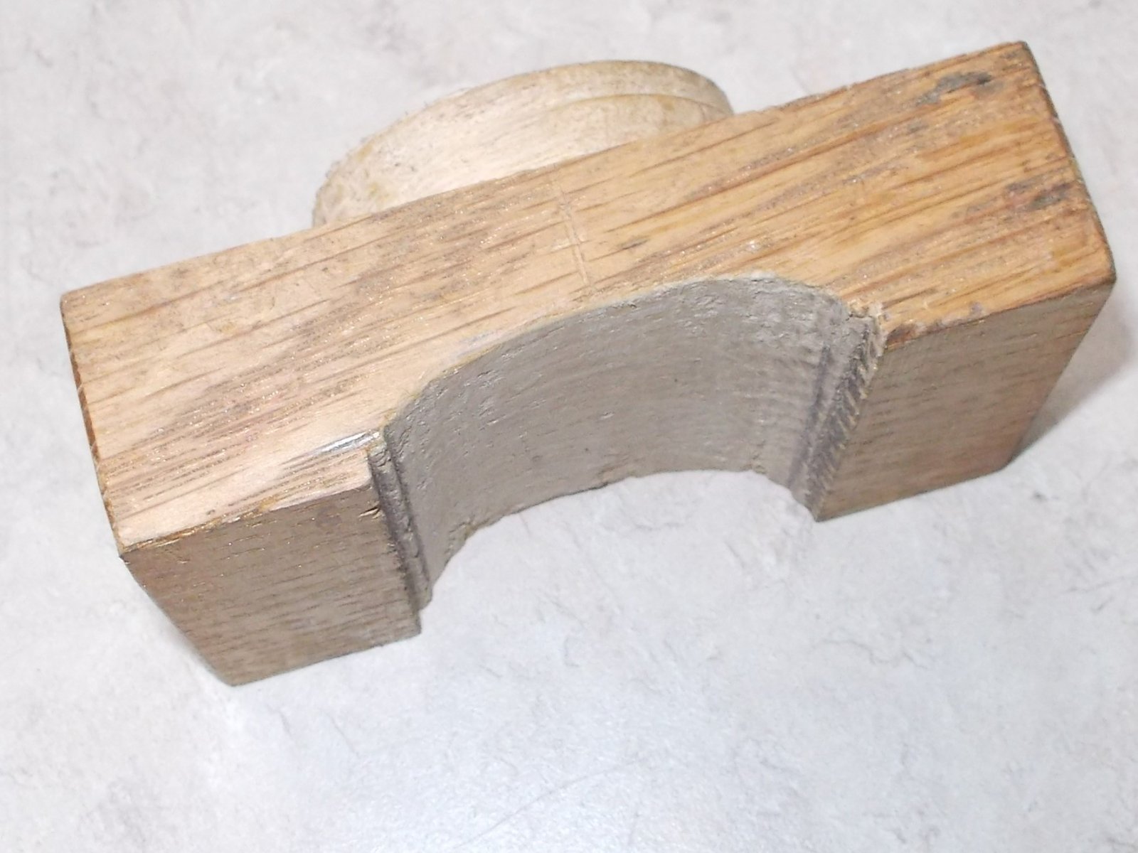

    I made the die set to put a crown in the grille surround. It doesn't show up real well in these photos but it should enhance the appearance of the grille if it works. My biggest concern will be getting it to work going around the corners; further mods to the die may be necessary. I also plan to put a small scallop at the top of the surround to possibly carry a monogram or name or number.

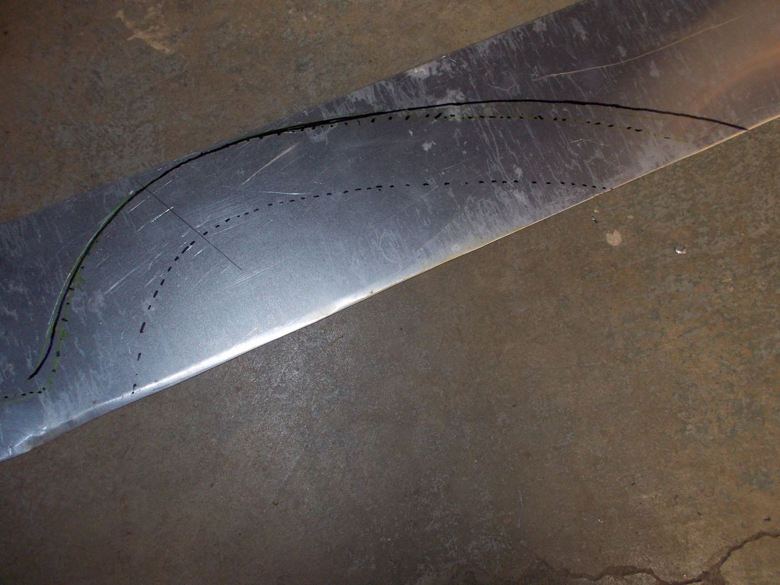

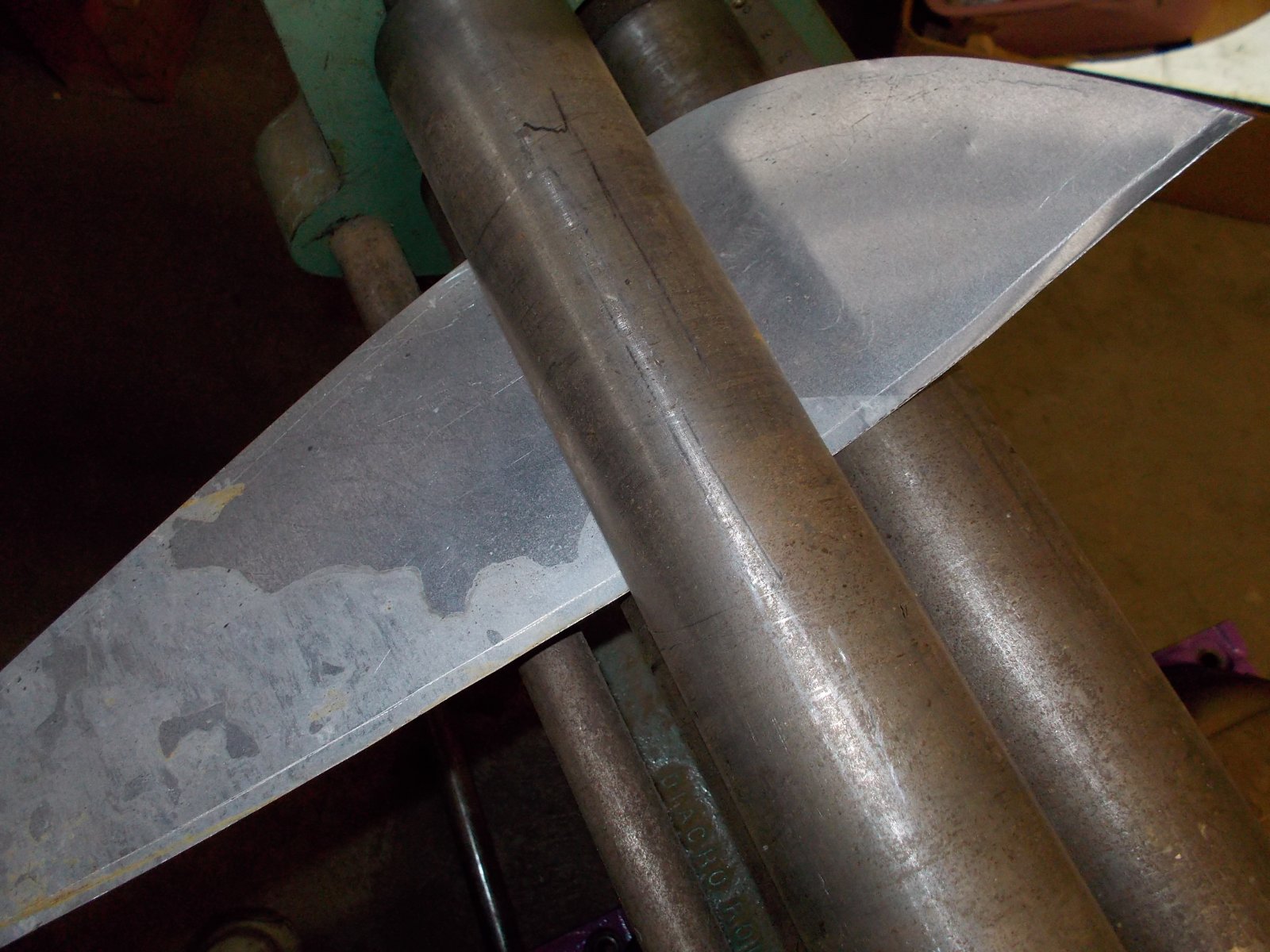

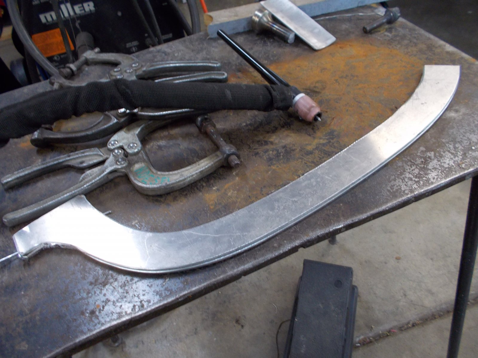

    More work on the grille shell. I laid out the flat pattern on metal shown by the dotted lines. Then since the part was going to be somewhat conical I eyeballed a straighter pattern to allow for me to roll some conical shape in it without shrinking or stretching too much - shown in solid black lines. Cut matching sides; put some crown in the pieces with my new dies and welded the two together. I had to weld a bit of metal between the two to get the right shape. Done for today. Stay tuned...
    grille 09.JPG grille 10.JPG grille 11.JPG grille 12.JPG grille 13.1.JPG grille 13.JPG grille 14.JPG grille 15.JPG grille 16.JPG
