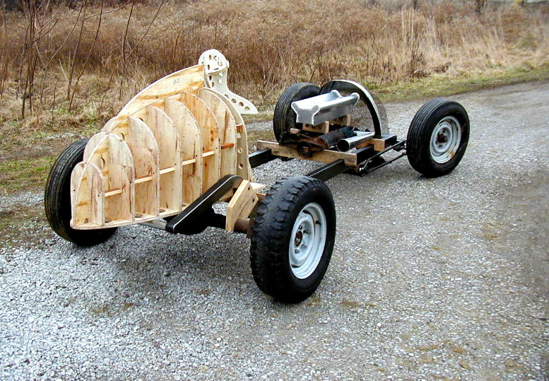

    I started the rear half of the body this week. It will have a head rest - I have seen photographic evidence of headrests on cars as early as 1934.
    I was going to use a Whippett style grille but I think I will use a track nose instead.
    OleDon, The crossflow head is an extremely rare prototype. It was never put into production. I hope to make it look old with a lot of copper and br*** tubing and fittings, reminiscent of an old Duesenberg straight 8 factory "crate" racing motor. I want to mount a dummy "crab" style flat distributor cap off the front of one of the cam towers with old style 7 mm orange plug wire and Rajo clips on the spark plugs. (Note: Does anybody have a worn out crab style cap they would like to donate?)

    ne**ussian, An outboard bearing will be attached to the hoop that holds the box.

  4. Nice bucks and sheetmetal work.

    It's almost to the point where you can sit in it a make your most convincing car noises.

    what rear end did you use?
    and what front?
    i was looking into doing this or a SportRod type build but i would like the front and rear axles close to the same track as possible...
    i have even thought of going to Posie's for a front superbell type and gasp! a sprinter rear end from Speedway...
    48 inch width front Pin to pin is as wide as i have seen and most rears hub to hub are at least 56"- am i missing something about the balance here- would spindles push out the track a few more inches?

    Fiorano,
    I used a '56 Ford pickup front axle.
    Narrowed 6".
    Perforated.
    spring pads removed.
    The rear end is a 9" Ford roundback from an '81 Bronco.
    I may graft on a quick-change center section for the look - except it will be all but hidden by the rear bellypan.
    The stance looks "about right" to me.

    its the rear that i am having trouble matching to an "off the shelf" front end from like speedway or Posie's why would i go this way- because i think its safer

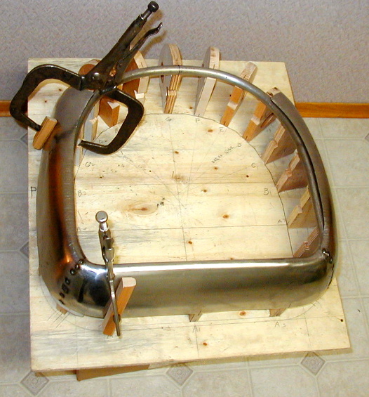

    I built a buck to make the nosepiece:
    I used pieces of an extra pair of fenders from my '46 custom pickup push truck to shape the nose:

    you do some really nice work , that intake manifold is cool , keep the pictures coming

    I did a little more work on the nosepiece. The fender sections from a '46 truck were so hard I could not work them, so I built a roaring brush fire and threw them in for a few hours. That annealed the steel so I can start to stretch and shrink them. Here is how far I got in an hour:

  25. People like you make this look easy!
    I'm so in love with this car I can't wait to see more.
