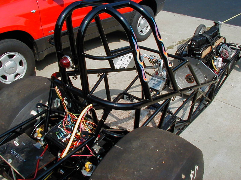

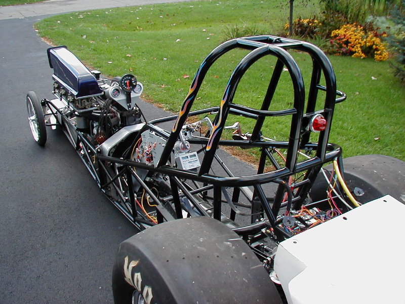

    I did a similar switch panel on my drag car. You can see it through the roll cage on the left side.

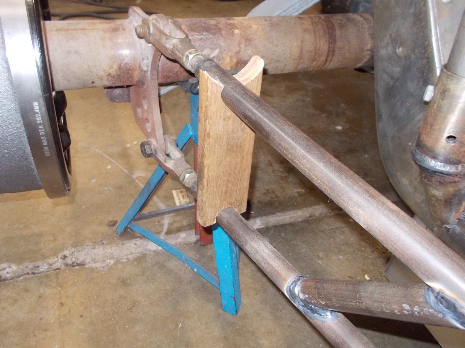

    In order to keep the hairpins from warping I made these hardwood spacers to hold them in alignment, making re***embly easier. After welding the hairpin slipped right in.

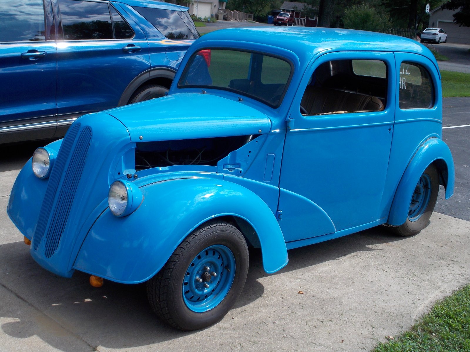

    I'll take a short break on this project to turn my attention to my Attic Anglia. The engine for that car is coming from another donor car - this Anglia. This week the engine gets pulled from this Anglia and replaced by a much stouter 303 ci Ford six. That leaves me with a complete, running 243 ci six for my little beast. The 303 is a real stump puller, what with a 4" stroke but the 243 likes to rev to the moon with a cam and head work and a stroke of only 3.18". Very fun to drive. Additionally its crunch time at my local drag strip and I'll be racing for a spot on the NHRA Division E.T. finals team.

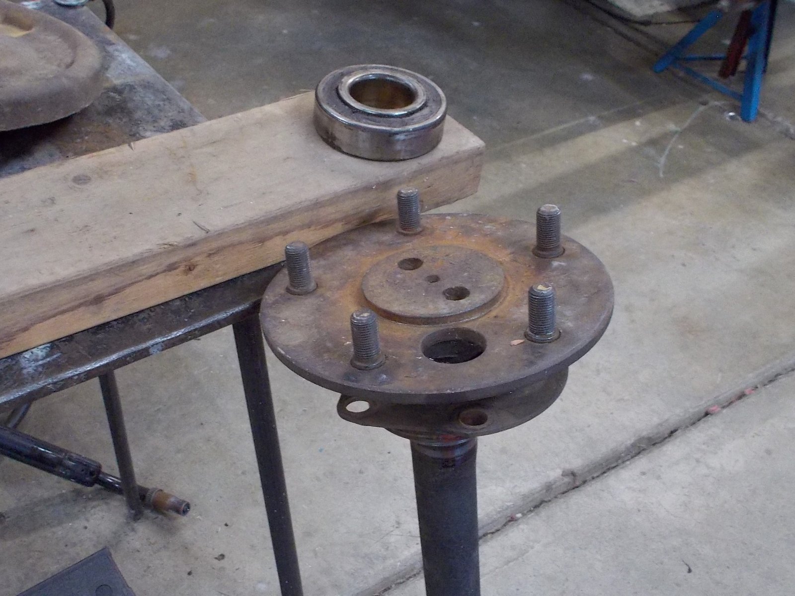

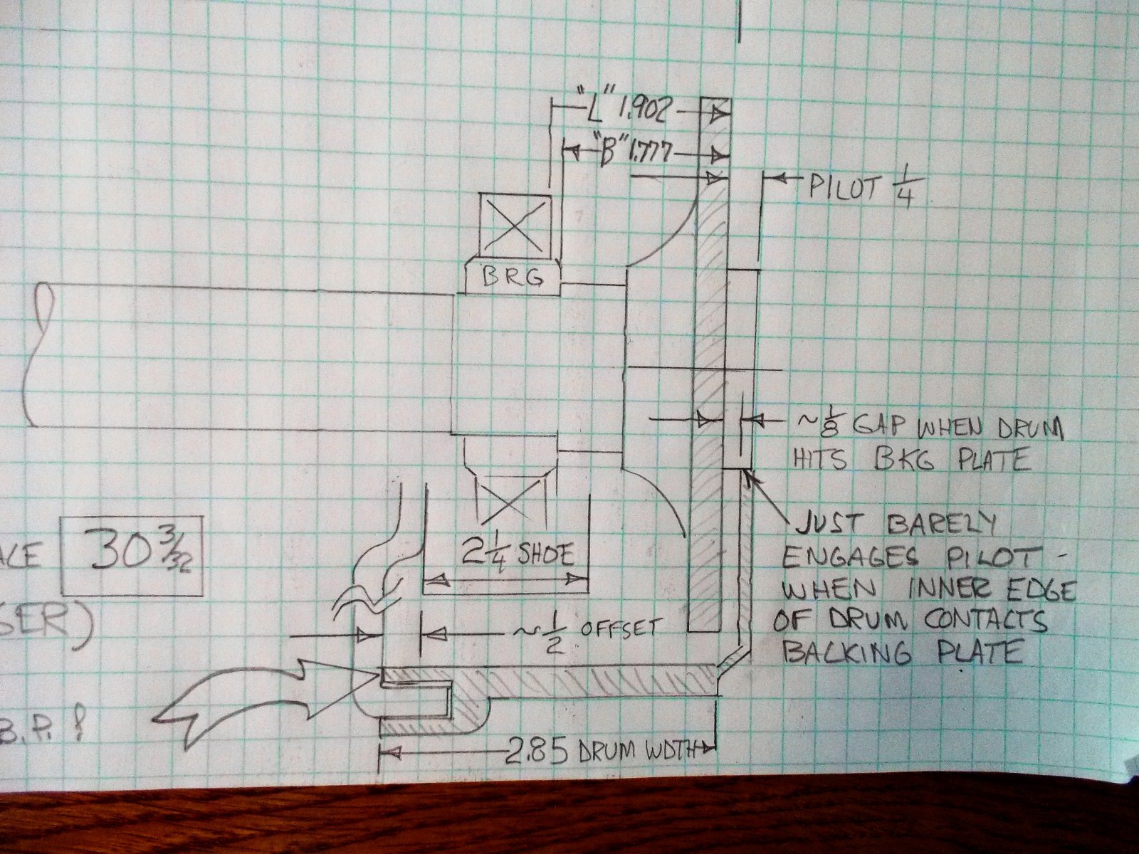

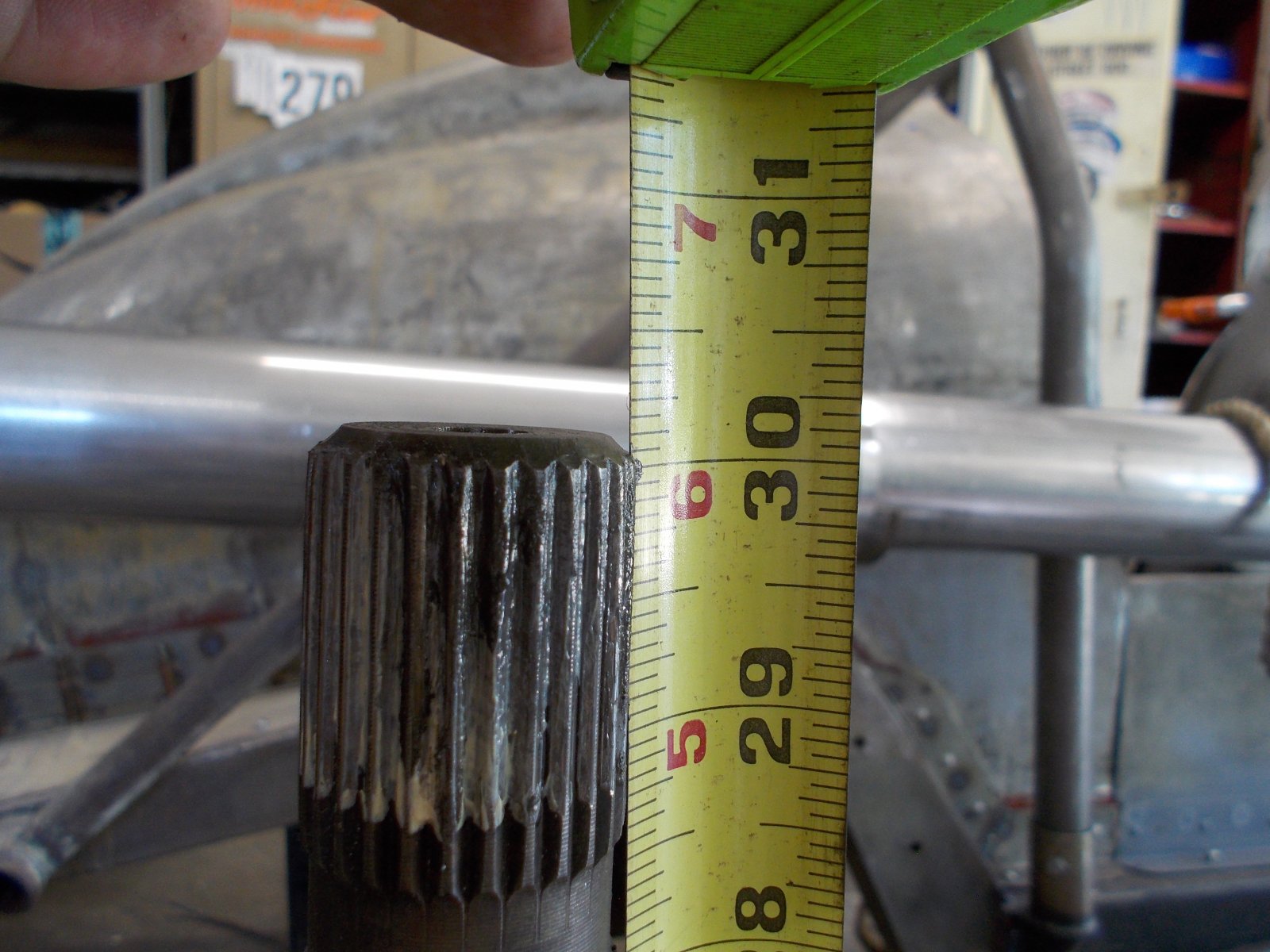

    I heard back from my axle supplier. Without boring you with details an exact copy of my old axle is not going to be possible to build. Some concessions are going to have to be made to get a new axle shaft. The supplier is genuinely interested in helping me out but for now until I decide what I want and need back there I am stalled at getting a replacement shaft. I'll dis***emble my brakes and the other side axle completely so I can fully transmit my needs and dimensions to them.
    One thing that concerns me is I built the single axle trailer to the exact width needed for the track width of the car. Moving the flanges outward a fraction of an inch, combined with the fact that my Dayton wires also will need a spacer to adapt the knock-offs to the 5 x 5.5 BC also adds width to the rear track. If that's what it takes so be it. I'll add width to the rear of the trailer ramps. Sigh

    Yes it is, and hopefully there is a solution on the way. I re-***embled my axle with the new brakes and the original axles and carefully measured all the critical dimensions. After talking to the tech experts at QP I have two new axles on the way to go along with the new 2.25" brake ***emblies. Not only will I now have increased stopping power I will have axles with known history (none). On close inspection even the axle on the right side showed shoddy machining on the splines from Ford (gasp!) and lots of spline wear. I feel safer with new axles.

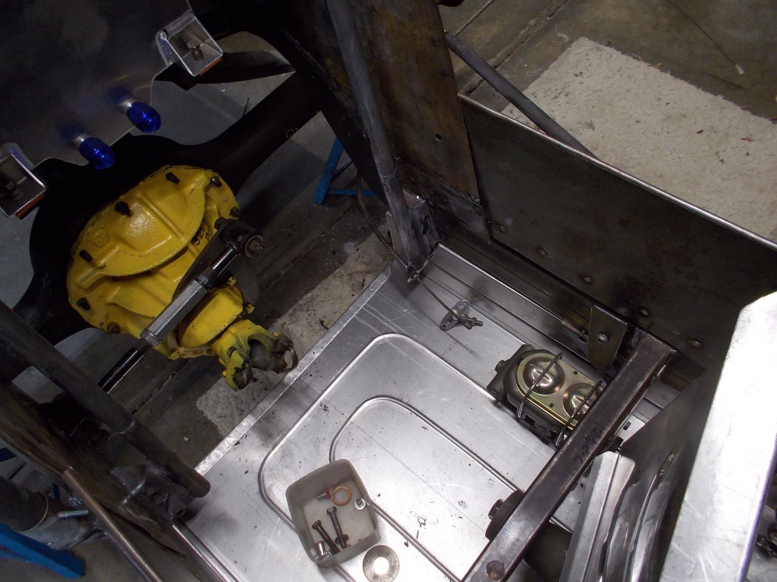

    While waiting for axles I did some work on the rear braking feature. I thought about putting the tab to hold the cable ends on the frame but it worked out better to weld it on to the bottom of the shoulder harness hoop. Then a little bit of linkage with an equalizer bar was needed.

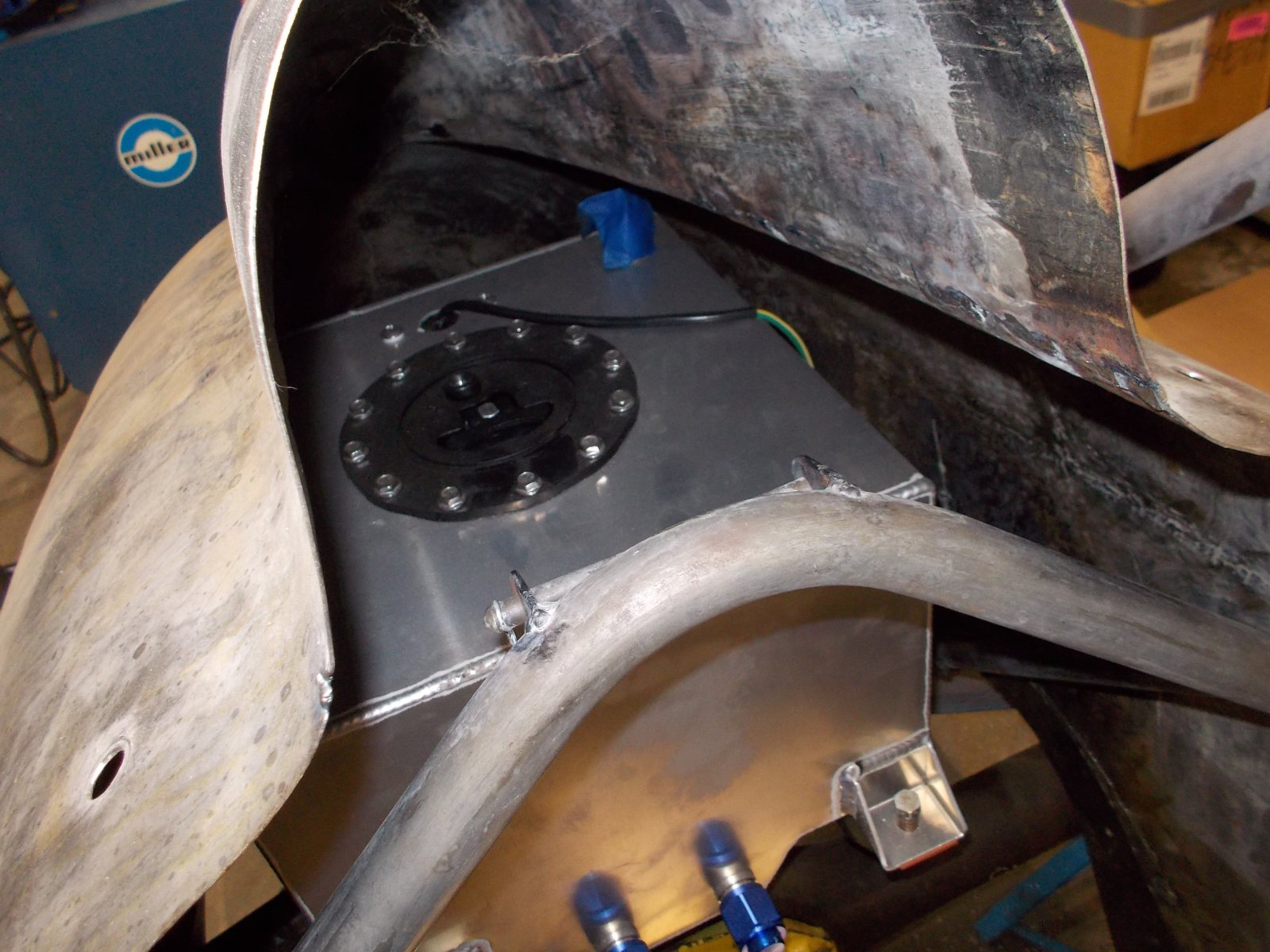

    While I was poking around back there I reconsidered how and where to put the gas tank filler tube. It looks like there will not be enough room to affix to the original opening since I do not want to place the cap on the head rest fairing and spoil its lines. The cap will be placed just behind the roll bar on the left side of the bustle. I'll fab a tube to weld on the upper left corner for the straightest shot at the cap possible.

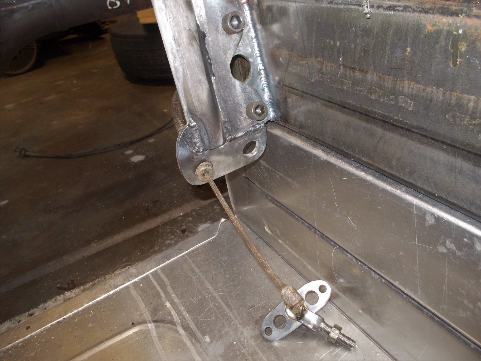

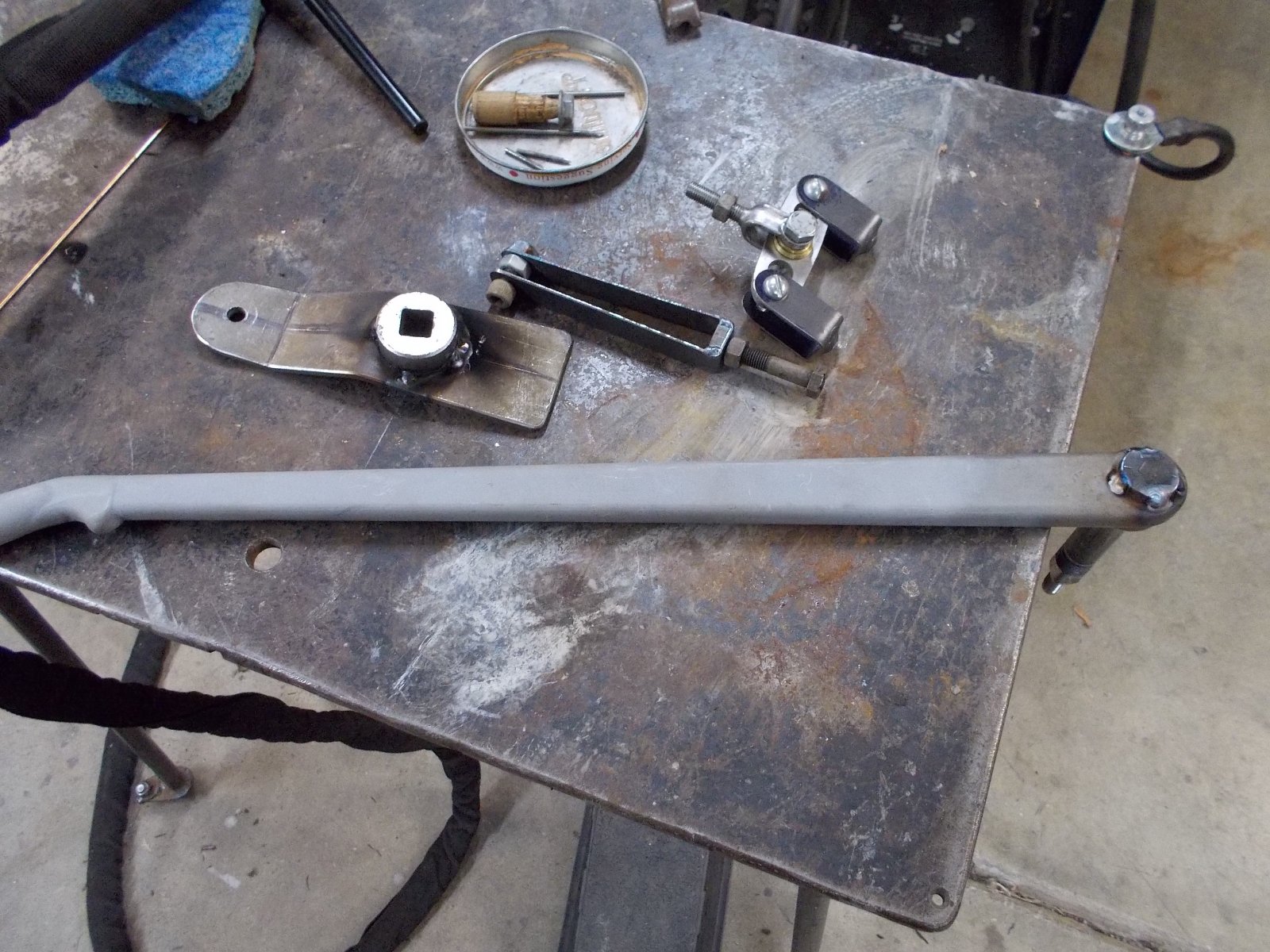

    I have sufficient parts to be able to re***emble the seat and get in the car to locate the hand brake handle and set all the pieces so that they are clocked in the proper position for welding. I welded all the little bits up to make the brake handle functional.

    Thanks Dave. I have a hand brake in a couple of my drag roadsters and find them to be more precise and give a good feel for fine applications. Those operate a hydraulic cylinder. This will be totally mechanical.\
    I painted all the components and made some cable ferrules which I will swedge and TIG when the cables are cut to length. I had some electrical shrink wrap that I fitted up to the brake handle. I like the finished look.

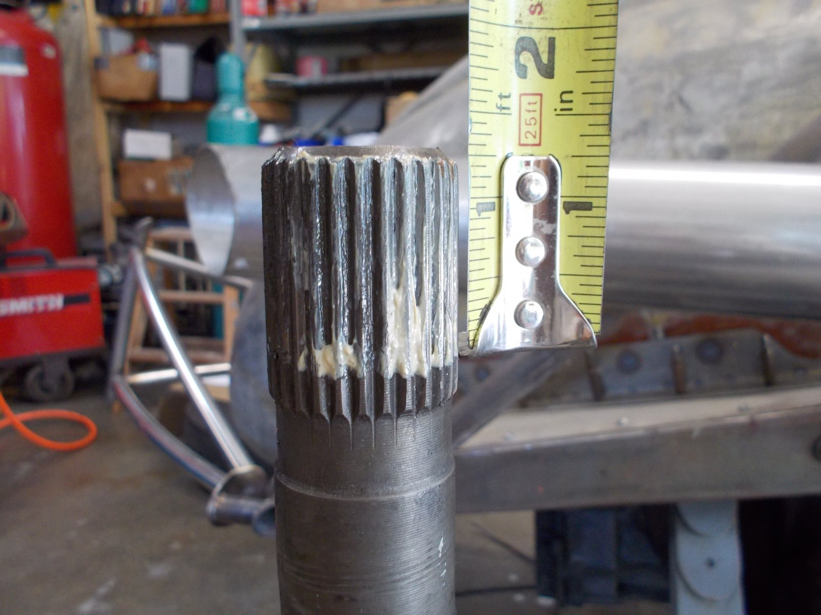

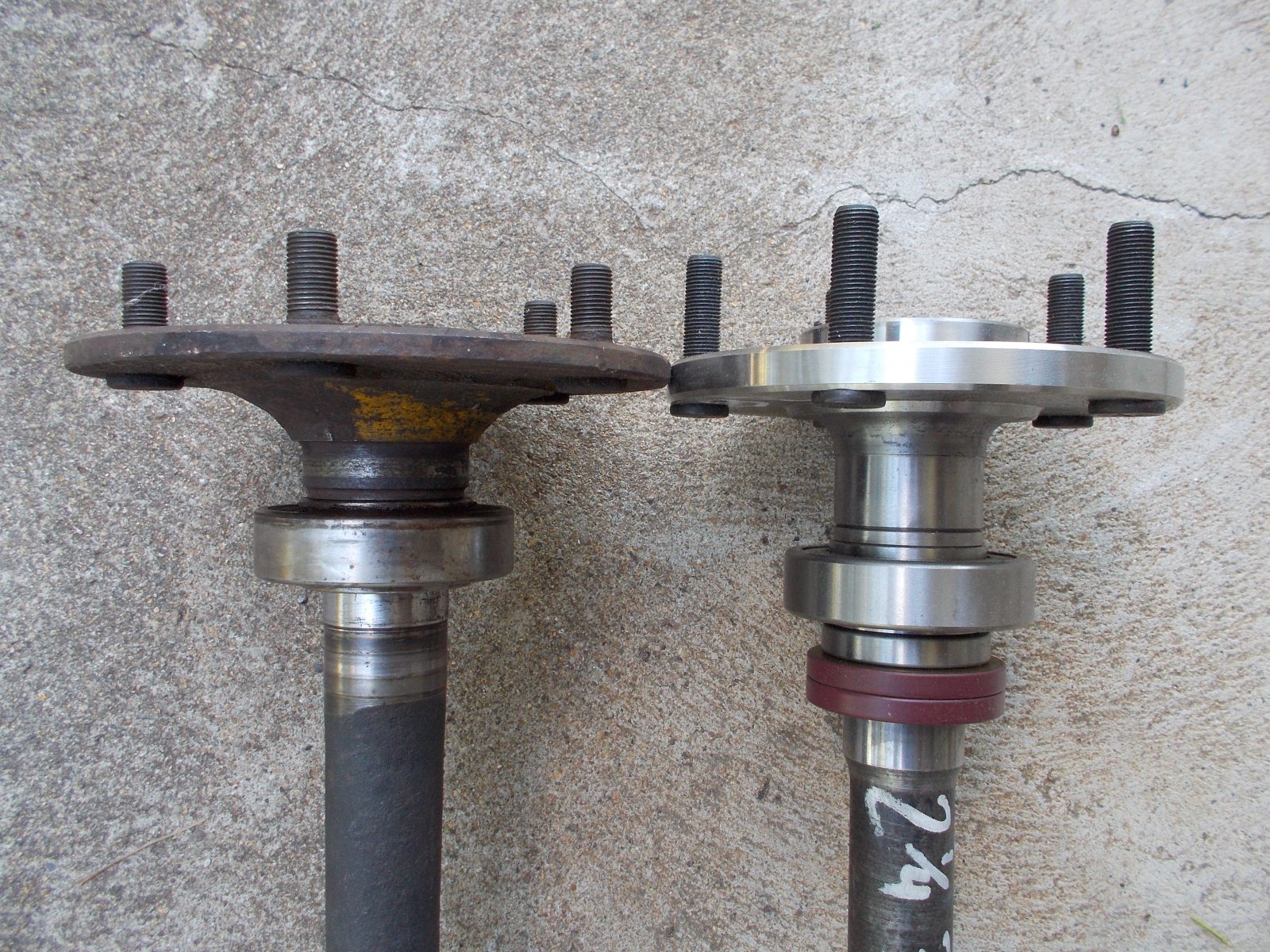

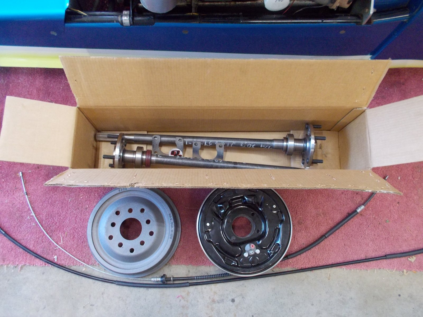

    I went to Indy to drag race this past weekend and when I got home my new axles had arrived, as did a new E-brake cable. Now I have the task of ***embling the rear end. For sure the cables will need modifications at both ends of the cables in order to make a matched pair that will give equal braking to both rear wheels at the same time.

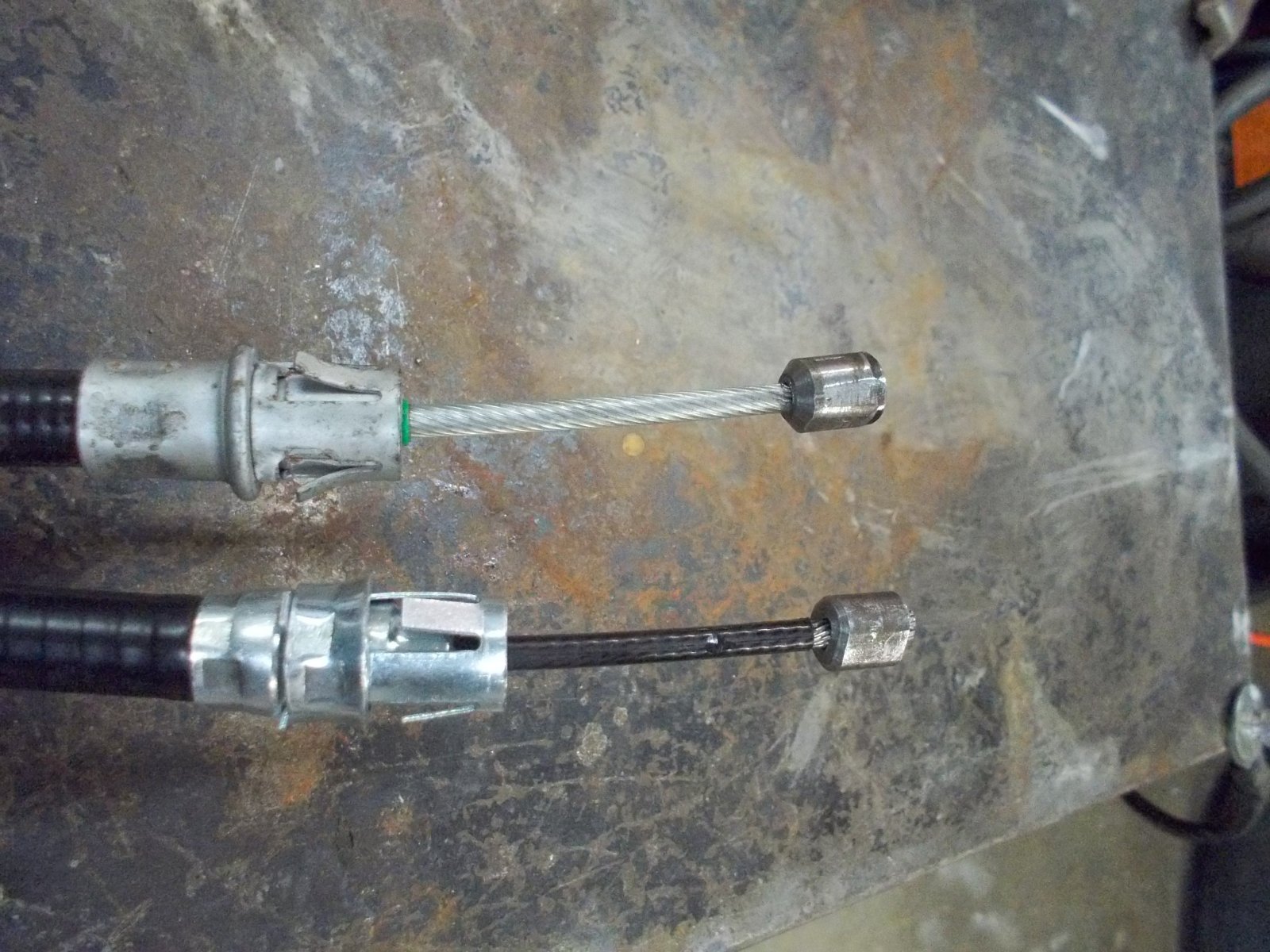

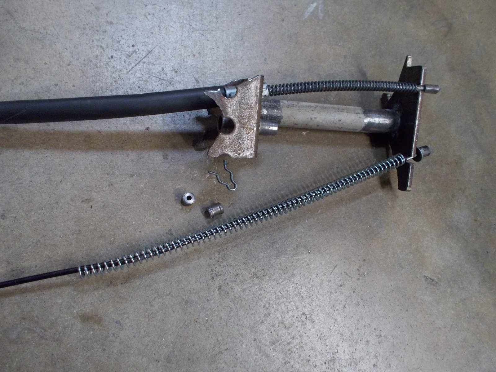

    I had ordered two mis-matched E-brake cables that had the proper housing length. I knew the ends needed to be modified to make them compatible with my brakes. For starters, I turned a housing end to match my backing plate.
    Next I made a single-use fixture from metal s****s to position the cables in the same relationship as they will be inside the brake drums. This will save me from having to dis***emble the brake parts several times to measure up other mods needed. One return spring needed shortening.
    On the lever end the cables got shortened and new ferules were made and swaged on to the cable. For insurance, I then fused and welded a nugget of metal on the end of the ferule to insure it would not pull off.

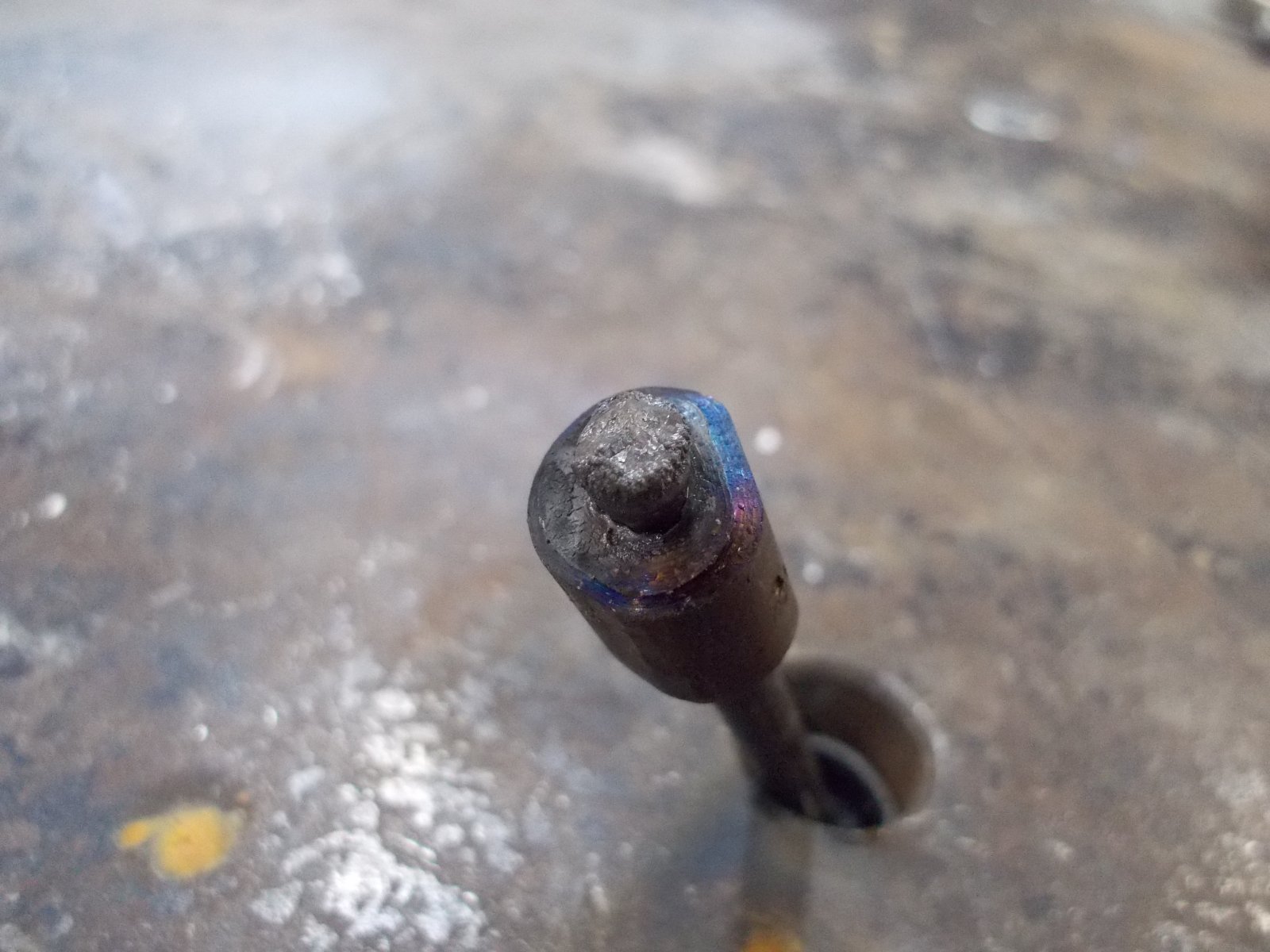

    Rustoleum 2000* brake drum paint is ordered. While waiting for it to arrive I wanted to knock down some of the sharp edges on the drums. So I took one of the old axles and bored a hole in a plank to receive the axle shaft. That allows the drum to spin as the grinder smooths things out. I'll save the axle - it may come in handy to mount a wheel for pin striping rims.

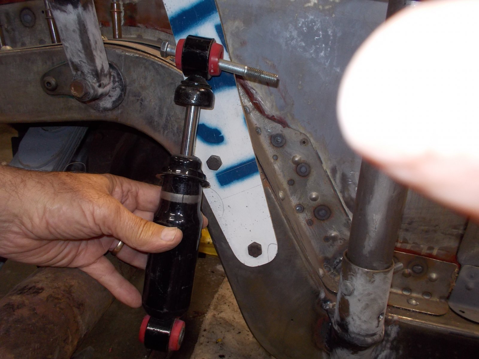

    I ordered some generic shock absorbers for the rear axle this evening. They have neoprene eyelets on each end. I am wondering what the best orientation should be - mounting bolt parallel to the frame and perpendicular to the axle... or... mounting bolts perpendicular to the frame and parallel to the axle? I know spherical ball ends would be best, but trying to go easier on the budget with bushed ends. In one position they will bind with axle rise and in the other position they will bind with axle twist, both of which will be happening.

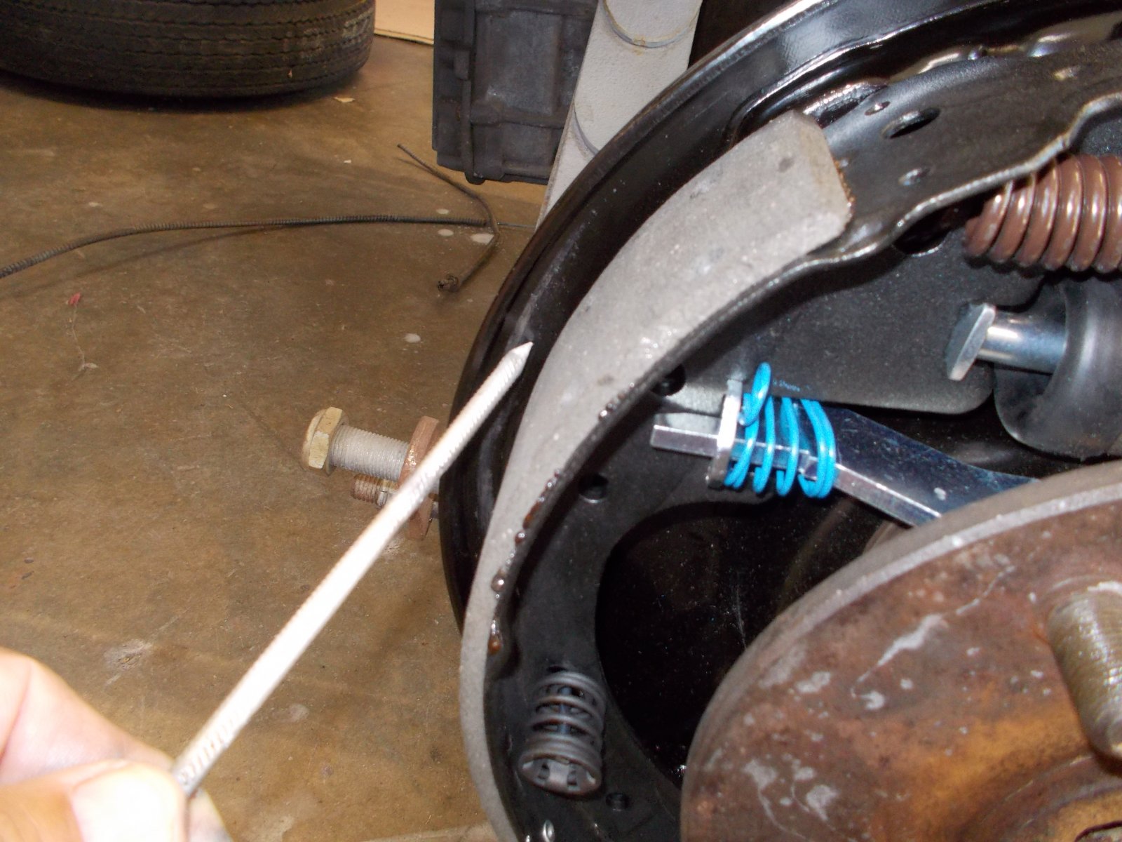

    I also ground an acute sharp edged angle on the adjuster pawl to insure positive engagement with the star wheel adjuster.

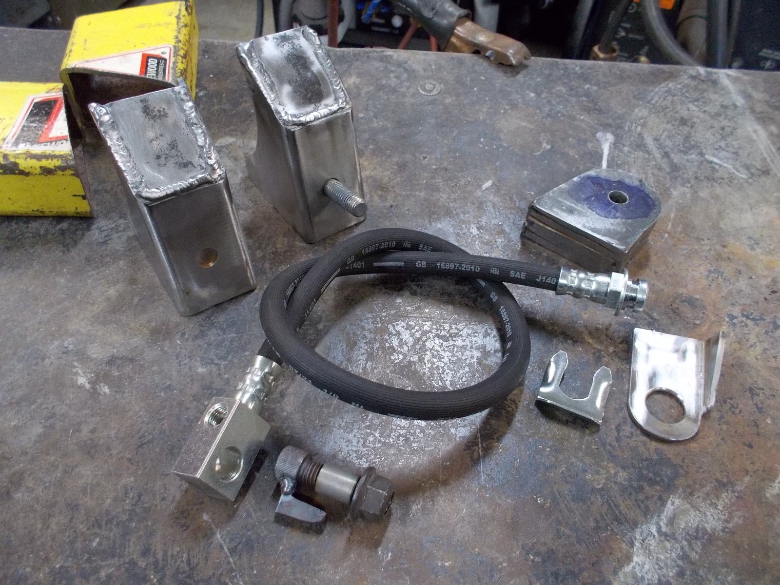

    My brake hose arrived too. I need to make a mounting tab and a 3/8 weld stud.

    I made a bunch of brackets and tabs in preparation for doing the brake lines and mounting shock absorbers. When I welded up the frame rails I installed weld nuts inside the frame in anticipation of using them to mount the shocks. My initial plans were for lever shocks, and I may still go that way if I find a suitable pair to use. But until then I needed a quick solution to rear shocks so I ordered a pair of tube shocks. The brackets I made are generic enough that they can be used for either lever or tube style shocks. The brackets were hacked out of leftover pieces of Lakewood traction bars of suitable size. I mocked up the approximate locations using a shortie shock I had on hand.
