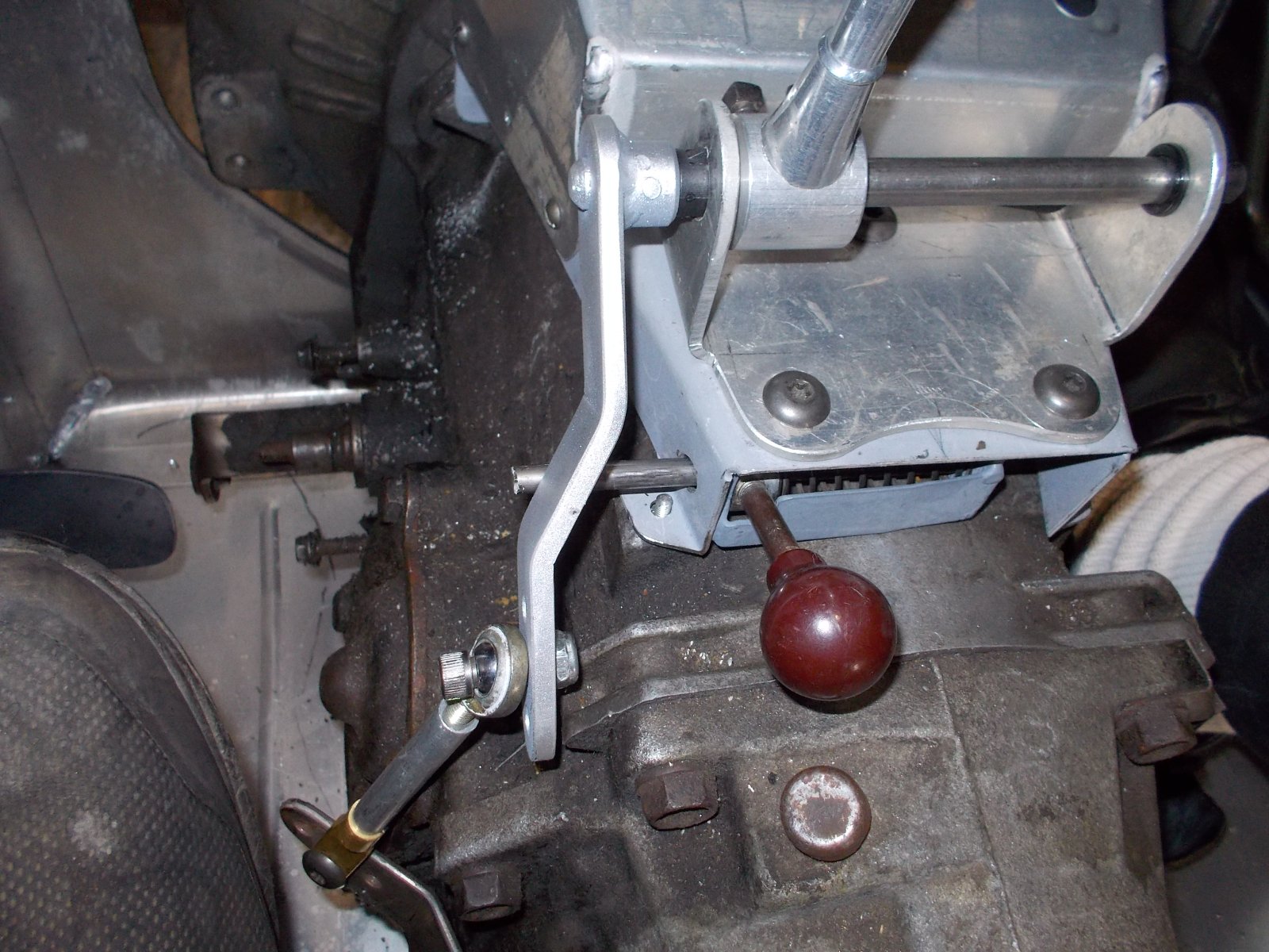

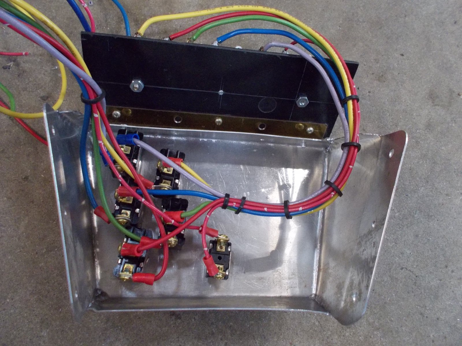

    A few more details got done on the shifter / console.
    Four SPST switches came in and got mounted. I made a copper buss bar that connected all the fuse sockets.
    The reverse lockout and reverse arm were cut and bent to their correct size.
    The reverse lockout with the gear shift in the R position:
    When they are mounted on the trans they are hardly noticeable, which is what I want, yet accessible by the driver.

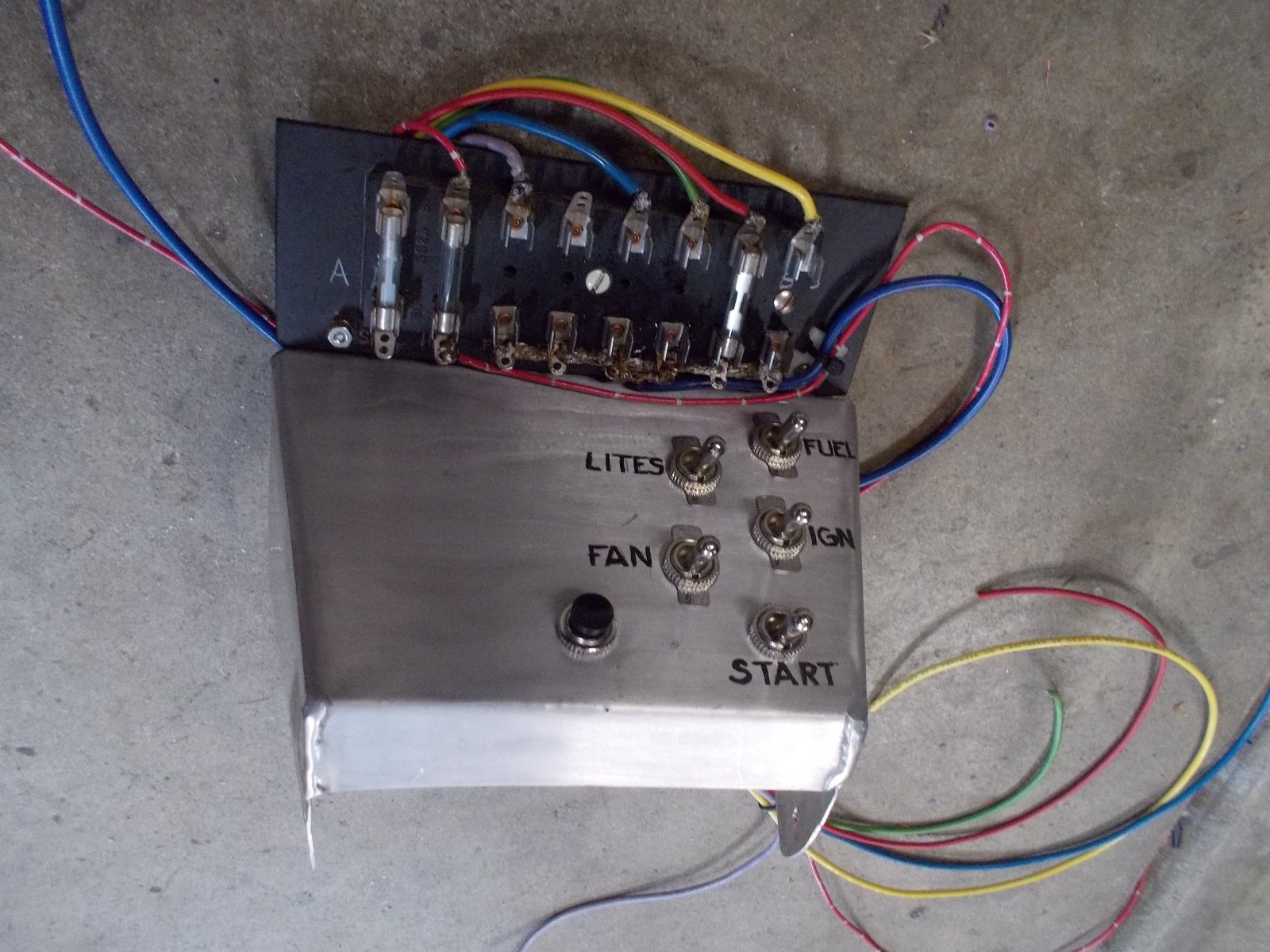

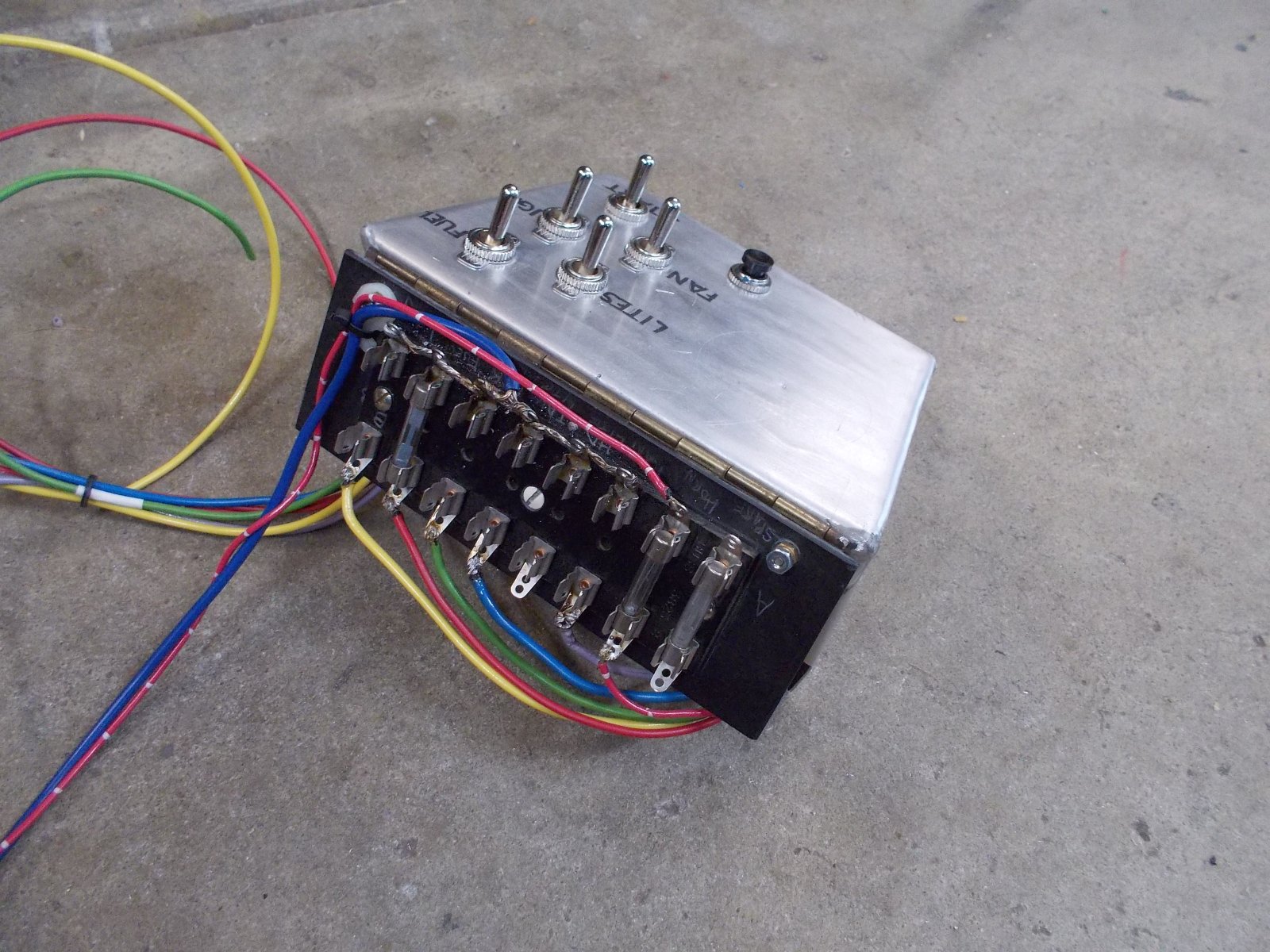

    I wired up the console module. In addition to the other switches I installed a momentary toggle switch for the starter motor. I also installed a horn pushbutton that is powered off a separate (red w/white dot) feed. That feed will bypass the inside master cutoff switch (blue #12 gauge feed), being only armed through the exterior master shut off switch (Bozo's nose). That way I can see if the exterior switch is armed with a tap of the horn. Still need a voltage gauge and labels on the fuses.
    (Tech Tip: SBChevy valve stem seals make good wire loom organizers.) shifter 29.JPG shifter 30.JPG shifter 31.JPG

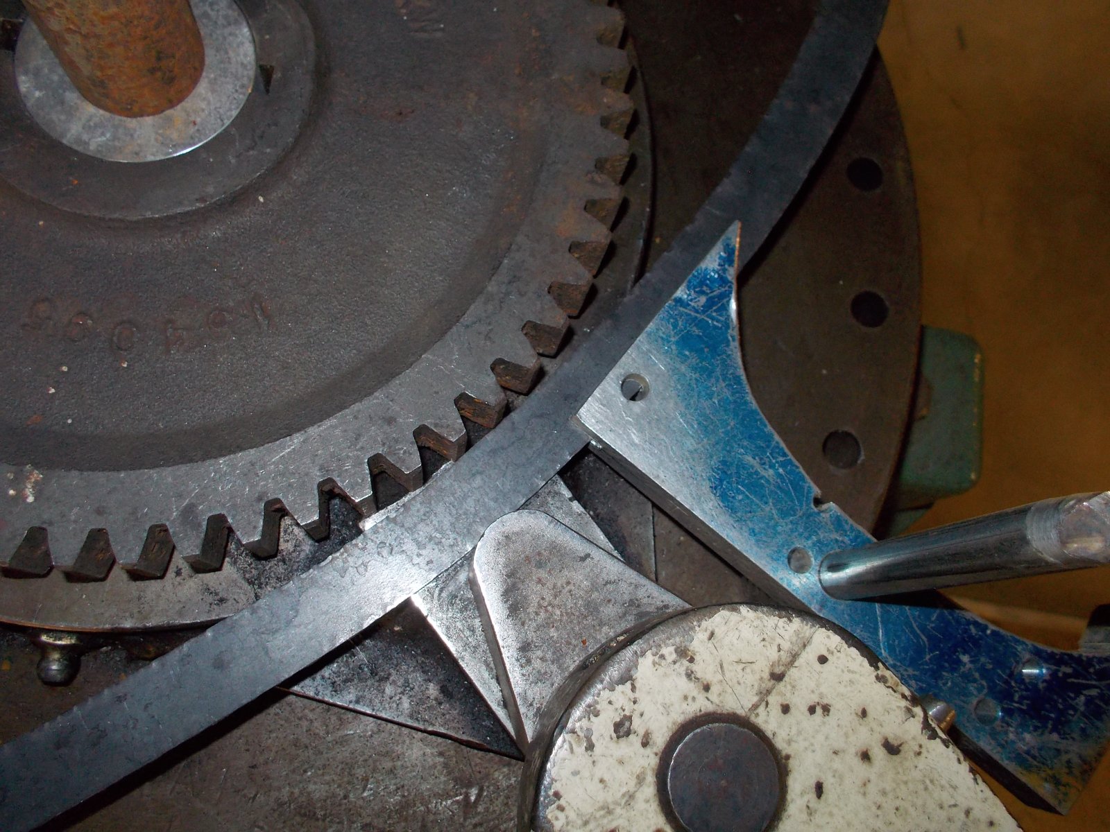

    I now have to address mounting the dash panel. This presents a dilema on how to make the flange that the dash screws into.
    A) Do I cut it out of a piece of flat sheet stock? This would mean lots of band sawing or plasma cutting with most of the blank stock being scrapped.
    OR
    b) Do I figure out a way to bend flat strip stock on edge, to follow the curvature of the cowl section? This saves material and cutting time but means building some single-use tooling.
    I decided to see if I can get strip stock to bend on edge. Starting with an old tractor gear I made an arbor and bushed the gear hub to fit the DiAcro bender. This will be the bending die. Then I milled a slot in a scrap piece of 1/2" thick aluminum to use as a shoe to hold the strip stock. I made a pivot shaft for the shoe and by a happy accident I discovered the left over tail serves as a ratcheting mechanism, so I can feed-and-pull, feed-and-pull, forming a gentle curve. I made a curved sample piece to confirm proof of concept. Tomorrow I will try to bend a piece of 1/16" thick 4130 strip into the correct arc to fit the car.

    After bending the panel anchor strip edgewise into a curve it soon became evident that I had to come up with a way to fix it if I overbent it. I used a chunk of aluminum with a slot milled in it and used it to hold the strip after locking it in the groove with a piece of square key. The hydraulic press could then press out some of the curvature.

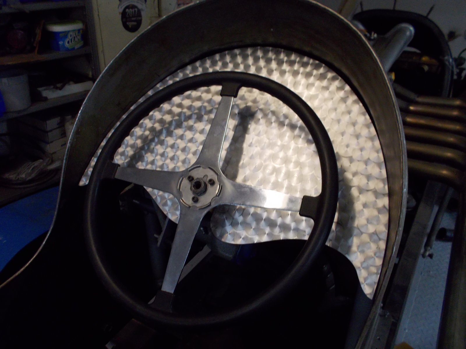

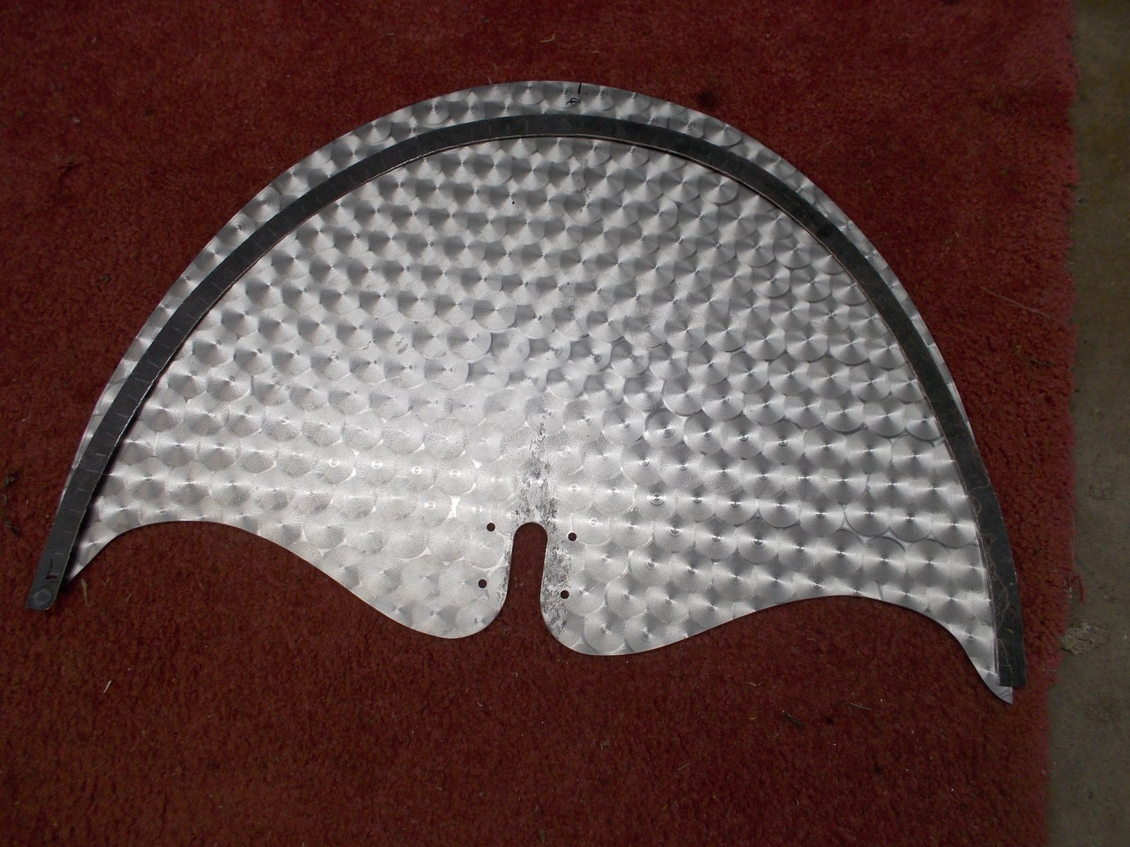

    The hoop has its final shape. Tomorrow I will MIG stitch it on to the cowl. I'm a little nervous about burn-through of the cowl so I chose MIG over TIG for that reason. Besides, some welds are upside down (overhead) and I don't have good access to do that with TIG. I may go back over the MIG welds with TIG, to knock the weld beads down out of sight.
    Then I need to figure out how to precisely drill and tap the panel and the flange.

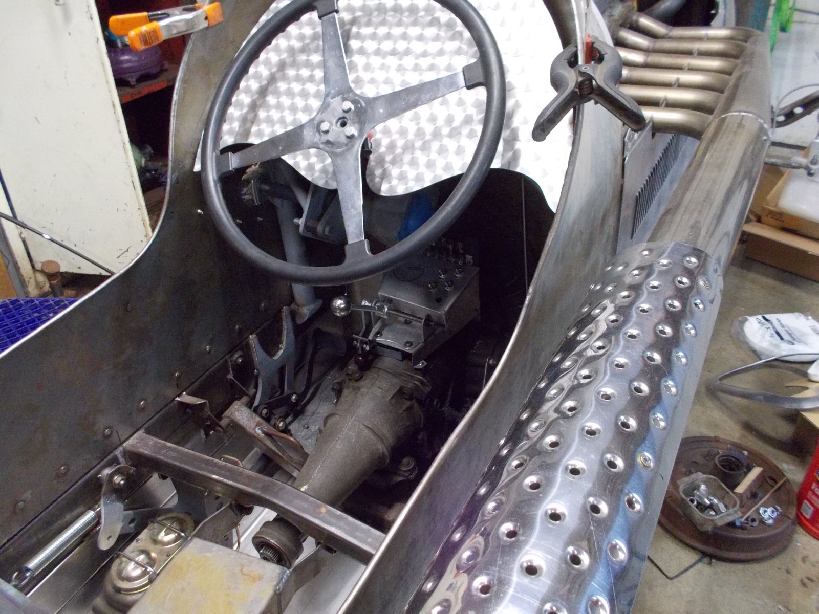

    I almost forgot about seat belt mounting points. I had to move a couple of things around to make room. The driver's side required I make a little wowoose in the fuel line. The passenger's side required I move the hand brake return spring anchor. The instructions for the harness said to locate the attaching point 2.5" ahead of the seat and backrest juncture.
    The instrument panel mounting flange is spot welded on and even though it only has spot welds at this point it feels rock solid. I only burned through the skin in one spot - it will be easy to fix. The panel fits good.

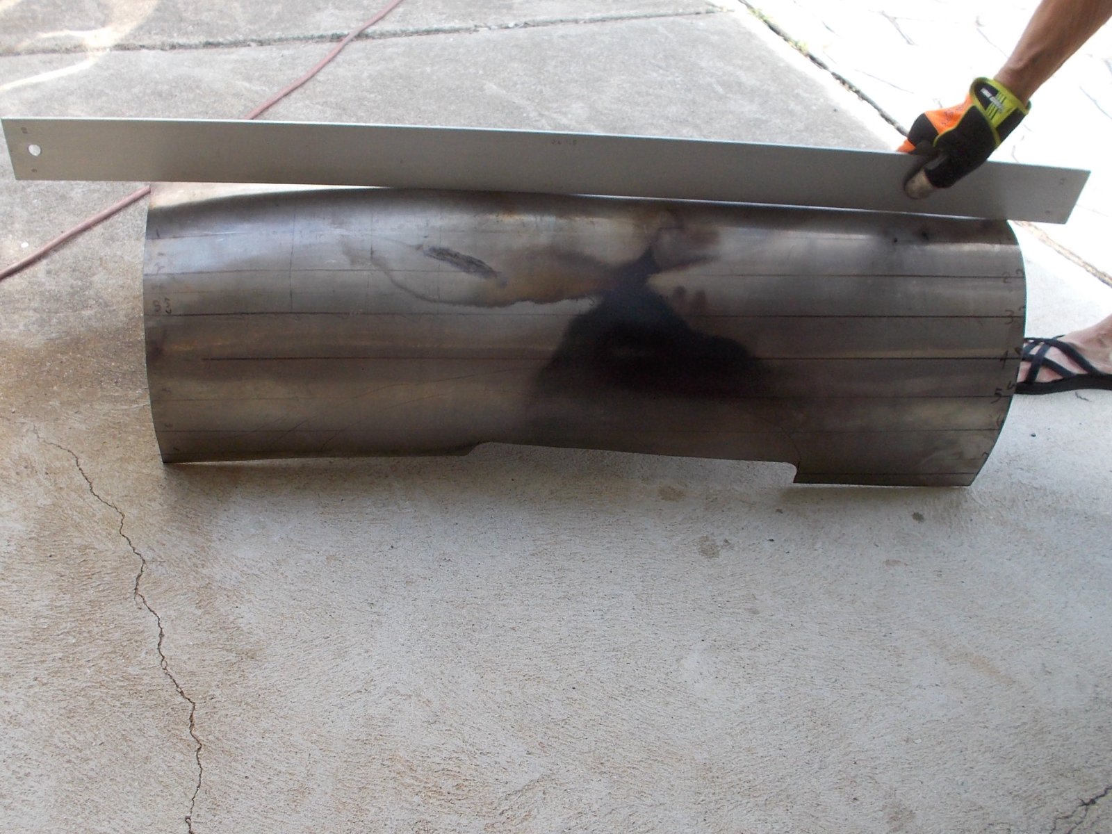

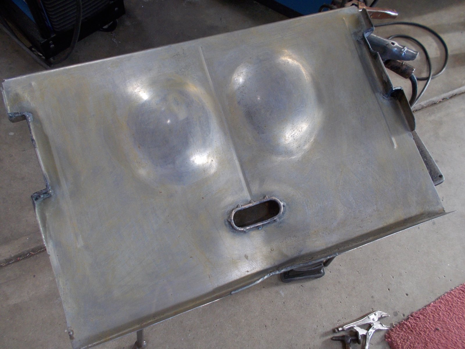

    The hood now needs some serious attention. I put too much crown in it at one point and it work hardened, making it hard to shrink. So I built a bonfire and annealed it a few hours. I selected a sweep that has about an inch of curvature in it and I'll try to get it back close to that crown, while keeping the sides flat.

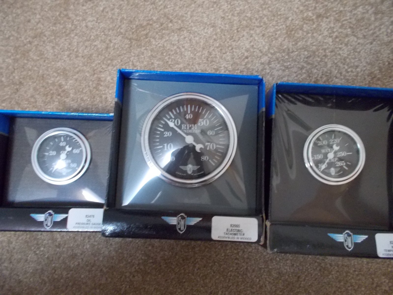

    The Santa Summit brought me some champ car bling. Classic S/W Winged Logo Tach and gauges. Sometimes I install the gauges where nominal gauge headings are straight up; i.e., the tach needle would be pointing straight up at 6000 RPM; the oil pressure needle would be point straight up at 60 PSI; the temperature gauge needle would be pointing straight up at 200*F. Which way do you think would present well? Logos straight or needles straight up?
