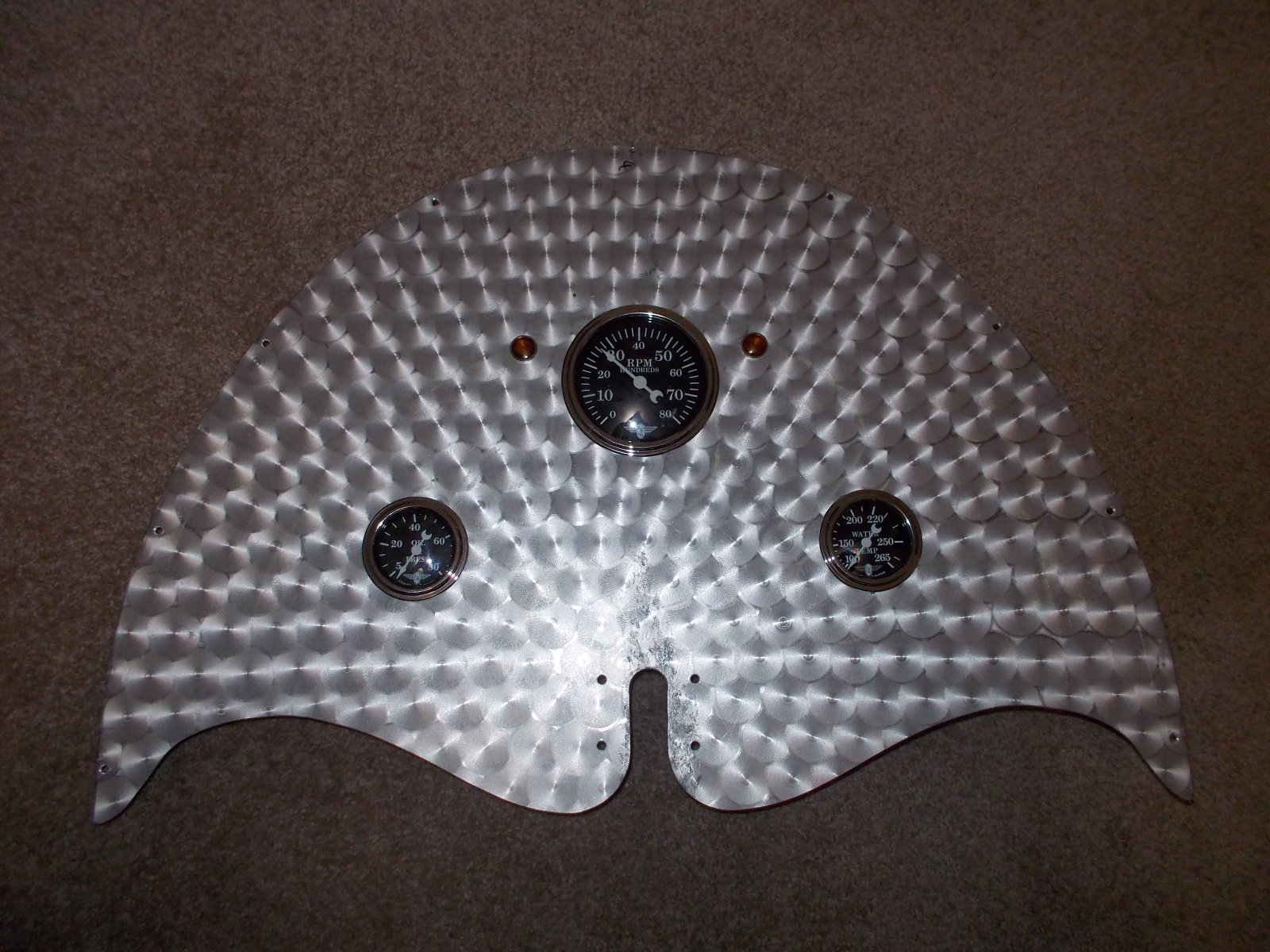

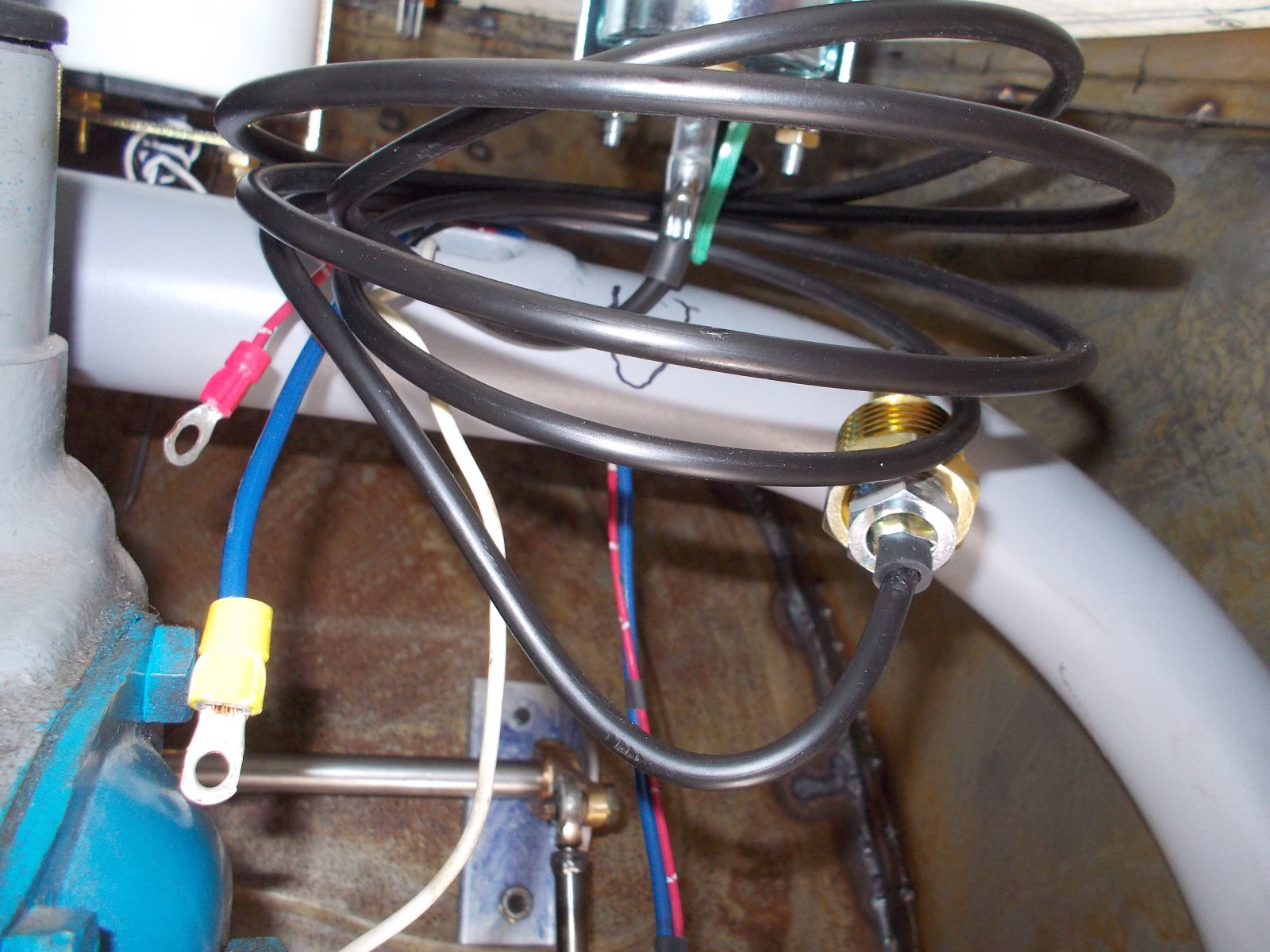

    I installed the SW curved gl*** winged logo gauges in the dash panel. All I have in there is tach, oil pressure and water temp. Plus two indicator lights. That is all I wanted. My voltmeter is hidden on top of the transmission. My gas gauge is under the upholstery.
    TECH TIP: I connect the hot wire of my tach to the hot wire going to my electric fuel pump. That way if my tach does not register when I fire the engine I know I forgot to switch on my fuel pump. It has saved me embarrasment on my drag car.
    I like to hide little notes on my junk to make it easier to troubleshoot problems, so I labeled the tach terminals and noted the dip switch positions.
    DOH! My water temp bourdon capillary tube just hits the steering crossmember. I will have to either make a new dash and move the gauge location(s) or put a dimple in the tube. I choose dimple the tube.

    In order to better see and locate the area of the tube needing work I made a Phantom of the Opera half mask from pressboard to locate the gauges and mark the tubing for cutting precisely. I cut away enough of the tube to install a dimple made from 3/4 OD x .065 wall 4130. Now the water temp tube will clear. The oil pressure gauge just clears the steering gear after a hodge podge of elbows and adapters.

    Funny thing is I originally planned to place the two side gauges about an inch lower but just before I cut out the holes I decided the arrangement would look a lot better if they were moved up, and I even didn't consider interference with the steering hoop.
    I'm going to add a center brace coming off the tube and anchoring the dash just above the column.

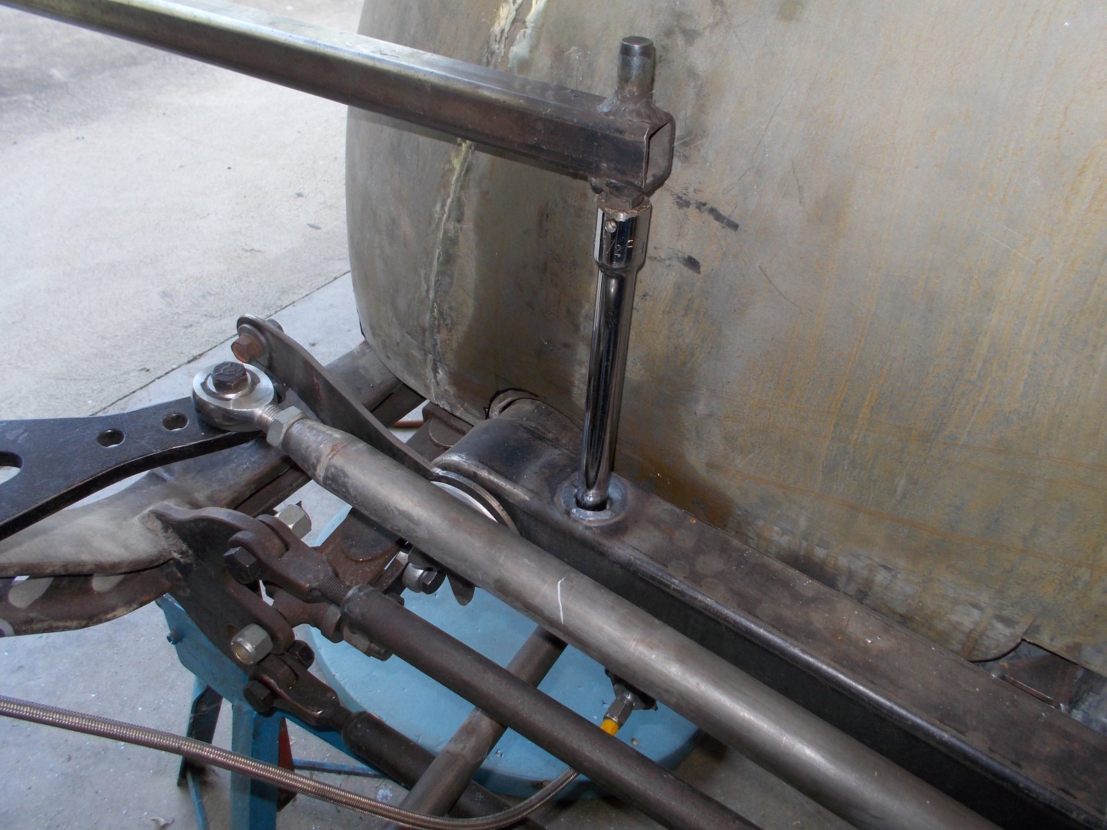

    My bud gave me the sockets needed for the headlight stands, and one of two extensions needed for the headlight stanchions. Nice

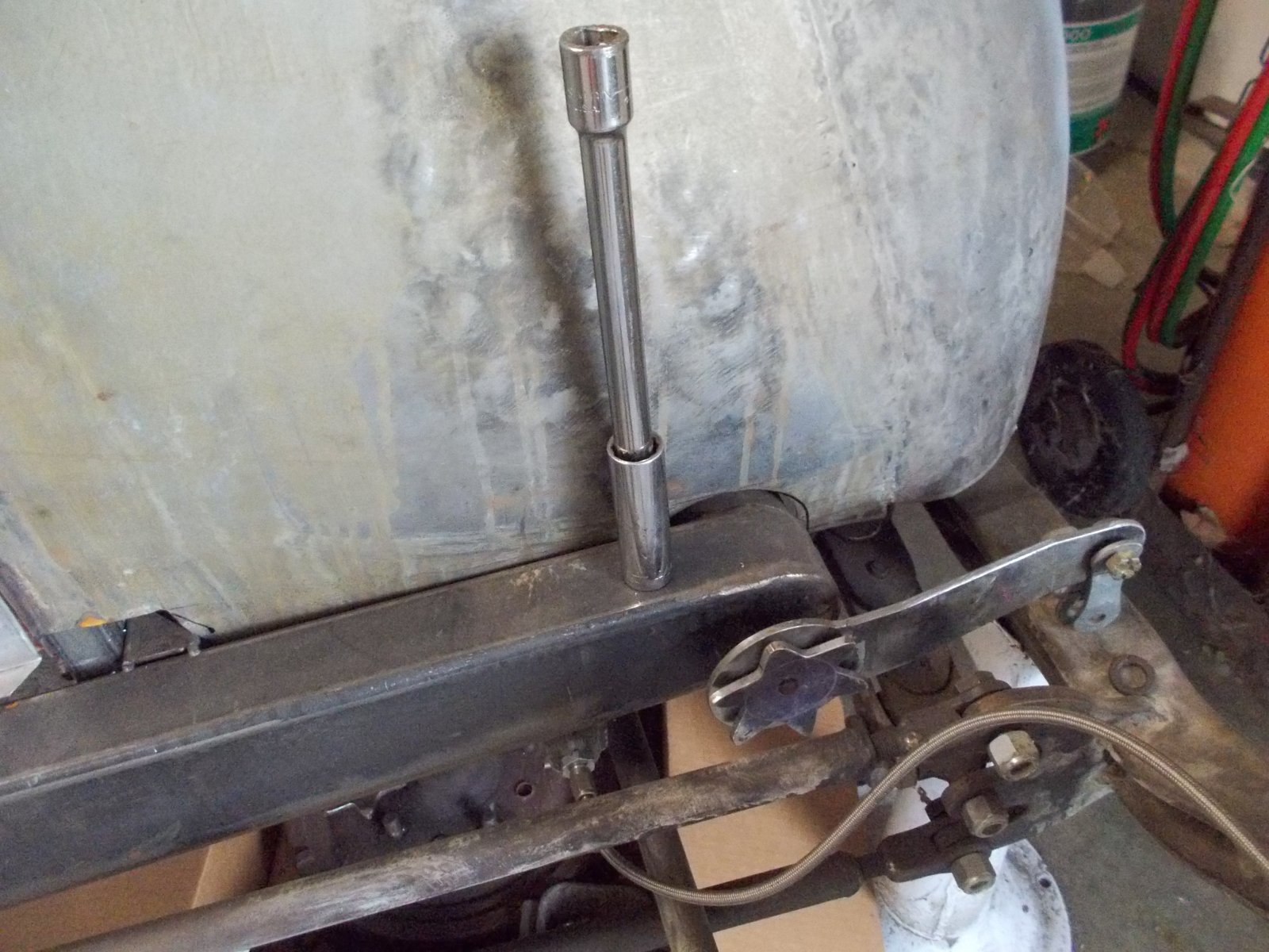

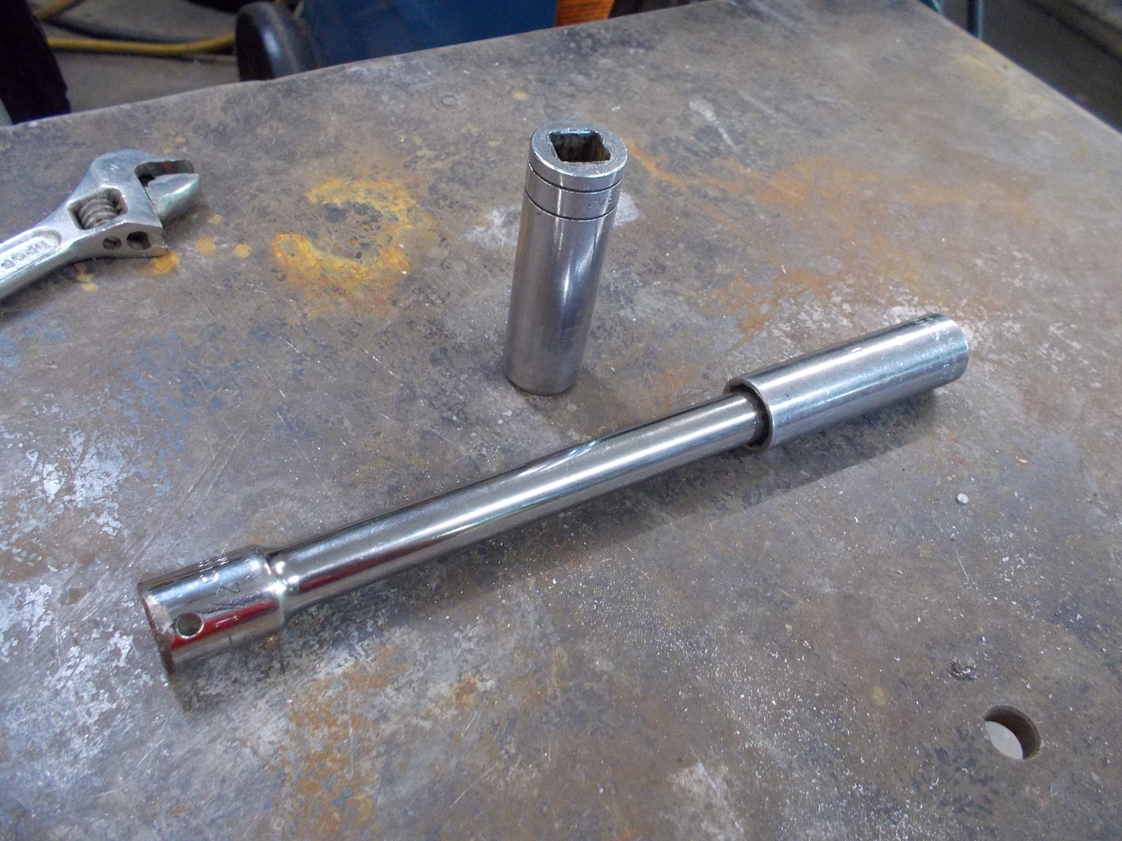

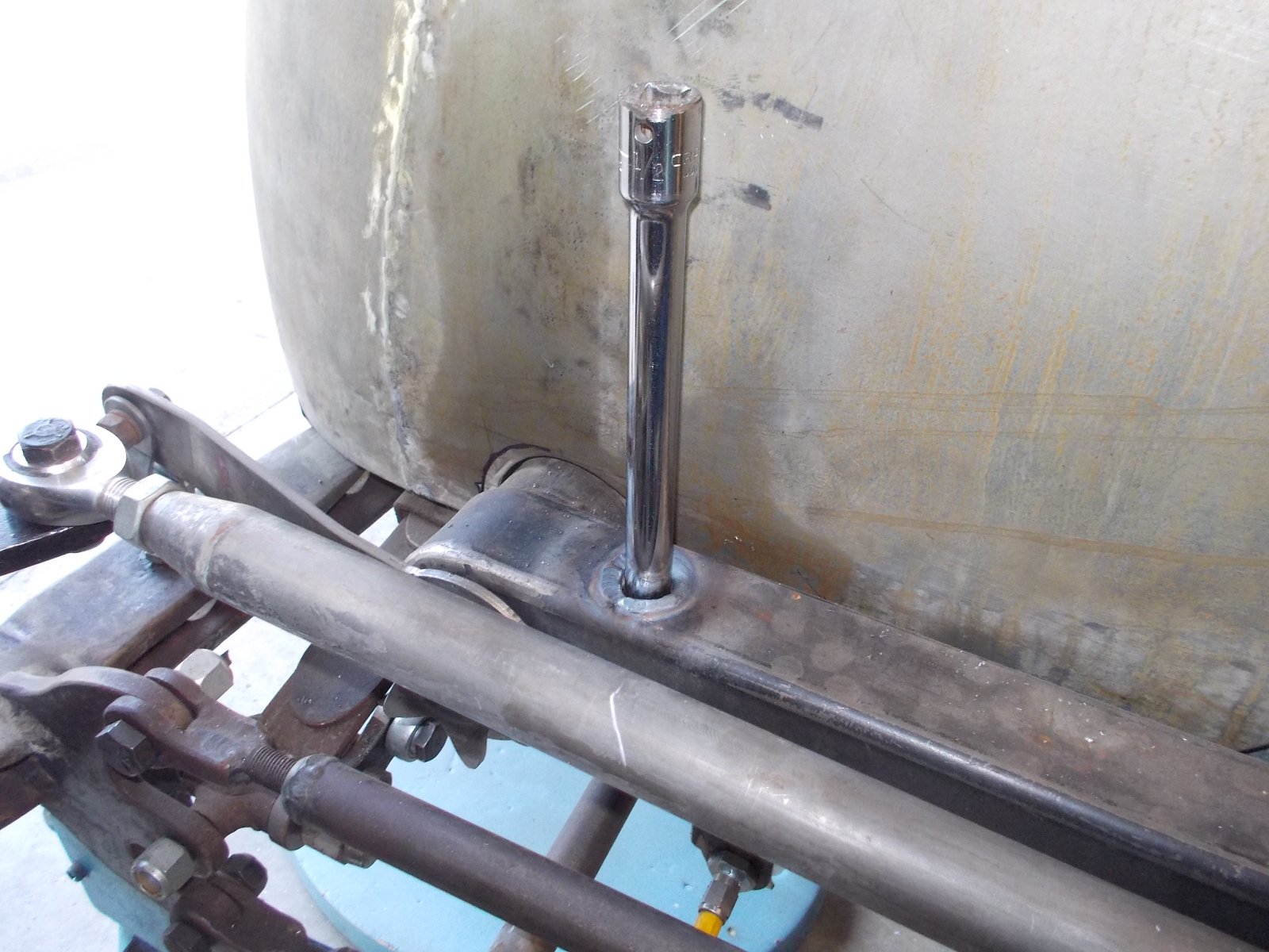

    I welded the headlight sockets into the frame rails, flush on top and bottom. Then I had another thought - the headlight sockets could also be used to fasten the front crash bars to the car. For driving on the street headlights can be plugged in, but when I take it out on the track (or for daylight motoring) I can use the same sockets to plug in the front crash bars. A happy accident! That will keep me from goobering up the frame with too many mounting tabs.
    I used my torque wrench multiplier bar snapped into an extension to align both square sockets, which may proove useful when bending up a couple headlite stanchions.
    TECH TIP: My multiplier bar is exactly the same length as my torque wrench. It is useful for doubling the torque of the torque wrench. Most torque wrenches go to 150 ft-lb or so. The bar snaps on to the wrench doubles the torque so you can torque stuff like rear ends, harmonic damper bolts, and other bolts requiring high torque values.

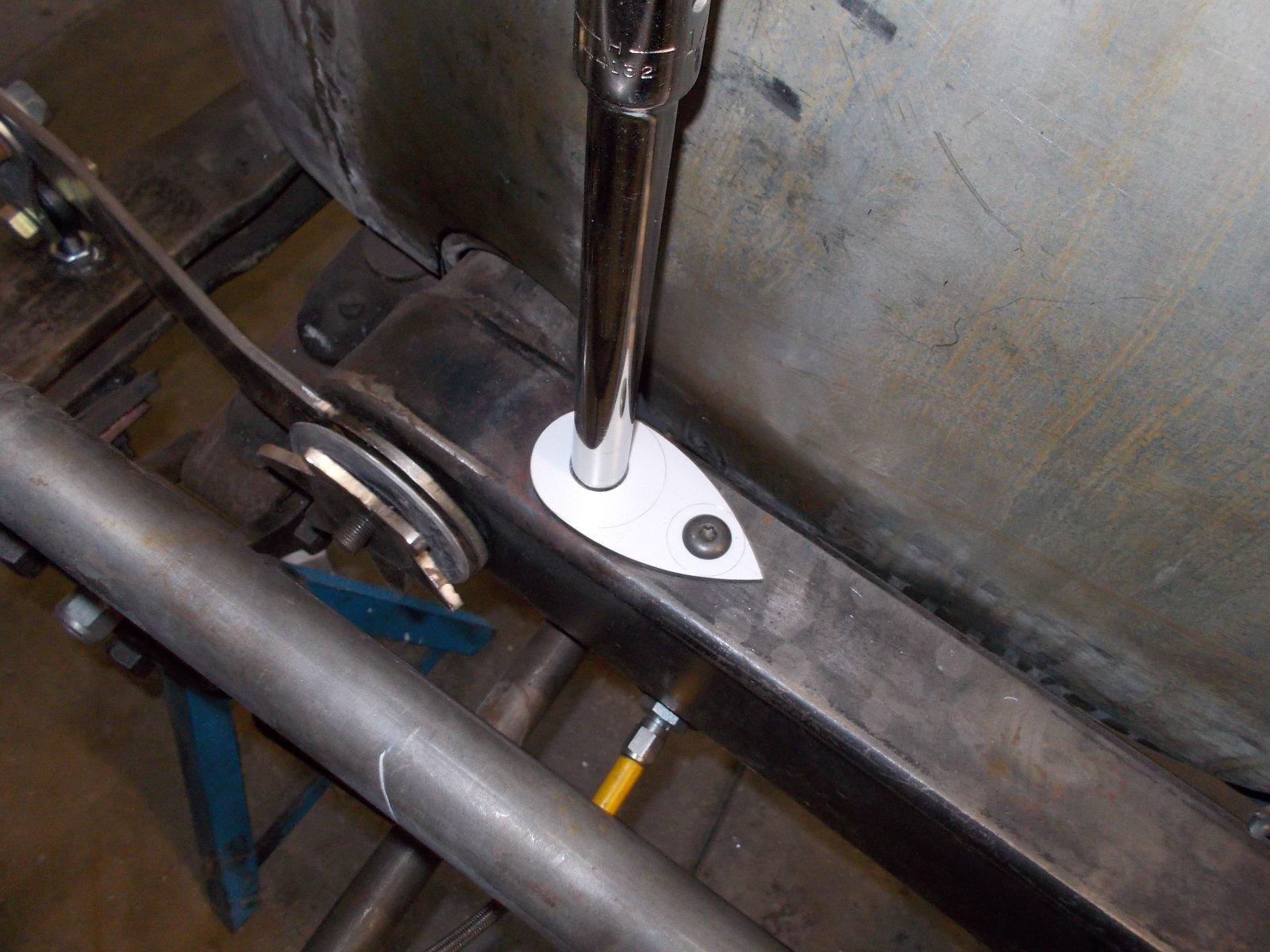

    Due to storm cleanup from severe storms in the area last week not much got done recently. I made a pattern for the headlight stanchion anchor pads. That's all folks. headlite 14.JPG

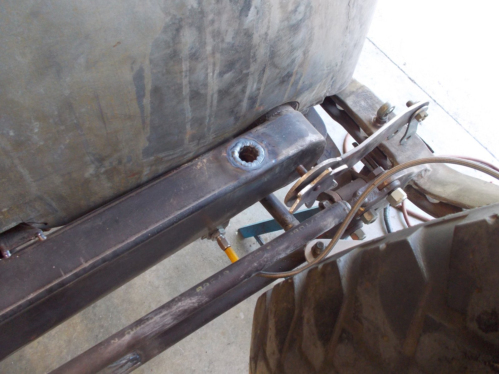

    The socket hole welds got dusted off. Two anchor pads got made from steel plate. I also reamed the front shock levers so they slide easily in the mounting studs. When I made the frame rails, before I welded on the front crossmember, I welded on nuts inside the rails to accept the friction shock levers. The shock nuts are "torque prevaling" to insure the studs will not loosen over time. I have some friction pads - now all I need is a 3" outer disc to bear against the lever.
