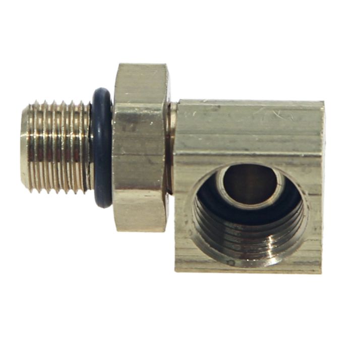

    EDIT: Found this online -
    https://www.cjponyparts.com/cooler-...XG0KTEO0_MTOasFteCqhBy6Oe5lSQwp4aAusPEALw_wcB
    WOW - $63 a pair!
    Note that it also has a seal in the internal flare nut attachment.

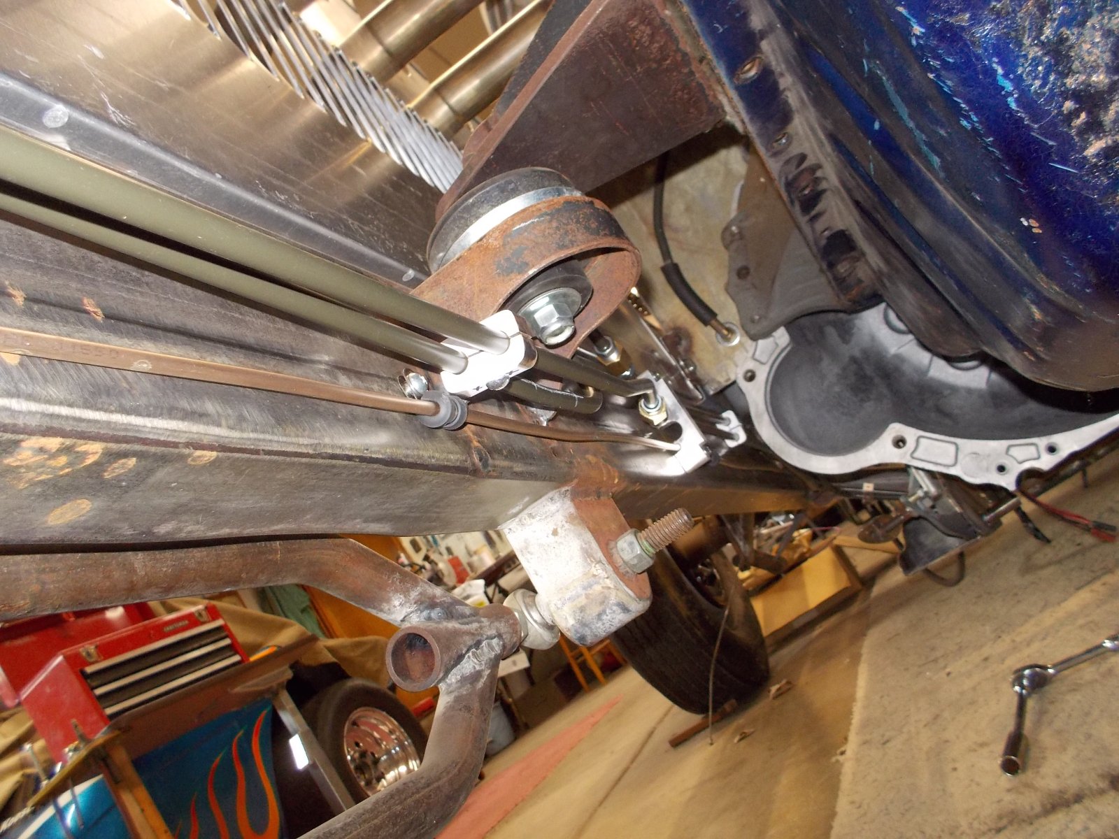

    In preparation for running cooler lines I re-attached the gas pedal ***embly to the transmission. Then I made a strut to stabilize the pedal to the trans case. Since that strut takes up some of the real estate near the trans case it was necessary to install it to see how much room is left for the cooler lines. I decided to run the lines rearward, well clear of the gas pedal linkage, then forward to the rad.

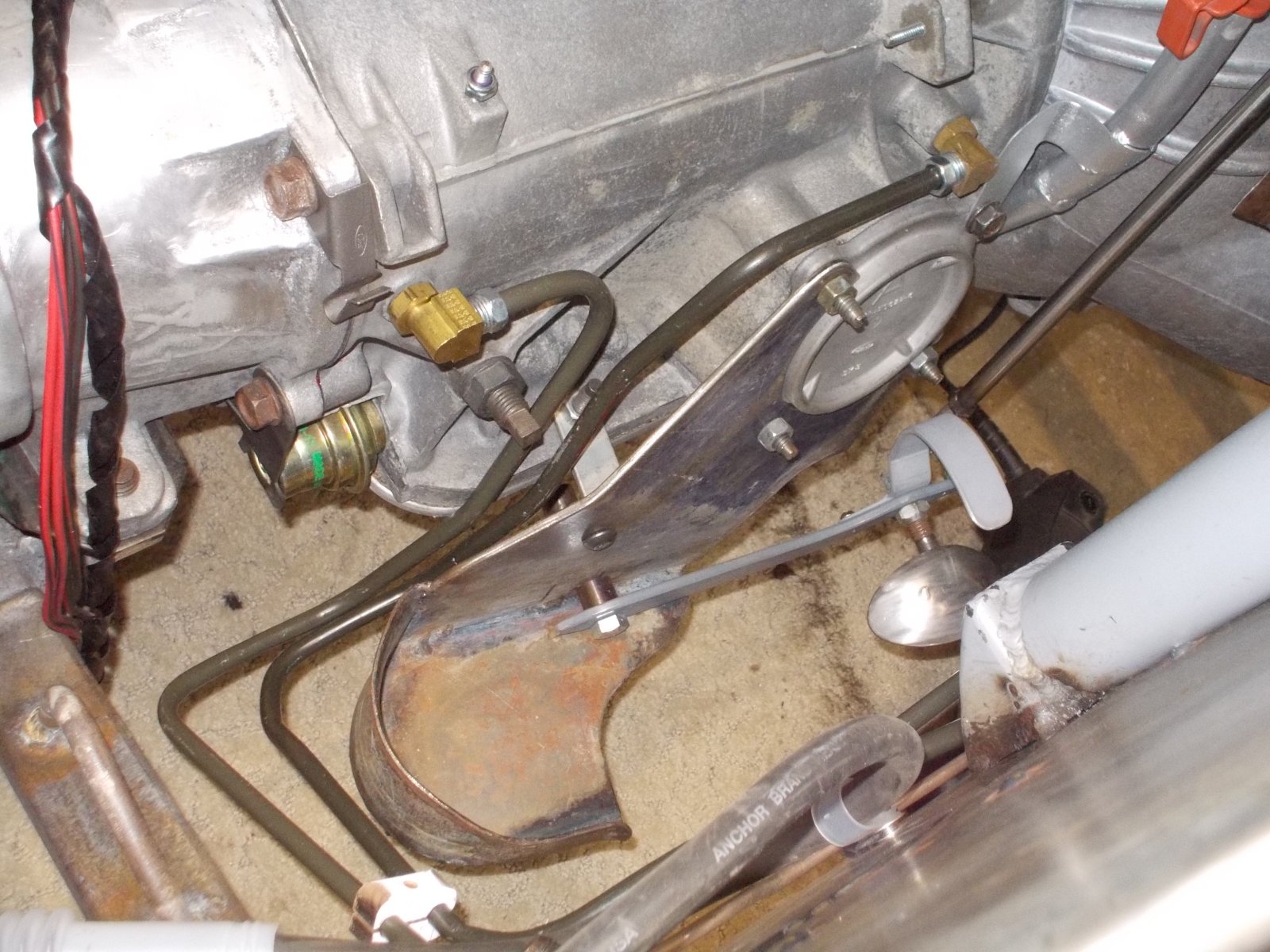

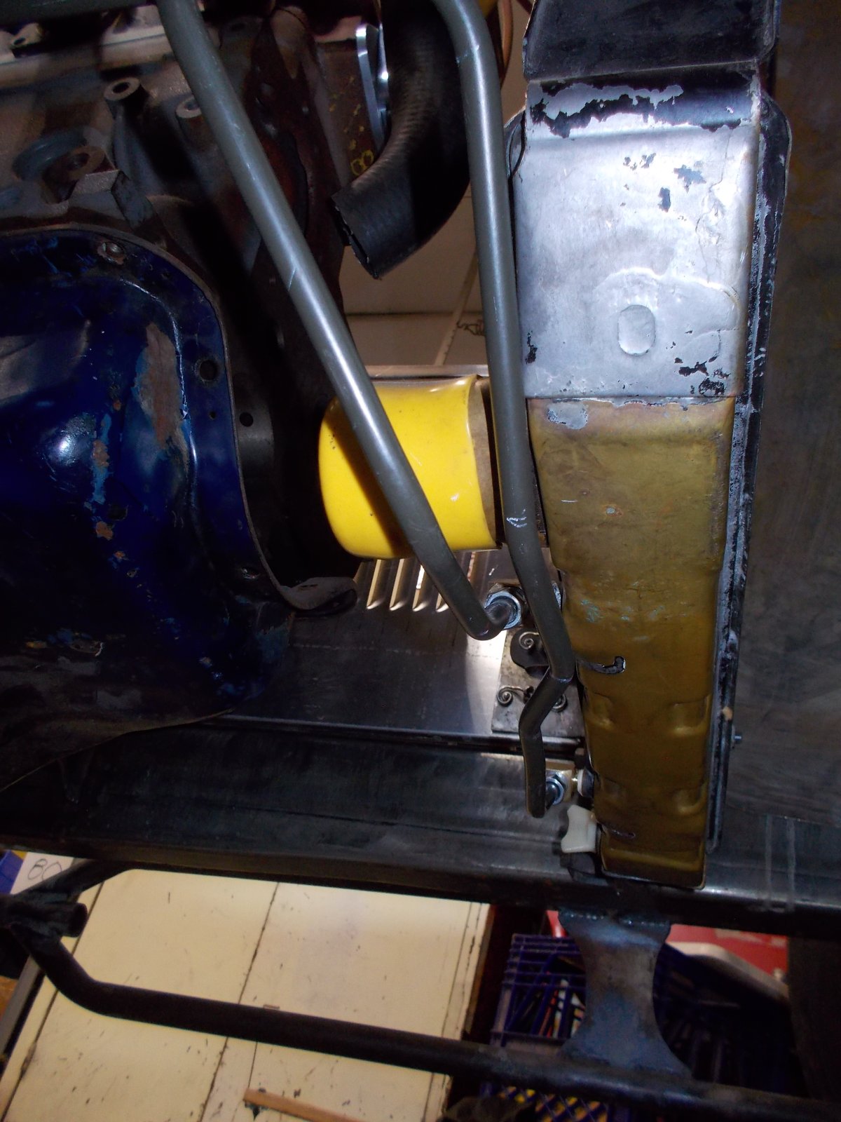

    I finished the transmission cooler lines. The list of things to make / do is dwindling down. Much of what is left - wiring, windshield, upholstery, headlight stanchions - can be done after the ch***is is finish welded. To that end I will begin to dis***emble the car to weld up the frame.
    The completion of cooler lines was a challenge. In past projects my routing of hard lines was never esthetically pleasing. I just wasn't good at routing lines to make them pretty and integral to the flow of the ch***is lines. I have a friend who is a whiz at this. He makes all his brake, fuel, and cooler lines look like they belong on a nuclear submarine. This time I tried to make them look good. To that end I learned some helpful tips:
    - Mark the inside of bends with a wax pencil with a line on the inside of the desired radius. Then align that line in the tubing bender.
    - Mark the desired beginning of each bend. Try to leave enough straight transition room between tightly spaced bends so the tubing bender can "bite" into a straight portion of the tube.
    - Bend slowly into place. If a 45 degree bend is desired start with a 40 and fine tune it after a trial fit. It is much easier to add a little more bend than to try to unbend a section. Of course this means crawling under the ch***is several times to get it right.
    - The completed line should be able to be threaded into the tapped fitting by hand using no tools and applying no body english to get it started, without bind. If there is bind your bends are incorrect.
    - SLIDE THE THREADED FLARE NUT TO THE END BEFORE BENDING THE TUBE, or you'll be making another piece after the flare nut ends up captured in the middle of the line somewhere. Thankfully, this time I did remember to move the flare nuts out of the way of the bend.
    Enjoy

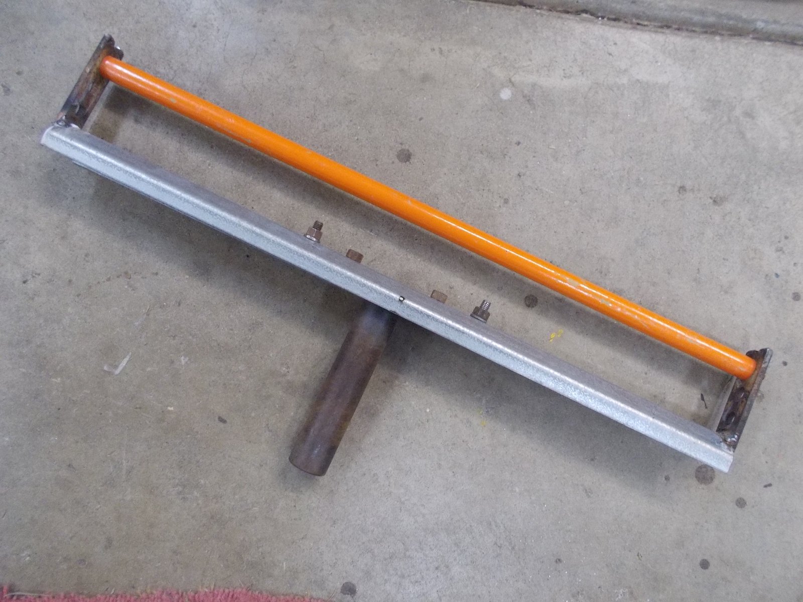

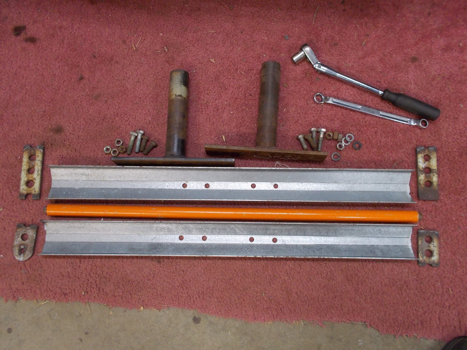

    Fun with a chop saw -
    Since the ones that came with it didn't fit my frame I needed to make support fixtures for the frame rotisserie. Digging through my s**** iron pile I found the needed materials and welded them up. I used a piece of broomstick (orange) as a fixture to hold the end tabs in place for welding. I made the broomstick a couple of millimeters wider than the frame rails so that after welding and shrinkage they just slipped over the ends of the frame.

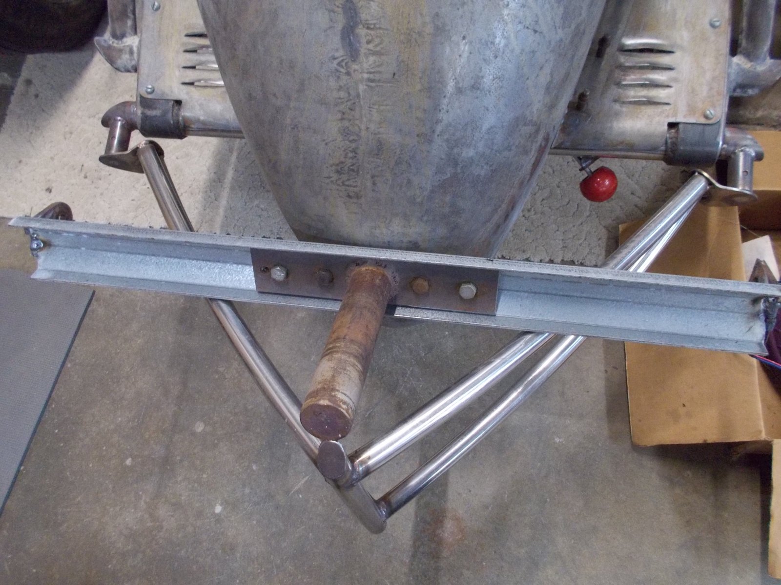

    I installed the fixtures in the rotisserie, ****ed them together, and got a measurement of how far apart the spreader ties needed to be for proper spacing. After determining the end stands needed to be spaced an additional 70" apart I made two spreaders out of 2 x 4s which will get screwed to the casters to maintain spacing to hold my frame.
