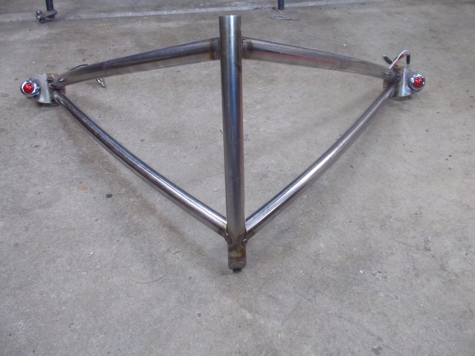

    I got some more trinkets for the car today - a pair of LED motorcycle stop/tail lights. I chose them because they are small and I'll fit them up into the mounts for the rear crash bar. My plan is to drill a 3/4" mounting hole in the crash bar attachment point and snap the lights in place with the wires running out of sight into spade connectors.

    The hole for the brake/tail lights had to be precisely on center since the ID of the stub tube is 3/4" so I made a press in pilot washer to center it up.
    Is this a crash bar or a tail light assembly?
    Answer: yes.

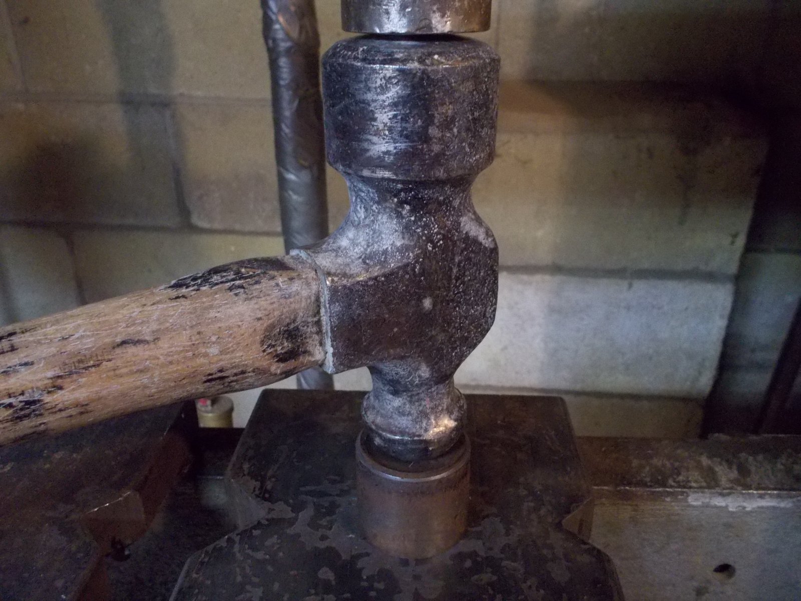

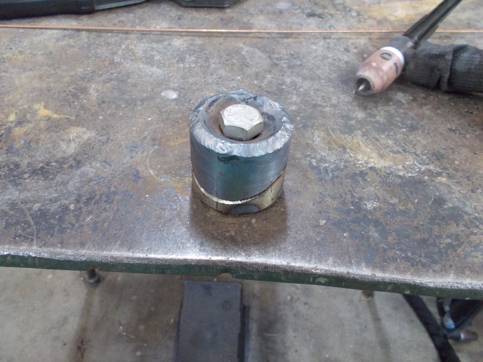

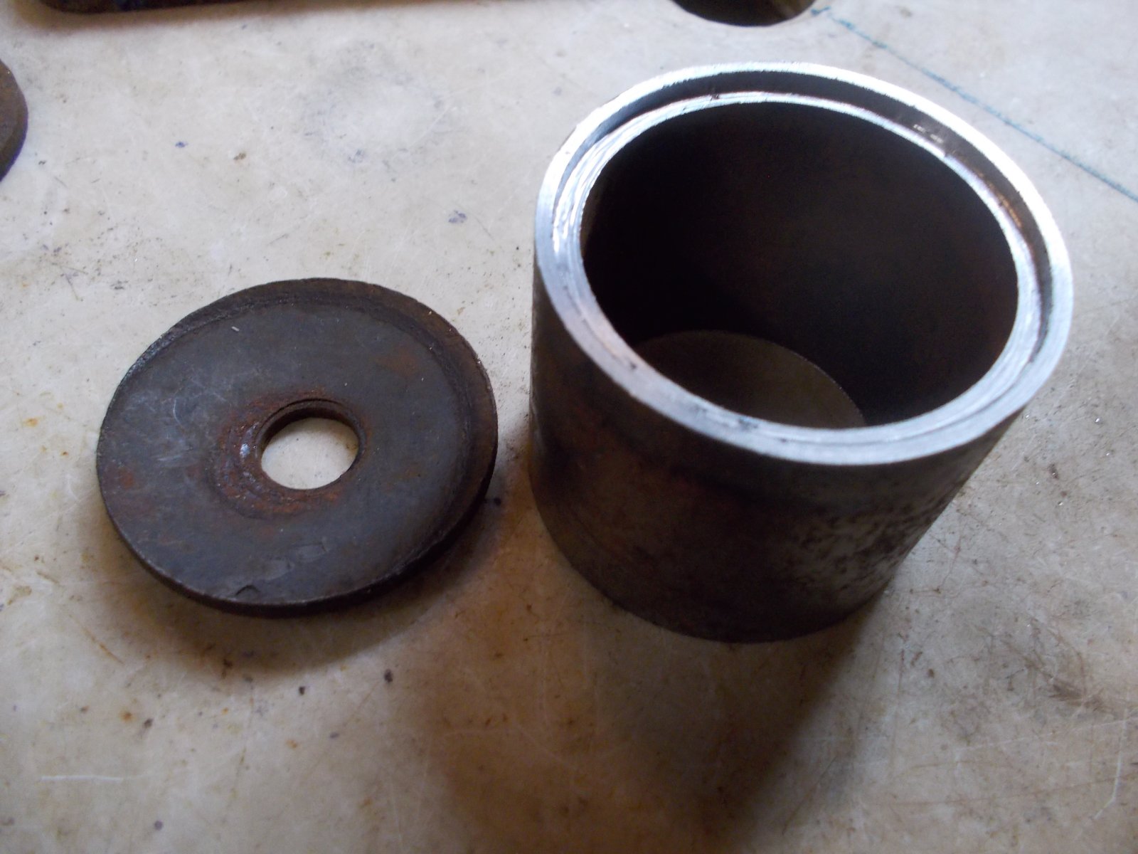

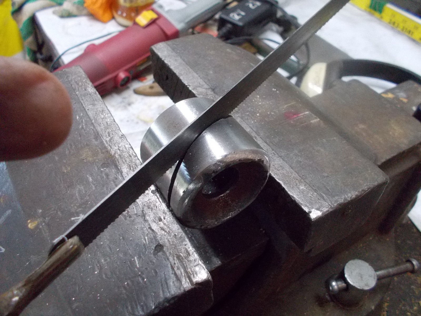

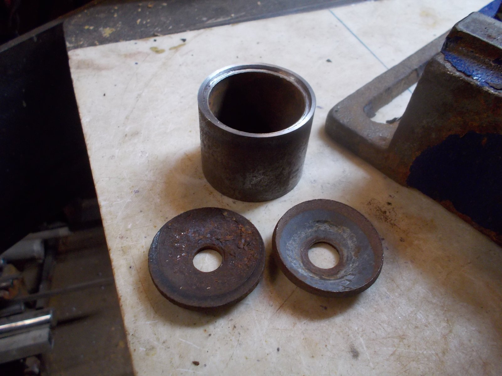

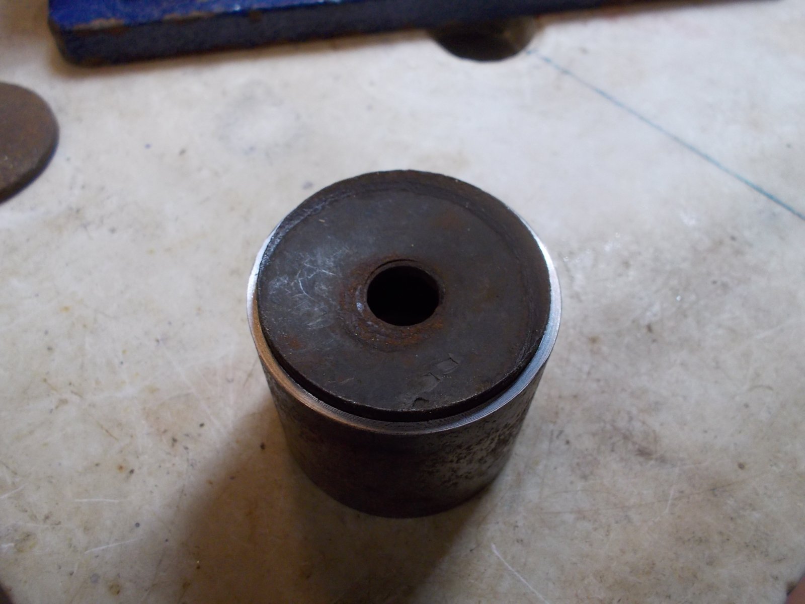

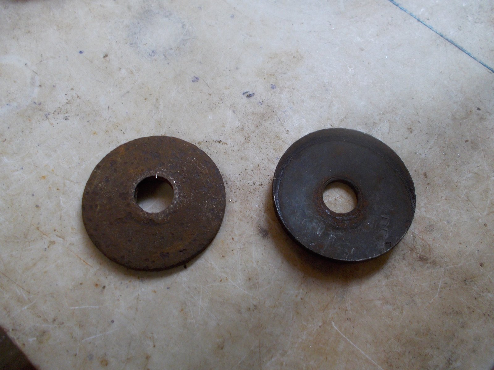

    Today I turned my attention back to the headlights. There is a need for spherical mounting sockets, that will get welded to the ends of the ratchet extension stalks. Out of my junk pile I fould a pair of thick concave shock absorber washers. Those look like they will work. I measured the headlight ball mount and it has a 3/4" radius. The shock washers needed more curvature. I made a sleeve and turned a slight counterbore on the end to accept the shock washer. Then, in a hydraulic press I used the ball end of the biggest ball pein hammer I had. It worked great. I made an adjustable ram stop so both washers will have the same amount of curvature.
    After pressing the curvature in the washers I decided to use the collar fixture as the side of the mount recepticle. To make it look a little more swoopy I scribed a sinusoidal line in the collar instead of slicing it straight through.
    A little welding.
    A little grinding.
    Voila.
    Ready to be welded on the stalks.
    headlite 17.JPG headlite 18.JPG headlite 19.JPG headlite 20.JPG headlite 21.JPG headlite 22.JPG headlite 23.JPG headlite 24.JPG headlite 25.JPG headlite 26.JPG headlite 27.JPG

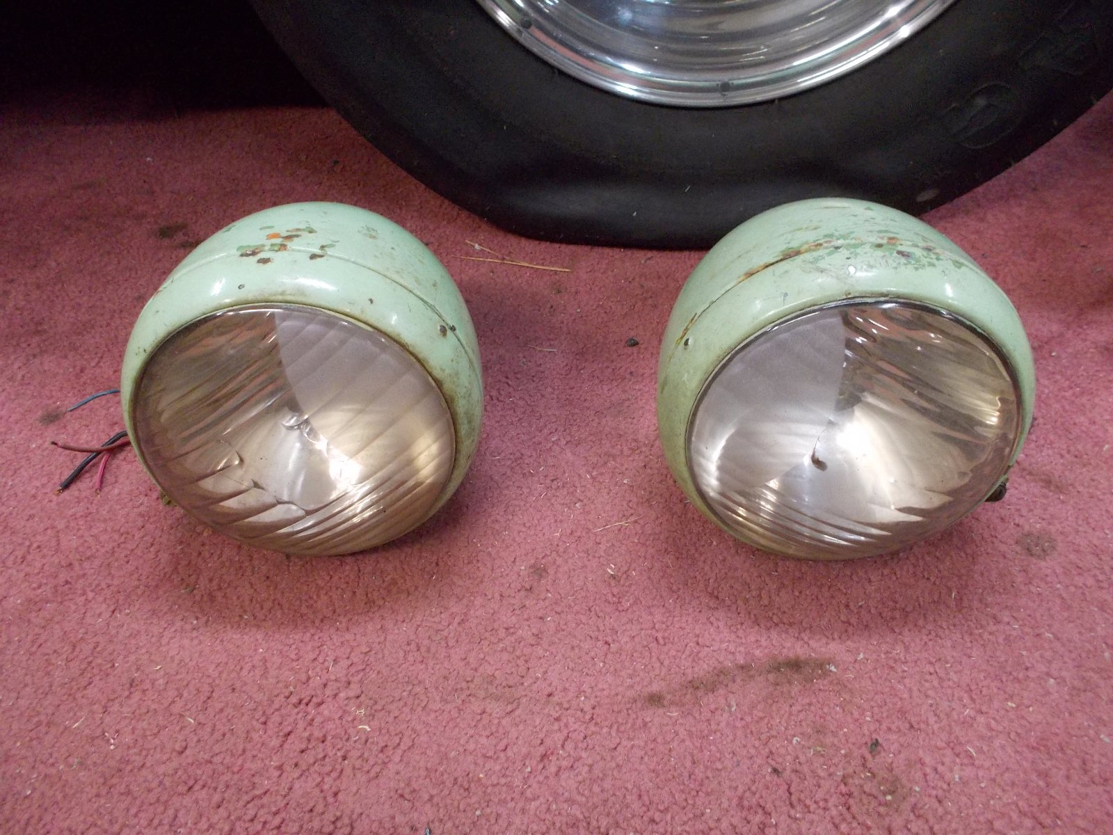

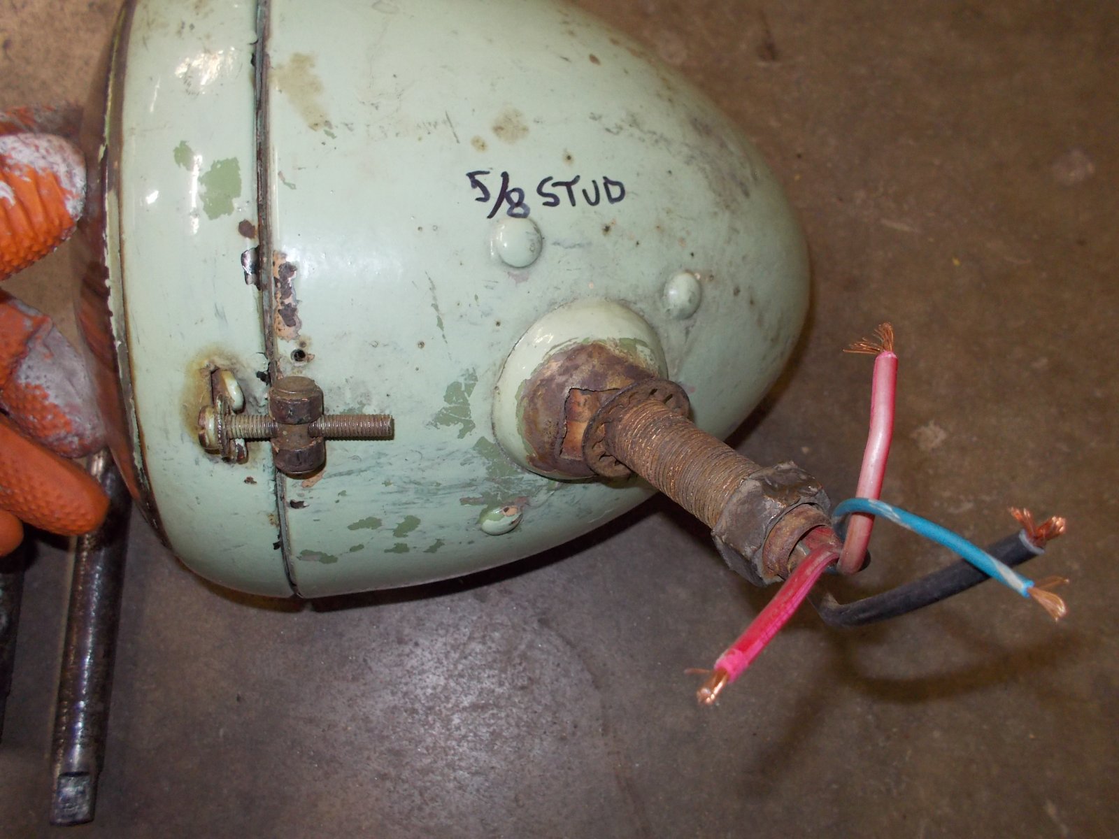

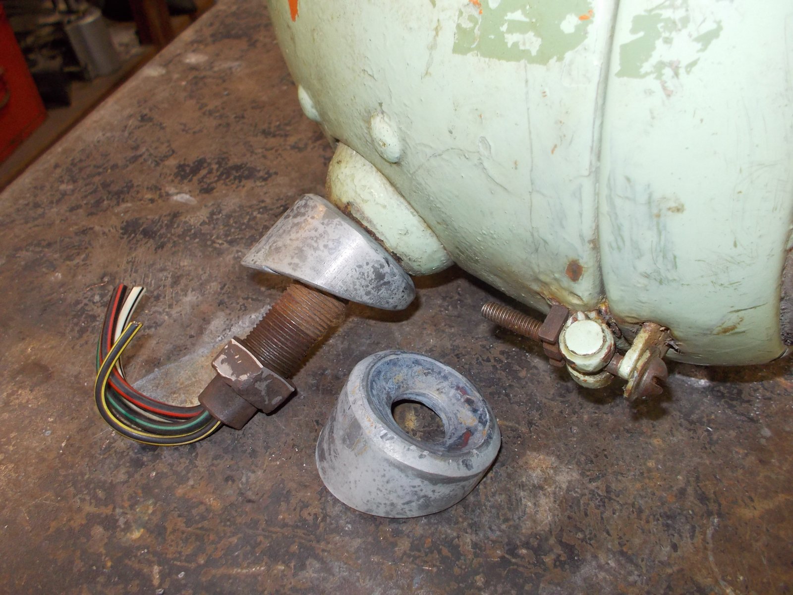

    I would still like to discover what vehicle these headlights came from. One lense has a stone chip in it and if I ever have to replace it I need to know what to search for. headlite 02.JPG headlite 04.JPG headlite 08.JPG headlite 28.JPG
    Some clues:
    It has two sockets
    Vertical flutes in the cruved lense, closely spaced near the sides
    The parking light (soon to be made into a turn signal) is covered by a frosted arc.
    A single trunion screw holds the lense cover in place.
    Any IDeas???

    Diameter of the lens and height of the crown would help.

    I'll guess they came off of a 1944 military Henway.
