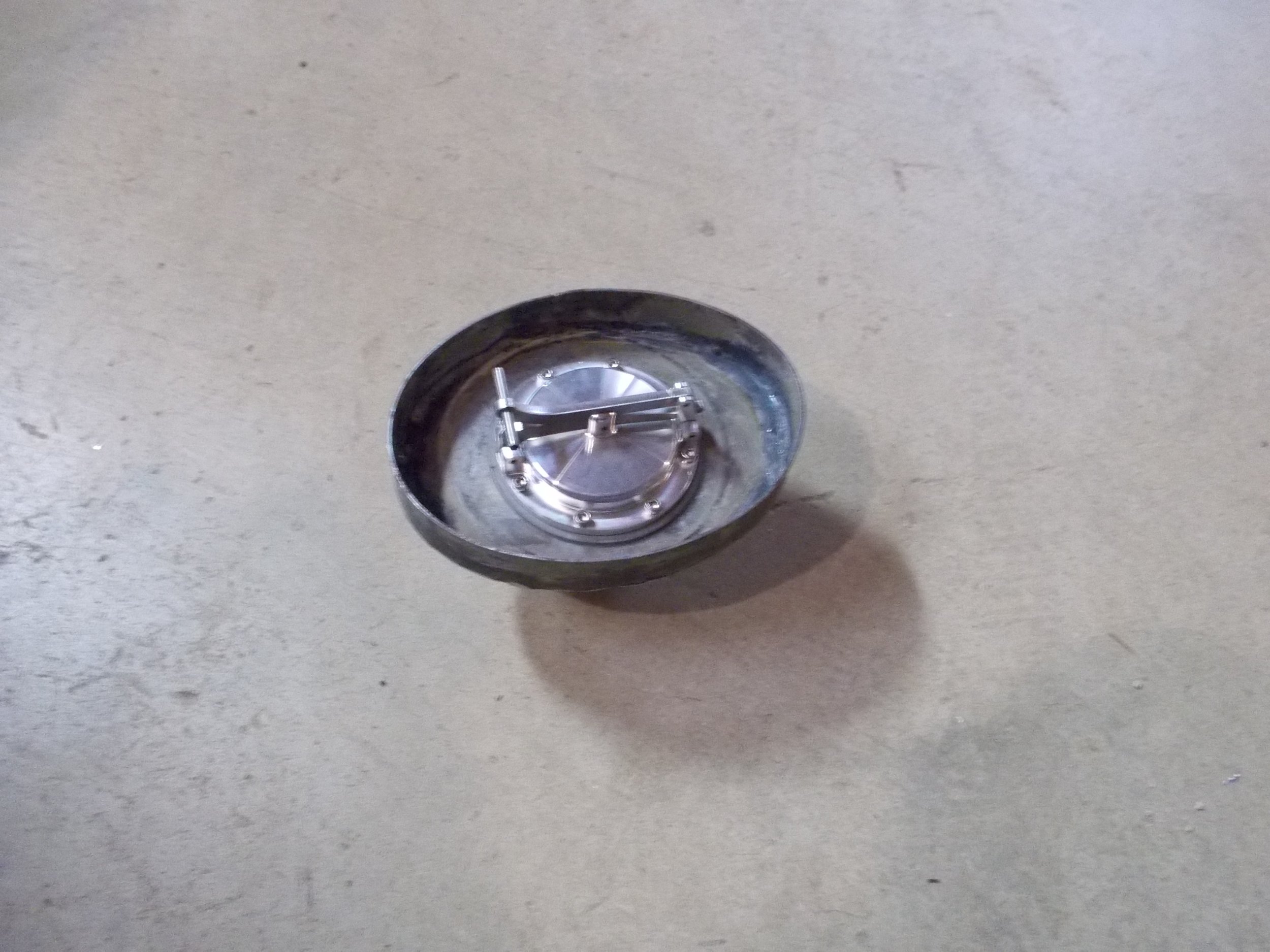

    I did some more tappa tappa on the bustle. I used some specialized tools - long reach hammers and a ******* that me and my dad made for getting into deep places easier. It is close enough for me to start skimming it with a thin coat of filler. I had originally intended to bolt the body back on the newly primed frame to finish the filler work, but the more I thought about it the more I did not want to see my frame dusted in Bondo powder and subject to nicks and scratches that would inevitably occur, so instead I braced the bustle with wood so I can take it outside and place it on saw horses and file/sand on it there.
    That did raise one additional issue though. I did not install the recess for the gas tank filler. This was somewhat intentional so I could get the body surface real close to net shape before I installed the filler cap cutout. Now I have the choice -
    Install the gas tank and bustle back on the body to finish the gas cap - or -
    Finish all the filler work and then put the body back on for the final cut-n-fit of the filler, with minimal damage to the frame primer
    BUT
    that would mean grinding off the filler locally to do the welding.
    I'm leaning toward Bondo filler first then install the gas cap last, with additional filler to be done locally around the gas cap well.
    Of course Murphy's Law kicked in and my orbital sanding disc disintegrated so I am waiting for a new one to arrive. And so it goes...

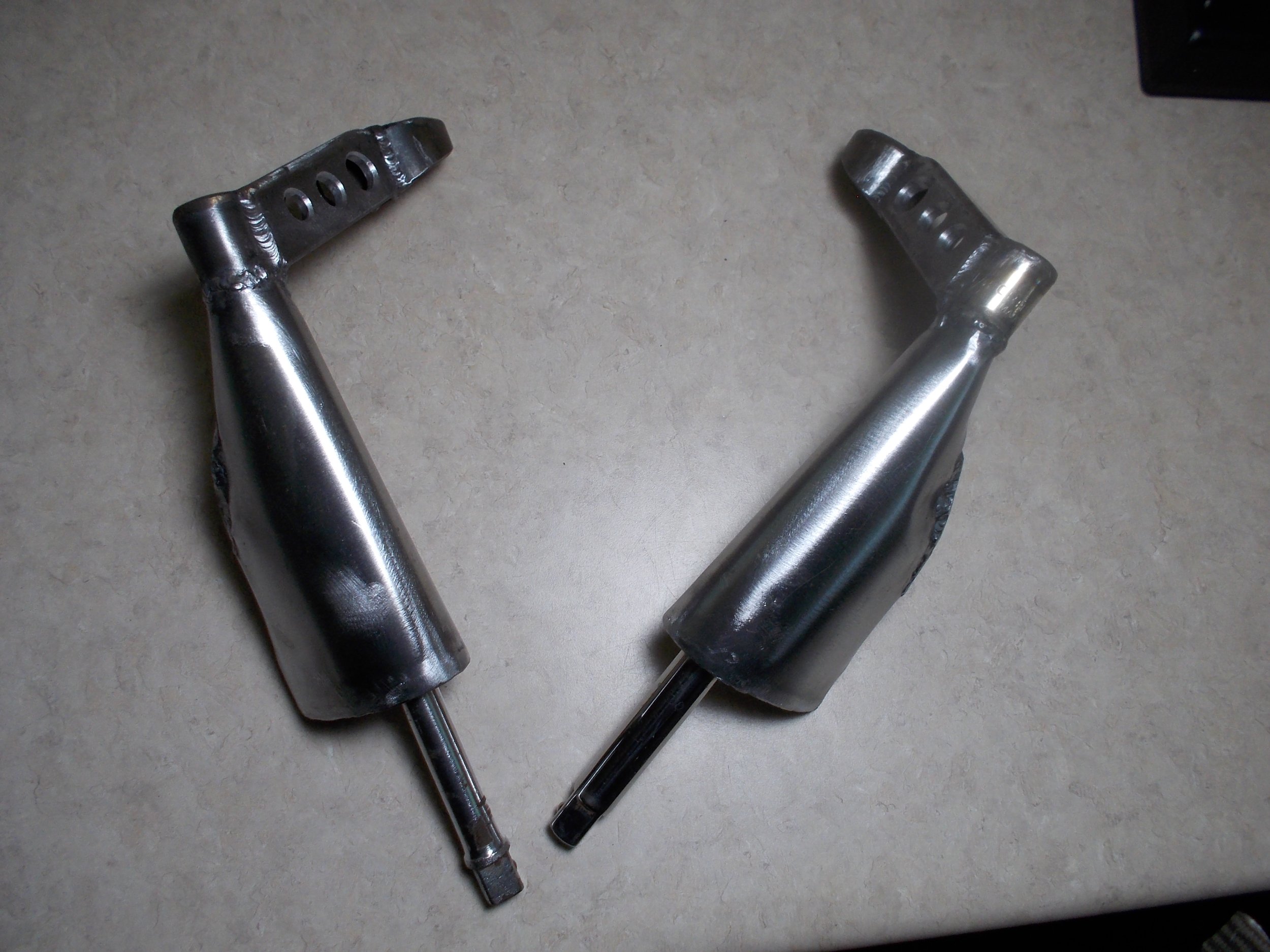

    Sorry Pete, looking back I did not cover the construction of the axle. It just showed up in my post #41 pics.
    I remember making a wooden jig to hold the kingpin bosses in alignment with each other. I was real concerned with getting a defect free joint in the middle too. I made sure there was a sufficient root opening with a proper bevel. A root p*** on each side followed by a top p*** seemed to work, using a TIG torch with a foot pedal current control.
    Hope this helps. FTF
