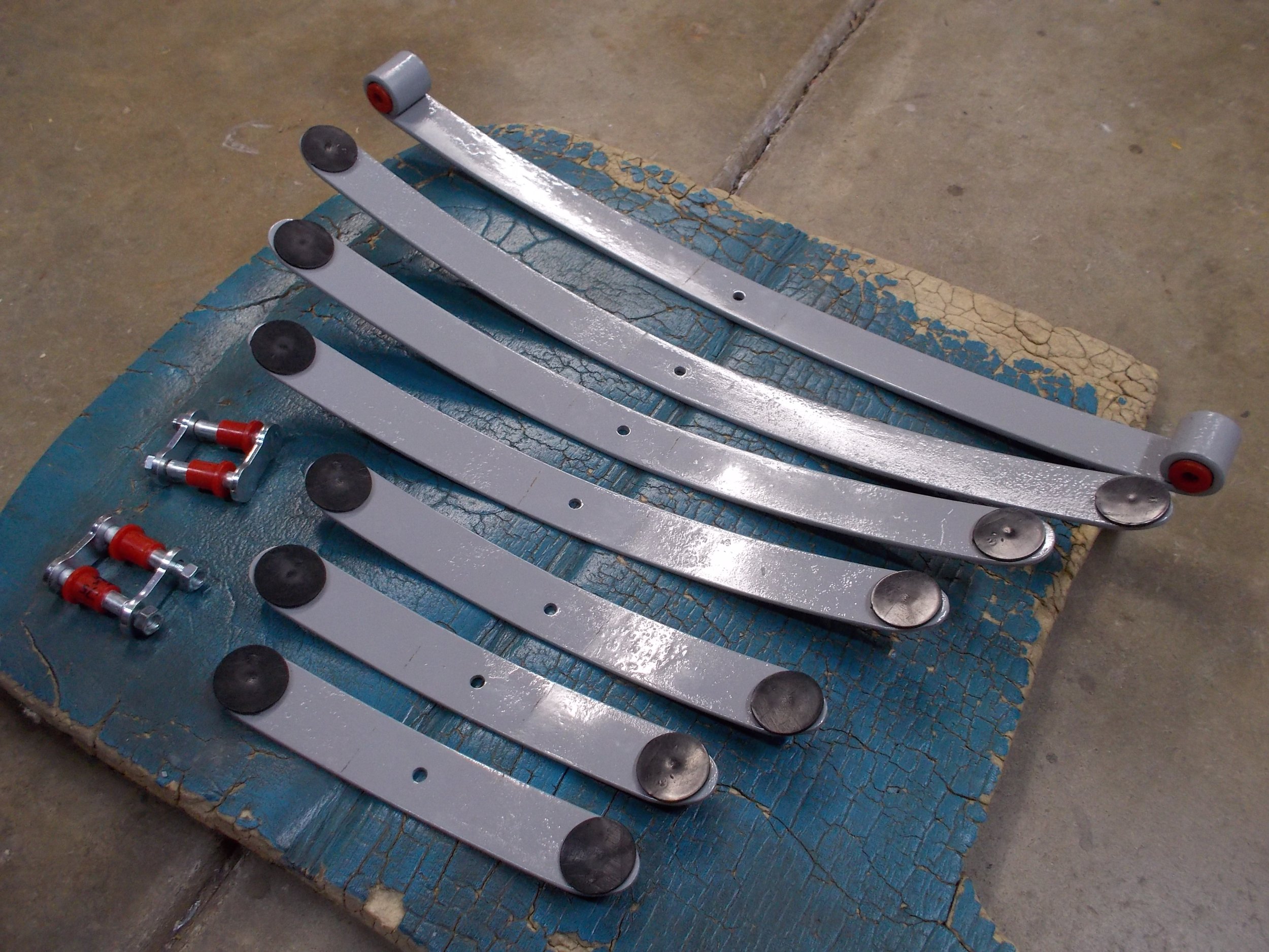

    I am about half way done with painting the ch***is pieces. Tedious.
    Here is a sample part in single stage acrylic enamel with the finished color. Glossy, not gl***y.

    The beautiful painting weather we are having continues, making for more conducive painting in my driveway. Today I did the big chunk - the frame - along with other bits. I also painted inside the lightening holes in the front axle black by hand.
    A couple of observations I learned while doing the ch***is painting:
    The borrowed frame rotisserie made painting the frame so much easier than wrangling it around on the floor or jack stands. Thank you to my buddy Greg G for the loan of the rotisserie.
    Instead of buying graduated paint mixing cups, I went to Gordon Foods and bought some simillarly sized unmarked polypropylene cups in bulk. Using my third-grade knowledge of proportionality I put marks on the cup for paint, reducer, and hardener. Graduated paint containers are pricey. I bought a stack of 25 food cups for the price of a couple of graduated paint mixing cups. Before using them I tested one filled with reducer overnight and another with paint/reducer/hardener to be sure there would be no interaction between paint and container. No problem.
    The rear axle ***embly remains to be painted. Since the backing plates are black I'm thinking the axle will be black with the rear springs done in Frenchtown Grey.

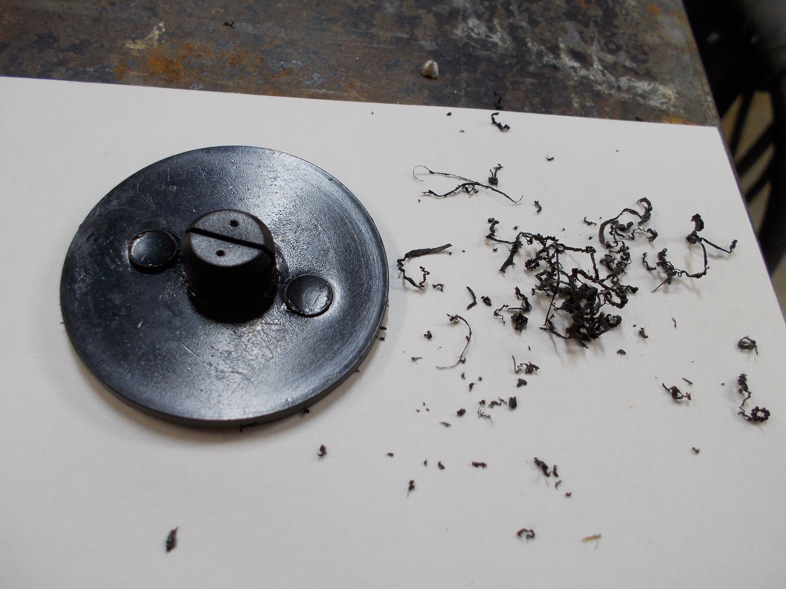

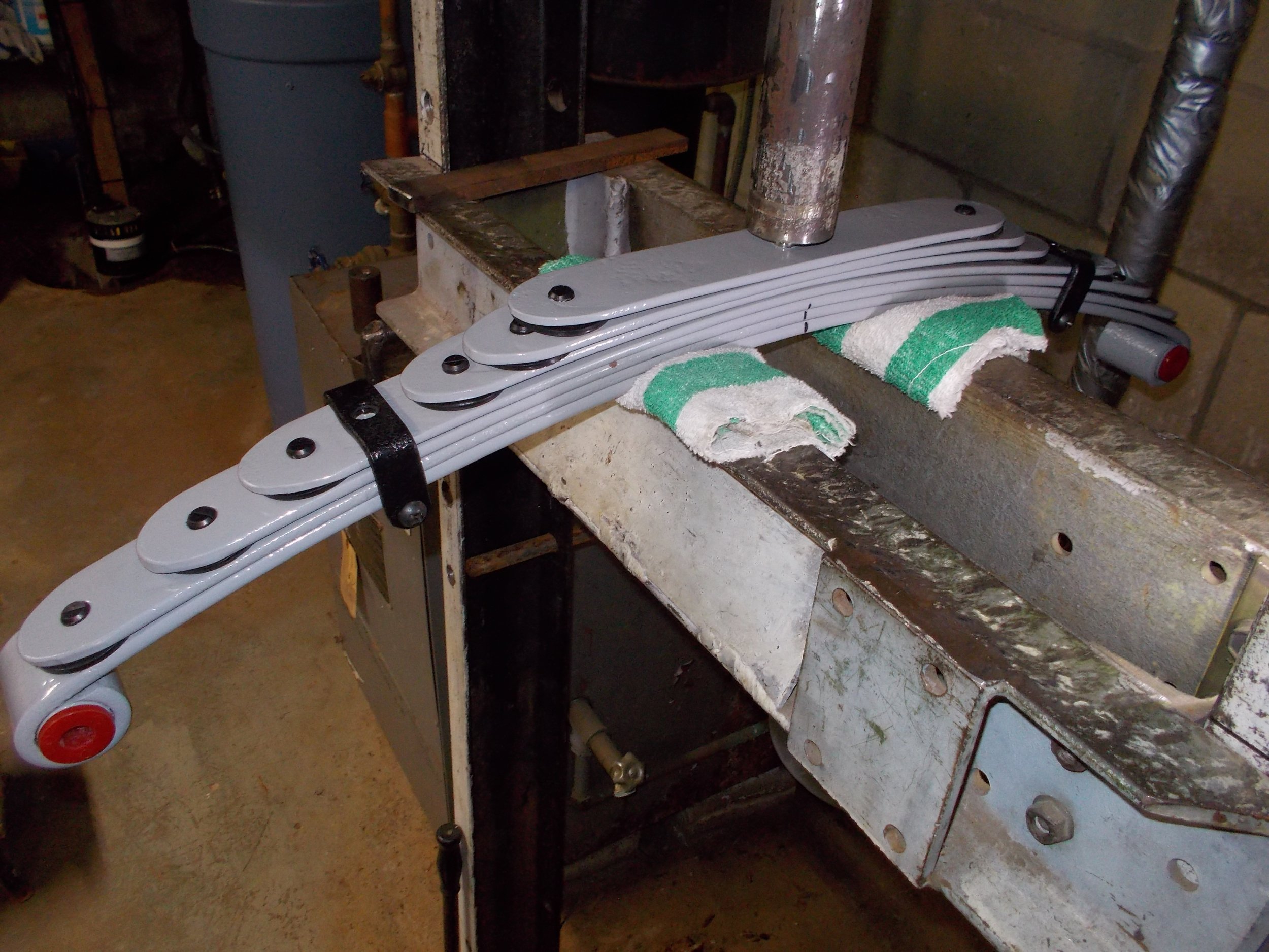

    Its raining today. I stayed indoors and began ***embly of the front spring. The spring slider pads had some flash on the outside edge. I remember my plastic model building days and how I did not like to leave plastic flash on the parts. As I recall, Revell kits were pretty good at not having lots of flash and mold mismatch. Monogram seemed to be the worst of the big guys. Anyhoo, I shaved the OD down before knocking them in place. ***embling the leaves was stressful as there is a lot of potential energy built up.
    Respect
    It took a ton of pressure to completely press the stack together. That one center 5/16 bolt makes me nervous so I put a temporary retaining plate over the middle.

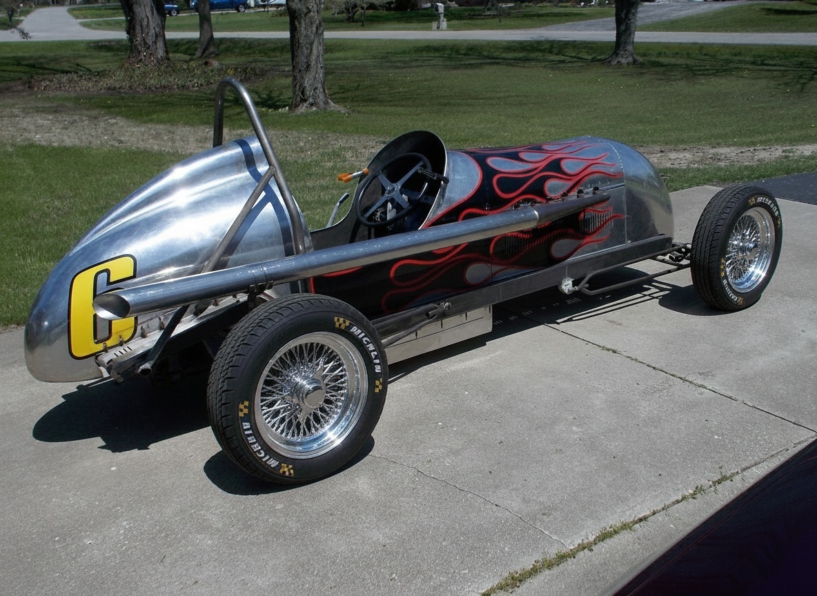

    A viewer on a different site sent me a photoshopped image of my cah. I like it except he couldn't get AI to reverse the flames.
    I suppose they would look good if I was backing it into the wall... yikes.
    And Dayton wires with knockoffs. It needs wires.

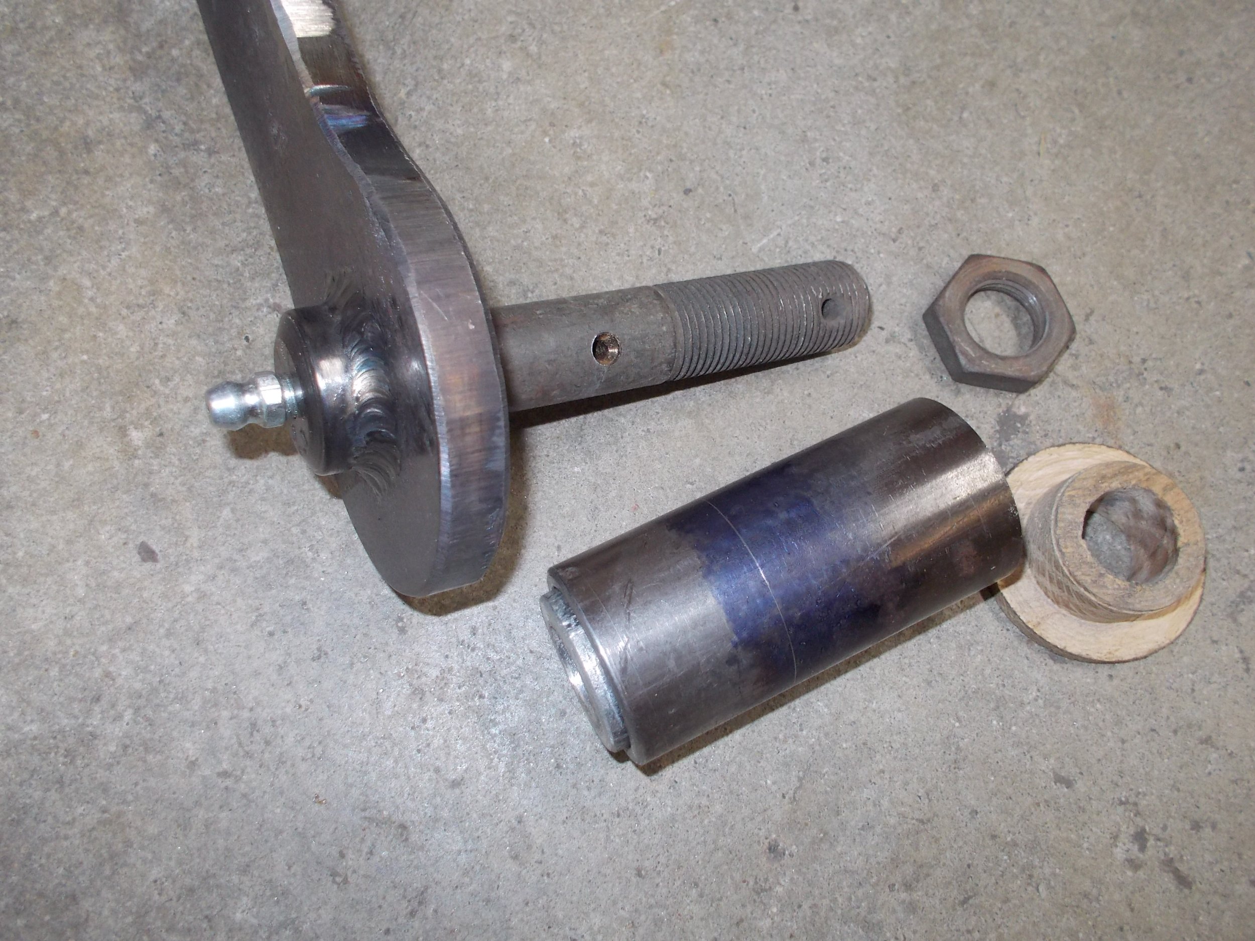

    I started in on the rear spring shackles.
    I've decided to use bronze bushings on the rear spring. To that end I made some shackle sleeves from 4130 chrome moly steel. I bought some bronze bushings that will get pressed in. When the bushings are flush with the sleeve ends there will be a .050" gap in the center. I will add zerk fittings to carry lube around the gap and keep everything sliding nicely. The sleeves will be welded on to one side of the hangers.

    from FRENCHTOWN
    Moving right along, I reamed the ID of the .065" wall sleeves to accept the bronze bushings, then I reamed the bronze bushings ID to size after pressing them into the shackle sleeves. Bushing clearance is 0.0015". I made a 5/8" rod to position the sleeves on the shackle links so that they stay in alignment when they get welded on to the links on one end, and also to keep the bronze bushing from being damaged by the heat of welding. Two 5/8" bolts will get their head turned down round so it can be neatly welded on to the other end of the link. New bronze bushings will be pressed into the ends of the leaf spring too. The link sleeves can now be inserted over the axle studs and the leaf spring slipped over the bolts on the other end.
    I hope.

    I don’t think that I had noticed you’re mounting those shackles on/from the end. Can’t say I’ve seen that before.
    Will the spring side get a zerk of some sort? That’s what I was trying to figure out mostly.
  30. THE FRENCHTOWN FLYER
    Joined: Jun 6, 2007
    Posts: 6,079
    from FRENCHTOWN
    I am not sure if I will put a zerk in the spring end. I did that when I split the drag link by drilling out the pivot bolt but drilling and tapping the bolt is a pain. Two bolts is two pains. We'll see. Steering 07.JPG
