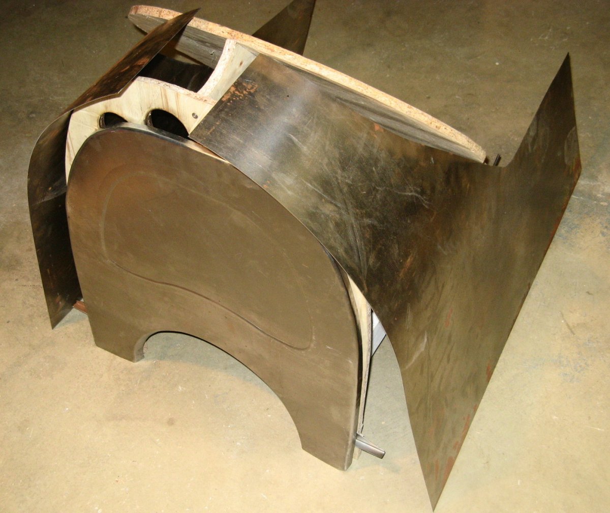

    I did some more work on the driver compartment buck. This buck is a little unique in that I am making it to fit onto the ch***is with the steering components in place so I can shape the body in situ.
    I blanked out the side panels.
    Next, roughed out the firewall with room to fit over the trans hump.
    Then started to fit up the sides.
