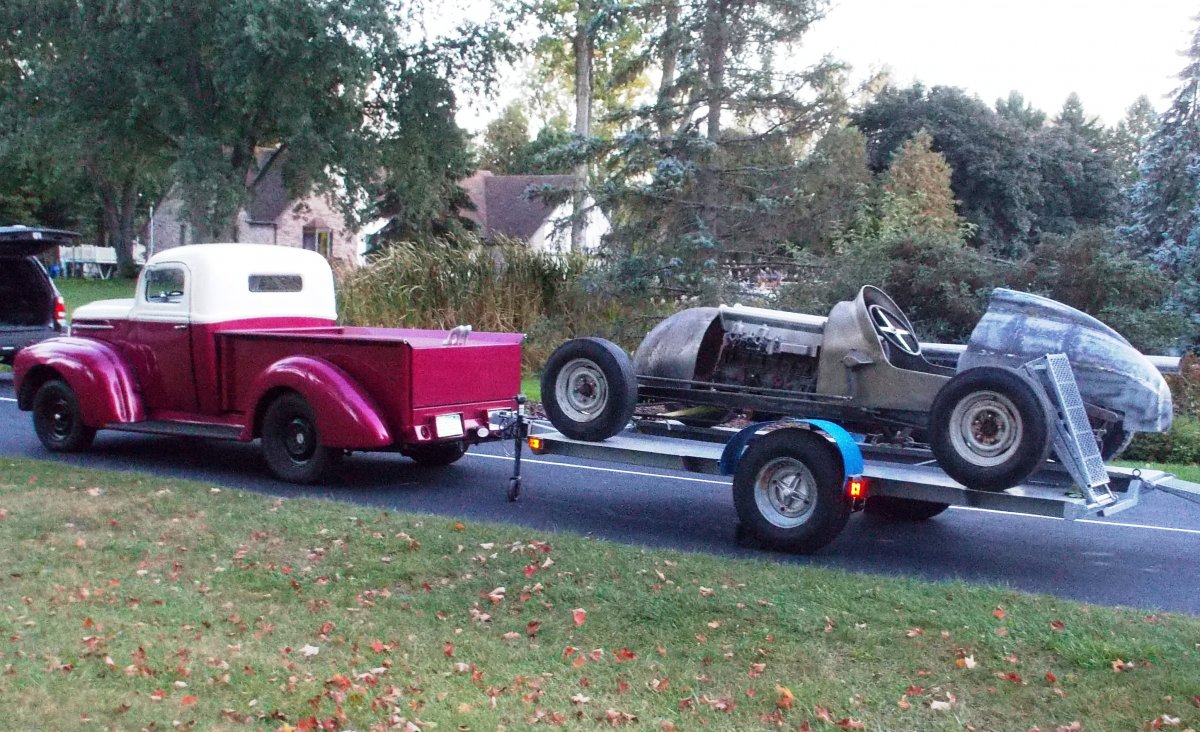

    This project is being housed off site, not at my home / shop. That makes it hard to work on it in short bursts of energy or inspiration. I want to be able to drag it home in short order so I can work on it more. To that end I had started to gather parts together to build a trailer to transport it from my storage site to my home. I have the same problem with my Attic Anglia project. I want to switch these cars around. Plus, the champ car will need a trailer to haul it to the track. Last week I found a house trailer frame for sale nearby and bought it. In the succeeding week I chopped three feet off the back, moved the axle forward, fixed a faulty hitch, mitered in a skid plate to the tongue, added a third draw bar member to the tongue, boxed the front crossmember, added fenders, added three tie-down sites, and narrowed it down so the Anglia and Speedracer will just fit.
    as purchased:
    current mods:
    I also installed a new jack and winch.
    The rear crossmember got a drop-center to facilitate loading and unloading. Ramps are installed.

    The champ car hauler nearing completion:

    I finished the champ car / Anglia trailer.
    The winch is housed in an electrical breaker box.
