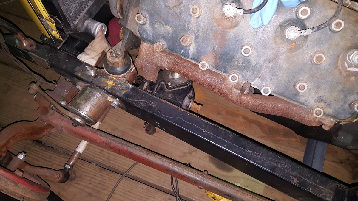

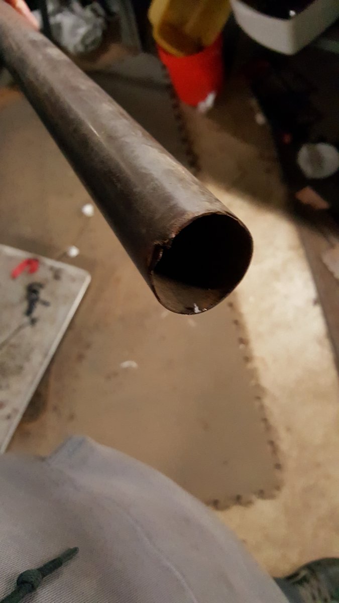

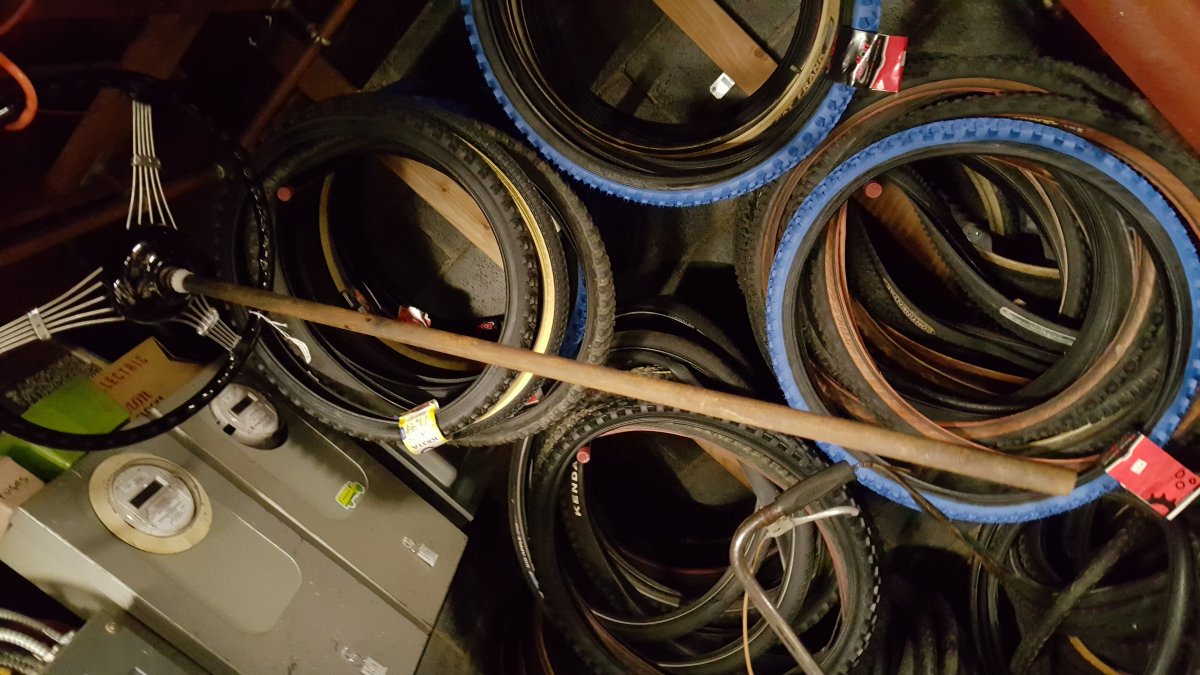

    hey thanks for the reply. i m gona have to post some pics. i may be incorrect in saying i have an f1 box. i am using cross link steering and have the pitman arm under the frame. the box has a spline and is not going to be part of the column. if that makes sense. so on the column i need to fabricate some retainer/bearing system to isolate the shaft and make the unit stand alone. i ll get some pics.

    i have an idea of what has to be done but id like to see if any one else has a plan or suggestions.

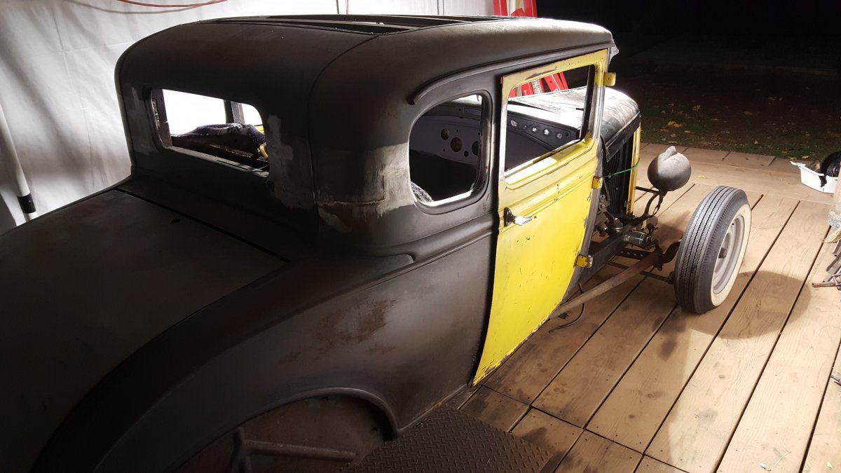

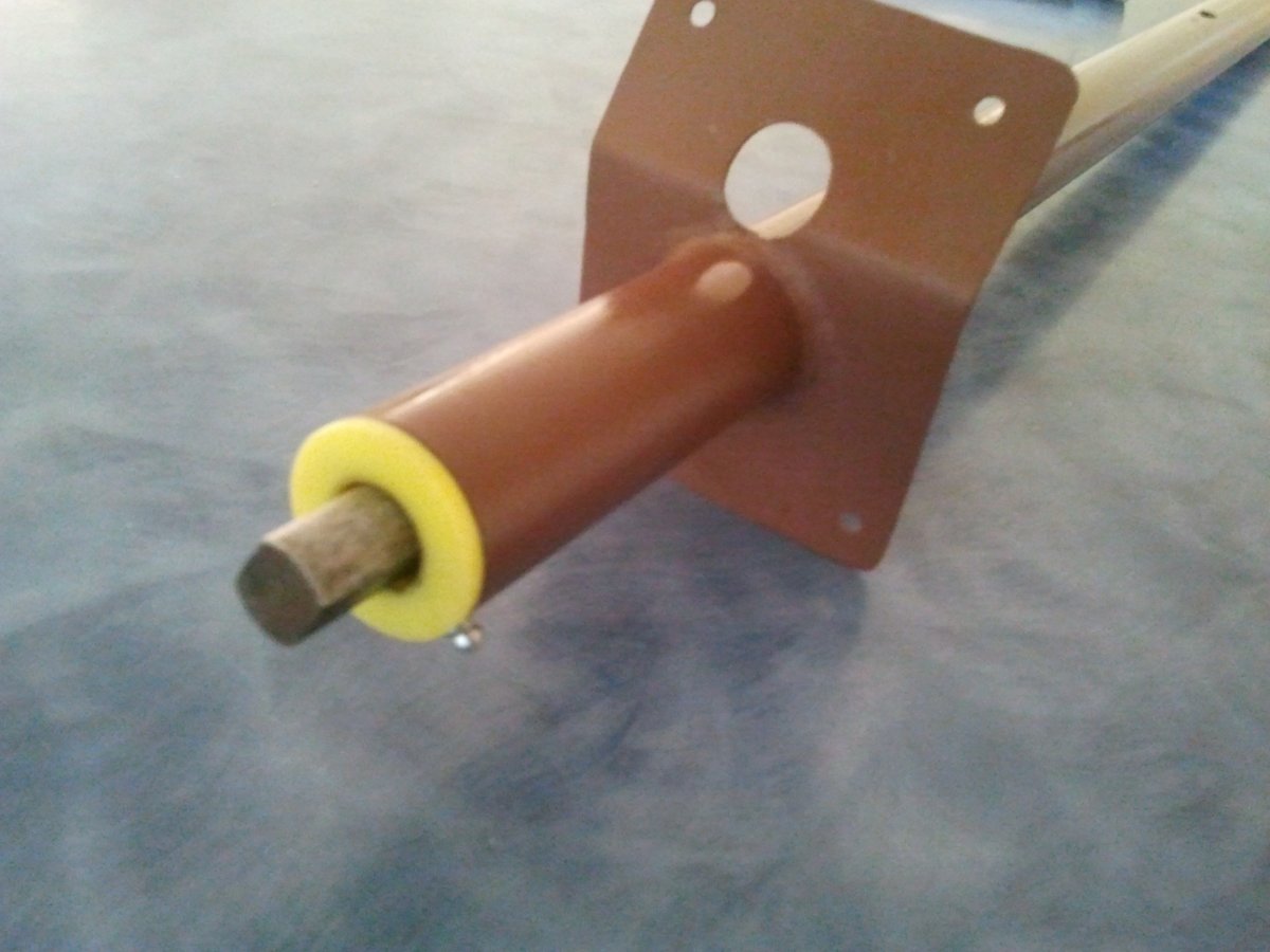

    There is no real load or need for a fancy bearing on lower end of the column.
    I have used hardware store wheel barrow bearing and a 3/4" shaft collar a couple of times at the bottom of a column. The Ford shaft is a little over 3/4" so it needs to be turned, filed, sanded, or reduced in diameter in some manner; but it needs to be reduced to fit a u-joint anyway. The OD of these bearing is slightly smaller than the ID of the tube, a slit in conjunction with the stock column clamp takes care of the difference.
    My kid uses bronze pilot bearings in the same manner.
    I suppose an appropriate sized piece plastic bushing material would work also.
  11. RICH B
    Joined: Feb 7, 2007
    Posts: 5,990
    RICH B
    Here's a picture of what I described in the previous post. You can see the rounded edge of the bearing just above the shaft collar.

    Skotty that sure doesn't look like any F1 box I've ever seen. Who told you it was F1? I'd guess it was a Vega with that short splined shaft coming out of it.

    i originally had a stock frame under my coupe but found a unused socal customs for dirt cheap locally. guy just wanted it out of his garage. it came with this steering box and i was told its F1. so im not certain. as bad as i feel about not using the cars birth frame theres something to be said about a laser straight tigged frame built by a professional frame company for less coin and time it would take to use my oem. you may be correct tho i ll pull it out and compare it to some pics online.

  16. Definitely not an F-1 box. Nice looking coupe!
