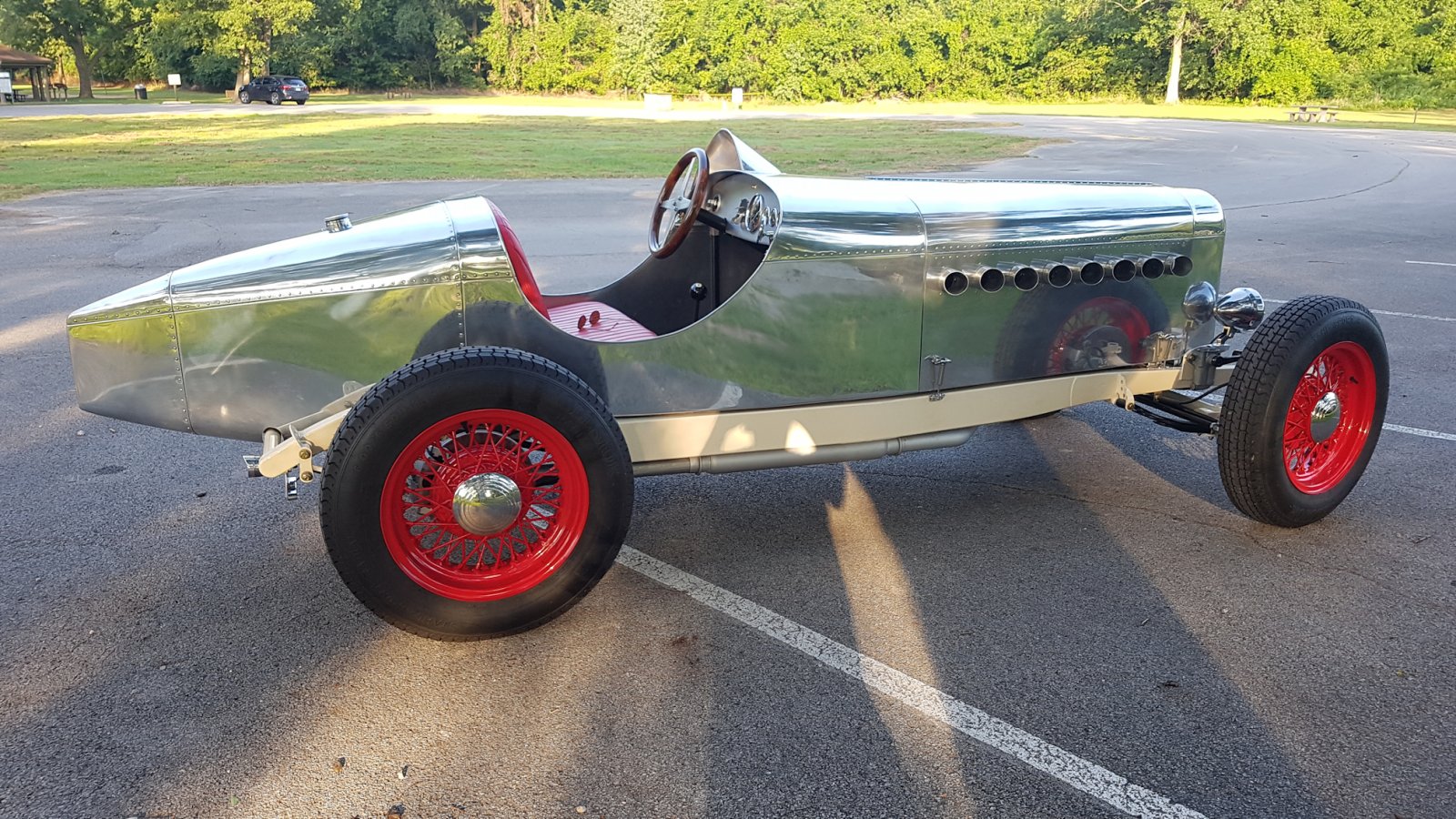

    For years I’ve wanted to design and fabricate a 1930’s style race car. These style cars are pretty simple and are perfect for a beginner. This would be my first attempt at fabricating a frame and body. Over the years I learned paint and body, upholstery and gl***.
    My metal forming started with hammered copper artwork and later the lower cab replacement panels for my 1937 Dodge pickup.
    Also, my first real job was as a design draftsman, so scale drawings were no problem.
    I started fabrication in early 2017 and got it street legal by 2020. There are over 4000 man hours in the car and 95% of the work was done while working a full time job. The end result is a decent attempt for a novice builder. The project was challenging but well worth every minute.
    It's called the "Oden Special"

  25. Jay A Driggars
    Joined: Feb 18, 2018
    Posts: 88
    Jay A Driggars
    The original plan was to use a straight 8 or 6 cylinder engine. A 1970's Jaguar XK6 engine popped up on Craigslist early on during the build but the seller didn't know anything about it's condition. I p***ed on the XK6 engine as it had the later style head with square valve covers and no idea if it was rebuildable.
    A local guy offered me a 1939 Hudson Straight 8 Flathead, it turns out the engine weighed a 150lbs or more than a SBC and it had m***ive 70 HP, decided to p*** on that.
    The Jaguar XK6 was my choice for an engine until I found out what it would cost to rebuild one and there's no engine builders around here that know anything about them.
    I decided to use a stock SBC as I had no idea if I could even complete the build.
    With no access to a louver press I added the 16 tubes to the hood to let the heat out.
    Here's a list of the components:
    Engine - SBC 350 crate engine, Edelbrock 3x2 intake with Speedway Motors Stromberg 97 copies
    Ignition - Pertronix Distributor and coil
    Transmission - Borg Warner T5
    Clutch - Stock Pressure Plate/clutch, Wilwood pedal/master, Mcleod hydraulic throwout bearing
    Differential - 2000 S10 Blazer with a custom made Torque Arm
    Front Axel - 4" drop tube with Speedway Motors GM metric calipers and panhard bar
    Shocks - 1960's MGB rear shocks used Front and Rear
    Springs - Late 30's - early 40's Ford pickup leaf springs front and rear
    Steering - Vega manual box
    Brakes - Wilwood pedals/masters, front calipers Speedway Motors GM metric, rear calipers Blazer
    Master Power/Ignition/Starter switch - NOS Delco Remey WWII B-26 bomber magneto switch
    Weight - approximately 1350lbs
