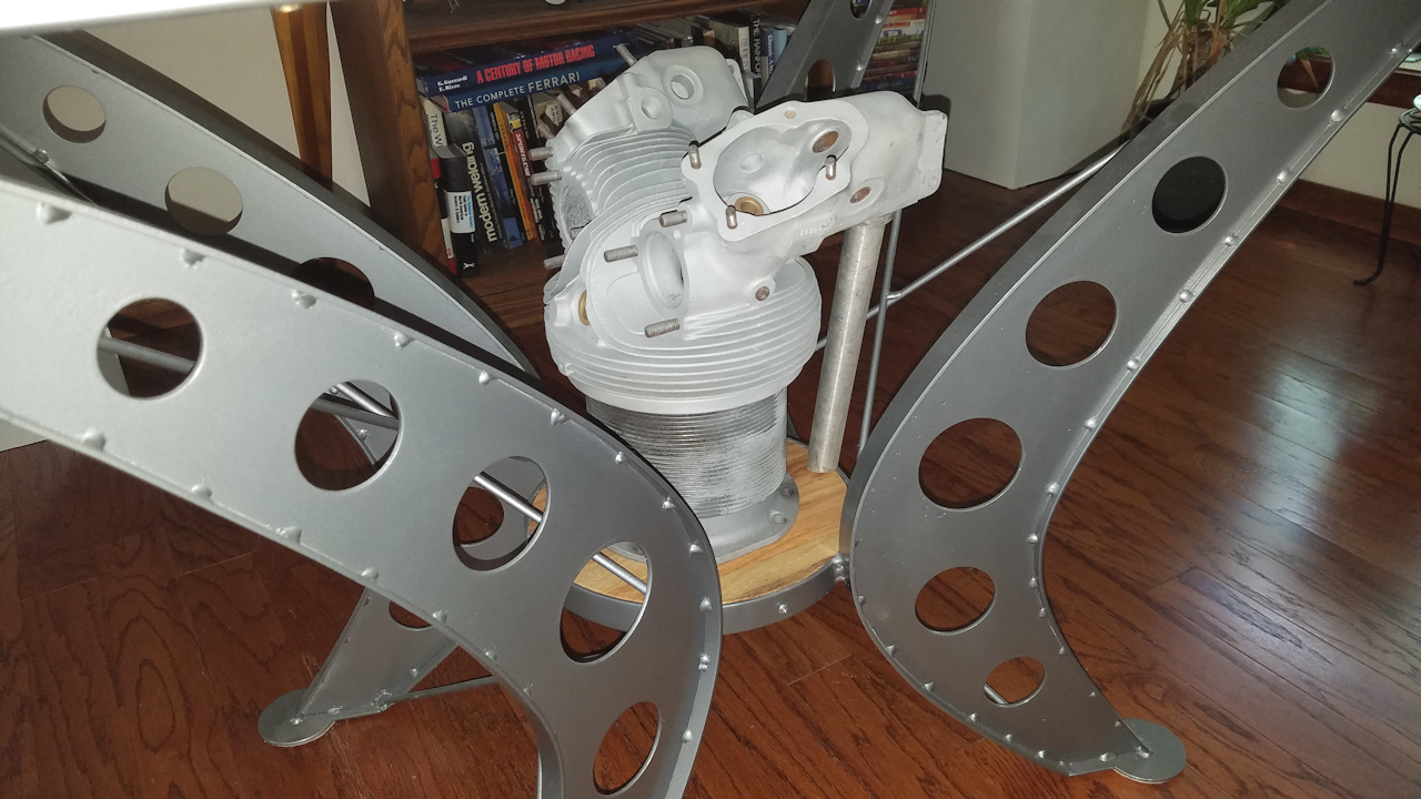

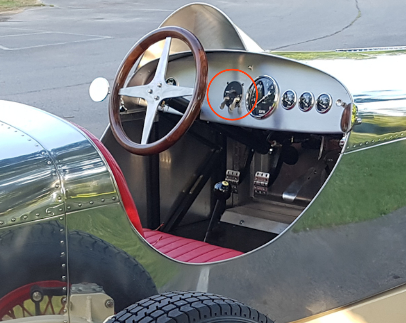

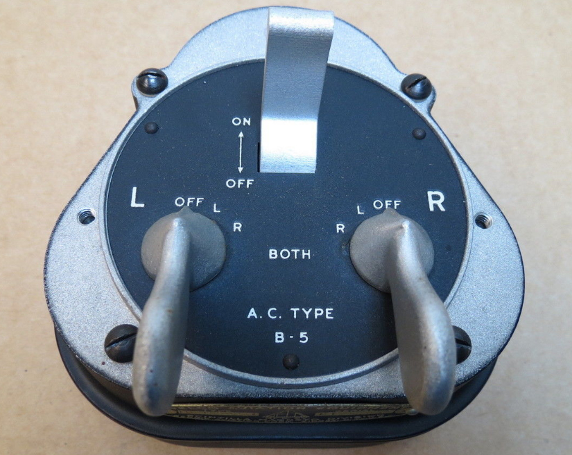

    I also built my share of airplanes. The cars Main Power/Ignition/Start switch is the magneto switch from a WWII B-26 (A-26C) bomber, I modified the switch to fit the application, it's the most complex mechanical switch I've ever seen.
    The switch started a conversation about aircraft and the guy happened to work at an aircraft engine rebuild shop that specialized in radial engines, he gave me a junk cylinder from a Pratt Whitney radial engine. That cylinder starting me on a path to industrial furniture design like in the attached photo, it's my new design table.
    B-26 Magneto Switch.jpg Magneto Switch.jpg Oden Switch.jpg Design Table.jpg Radial Cylinder.jpg

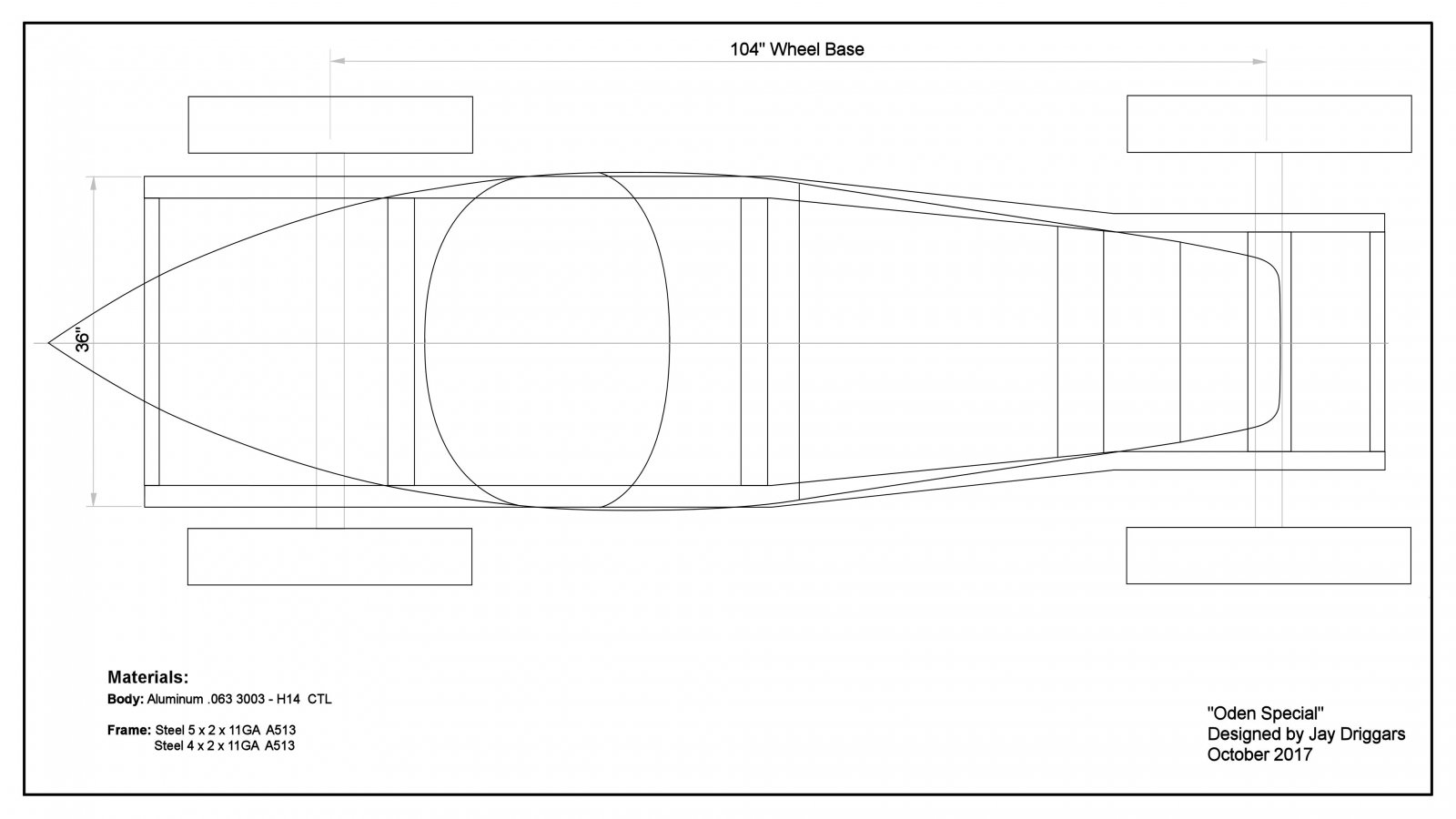

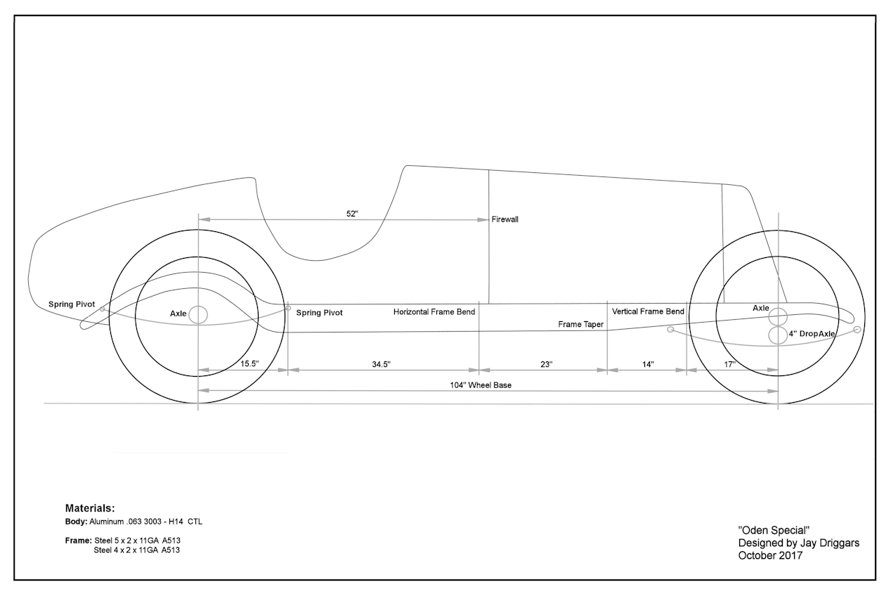

    The application for the Oden Special was an “Affidavit of ***embly and Ownership”. Receipts or Bills of Sale, drawings with side and top view and detailed build photos were included, there were 7 photos. Oklahoma requires the vehicle exist at the time of application and if the application is approved you must present the vehicle to the DMV(local tag office) within 30 days. Once my application was accepted I took the vehicle with a VIN tag attached to the DMV(local tag office) where they verified the vehicle and the VIN location. I paid the taxes, got a Tag and the ***le was mailed to me.
    I had receipts for the body and frame materials, engine and transmission. I fabricated the frame so receipts for the materials were included, do***ented the fabrication with photos. The photos should also illustrate the overall progress of the build. A photo of the proposed VIN tag location should be included. If Bills of Sale are used it’s best to have them Notarized. The drawings were vary simple but did at least show some basic shape and dimensions. The DMV contact person said it was the best do***entation he had seen, the application was approved in about a week.
    I was risking money and labor without knowing if it could be done or if the state would accept my application after completion.
    The form below is what I submitted to the DMV.
    Form761A.jpg Drawing Front View Final Print.jpg Drawing Top View Final Print.jpg

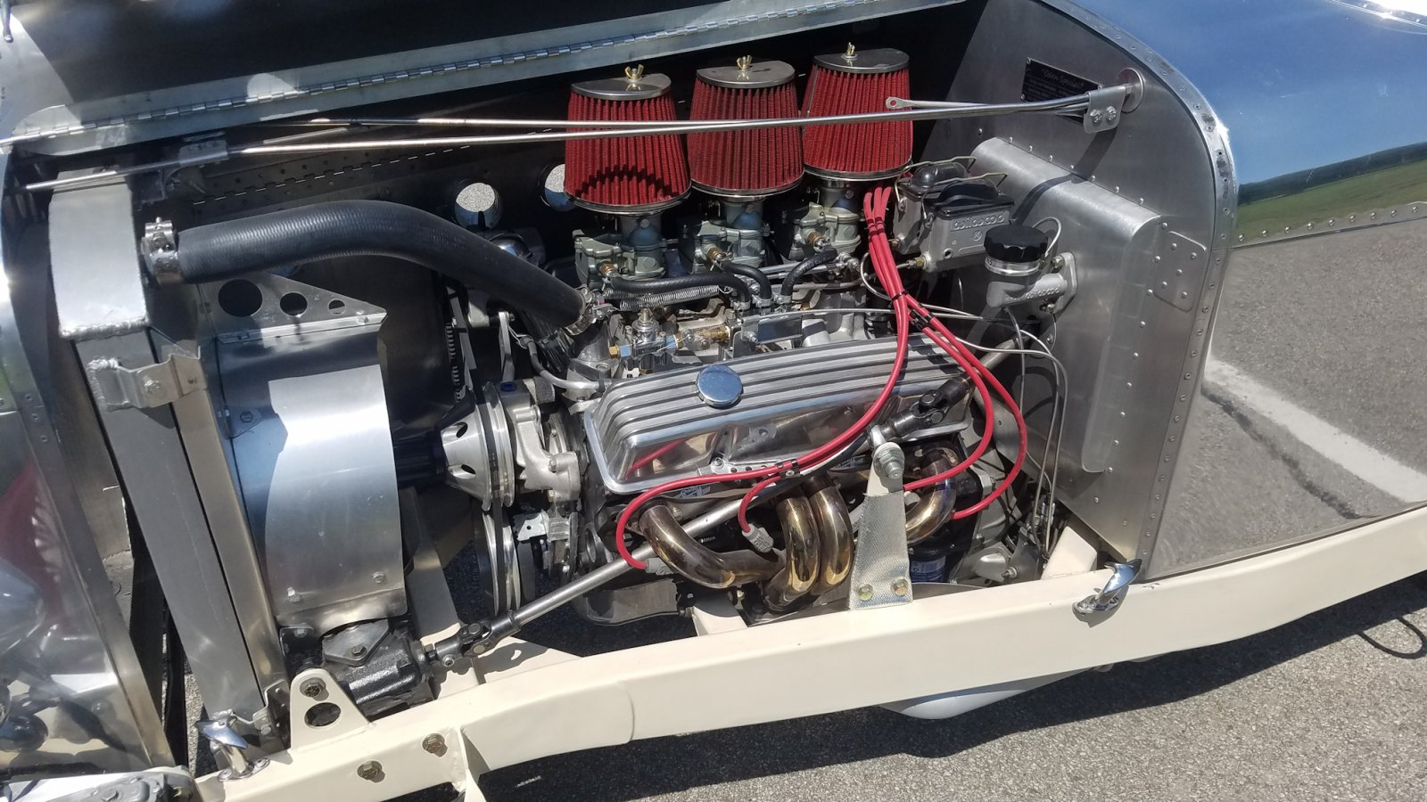

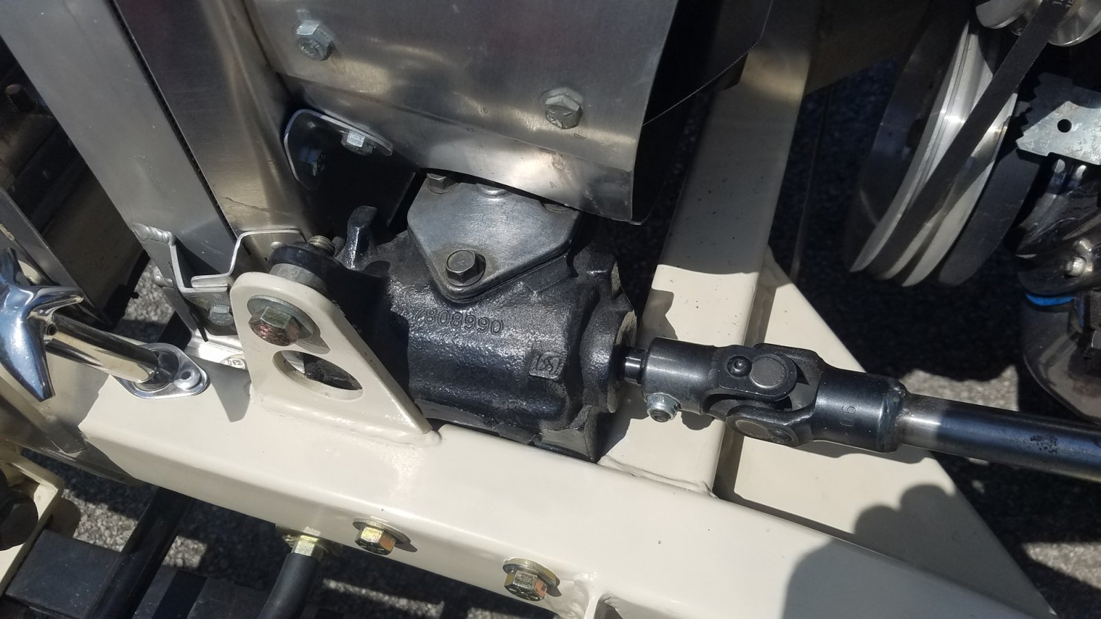

    Here's some more pics
    Interior.jpg Engine.jpg Front Suspension.jpg Steering Box.jpg Front Shock.jpg Rear Shock.jpg Torque Arm.jpg
