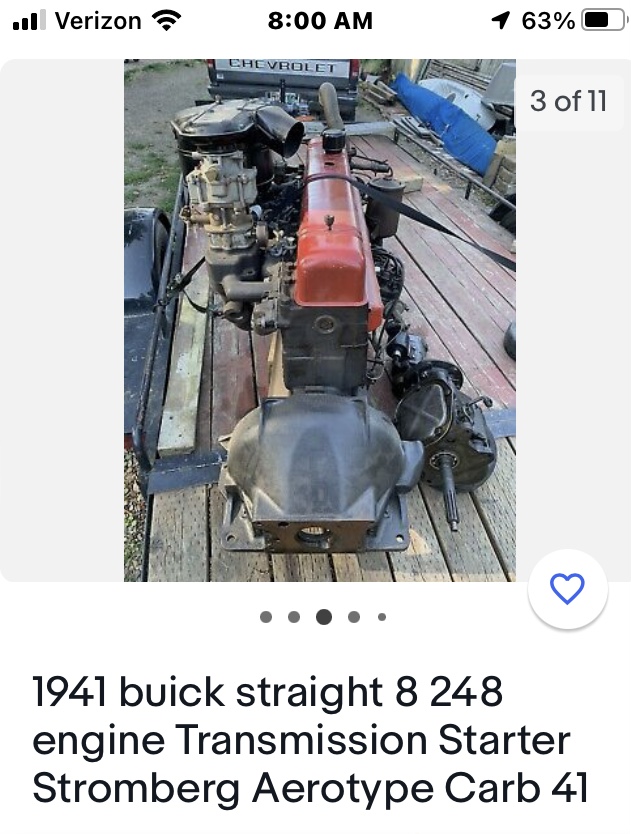

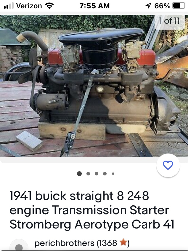

    2250 bucks for a proper engine, this one even has the compound twin carb only available in 1941!
    You can get more for that SBC or trade it for this. About 120 Hp.
    https://www.ebay.com/itm/134159694384?hash=item1f3c8a7a30:g:Z6wAAOSwZ61ivPa-

    094BFCD0-6985-4973-9761-77762F42BAFB.jpeg 0345C98F-4B91-423F-AE5A-5B508579FC0C.jpeg
    I saved images of the proposed replacement engine. EBAY images tend to expire so you cannot reopen the page in the future

    I tipped about the same engine on Ebay ! It is a great candidate for this car!

    That is definitely a great engine for my car.
    The seller is asking $2250.00 plus $1500.00 for shipping, plus $250.00 tax that's about $4000.00 for an engine that may or may not run or be rebuildable.
    If it ran as is that would be great, if it needs a rebuild, it could cost several thousand more.
    The so called benefits just don't add up for me. If I ever come across an engine locally that runs as is I would definitely go for it.

    The 1500 is painful for the transport! Also the early ones have babbit bearings making a rebuild costly, and many do not want to mess with that.
    Keep looking :) The perfect engine WILL show up! I was lucky got a well rebuilt Buick 320 Cui straight eight for 4500 bucks including a ***led RUSTY car.
    A running non smoking straight eight or maybe a flathead V12 would be great.

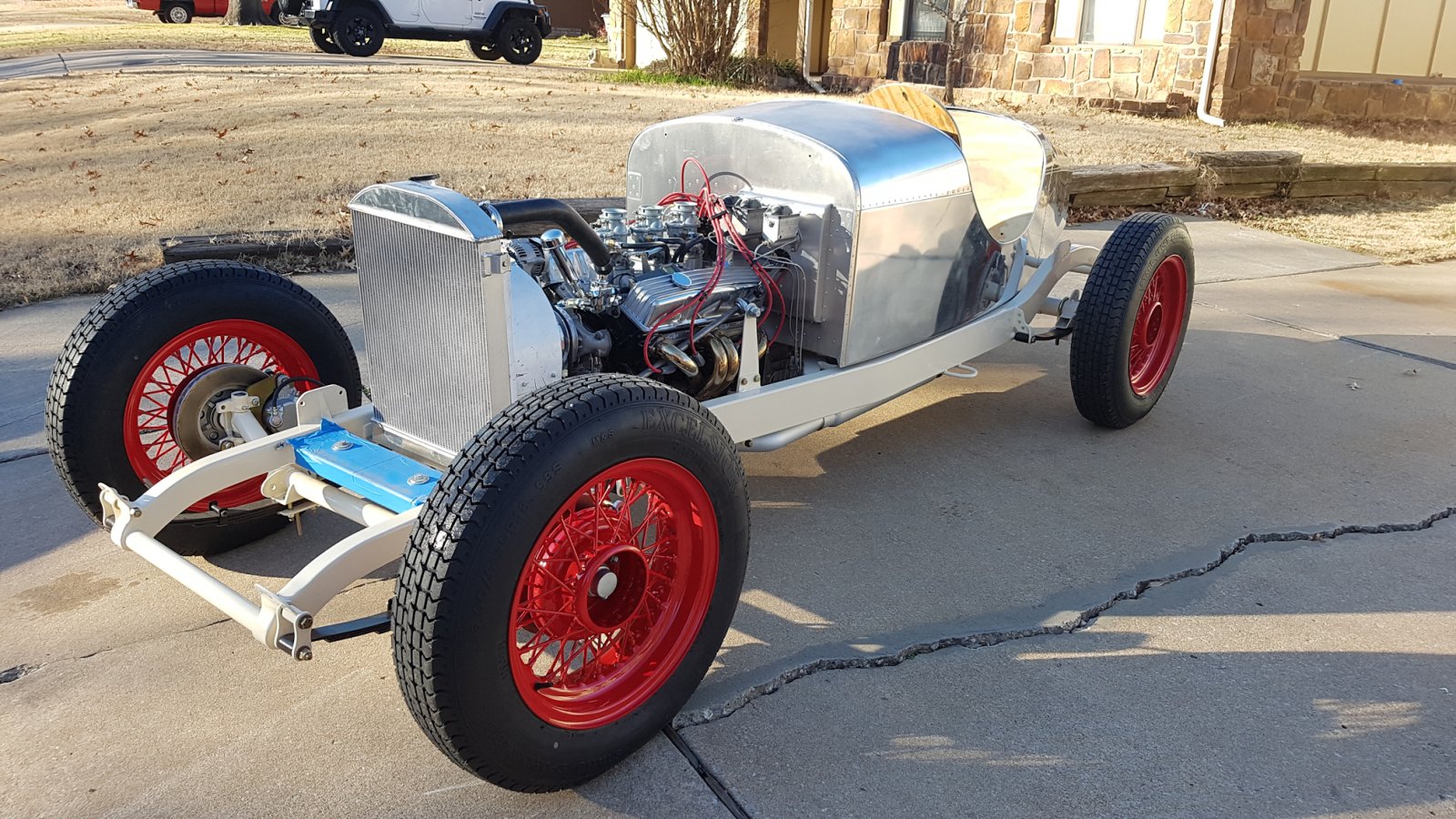

    A question regarding the body. Did you plan it so you have NO welded joints in the body, but rivets/ screws, and par***ioning lines, i.e. great planning, and design to work around the issues. Or do you have panels with welds that are perfectly metal finished, and polished?!
    Both ways are hugely impressive. Just wondering if you worked to avoid welds in panels (hard) or if you managed to get them so perfectly worked out (hard).
    What kind of fasteners did you use? Pop rivets..., real aeroplane solid rivets or did you use screws?

    I designed it with no welds in the body, but the lower 5" of the tail piece was welded with a spool gun, don't have Tig welding skills. The scale drawings were laid out with bulkheads in the same approximate position as the final product. The first buck was cardboard with thin wooden battens for the contours. I used the cardboard bulkheads as patterns for the plywood bulkheads, they gave me the final shape for the aluminum bulkheads.
    The body skin is attached with aircraft rivets, the cowl/firewall was attached with countersunk pop rivets. I did all of the aircraft rivets by myself, except for 10 rivets in the tail, it was not possible for one person to do. Installing aircraft rivets by yourself is not an easy thing to do. I spent several hours fitting the skins so that the seams lined up. There are 4 stainless ****on head screws where the body frame blocked access to the backside of the skin.
    The body design is simple as I do not have enough experience to create compound curves. If I was a skilled coachbuilder I would have built a car like one of the Miller's.

    Thanks for your detailed answer. How thick is the part you welded with spool gun im that tail piece? Not having welds in panels all over but rather put the par***ion lines in adequate places was a smart move to avoid weld distortions that are very hard to iron out perfectly hence making a polished body very hard to perfect. I weld panels of 0.063" alu with gas (Oxy-Acetylene), low pressure regulators, and special flux, makes for very workable weld compared to the more brittle TIG welds but there is as in all welding distortion, it is not so hard when you can still use the English wheel on the weld, but if you cannot due to size hammer, and dolly work is possible but it is hard to make it perfect as for mirror finish.
    I am sure you will be able to do compound curves in the future if you would like too.
