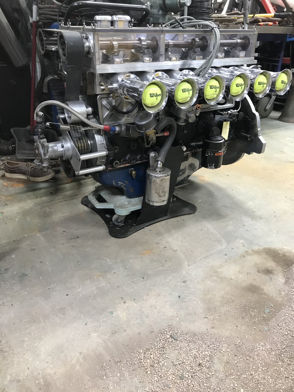

    What engine is this?

    Its a Ford truck 300 with a special head. I'm hiding the ugly valve cover with a pseudo DOHC cover, looking for that old Duesenberg vintage look.

    ^^^^ What big 6 is that?? Plexigl*** cam covers?

    Worked for me
    Ford 300 truck w/ a one-off head.
    Okie Pete and brEad like this.
  22. Very nice looking
  23. 300 ford 6
