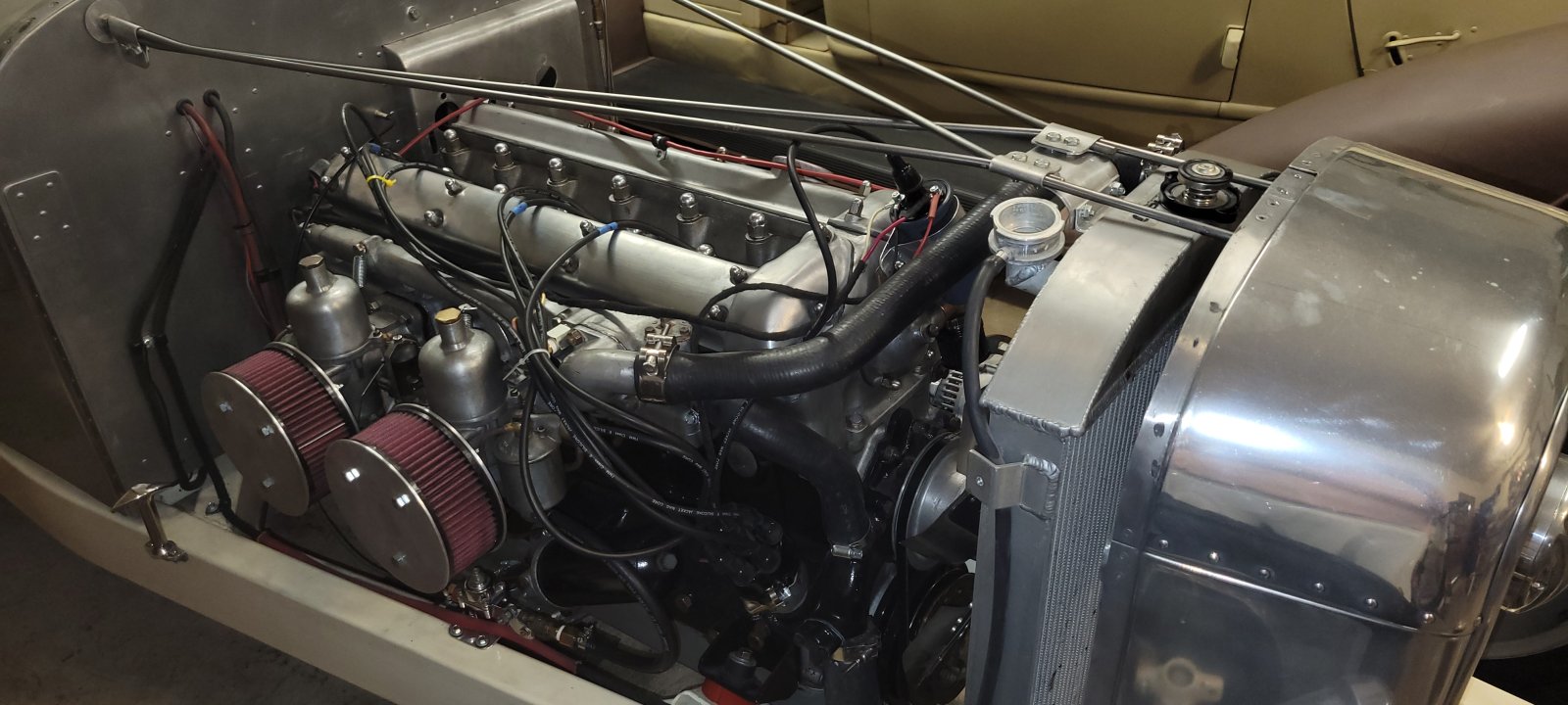

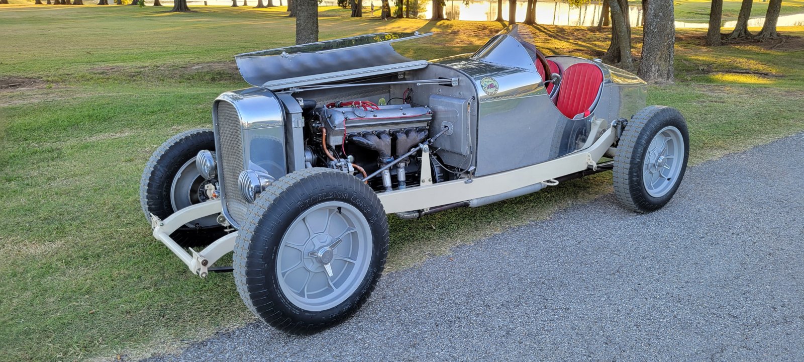

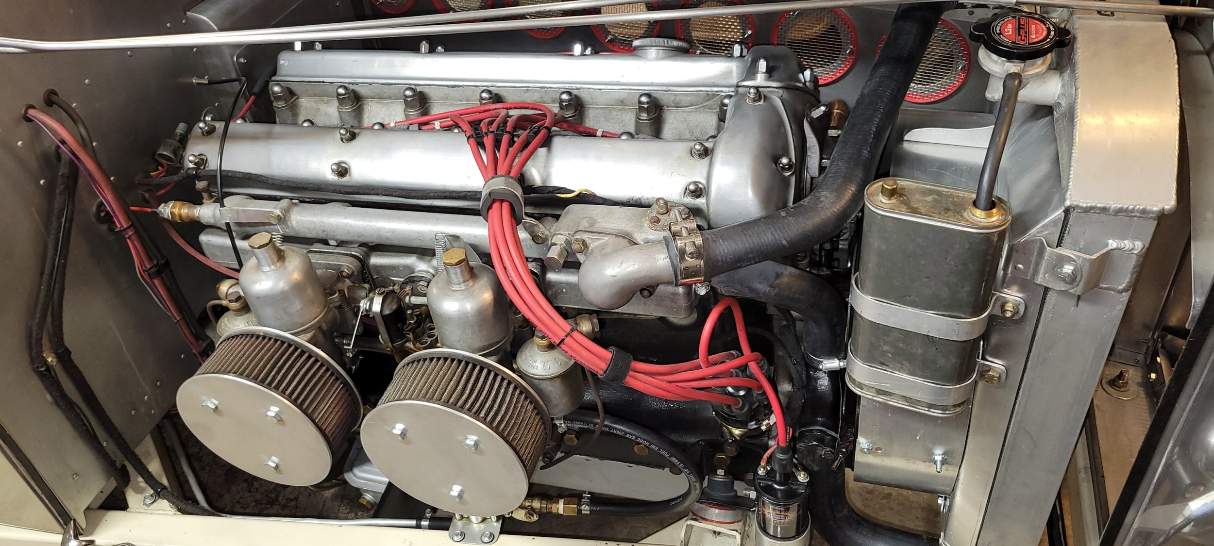

    Left Side Front_2.jpg Engine2.jpg Right Side Front_2.jpg Right Side Rear.jpg Here's some new photos. It's running great now, and it's so much fun to drive.

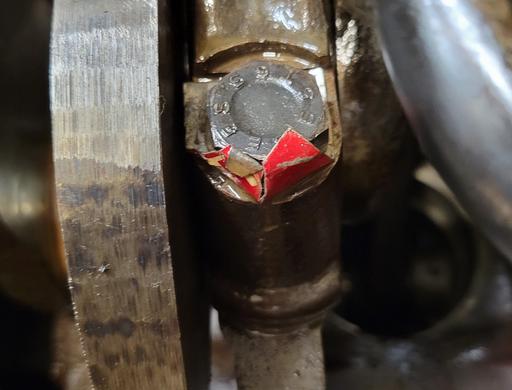

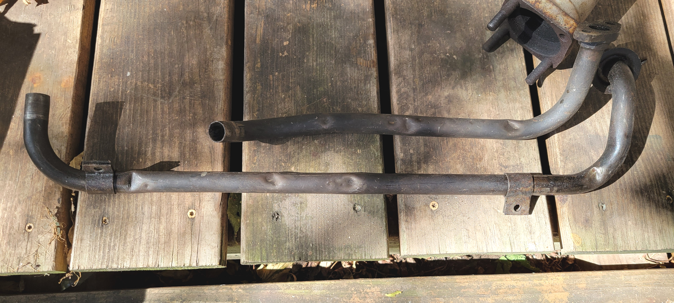

    The Jaguar 3.4 that's in the car now, appeared to be a collection of parts. The head and the block are matching casting number. The oil pan was most likely from a different block, as were the sump pickup tubes. The pan and pickups were both damaged by metal pieces bouncing around in the pan.
    There were some odd things also, like one of the main nuts was secured by a tab lock washer made out of a tin can.

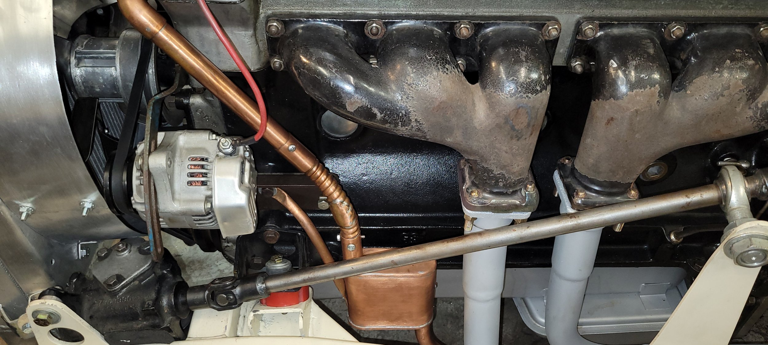

    I recently completed a few updates and fixes.

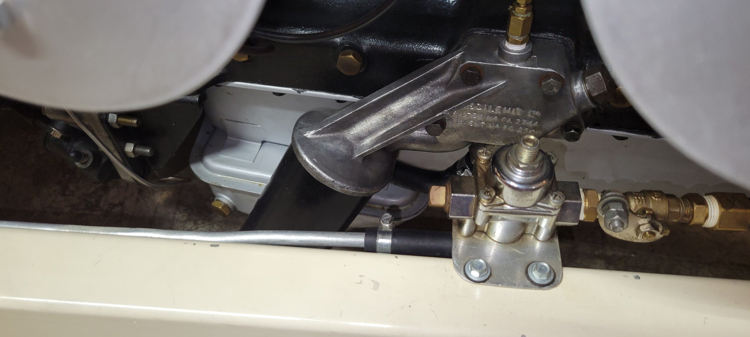

    The oil filter pointed downward, no oil in the filter at startup. This caused the oil pressure to delay at startup. I replaced the oil filter ***embly with an up facing filter, proper oil pressure at startup.
    The sump was damaged and leaked lots of oil. I replaced it with one in excellent condition, with no oil leaks.

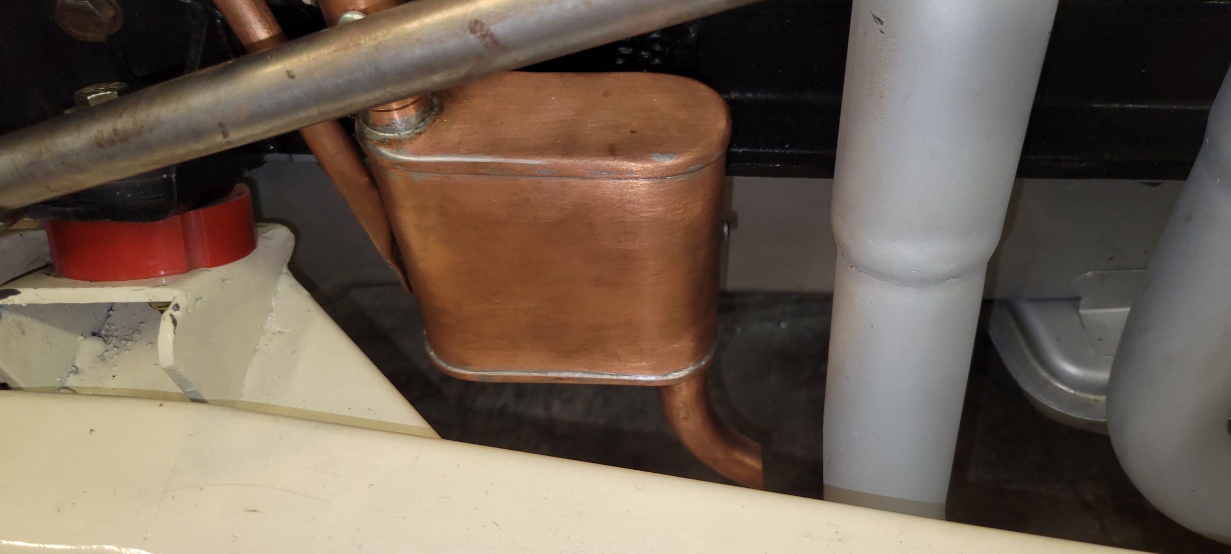

    I added a fan shroud too. I used a small kerosene flask as an overflow tank.
    It's been a while since I worked with copper, so it's got a custom copper catch can now.
    There are still a couple of minor oil leaks, one's the intake cams oil feed inlet. Someone had damaged the banjo bolt threads, so I had to install a heli-coil insert. I tried new copper washers and crush washers; it still leaks a little. It might damage threads if I tried to tighten it more.
    It recently started leaking a lot of oil from the rear transmission seal. The seal was replaced during the rebuild. I have another new one on order. The yoke may have a groove in it where the seal sets.
