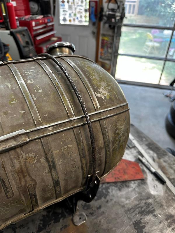

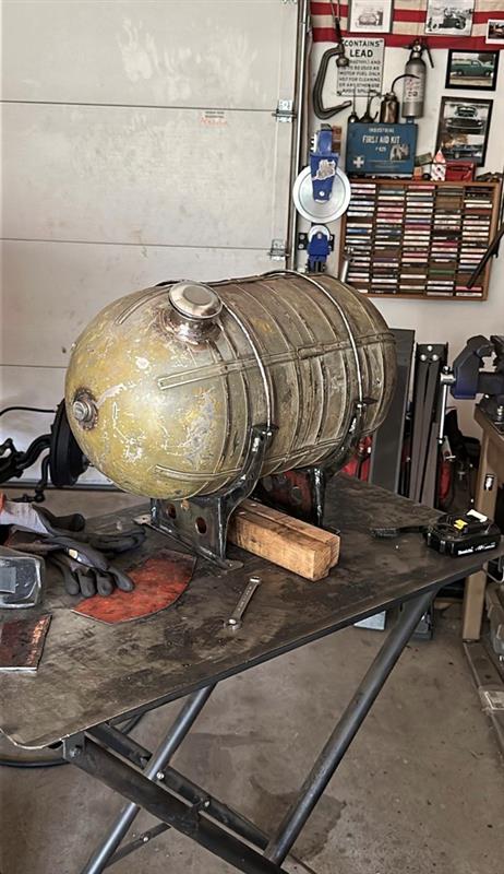

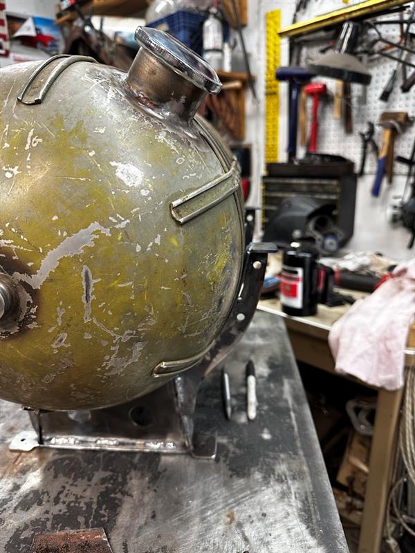

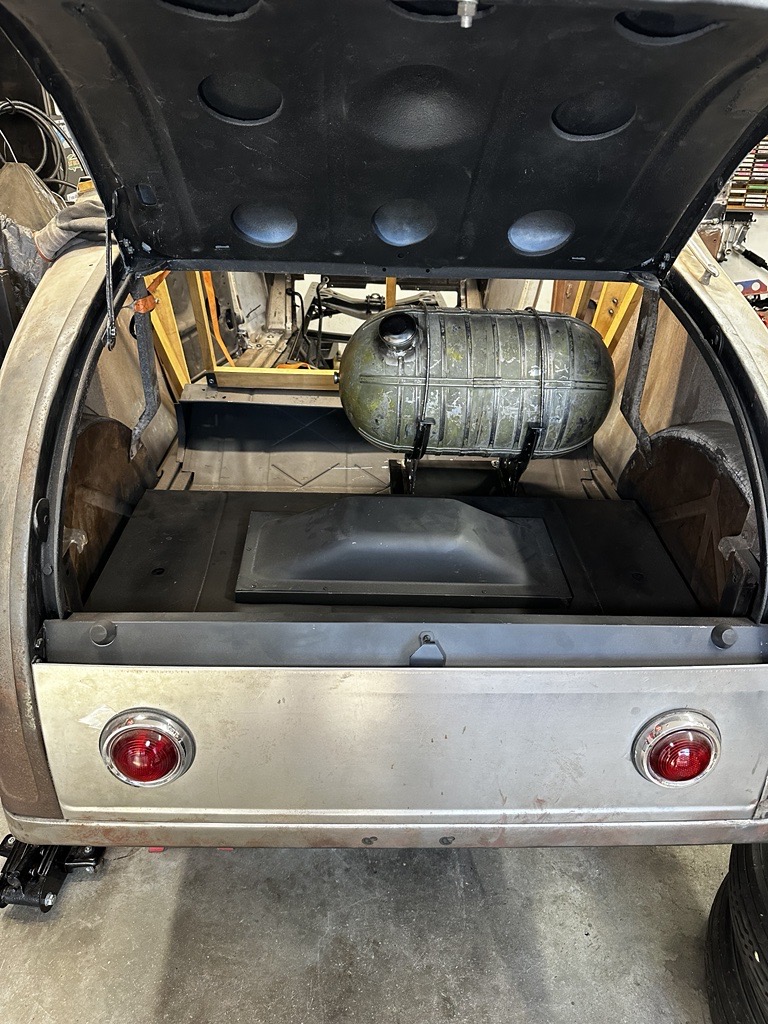

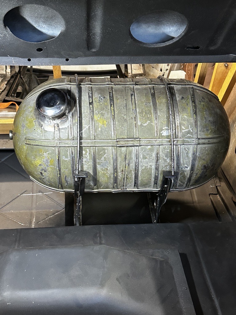

    Been a Minute since I updated here. I have been hitting the Car and hope to get it to LSRU this year, fingers crossed. I have been really busy with work and a large screened porch project and a car meet I put on here twice a month here in Austin TX. Enough with the excuses. Here is a photo of the tank mounted in the trunk. I plan on running lines as soon as I get the exhaust planned more. Image (1).jpg Image.jpg

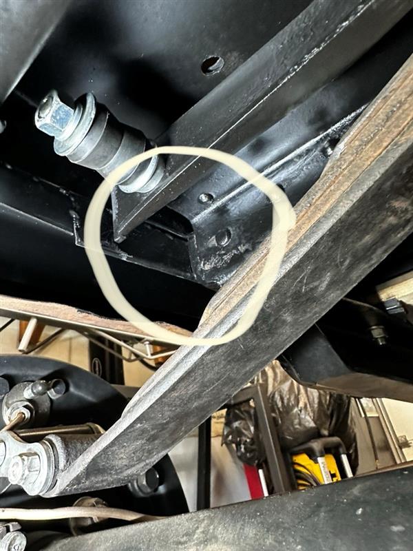

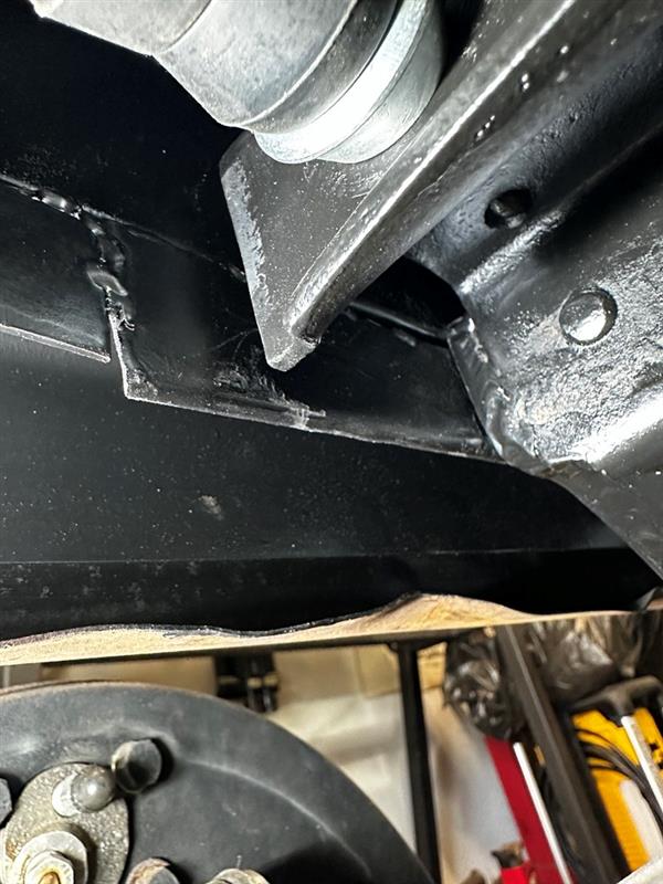

    After I got the body back on the car I noticed a few issues from moving this jalopy roadster around that it wasn't fitting back on the frame as well as it had been sitting. I have a buddy who used some boat trailer roller rubber guides as shims and ill say it worked really well for the areas i needed more shim than i was getting from just the stock wood blocks. They also worked really well for under the cowl instead of buying the stock rubber ones. I also noticed the back of the car was not sitting correctly. I realized with I put on the fish plates to strengthen up the step in the frame it added some width to the frame which was not sitting square under the boxing I put in for the trunk floor raise for the rear end to come up through. Once i realized i was able to take the body back up and shave down the plates to make room and it was fine. Being new as building a car in this fashion i have made so many steps forward with out thinking of how it was going to fit on the car. 91c68648-ce26-465f-bf3d-4fb7bf1e73d1.jpg 9995d37c-65ff-4dec-87c0-c51f74e7e1de.jpg 042a6dc8-cea5-4d49-a8b5-eb17cddb2ab8.jpg eedc7b59-3d2c-419b-9bf2-8f4f84401a09.jpg

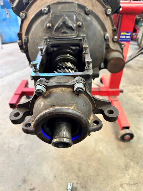

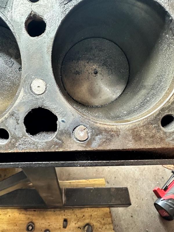

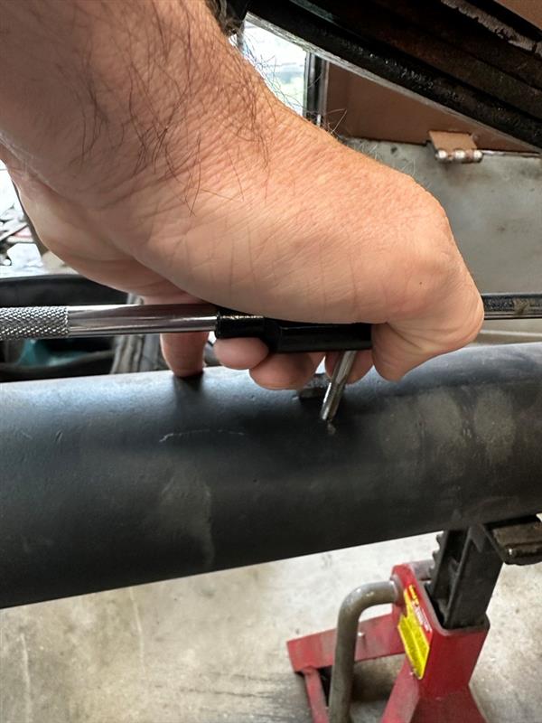

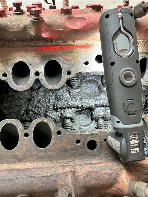

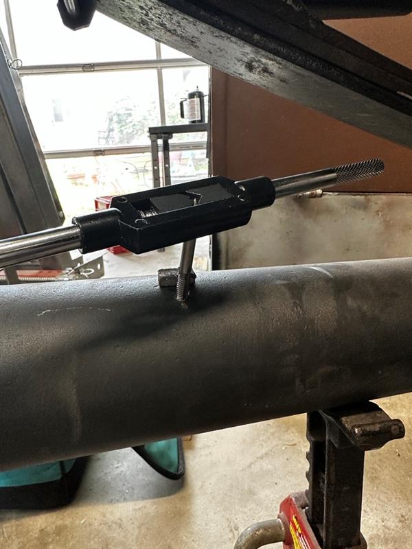

    Next up was tackling the rough motor I have that is a runner but still rough. When I bought this motor a few years ago I started it on the ground and it was running pretty well. With this purchase I was able to get a good bare block but I don't have the money to dump into that block yet so I am going to overhaul the runner. This is a 8RT motor from what I can tell. When I took the intake off and found how crusty the valley was I was struggling to keep moving forward with this motor but like I said finances kept me hoping for a win here with this one. I broke two head bolts of course taking them off. I tried all the methods of removing the broken bolt, but had to end up drilling it out. Extractors and welding on a nut were useless attempts. I followed one of the tricks I saw in a book where you put the head back on and buy a drilling sleeve and insert it in the head bolt hole and use a vice grips and make a punch then drill it out. I was unable to find the sleep I needed so I had to buy a larger size and shrink it some which I don't have a lathe so I used my bench grinder. I tapped and amazingly it seems great. Now once I get this running I ***ume they may weep. Sadly I'll have to cross that bridge when I get to it. 69aa3188-cea1-46c1-8efa-cfa89b7b3a51.jpg b29c7290-c44e-4105-ab86-ed2944ad6439.jpg d1e6c765-1179-49b2-9e98-2b2ffddbed83.jpg

    After I was able to retrieved the broken bolts and felt that the taps were good enough I moved forward with cleaning the block the best I could with out taking it completely apart. I used compressed air to do a lot of the coolant lines and diesel fuel in the valley and a mix of acetone and auto trans fluid as well. It is far from perfect, but it came out ok. 478fa55d-8143-4f99-affe-46747341b428.jpg

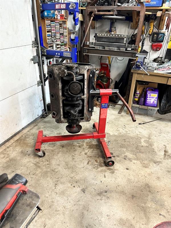

    Being my first flathead to pull apart seemed as if there was some repairs, but nothing was jumping out at me so I continued to move forward with the overhaul just cleaning and re gasketing basically. When I had done a compression test when I had it together all cylinders were coming back about 90 to 100 aside from number 1 which came back 80. I got a kit from Best Gasket and cleaned and installed and all went well. Cleaning that old dog got me dirty as hell many times. 3ad0f67b-470f-4a65-8595-0b53c4329204.jpg 82e3ed7d-015c-41c2-9a07-2a00067a6a1e.jpg 109796b1-e9f8-4abc-8a9e-d35f0e2da753.jpg

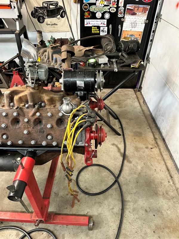

    After I got it all back together, figuring out how to run a pulley mounted fan off the generator is my next task. When I had mocked everything up before, mounting the fan in this way was my only option. So I got a '36 generator with the fan mounted pulley and shaved off the mounting ears and used the 8BA strap. I had to drill a small hole in the generator for the ****** in the 8ba strap to sit on, but other than that it was easy. The earlier generator was also smaller in size so I cut back that strap and welded it back together. All in all it worked great. This generator has been rebuilt for a 12 volt, but its untested till I get it running. Alot of fingers crossed here, if you have been following along I've been doing that the entire build. 1621c182-41c6-4132-a85b-82a640c6b054.jpg

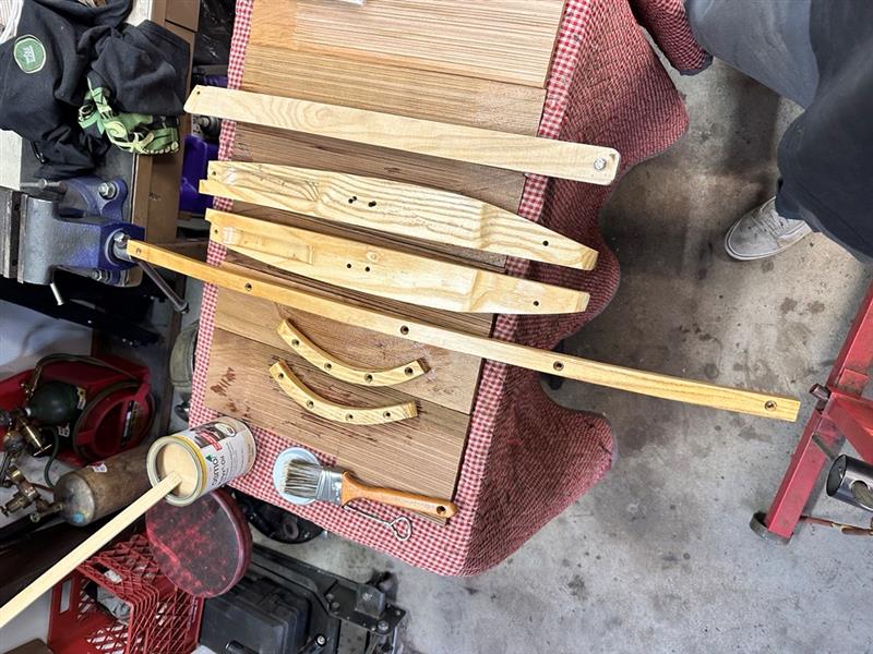

    I was dreading taking the wood kit back out of the car to seal and stain it, but now is a good a time as any. I used the Osmo Polyx Oil. Worked so well and came out great. I brushed it on, let it sit then scuffed then added another coat and scuffed. 7f6a36dc-d8a2-4592-bac8-3beed464abe8.jpg 9f731397-e149-4a9d-803f-b71c3a6f90d5.jpg

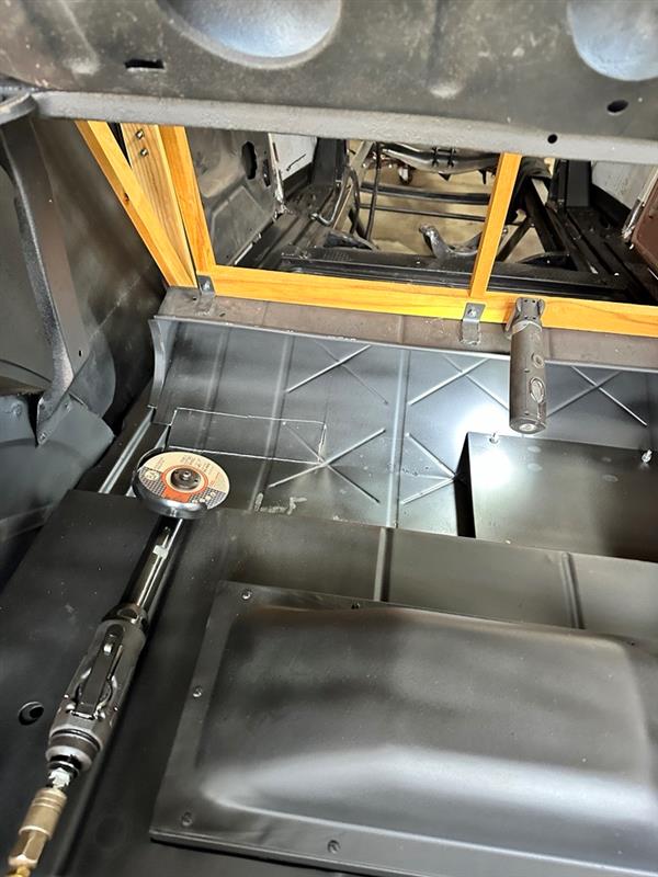

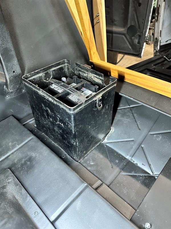

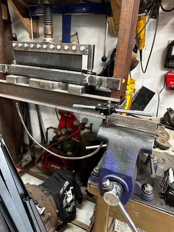

    I realized I had not thought threw battery placement and knew i wanted to run a box. I found a box from maybe a tractor or a utility vehicle from the 50s give or take. I had to make a couple of relief cuts to make it fit, then welded in some of the left of sheet from when i built the trunk floor. Highly recommend that Eastwood Extend cut tool.
    Squablow likes this.

    Loosly have it sitting on the open flat of sheet here.

    Will need to make a vent out for the off g***ing or get a gel battery i guess, but its looks neat and tidy.
