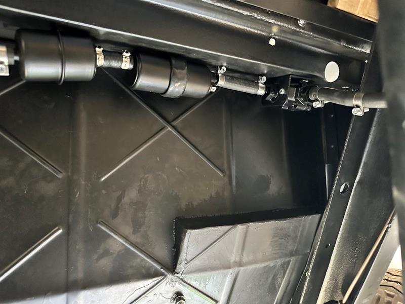

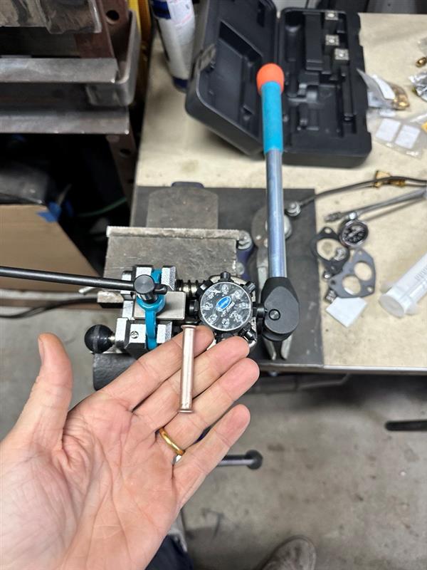

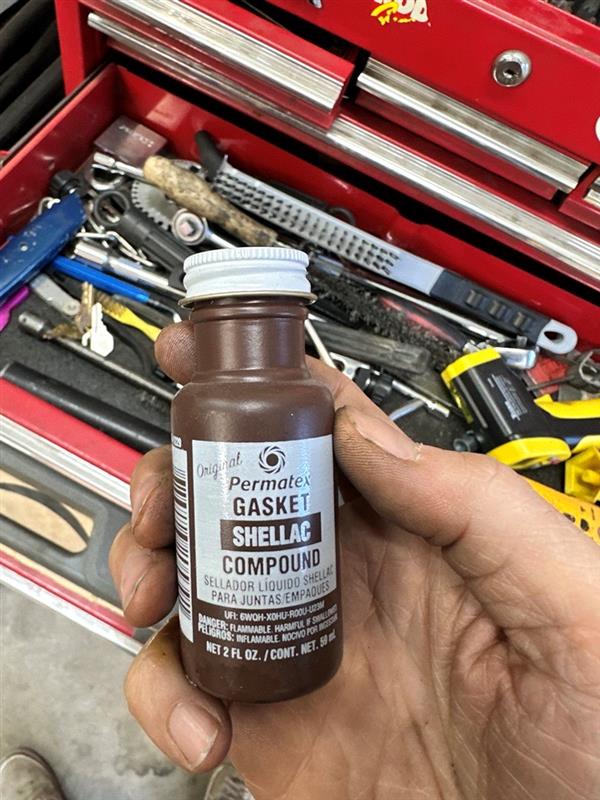

    Added the fuel line in the last couple of nights after work. 5/16 nicopp line, carter inline pump, holley regulator. I used some of the permatex indian head stuff on the threads of the tank out just in case. I used soft lines from the tank to filter/pump/regulator then to hard line to the front. Thinking my regulator being at the start of the fuel run might be an issue, but ill see when its running. I wanted to hide all mentioned items as much as possible. I will need to insert some grommets around holes the lines goes through in the crossmember. I used the Eastwood Flaring tool again, and cant recommend it enough for this kind of work. I am planning on running a single carb with the Canadian intake got, but i will still use the fuel block up front so i can have a fuel presser gauge, mainly just for looks. Next i need to start plugging some of the holes in the firewall while the motor is back out of the car.

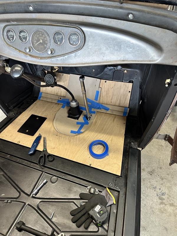

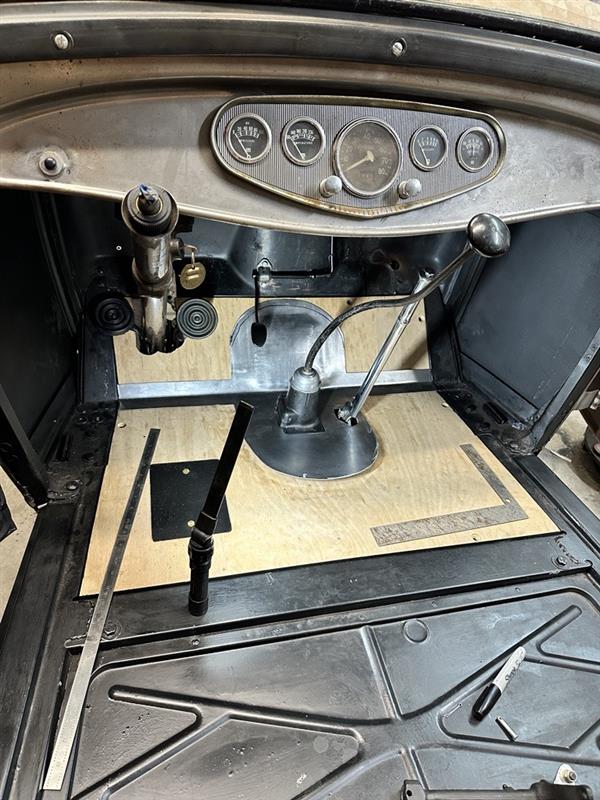

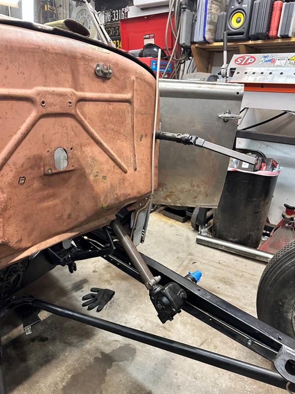

    Been taking care of last little bits on this car recently. Needed to figure out how to gain access to the master cylinder so I made a very simple plate and used a router to recess the plate to make it sit level. Nothing fancy again, just good old garage built stuff here. I still need to seal the toe board and floor board. The list is getting smaller though.

    I used that Indian head on vintage mopeds years ago

    It has a smell that is so odd and I love it.

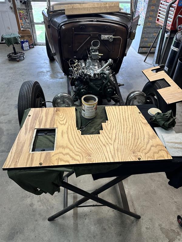

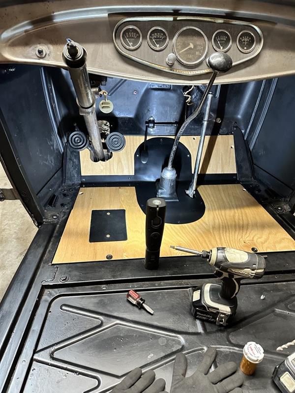

    Next I tackled the floorboard insert to meet the toe and heel boards. I just used a piece of 16 ga flat I made a pattern and had to make the smallest little tunnel to bring the floor up off the Trans. I also went ahead and stained the floor boards as well.
