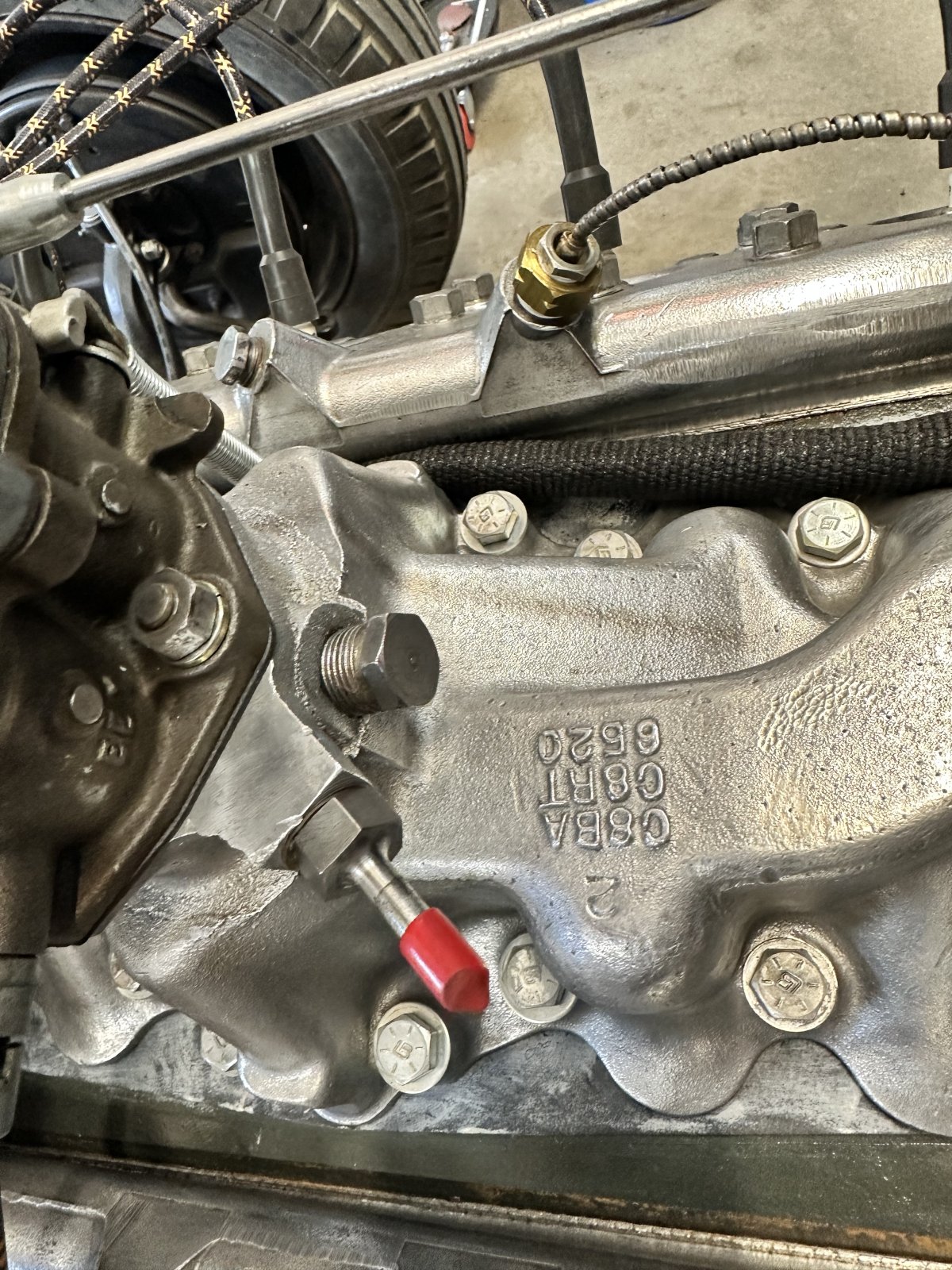

    With the smaller issues taken care of like radiator hoses and brake adjustments, I was thinking in following in @Aaron D. footsteps and adding a PCV to this 8ba. He has a very good little video up that he put together a few years ago. I bought the Napa parts needed and ran her around a little. I think my motor has too much blow by to keep up. It is odd though cause with the downdraft tube I hardly notice the smoke but when I installed the PCV smoke was obviously coming out of the oil fill tube. But maybe I installed it wrong? I’ll add some photos to give y’all a look.
    I cut a hole in a freeze plug and popped it in the downdraft tubes hole on the intake then added a grommet and the PCV. Then ran a hose to the intake hole under the carb. The bigger one that I ***ume was maybe a wiper vacuum line? Anyways with no other place for that smoke to go it came up and out of the oil fill tube.

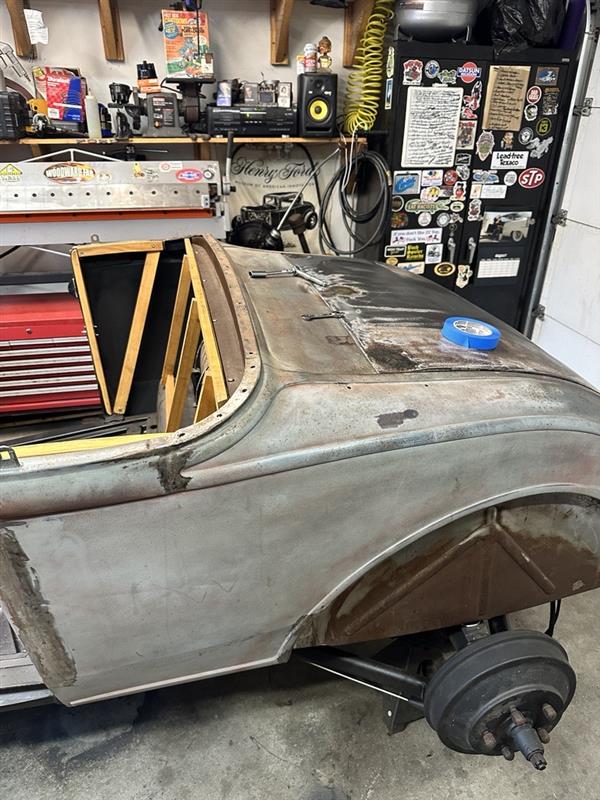

    Not rocket science here at all. Most folks like to use real rust in with their Patina jobs with vinegar and so on. I didn't want to do this because the car is totally ***embled and its a pain honestly to go through all that to create the rust then kill it and then paint and or whatever.
    You can see what I started with and taking all the taillights out and wood kit out.
    I used rustoleum brown (base color) spirit stain (with a rag) for the top color, a little big of green in a few spots to create a little different color and then buffer to clean up, and gibs or Galmet to lock it in. Photo attached with all products I used.
    So I used flat rustoleum as the base layer, then I add black spirit stain over top via a rag and put it on thick. I let it dry for about 4 to 5 mins and then rub it back to smooth. Then I let it dry over night.

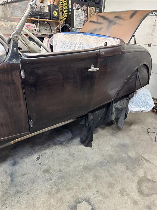

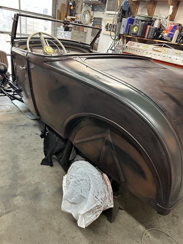

    As you can see in the photo the stain will create a bit of a streaky brushed on look, which some folks might want and you can just stop here if so. I wanted to blend the brown and black more to create an aged brown look for the entire car. I did add some green paint in spots to create a little depth which I think turned out really well.
    If you want to smooth out or feel that you have too much spirit stain use the buffer to remove as much as you want. If you use a cutting compound you will literally buff and it will pull alot more of the stain off. Best thing about paining like this is if you dont like the result you have almost no money in it and can take it right off or make changes in the color or shine in this step. Lastly i added some Gibbs to lock in the color. Sorta a whipe on clear that will fade to give a perfect non glossy look. The Galmet product is also really good here but it stays glossy for alot longer, but i have a feeling it protests alot better too. Then i came back with a rag and really hand buffed off the shine to give a flatter look. It is a little more glossy than i want right now, but when i did this same method on the front it tamed after a week or so. I have been through a few rain storms and none of the color changed. The Gibbs really helps keeping that moisture out.
