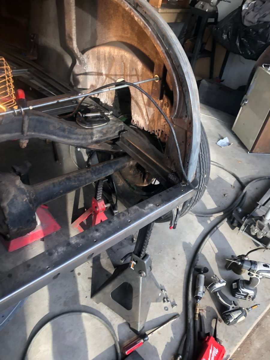

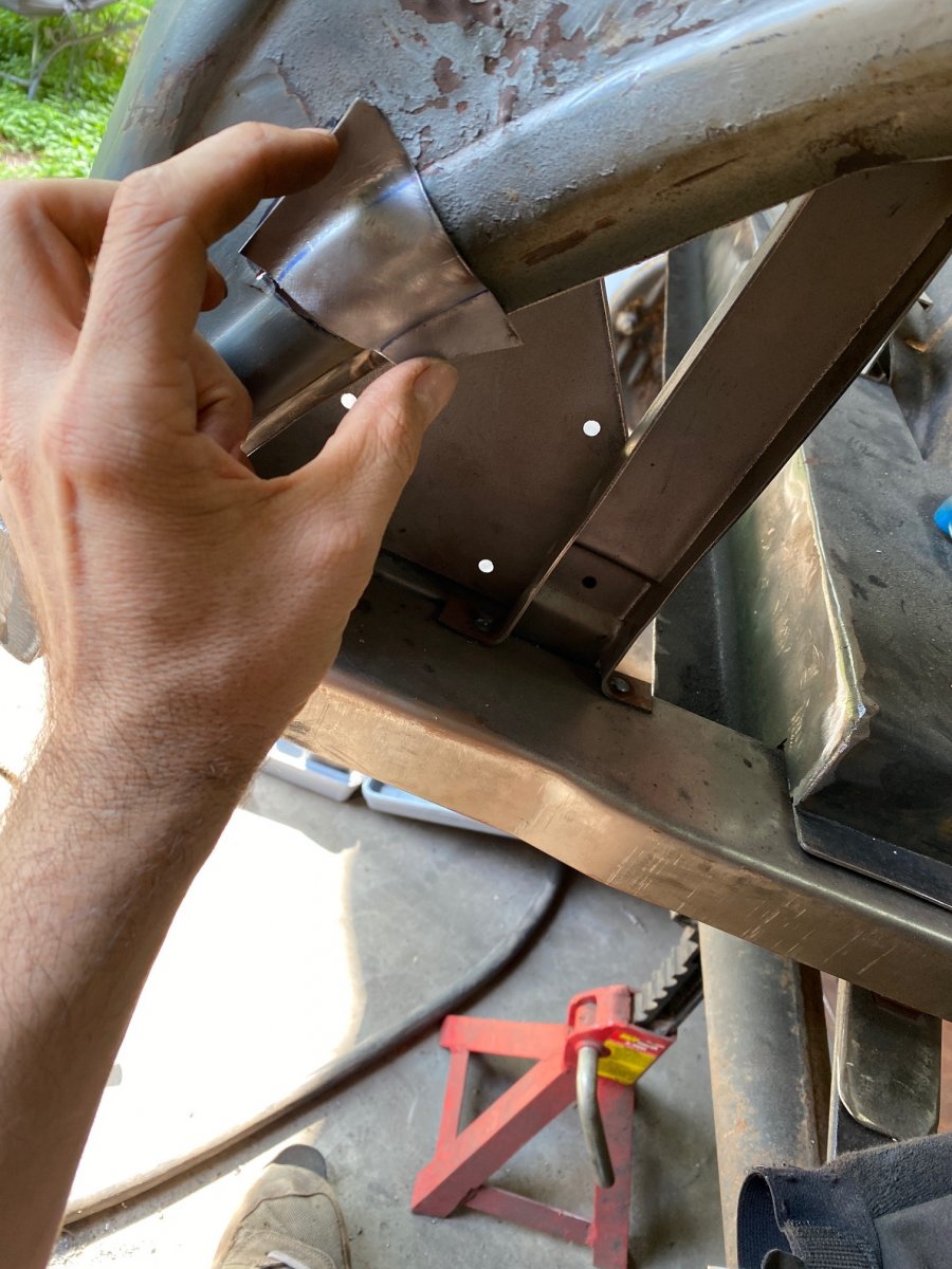

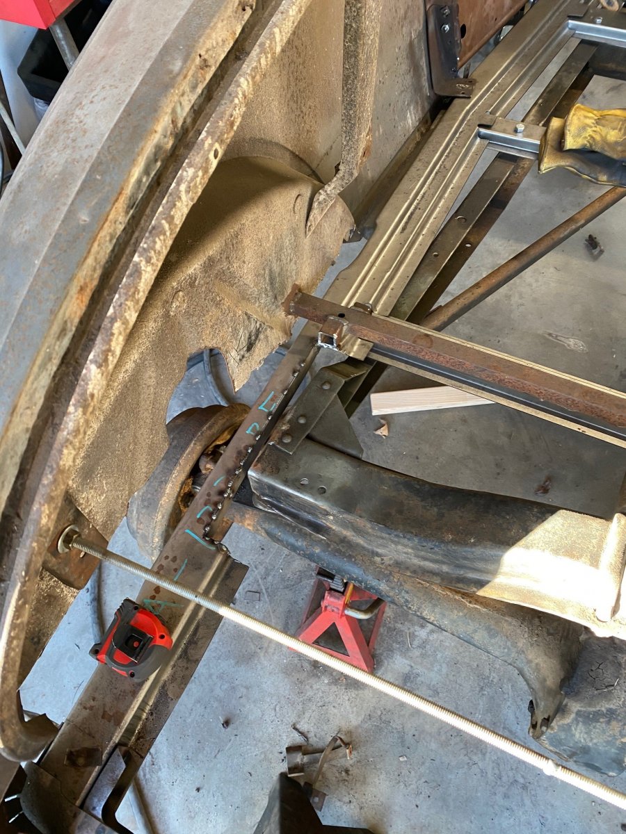

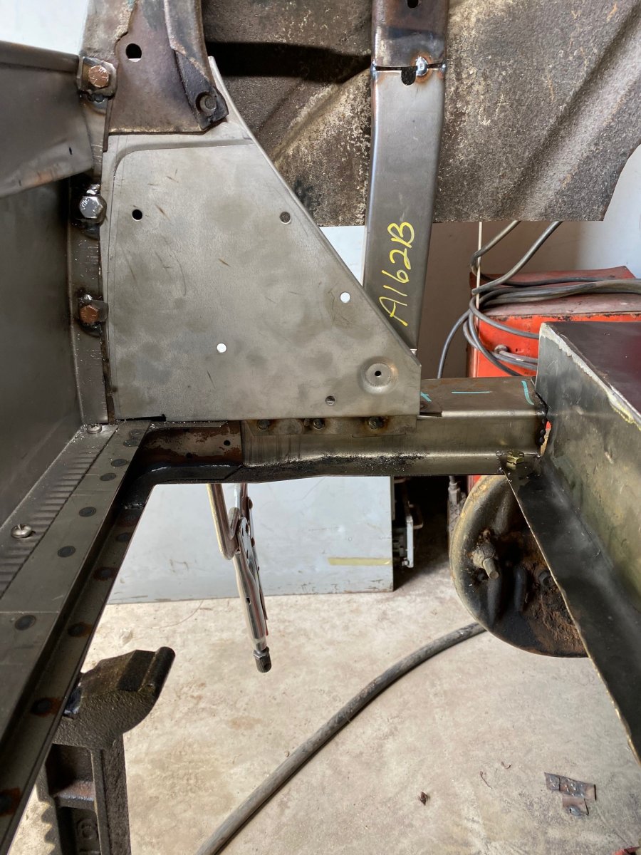

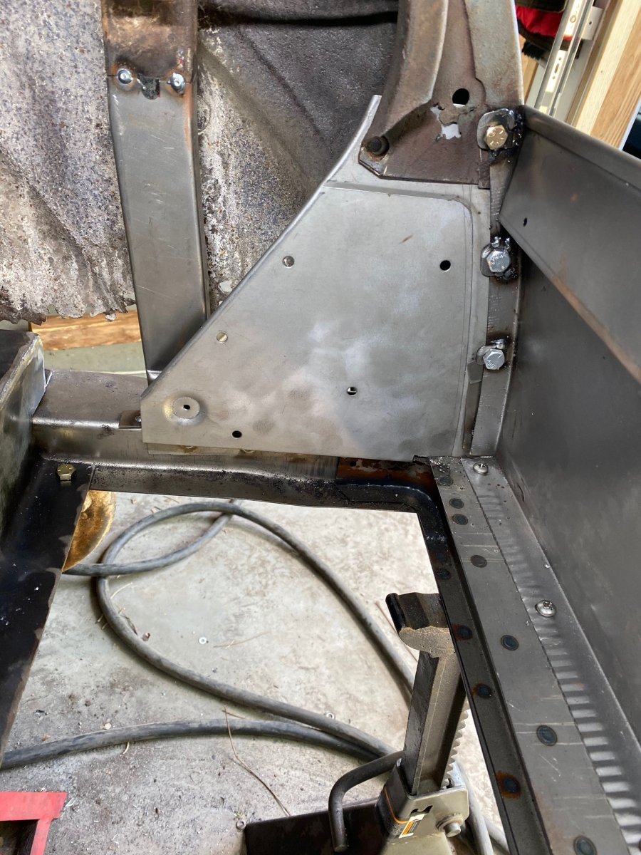

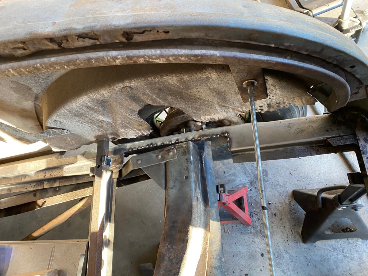

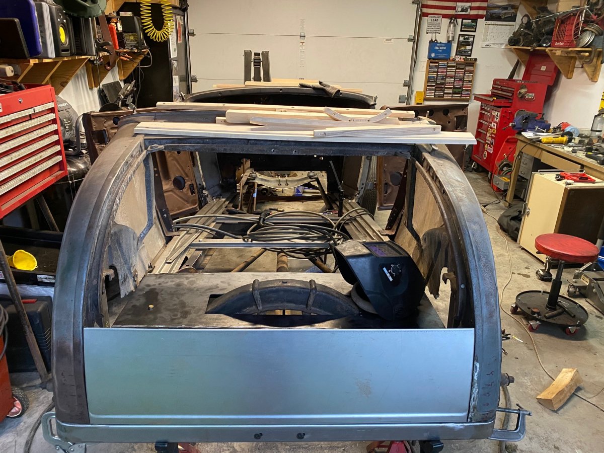

    Strengthening up the rear of the car has been fun. Taking forever but with the shelter in place in here Texas I have been hitting the car. I was able to get the side braces removed and install new ones. Took out the old under deck lid section and replaced it with a new one as well. The old one was very swiss cheese. I also had to extend the notch in the sub frame to account for a upper shock mount to attach to the cross member old bracing 2.jpg old bracing.jpg .

    new under deck lid installed.jpg Here is the under deck lid piece installed. new under deck lid installed.jpg

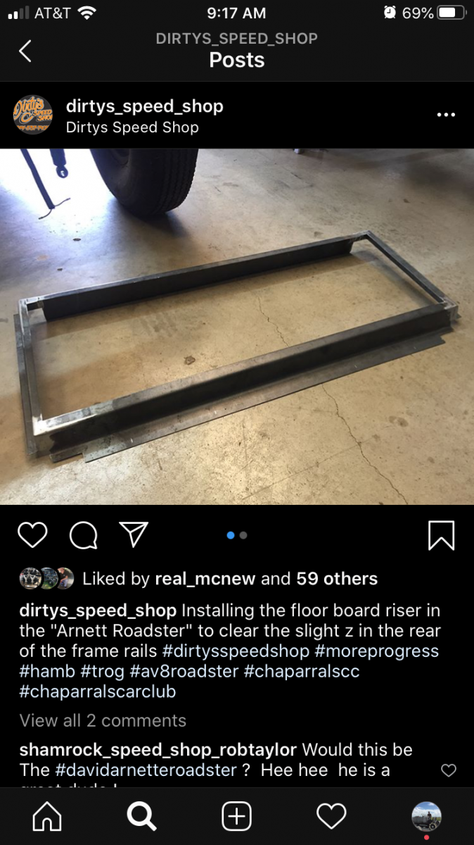

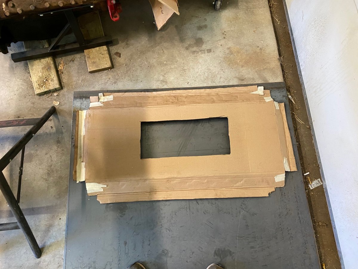

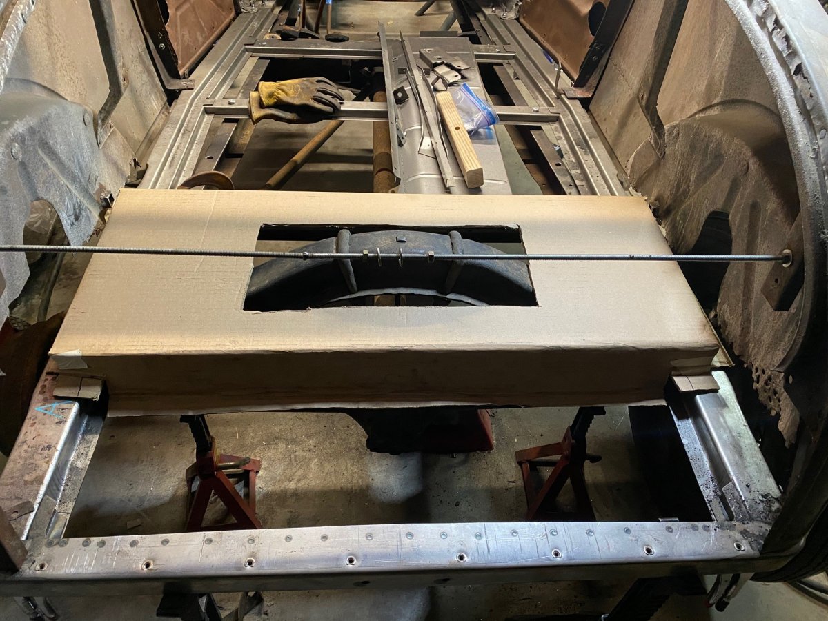

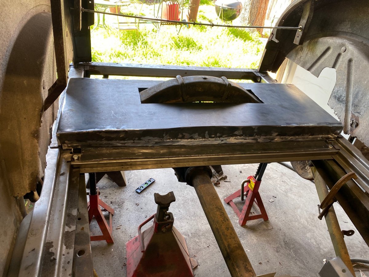

    I have been staring to ***emble and make a template for the floor riser to connect and strengthen the rear section of the sub frame I notched to allow for the cross member to drop below and or inside the trunk. Folks seem to go about this step in many different ways. I went the the Rusty from dirty s speed shop in Denton route. Here are the photos as follows.
    cruiserjohn76 and winduptoy like this.
  7. glorydime
    Joined: Jul 14, 2016
    Posts: 384
    glorydime
    from Austin, TX

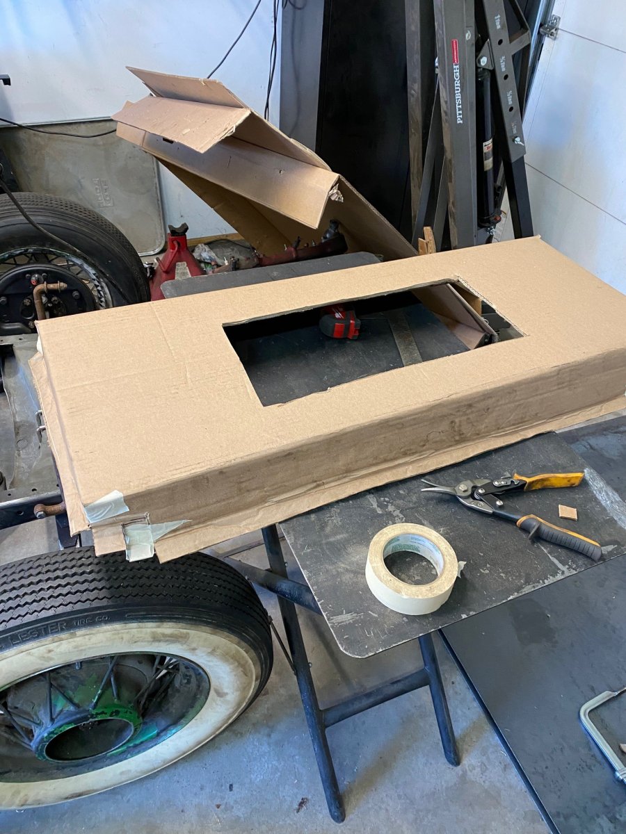

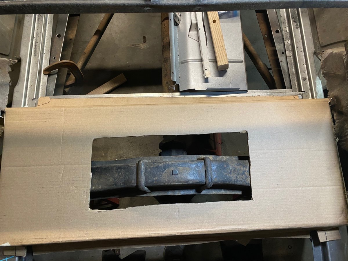

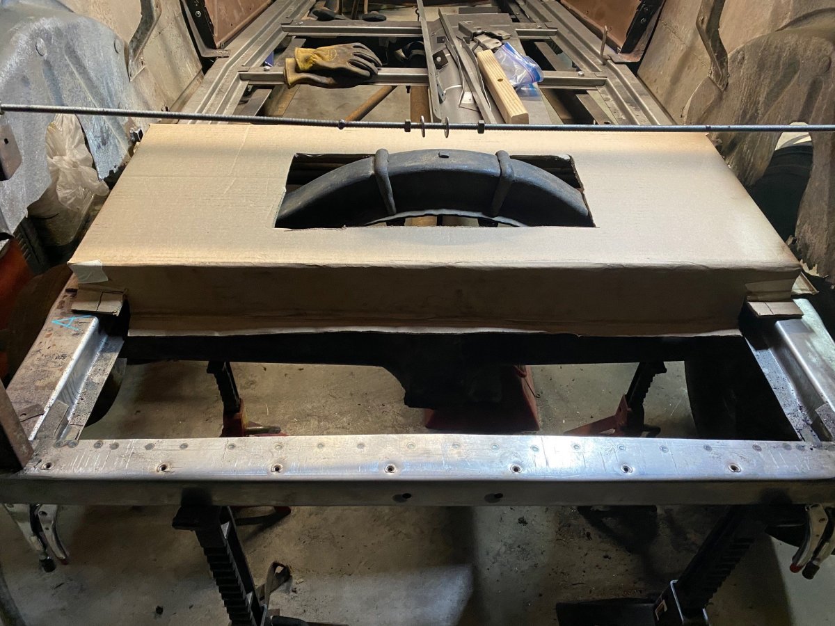

    I first made a cardboard cut out template of the box/riser and made sure it would fit and would be easily removed from the car when needed. cardboard template installed.jpg cardboard template installed2.jpg template for riser tracing.jpg template for riser.jpg template.jpg top view of cardboard template.jpg

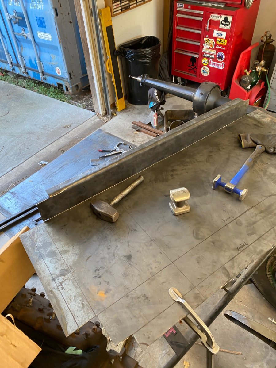

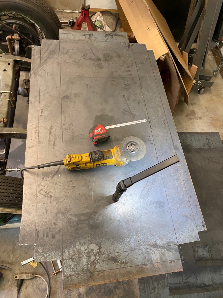

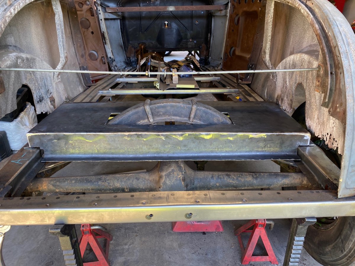

    I then traced out the cardboard template on the sheet steel i was going to use. Being that I don't have a large brake I was forced to use the old clamps and pipes to create a good edge and hammer away. The results are not the prettiest of boxes but totally works. first bend in riser.jpg template for riser tracing.jpg template traced on metal.jpg

    The fit came out reasonably well once in the car. I had to make alot of adjustments and will need to make some small patches but came out great. rear section 2.jpg Rear section.jpg

    After getting the fit correct and realizing that I will need to get to the cross member for a while longer I attached some tabs at the back and drilled holes to attach fasteners on the top and sides. I still need to changed out the Model A rear with the 40 rear I have, and shorten that tube and shaft. I also want to be able to play with the leaf count because I don't like how high the car is sitting presently. Bolting with fasteners will allow me to take this riser in and out till I finally weld it in place. bolted in riser.jpg bolted in riser2.jpg bolted riser front 2.jpg bolted riser front.jpg

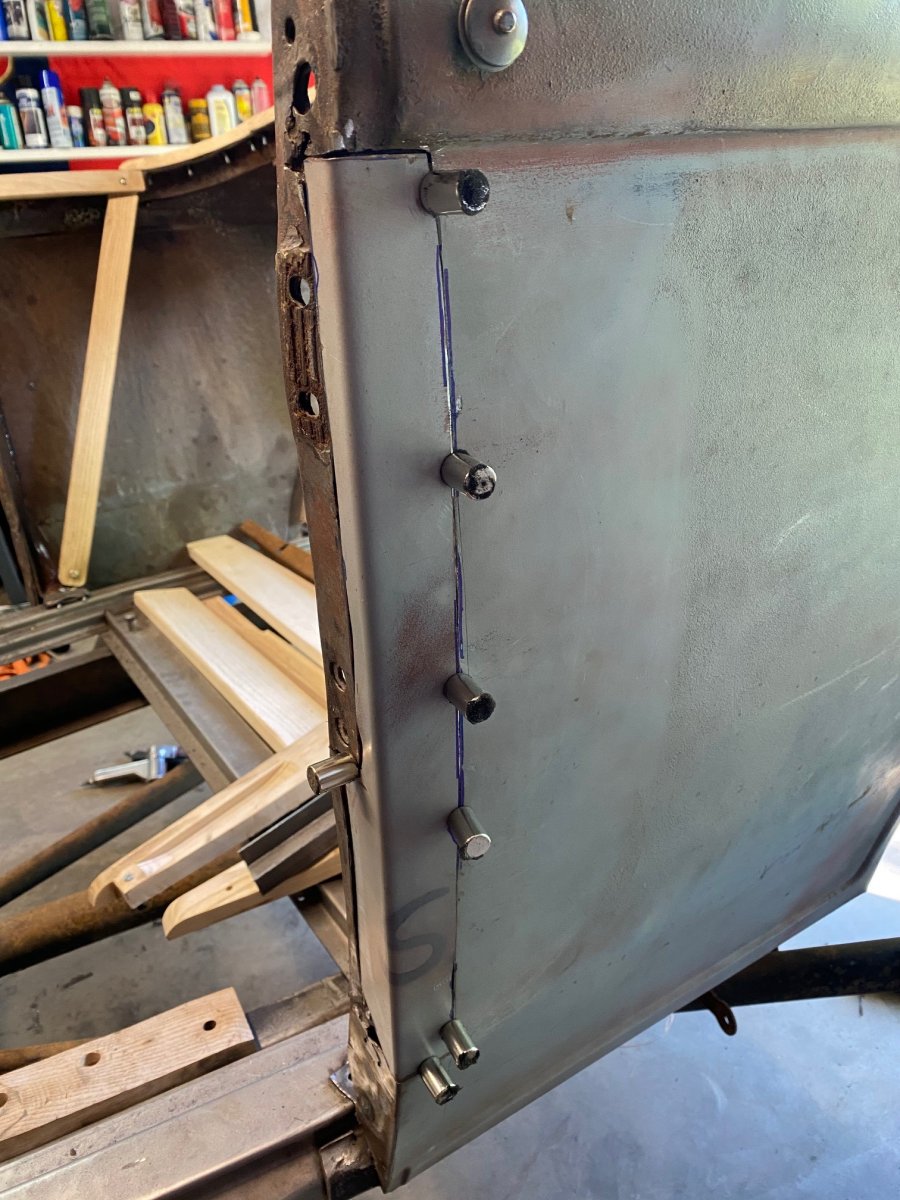

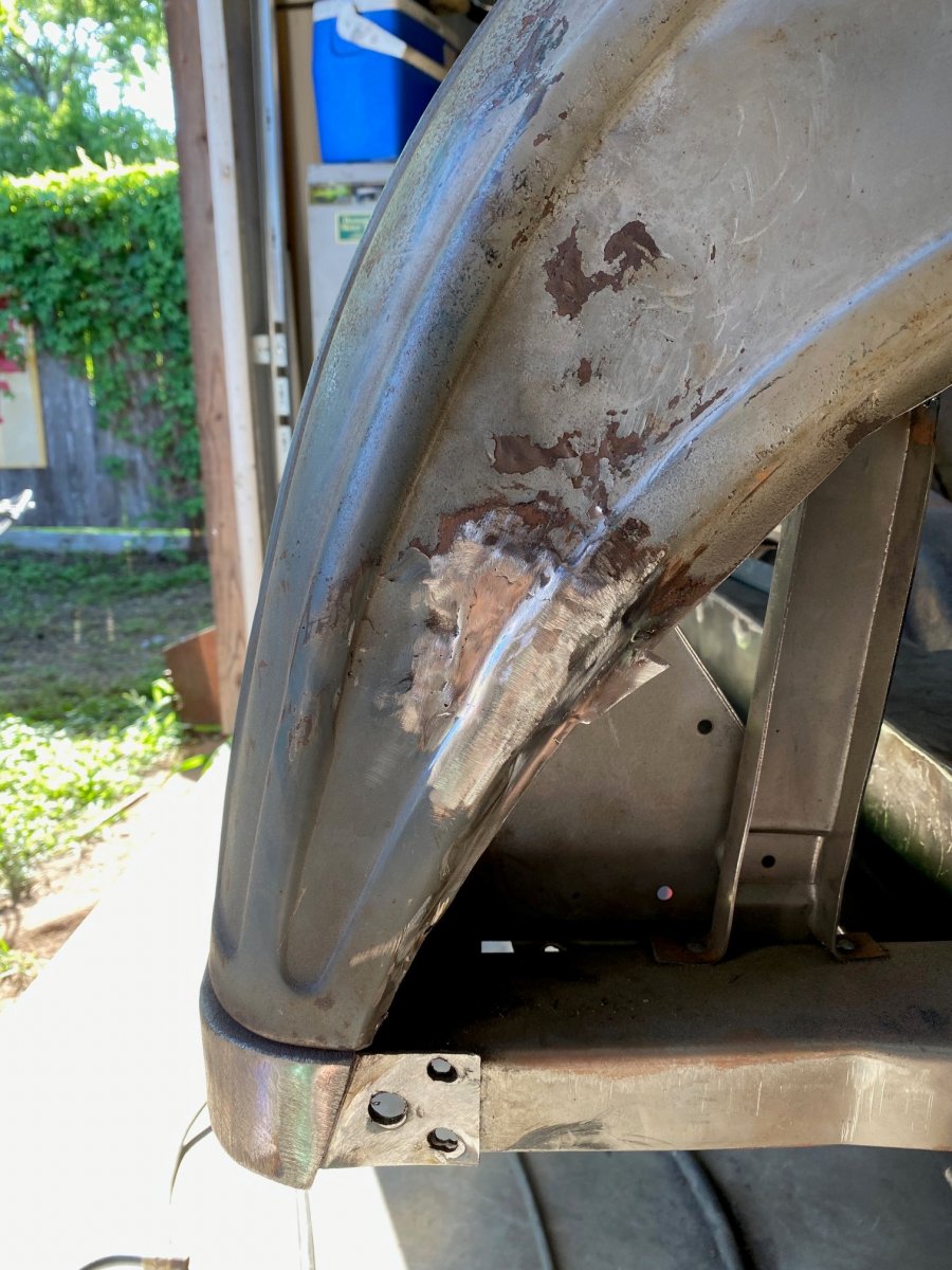

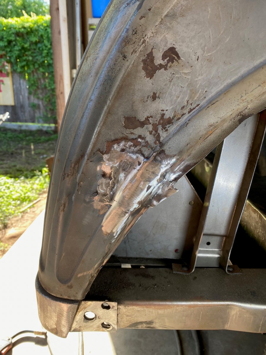

    during the Covid mess I started digging into the sheet repairs that needed to be done to make this a more solid body. I have almost 0 experience with sheet metal repair, but came out ok in parts and not so great in other parts, but Ill try to m***age it more.
    I started with my quarter panels. Both had large cracks from previous stress spots. Quarter panel crack 2.jpg quater panel crack blend.jpg quater panel crack.jpg

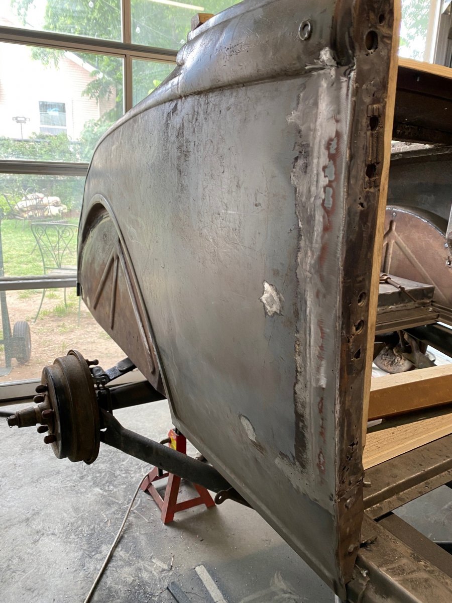

    Both the driver and p*** side quarter along the B pillar were Swisscheese and needed repairs as well.

    On to the p*** side same spot needed help.

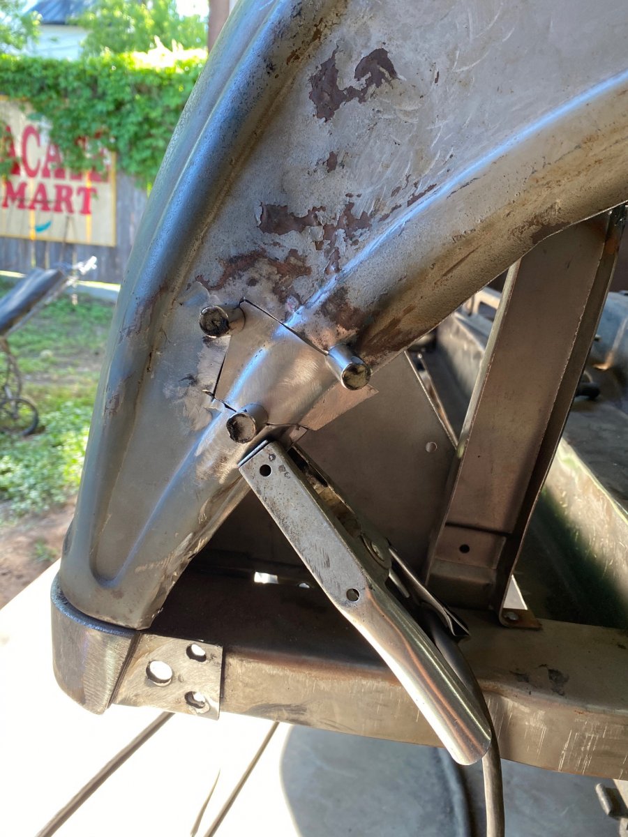

    pass quarter repair 2.jpg pass quarter repair.jpg b pillar repair 3.jpg b pillar repair 2.jpg b pillar repair.jpg

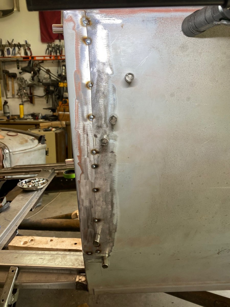

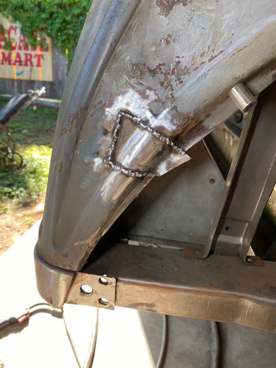

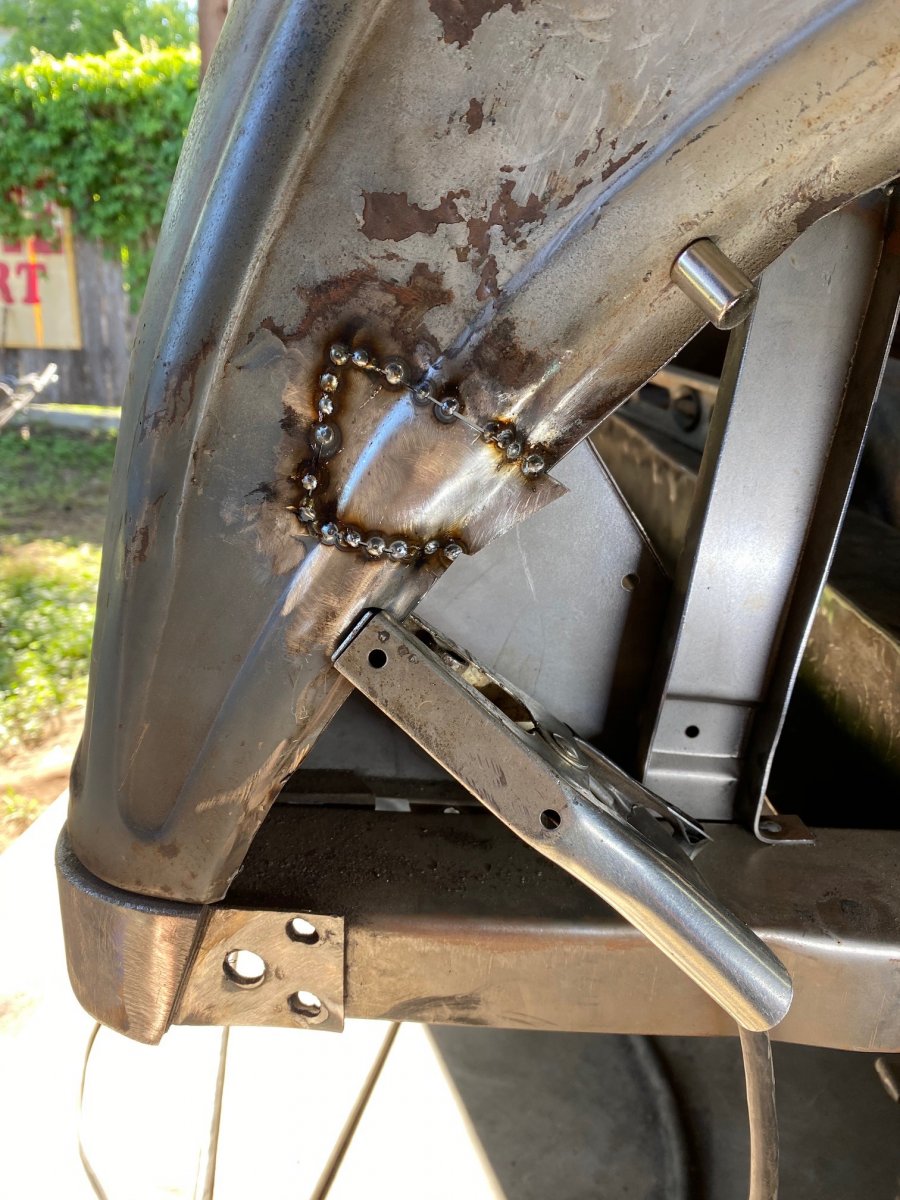

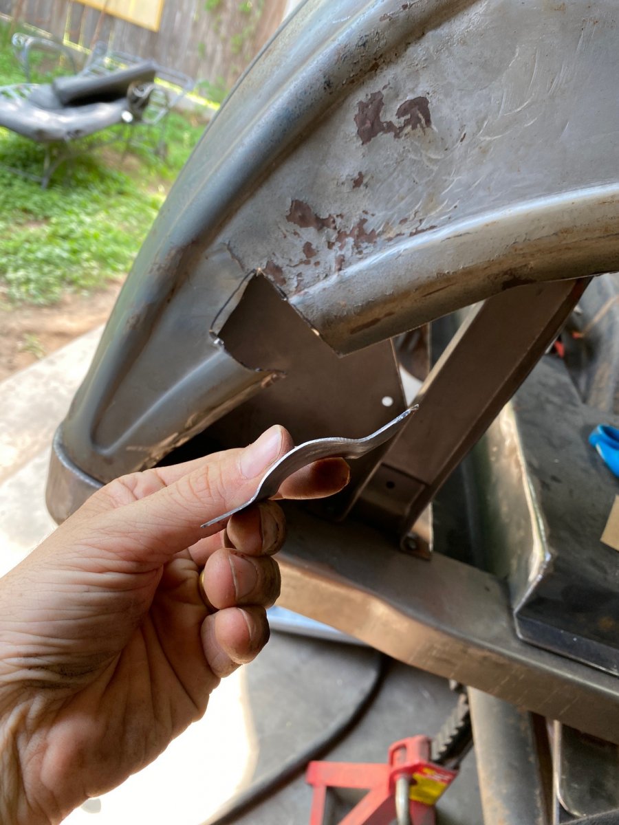

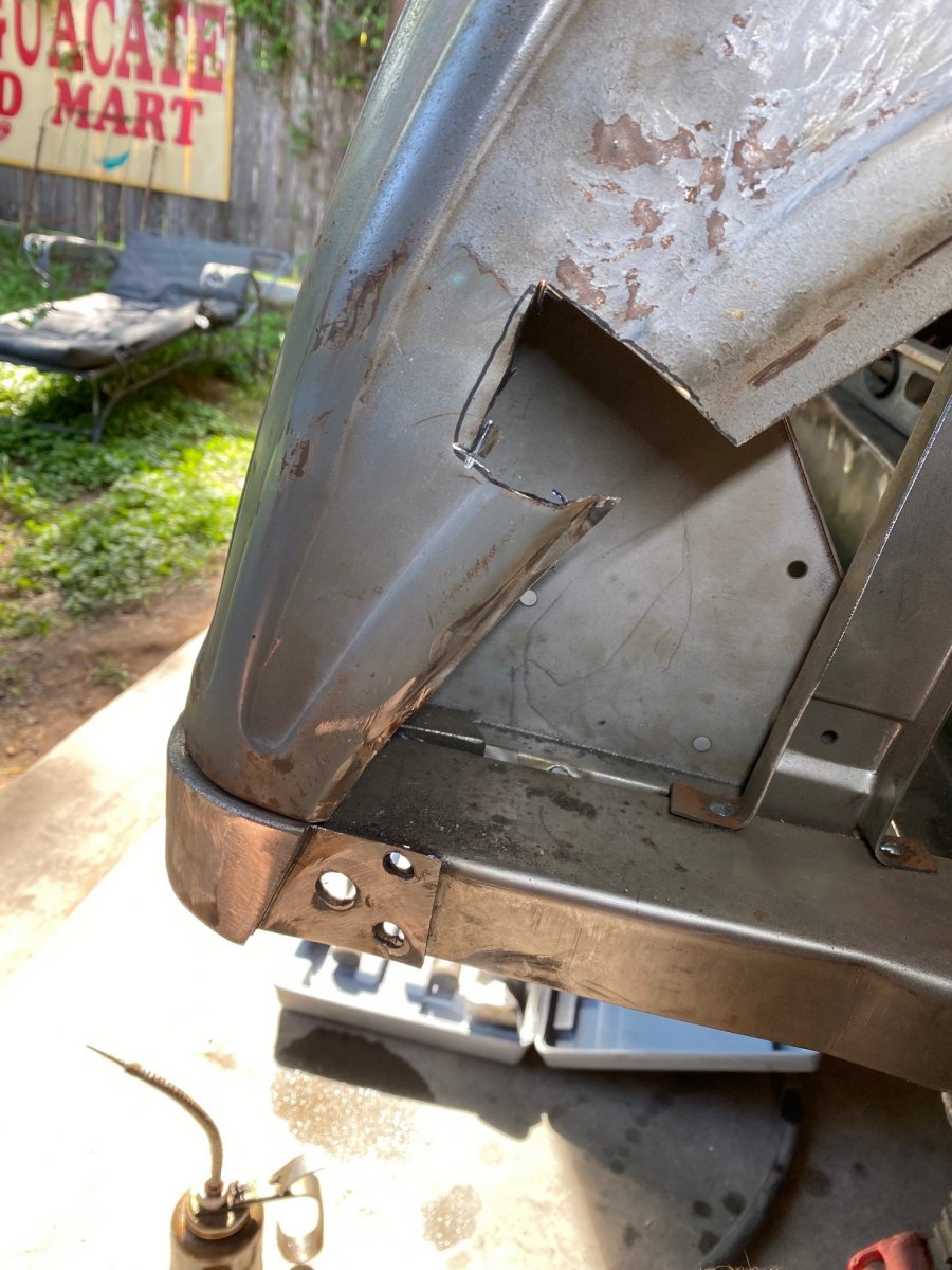

    Next was on to a small section on the p*** quarter where a previous owner had put in a piece of flat in a body line and tried to make it work so I ended up cutting it out and mating a small patch by hand forming the line to follow. Not super happy with the results and it will need more work, but it is stronger than it was. Just looks a little impregnated which i might be able to shape a little. The section behind the wheel well is also crunched in some and hammer and dollyd it pretty good, still needs more love as well. pass quater cut.jpg pass quater cut2.jpg pass quater cut patch.jpg shaping pass patch.jpg pass quarter patch.jpg pass patch.jpg pass patch stiched.jpg pass patch blending.jpg pass patch needs more work.jpg

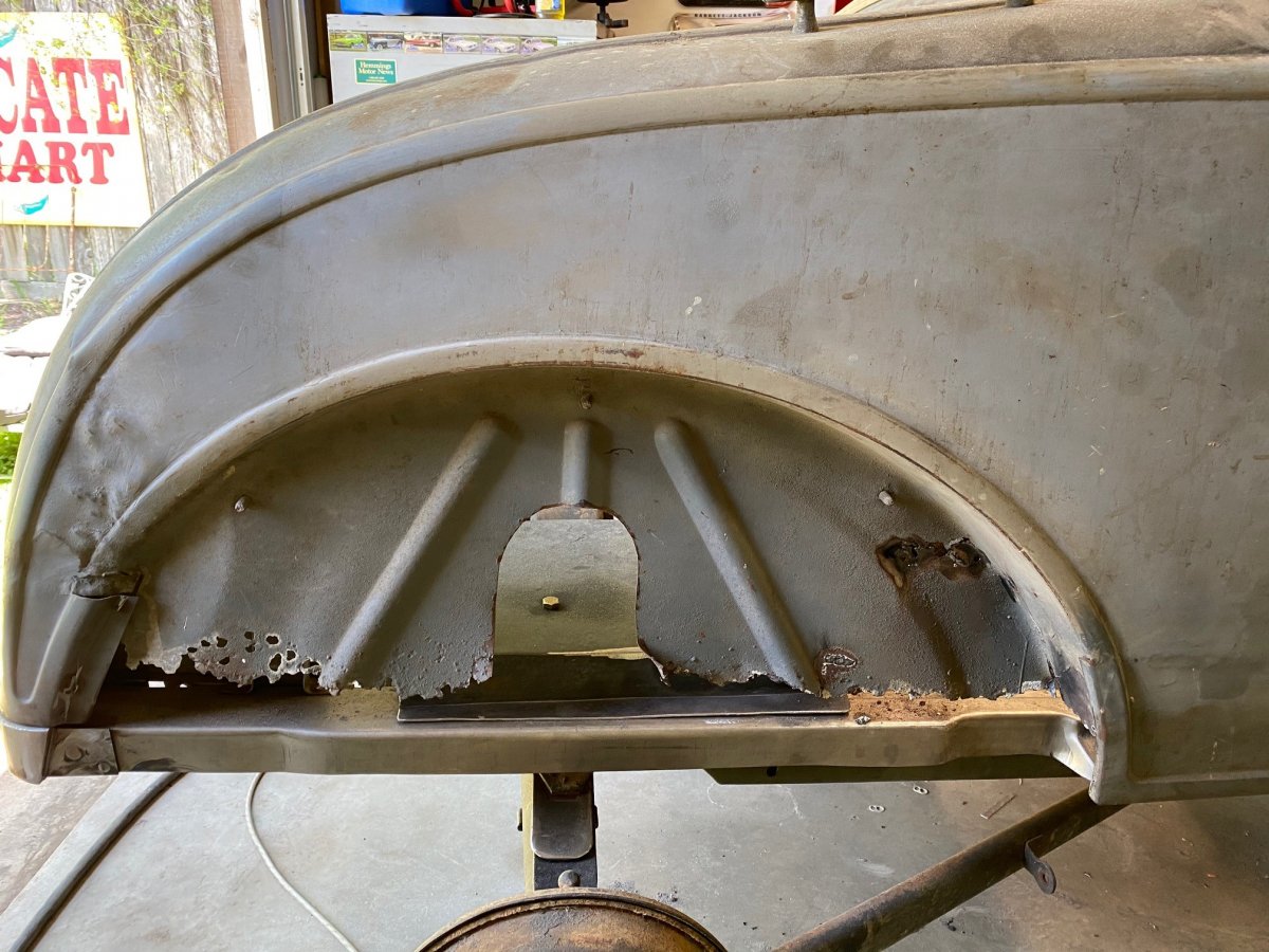

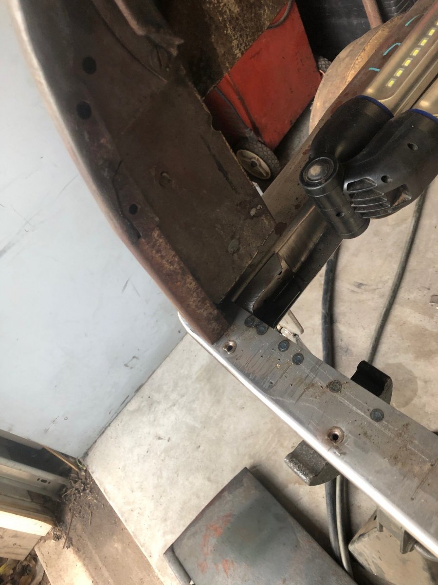

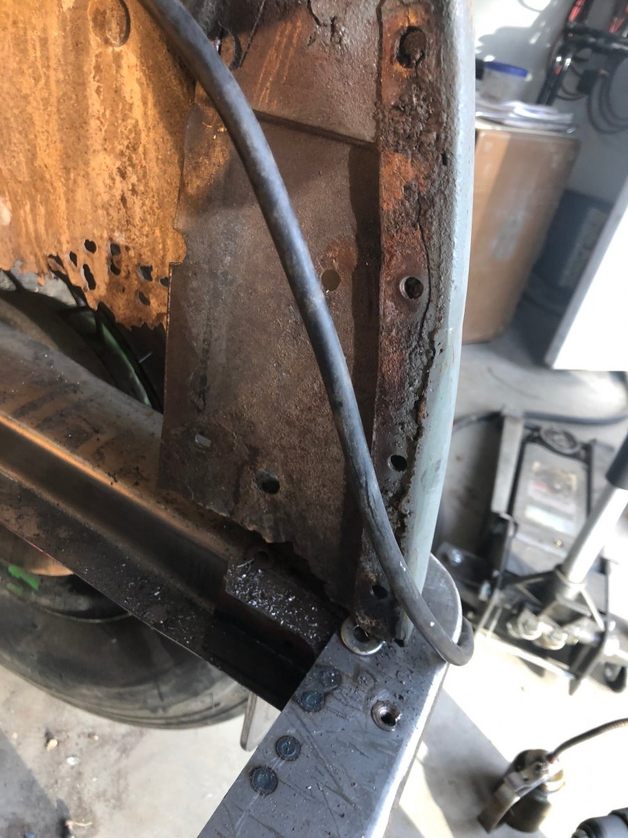

    Then i moved onto the inner wells of the quarters. Per usual these were rotten and cut up. Came out ok, im happy with these, both still a need a little more work. Drivers quater before.jpg pass quarter before.jpg drivers fender well blending 2.jpg drivers fender well blending.jpg drivers quarter.jpg inner fender well 2.jpg inner fender well.jpg

    Wow, that roadster body is rougher than a stucco bath tub...........I have never seen a roadster rust out in the body where the doors close, were those bondoed in at one time, strange rust area ? ......when they are rough like this they good ones to learn on because whatever you do is an improvement , your work looks good
    winduptoy and glorydime like this.
  30. glorydime
    Posts: 384
    glorydime
    from Austin, TX
    Totally agree. I feel like no matter what I do will be better than it was. Hahaha. I’ve found almost no bondo in this car. But who knows if bondo or a poor prime job soaked up moisture and then was ground off prior to me.
