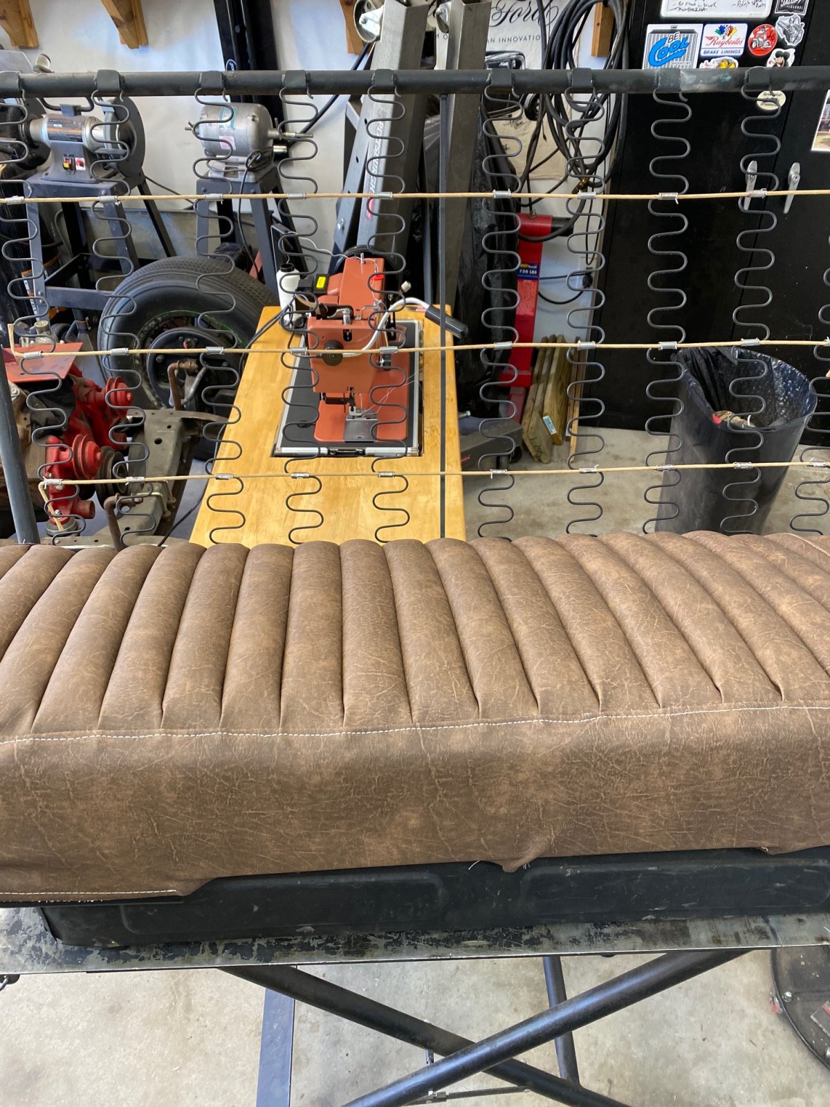

    You can see the nicer vinyl here on the bottom, which is the material I am going to run. Sewing with this thicker material was also nice because it folded much better and was easier to work with all around.

    Easily one of the biggest triumphs with this car was completing this seat cover. It really slowed me down in the progress of the car, but now I sort of know how to do it. Last photo wife and our Pup sitting on the new seat.

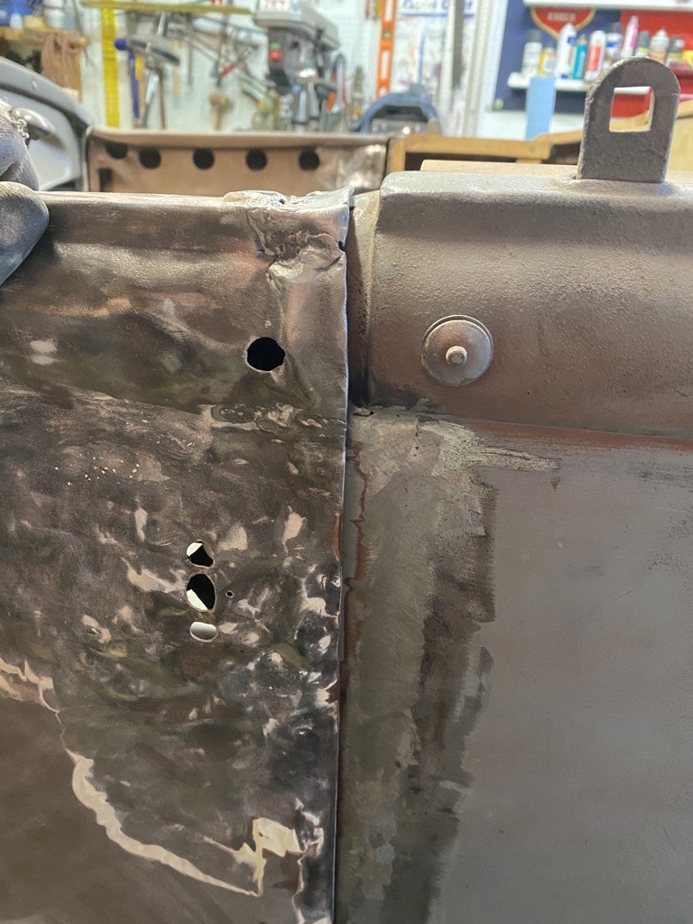

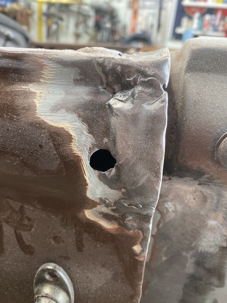

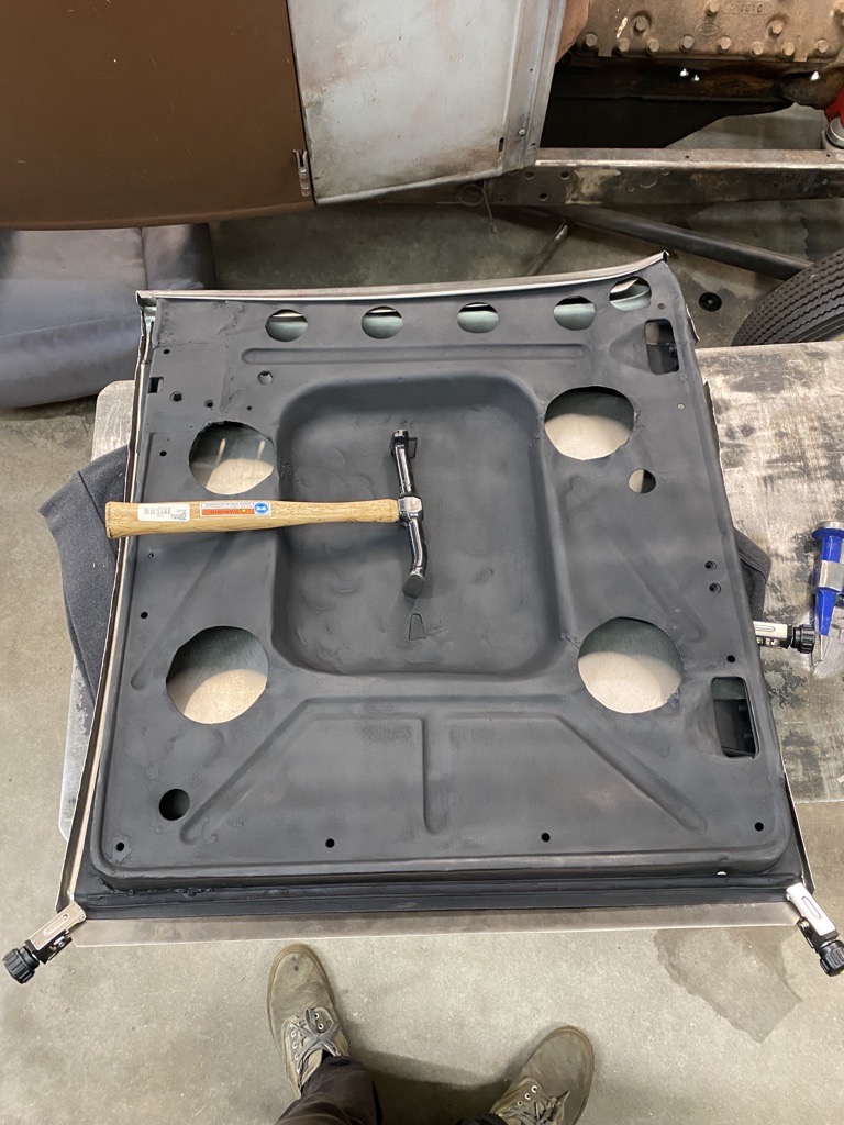

    The doors I have presently are full of filler and the drivers side one is horrible and fits really poorly, and that's saying alot for this heap. I tried to putt out the filler to repair but decided to get a new skin and mount it. The inner structure wasn't much better honestly, but i was able to repair and make it work.

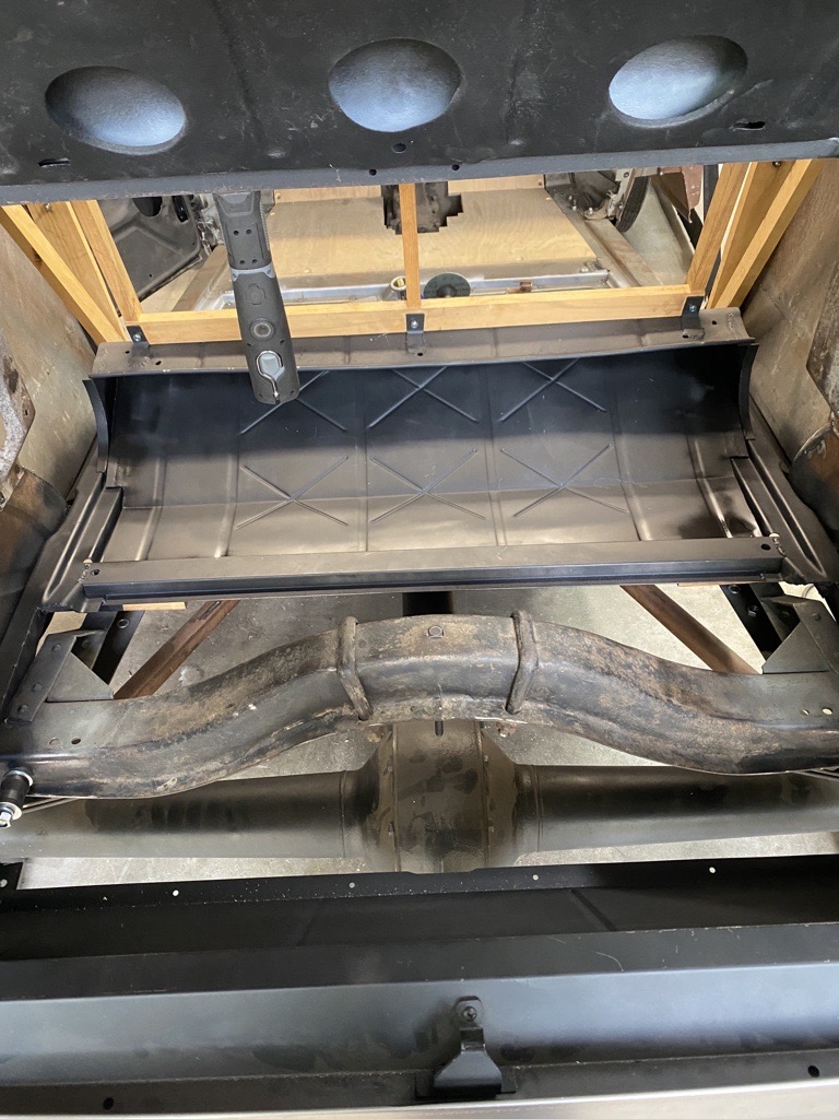

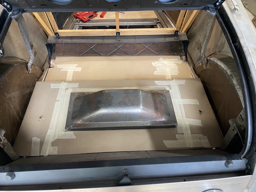

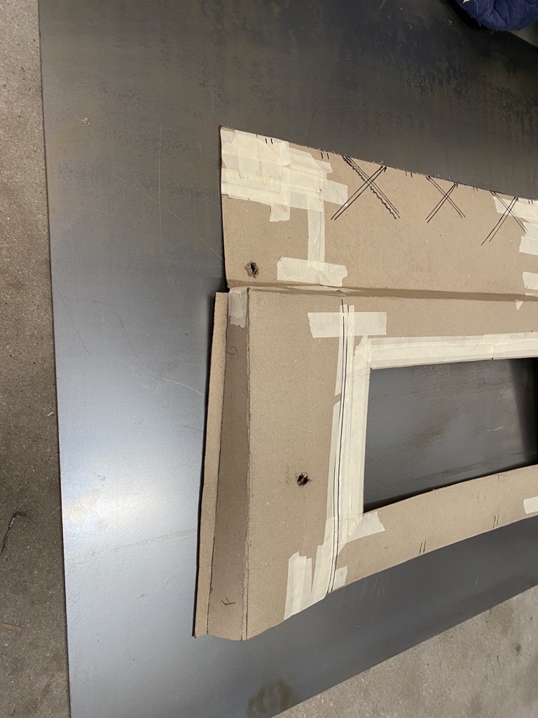

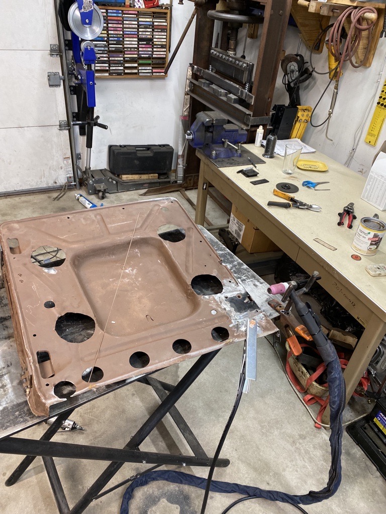

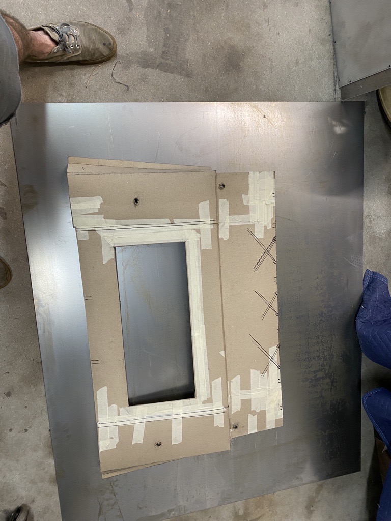

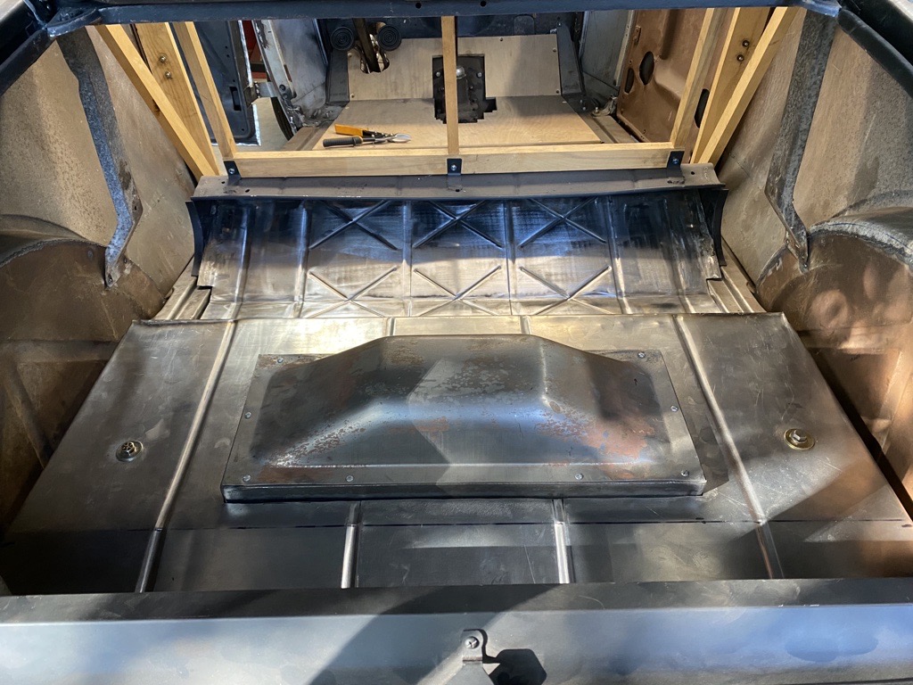

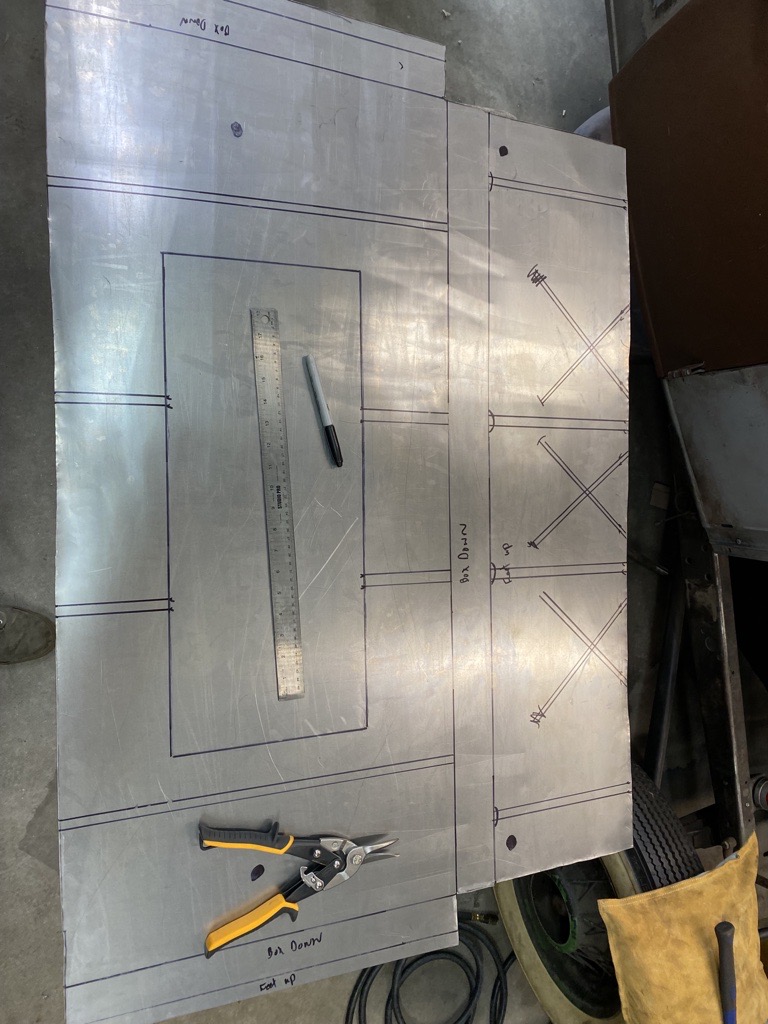

    Floor pan for the trunk was next on my list. Not alot to say here pics tell the story. I made a ram board template then traced it on some sheet and bead rolled and braked it to shape.

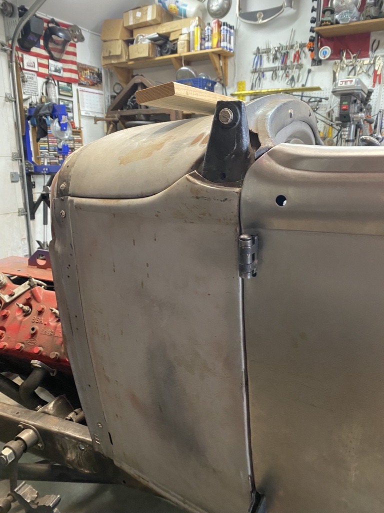

    The owner prior to me welded the firewall to the cowl top. If you look back in the build thread you will see where I had to cut it out to break the two apart. I finally got another cowl to replace this cut down one. It was the full tank which I had to cut out. The old one was a filled cowl, and i planned on filling this one as well, but I am liking the gas cap now that I step back from the car.
