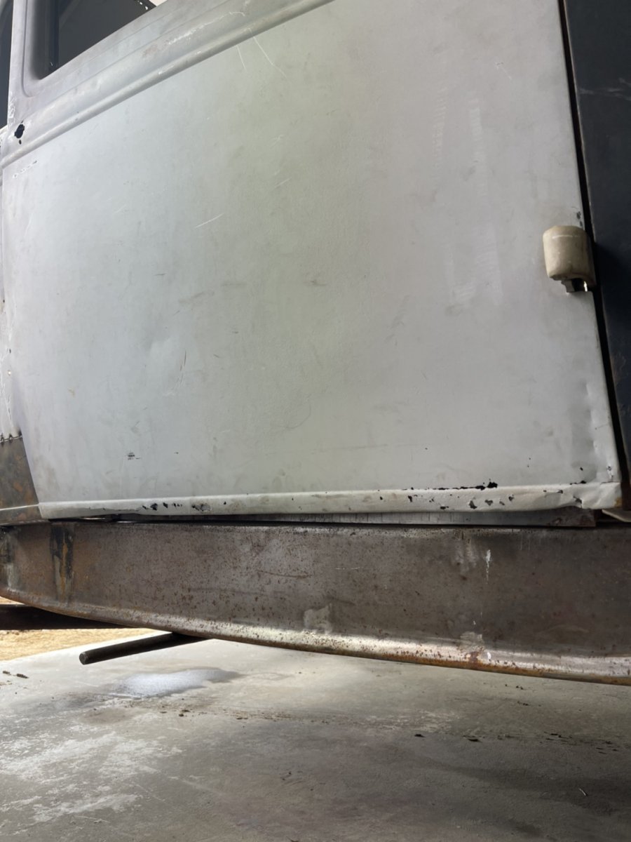

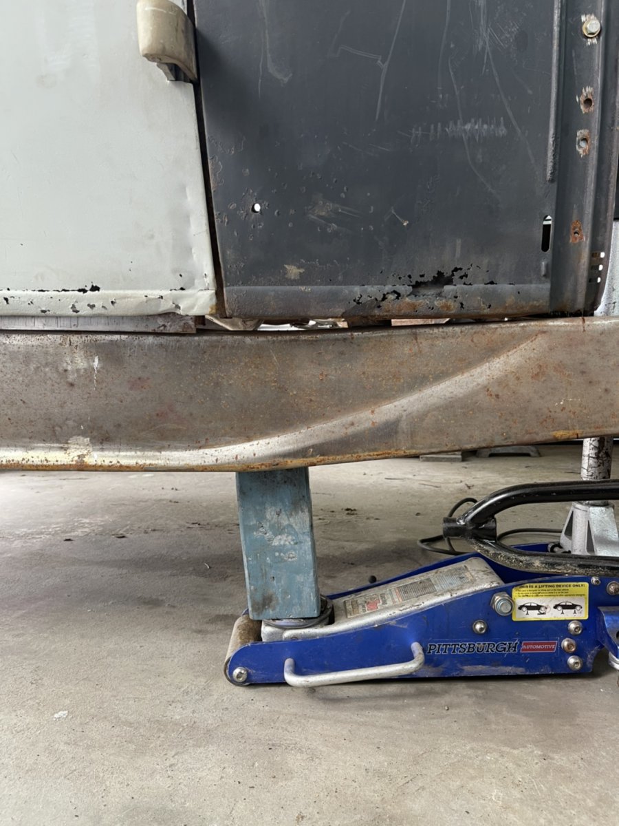

  18. IMG_5762.JPG this gap is really irritating me, but I gotta keep the cowl in this position due to hood alignment. Any ideas or tricks to fix this? IMG_5766.JPG kinda a ****ty picture since the door is smashed and the lower quarter patch isn’t aligned (that’s why I tack only until everything is fit ) but you can see the gap closes towards the wheel well.
    32 Ford’s actually sweep up on the body I suppose I could buy cowl patches for a 32 and new Vicky door patches and create the same “sweep”

    Back in the old days they filled that gap with a strip of wood and painted it...seriously...
    Pinching the frame and/or channeling the cowl over is a newer option...and I have seen the 32 lower cowl panel added as well..
    If you go for a pinch and channel you would have to also mod the rad & shell to match the channel...
    https://www.jalopyjournal.com/forum...29-body-on-deuce-rails.1069919/#post-12144551
    :rolleyes:...in this Thread the Hamber @Roadsterholic fabbed wood shims/packers
    :rolleyes:...Hamber 5wbomber did a nice job on his Roadster and they actually look nice au natural...
  20. D-Russ
    Joined: Mar 15, 2006
    Posts: 1,749
    D-Russ
    @DylanHill1931 I'd consider a little channel – that's what I did on my car. I personally don't care for the wood gap filler even though that may have been done in the olden days. Sorry Jordan. ;) It also looks like you'll need to pinch the frame or spread the cowl feet at the front/bottom.
    Oh and go big (or small depending on how you look at it) with the 5.5 inch chop!
