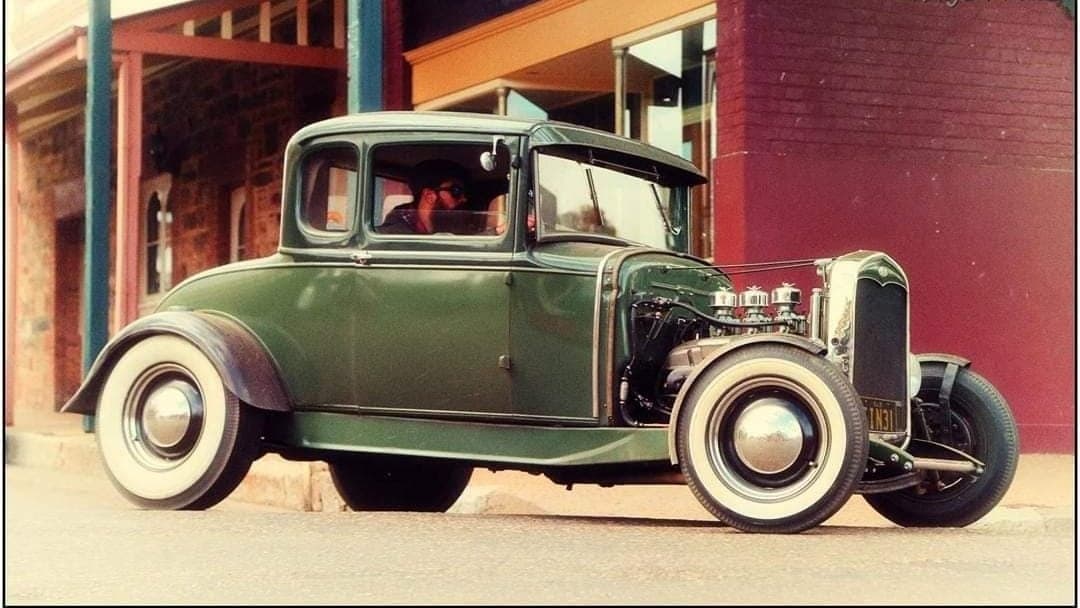

    :rolleyes:...here's a Hambers ride from AU and it's just done the way most were probably done back then...nothing but wooden blocks and rubber with no pinch or channel I believe. I've always liked this Hotrod...
    As it is many times said...fast n' dirty...
    It actually is not really that noticeable...

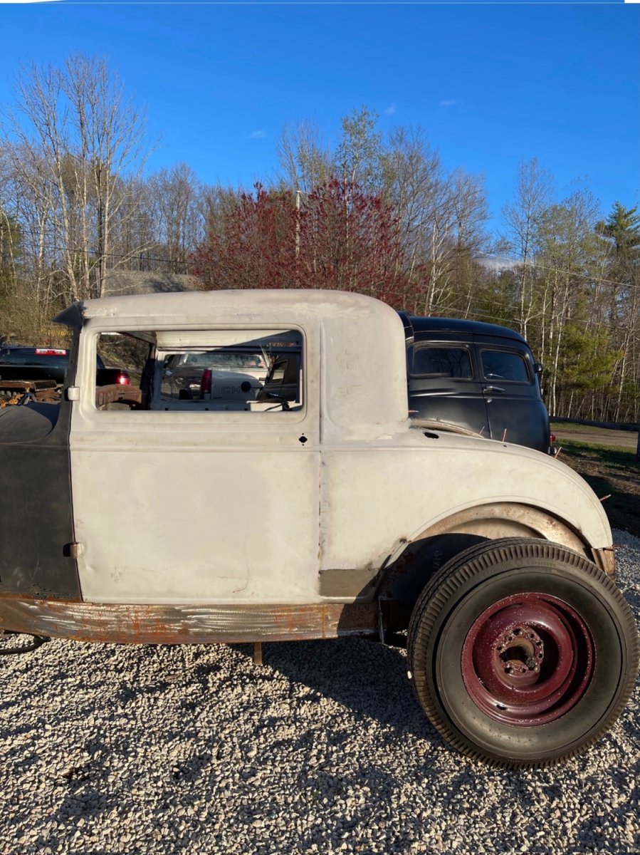

  14. 6AEFE7FE-F3C0-484B-8253-295234897F0F.jpg settled on this chop and roofline for the coupe I’ll do the chop after the car is strong enough to do so. Hopefully I can get it right!

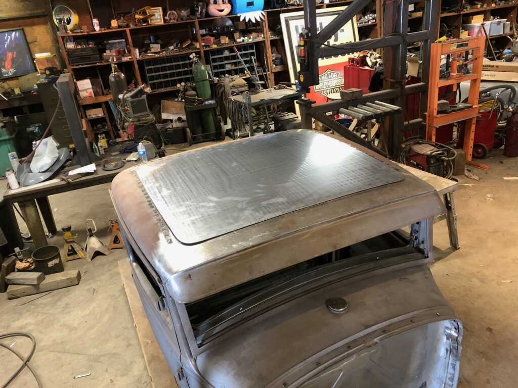

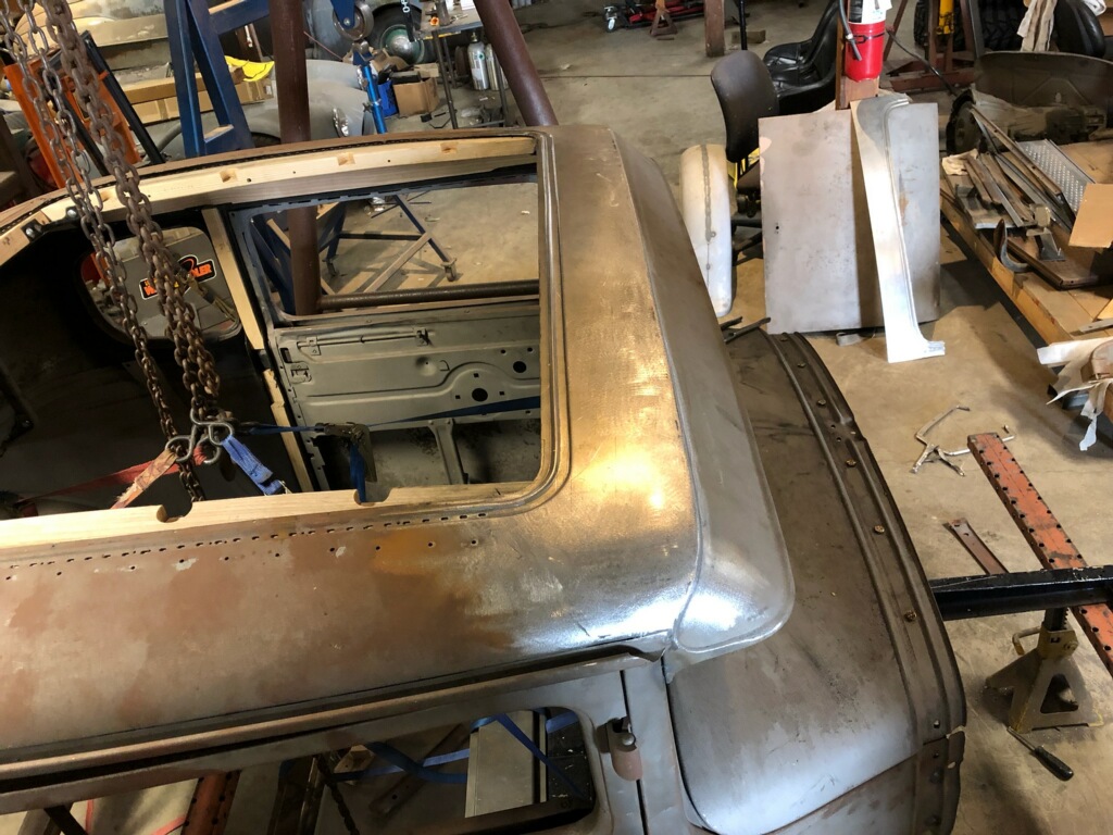

  16. IMG_5909.JPG IMG_5911.JPG IMG_5923.JPG ok so Im finally getting somewhere with this roof. I committed to the leaned roof look, in the process of leaning I found that I would have to take some height out as well to get it to fit the door again. I’m lucky to have an original 33 3 window hanging around so I went a stared at it and felt the contour of the roof profile walked back to my A and realized I had more than enough height to sacrifice some. I ended up removing most of the gutter area which I was going to do anyways. After I cut everything loose I used a heavy ratchet strap and used the cowl to lean the roof to the desired angle. Tacked in place and started fitting the swage line and filled the quarter window with a piece of 16g I put in the English wheel to give some contour. Still need to tackle the p*** side tomorrow after the swap meet early in the am.

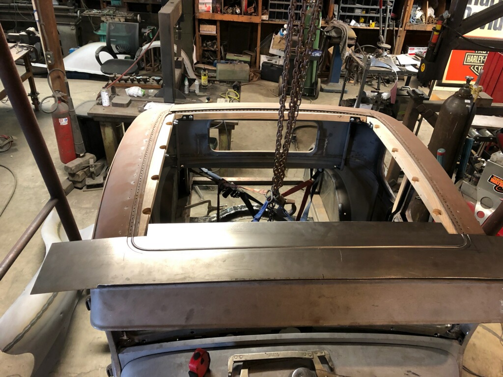

  17. Well you win some and lose some, today I definitely messed up on the p***enger side of the body. Missed one step and ended up cutting the roof back 2” too far. Oh well I’ll fix it I welded the section back on but it needs some more finesse and the B pillar is now back too far and it’s not as tight of a fit. All issues I will fix. IMG_5951.JPG IMG_5962.JPG IMG_5959.JPG no fancy tools here, doing it how I can figure out with the tools I have. IMG_5965.JPG this is where I should have stopped [emoji23] IMG_5966.JPG IMG_5954.JPG IMG_5950.JPG I’ll post another update next weekend thanks for reading
