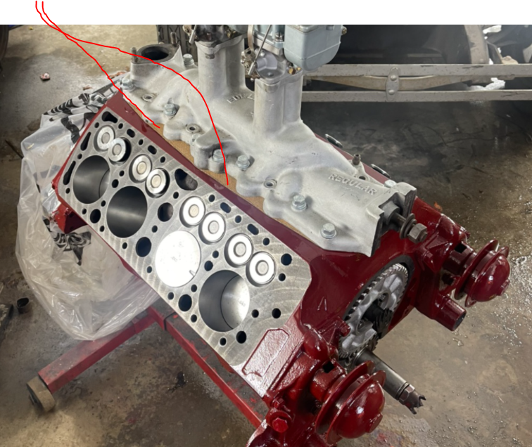

    Bandit Billy
    Take an exacto knife and cut that superfluous gasket material away while you can get to it. I used the same intake gasket, hard to trim once installed.
  25. I painted the motor in the shape of that gasket so unfortunately it’s going to stay. I don’t hate the look of the gasket. I suppose once it comes back from the machine shop, I can cut to fit the intake and repaint the top of the block

  30. Bandit Billy
    Joined: Sep 16, 2014
    Posts: 16,123
    Bandit Billy
    I doesn't look bad now...once your strombergs leak all over it (and they will) it won't look very clean anymore (experience talking). :cool: My block was painted prior to that gasket as well, after t******* I thinned some maroon enamel (so it would flow) and brushed it on and clear coated it with a brush as well.
