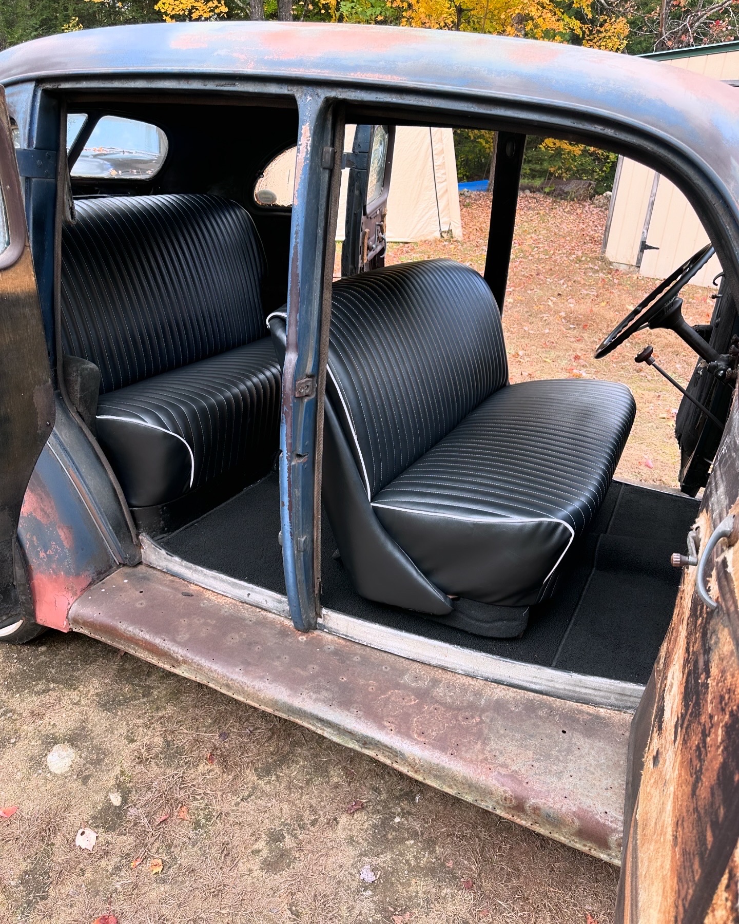

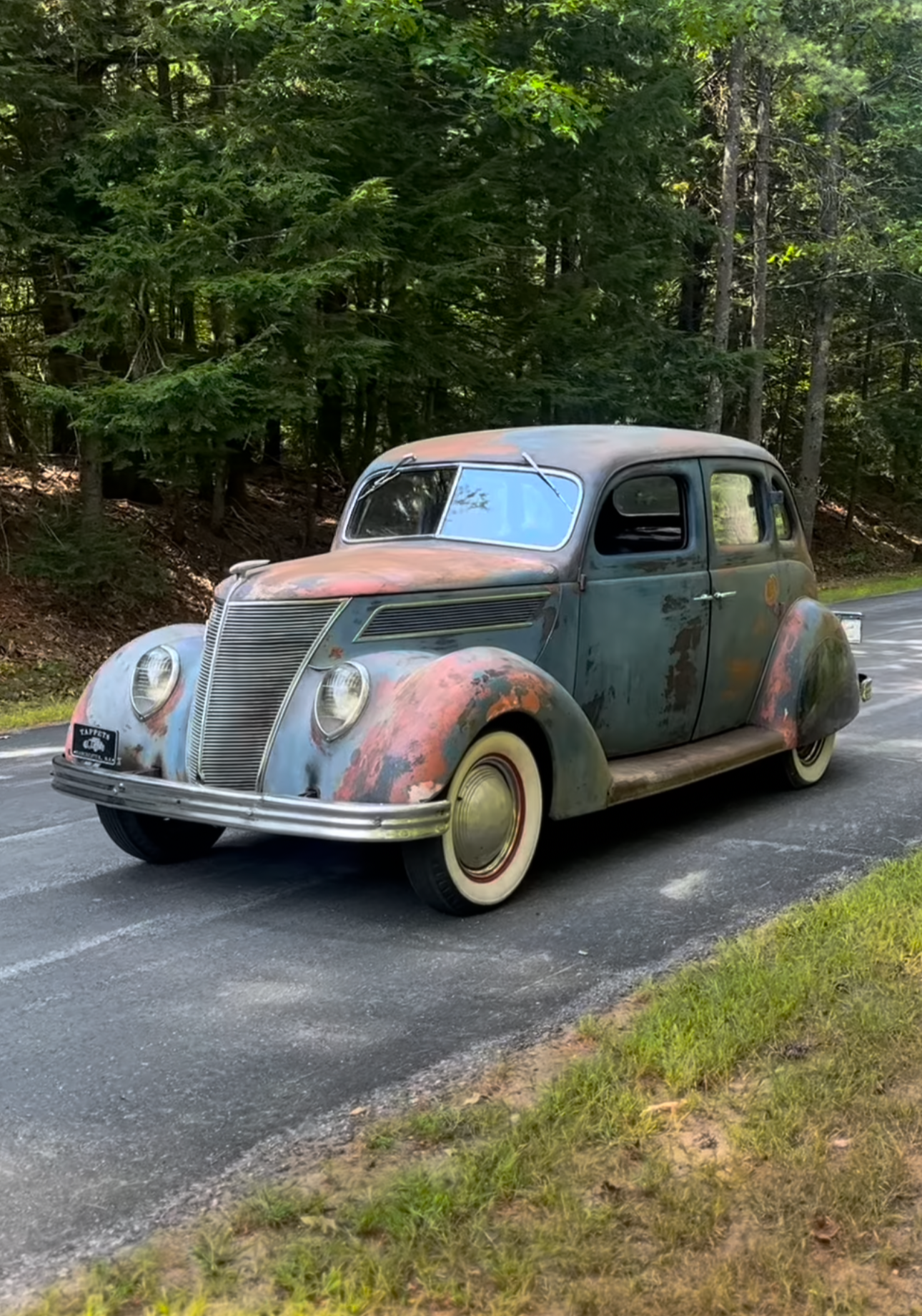

  17. Since I got the coupe on the road I’ve been busy with home life as we tend to do! Got married and had a baby boy! IMG_6489.jpeg Hudson’s first day home from the hospital! Had to put him in the coupe, he wasn’t impressed. Ha IMG_6777.jpeg I knew I needed a “family car” so I started scouring marketplace for a mid to late 30s fordor and found this extremely solid 37 Ford! Without taking over this thread I’ve redone the seats and changed up the look for an early custom vibe! 7F8FCFF6-791B-467E-A7C9-C5FA36BEAB60.jpeg EB9DB695-4FA9-4034-8271-909947EFE2FC.png Now back to the coupe!
