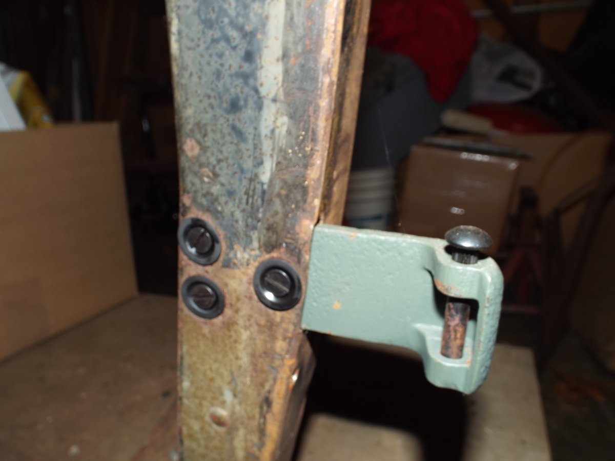

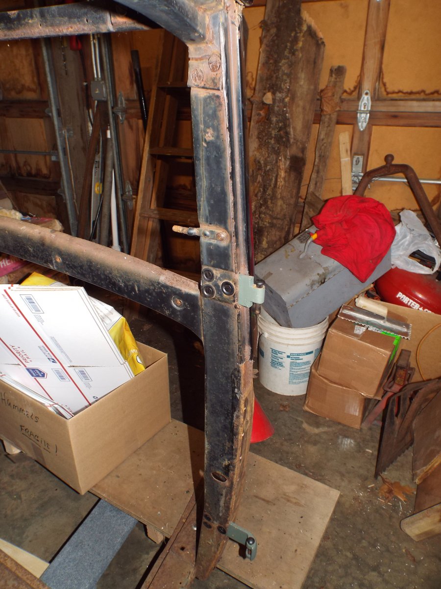

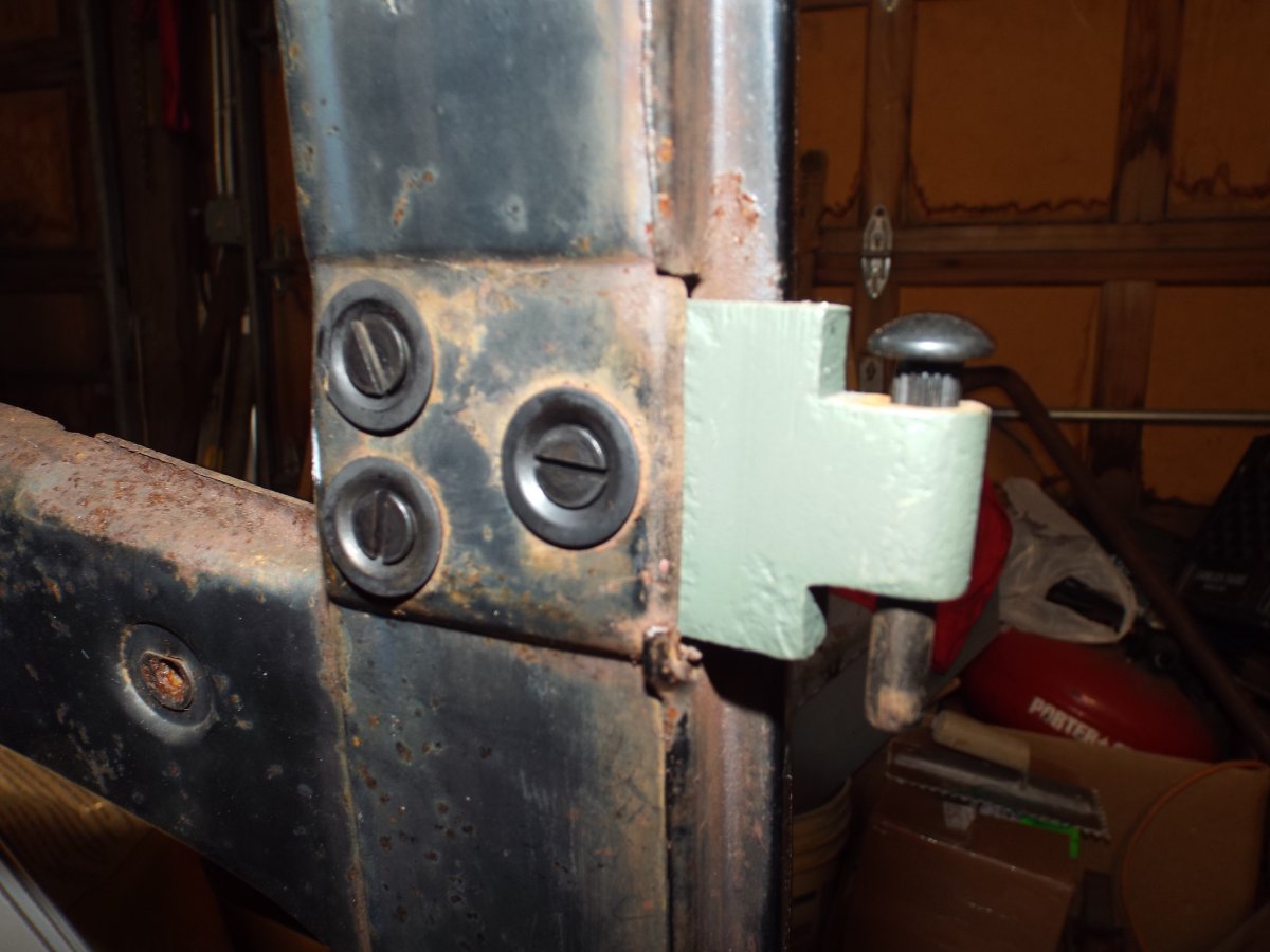

    Nice score on the Vicky doors, now you'll need to find the cowl side of the hinges. I wound up buying a whole cowl at Hershey to get two missing hinges for mine. Bob DSCF6477.JPG DSCF6475.JPG DSCF6476.JPG
