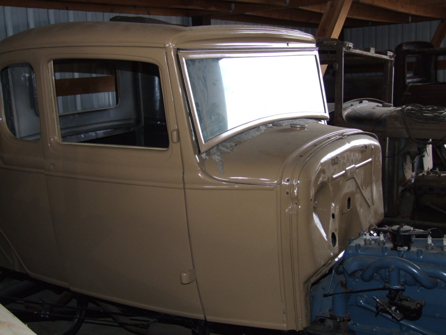

  6. [​IMG] my dad holding up the Vicky door still undecided whether I'll do a slant or not [​IMG] the difference between model a coupe hinge and a Vicky hinge which looks an awful lot like a 32 hinge [​IMG] oooohhhh yeah! Haha [​IMG] hmmmm what to do? [​IMG] Vicky doors are about 3" shorter than a coupe door so well see about the chop later on might leave the doors alone [​IMG] [​IMG] Vicky hinges are a tad different will have to modify it to work but the belt line lines up perfectly with the lower hinge in stock position on the Coupe cowl [​IMG] okay last pic!!

  7. [​IMG] original Henry Ford 3 Window prototype straight post [​IMG] original Henry Ford 3 Window prototype slant, I'd run a visor for sure if I do a slant or straight what do y'all think???

    Slant for sure!

    Get as slat cowl and your hinge problems are a lot easier to correct. Just noticed the two Henry built are a 1930 with the straight and a 1931 with the slant. Bob

  11. Hahaha I really thought everyone liked the straight window better here and Instagram told me the complete opposite is it because slants look better or more rare??

    SLANT!! No question. FWIW
    SLANT!!

    Have Moose over at photoshop add visors to both styles, and then see what you like best. I thought you had said you wanted a visor?

    Hey Dylan I right clik saved this years ago and its a great detail shot for the slant post model...Yeah its more work but I vote slant. I must say this car in the pic is quite rare as well...I'd say no to visor even but you can decide...

  21. I agree with that, I've noticed the Vicky and slant model As very similar to the 32 etc. door hinges, no visor, slanted windshield, window parts, webbing in the front of the door window, and flush fit doors, I personally I love the visor and the overlapped doors just screams model a to me

    They are not the same, but the fordor sedan can be modified to work on the Vicky. The windshield pillars are tapered and the sedan is taller than the Vicky so the tapers are different too.
