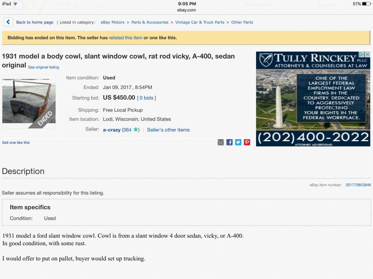

  10. This didn't sell, I'd say it's worth tracking the seller down.

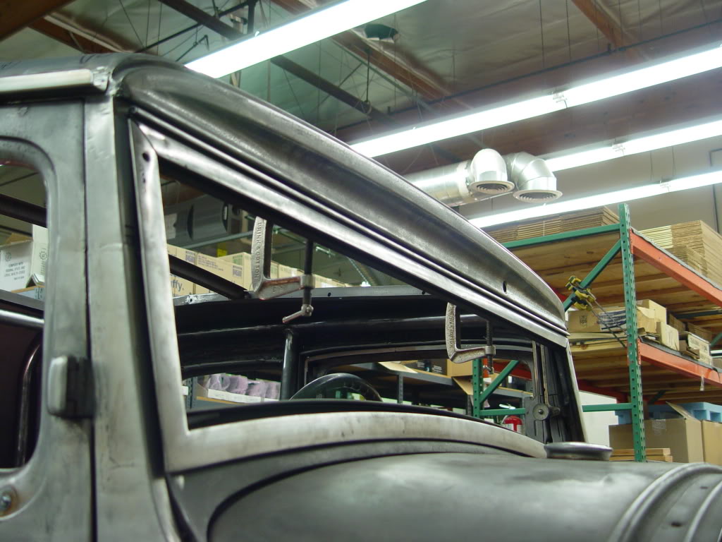

    The headers are different on slant window cowls
    Here's a 32 header and windshield in process on Dave's Vicky (Druss)
  11. D-Russ likes this.
  12. Dave did a really nice tech on the entire process here on the Hamb
    DylanHill1931 likes this.

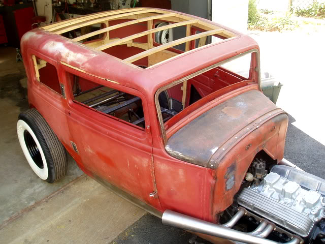

    upload_2017-1-30_23-13-48.png I don't know if my Steelback build is of any help to you, but here is a shot of the '31 slantwindow shell with a '29 Fordor visor. Bob
    Dannerr and DylanHill1931 like this.

    There are several '29 visors along with the 30-31, so study the designs and pick the one you like. That '29 I'm using was leaded in after it was tacked to the wood. I need to get back to that project and do something. Bob

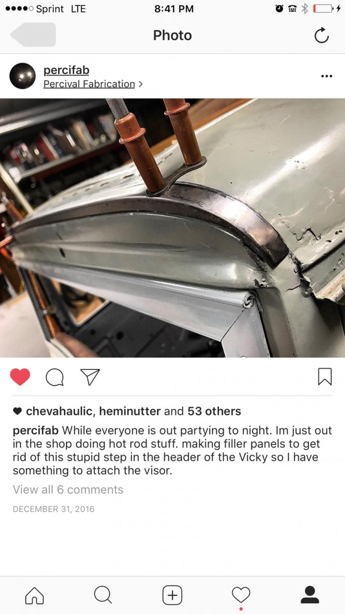

    Hey Dylan , are those motor cycle chain links ? Great idea . You should submit them to tech week . Blue

  19. This was not my idea unfortunately but yes it appears to be a motorcycle chain link, I am following the guy who posted this pic, was excited to see a Vicky with a visor and how he did it!!

    I think that is a clever way of getting the splice piece aligned till welded...not a permanent part of the build. 30/31 visor makes sense to me with the beading matching the year unless you are building a Jalopy...;)... seriously you got one already. Seating height is another consideration when determining sight lines in your ride...
