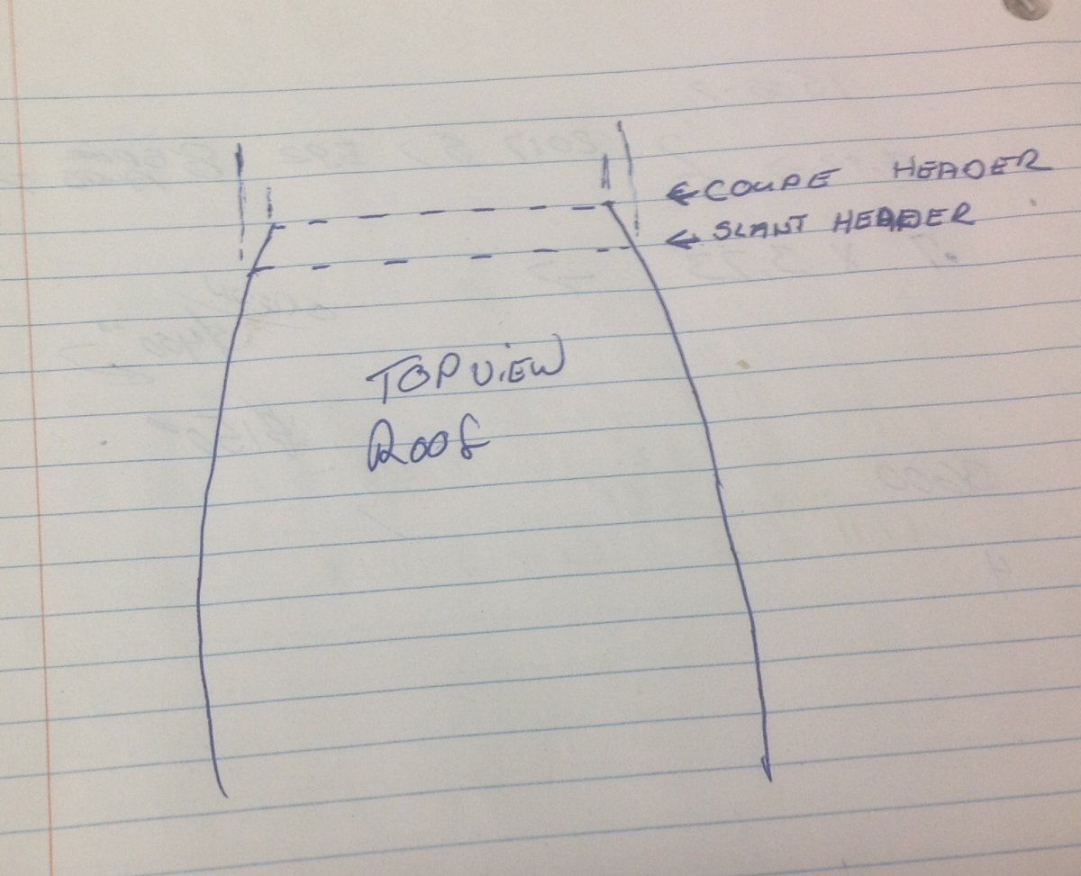

  20. The A has a tapered roof, in top view front to back.
    Leaning the windshield back gets into a different dimension due to the taper

  23. the problem when I line up the back side of the a pillar it throws off the rest of the slant a pillar,
    Can it be safe to say that the problem area is here?
    What I was saying before about the tapered roof was that this.
    The coupe header leaned back is likely to be too short for the slant doors.
    The rest of the roof line is going to be an exercise in imagination and proportions. You can do what ever you want with that one, just go from point A to point B so it looks good.

  25. What I was saying before about the tapered roof was that this.
    The rest of the roof line is going to be an exercise in imagination and proportions. You can do what ever you want with that one, just go from point A to point B so it looks good.[/QUOTE]

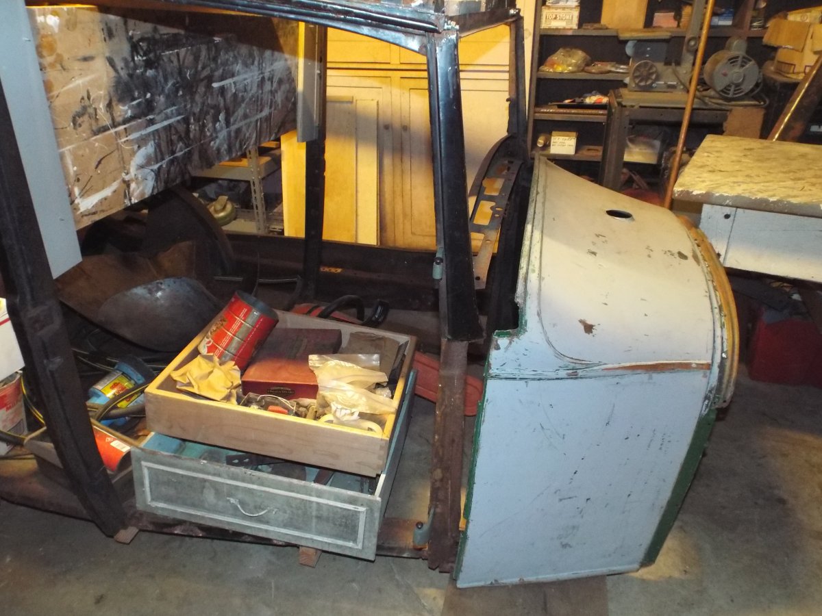

  28. [​IMG][​IMG][​IMG][​IMG] okay y'all I picked up another body! This one I can work with!! Got a good deal on it so I had to jump on it!
    brEad, Stogy, loudbang and 1 other person like this.
  29. [​IMG] would like to post some walk around videos on here but not sure how to but here's a pic of the body on!
