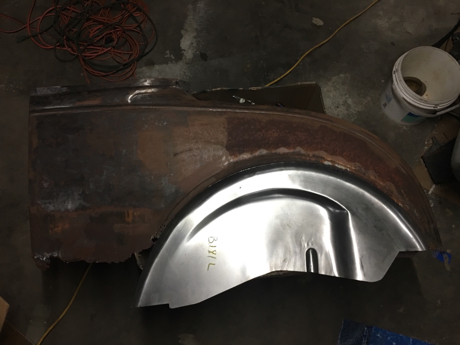

  5. [​IMG][​IMG] so I was working on the coupe last night and my dad said the guy around the corner that was helping him put the new rearend in his panel truck had some '32 Ford wheel wells that he's not gonna use so he said let's roll over and look the guy doesn't have a steel 32 but does have a few more hotrods but these are Brookeville patches and seem pretty nice! What y'all think of 32 wheel wells in an A they fit almost perfect just gotta trim the bottom some

  8. [​IMG][​IMG][​IMG] well yesterday was pretty cool, got to see what the quarters would look like with two of the 3 patches on! They're just clamped for right now but I really dig the 32 wheel wells and they fit perfect! Who would have thought?!? Still need to buy the rear bottom corners but it looks good so far! And also picked up this 27 T roadster cowl for a future speedster project after getting to drive a fellas yesterday I got the bug haha!

    I really love A wheel wells, but if I were doing what you're doing; on the low budget you say; and had the '32 wheel wells; I'd use them in a heartbeat. Have been and will continue to be watching over your shoulder.

    I really love A wheel wells, but if I were doing what you're doing; on the low budget you say; and had the '32 wheel wells; I'd use them in a heartbeat. Have been and will continue to be watching over your shoulder.[/QUOTE]
    I do too they have a good look to them and thank you I appreciate it and couldn't p*** them up for the price! Thank You sorry for the slow progress on it I'll try to get over there some more now that my pops knee surgery went well and he's back on his feet!

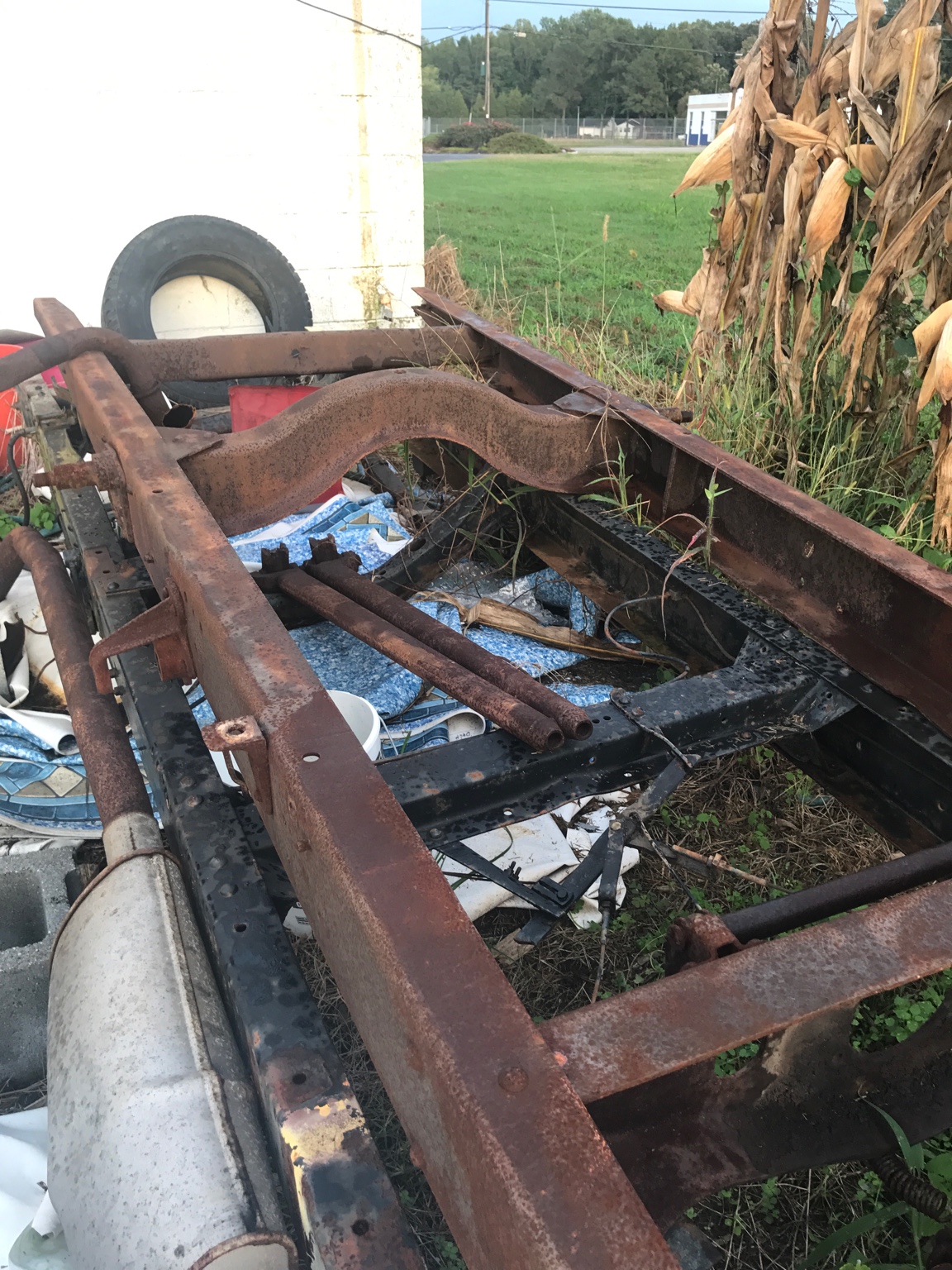

  18. Also decided to use one of the Model AA truck frames as they are a lot stronger, wider and resembles a '32 frame! Will look for a picture
  19. [​IMG][​IMG][​IMG][​IMG][​IMG][​IMG][​IMG] okay so got over and took some pics of the AA frame the one outside is my dads for his blown Sbc sedan and the rails I'll be using standing upright!

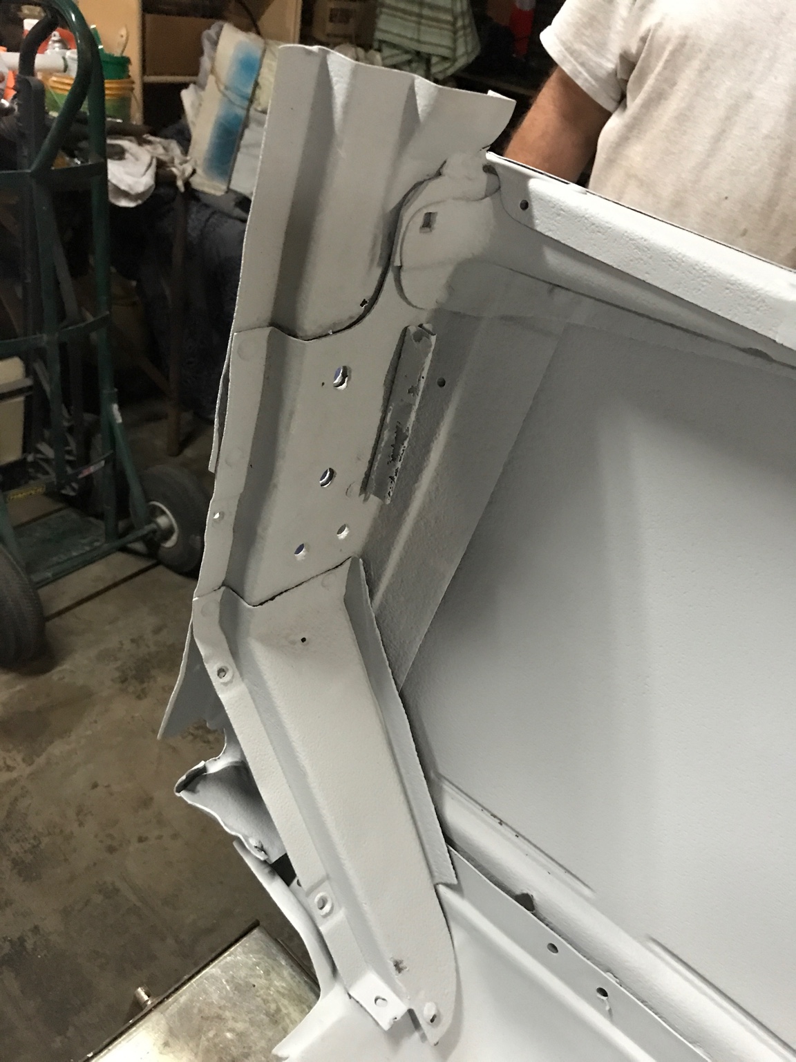

  23. [​IMG][​IMG][​IMG][​IMG] well I got some time last night and figured I'd just go at it and try to recreate it so here it is not perfect but I can tweak it and make it fit I will buy the subrails to go underneath the extensions but in case anyone wants to make one I took some construction paper and folded it on the original metal and laid out the lines and traces that onto the metal, put lines on both sides and used my metal brake and got as close as I could. Turned out better than I thought it would I'm pleased!

  25. first one wasn't accurate enough so I s****ed it and made a new one with a new template here they are [​IMG][​IMG][​IMG] not as good as some of the guys on here using files but got it close! Need to invest in some nice metal files and other metal working tools a dremel and angle grinder will have to do the trick for this one! [​IMG] the front mounting hole was torn out and gone so I cut out a rough piece of metal and welded in place [​IMG][​IMG] it fits in the cowl pretty good! [​IMG][​IMG][​IMG] and with the exception of the mounting holes ( will need to finish the A pillar brace to mock up) this subrail extension is done!

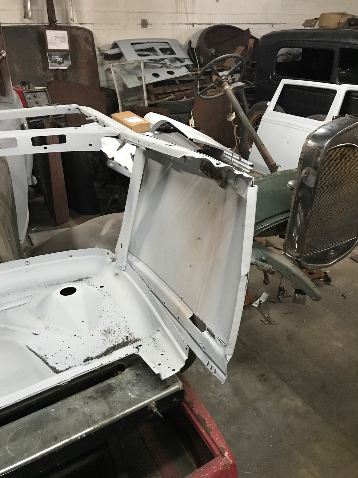

  26. [​IMG][​IMG][​IMG][​IMG][​IMG][​IMG][​IMG][​IMG][​IMG] some more progress on the cowl! Primed the inside of the brace and a pillar where I repaired it letting it dry and then will start making the lower inner cowl panel! Some more little things like cracks and straightening to fix that I won't bore everyone with will post a pic of the completed lower cowl next!
