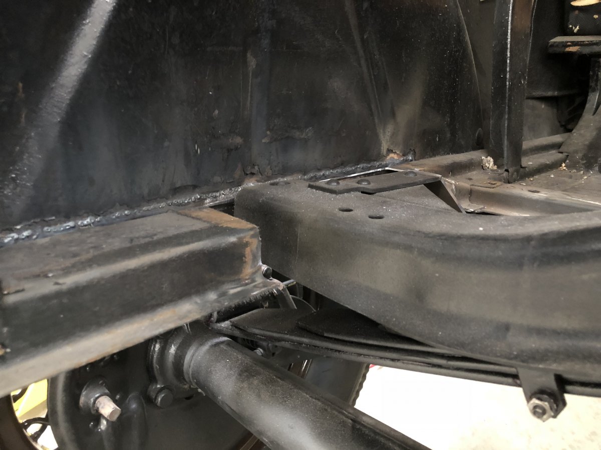

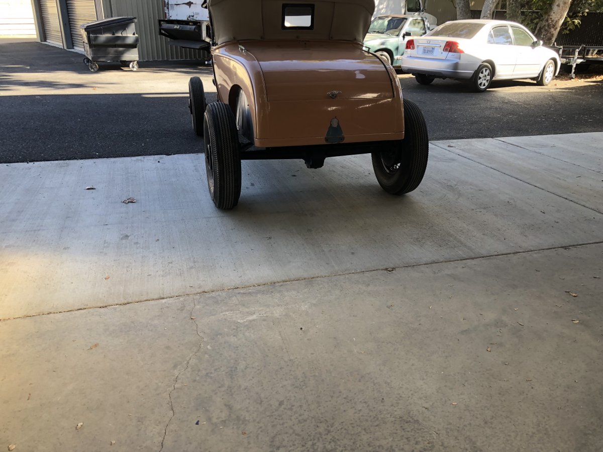

    017E4DB2-12BF-4771-9476-67AD72E30F70.jpeg 91AD9460-ACE9-4198-B631-49F0CA6609CB.jpeg B3924E86-37C8-45AF-9235-FA72686600EA.jpeg I miss-spoke apparently I have never messed with a model a with decent subrails, or if I did a street rod frame was used, I had to make a 1/2” bump in stock subs for this car, not a 30 but this maybe of some help
  25. Very nice looking roadster! And I like how you did the subframe, I suppose you just clearanced the subrails enough to slide over top of the frame?! Did you just bolt the frame directly to the top of the frame?!

    BB9F5636-F68F-4980-9DBB-8B3A6F20B156.jpeg 6ECEEE15-672C-4A69-BCB2-3E94DC97A3E6.jpeg
    Basically I just made a little riser and used a little piece of 3/16 as a spacer/ re-enforcement where the subrail bolts to the crossmember , the car was a rumble seat car so we used the rumble seat riser , and cut a hole in it for the crossmember to poke through and a stock model a crossmember cover on top of that
    The rear spring is from 100% Matt on here I think a guy could probably de arch it another inch or so but after that the u bolts would come a little to close to the banjo for my taste
    Oh and the tires are 7.00-16 and 5.50-16 in case you want to compare to what you are going to run

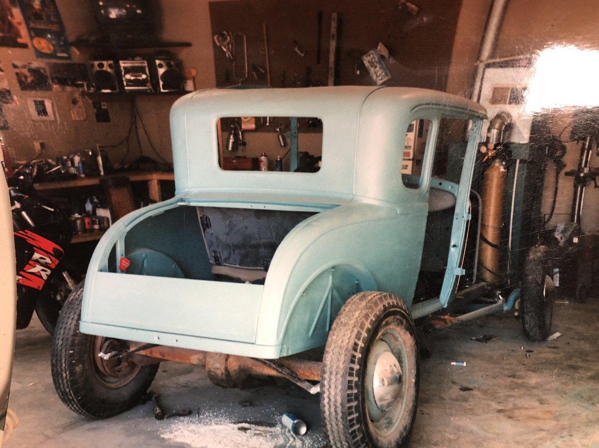

    Was digging around and found a pic of my old coupe, this was the 2x4 tubing stacked on top of a frame with a 2” round crossmember centered 40 rear ended and spring , those tires in pic were 6.50-16 E9B3A781-AF1F-45C5-8579-A673D2B6D0EF.jpeg
  29. That sits good! I like that! Not looking for super low with my coupe, I just want it to be noticeably lowered from stock....but I’m sure to someone who doesn’t know they’ll think it’s stock height lol, thank you for posting I just bought some 2x4 so I may end up doing this!
    loudbang and Stogy like this.

    No prob. The reason I did the frame that way was that I actually only had the front half of the frame from center cross forward , so grafted 2x4 from there back then stacked it about the wheel well area , so on this particular car the frame didn’t “bowe out” like a typical a frame ..it was a consistent taper , if I remember right the frame poked up inside the subrails you will need about a 2” c notch but with 4” tubing there is a lot of meat on the bone yet, the 40 spring will make it ride like a Cadillac compared to the A spring
    Like I said those moch up tires are only 6.50 which is 27” I think?.. so a 7.00 or 7.50 would really fill in the wheel well nice , the front moch tires were Harley sportster tires , they were about 25-26” I think , that picture is about 20yrs old, I’ve had some head trauma since then so things are a little fuzzy
