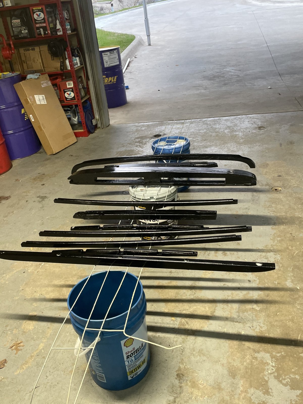

    Getting ready to put the wood in the body. I'll be sealing this and painting it black once we get a warm day.

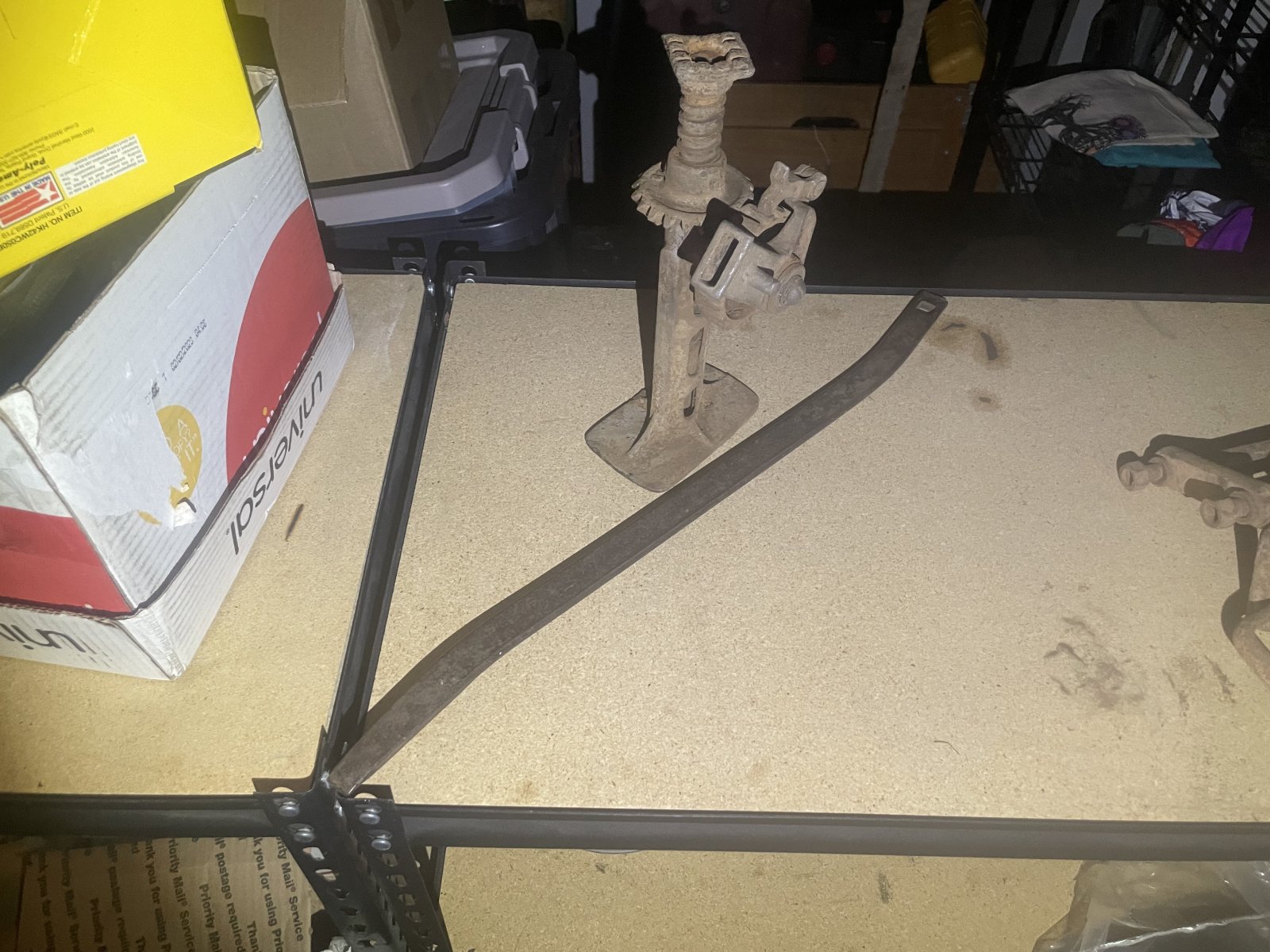

    I forgot to mention last week- the old jack that was under the seat cleaned up well. It seemed pretty ****ed and I didn't have any expectations that it would emerge from the acid bath in a usable condition, but...
    A little bit of love got it broke loose and it works great. This is actually a late 31 Ford script AA jack, so it may be the truck's original jack. Sadly there was no handle. Worth jack **** but pretty cool that it gets a new lease on life & stays with the truck.

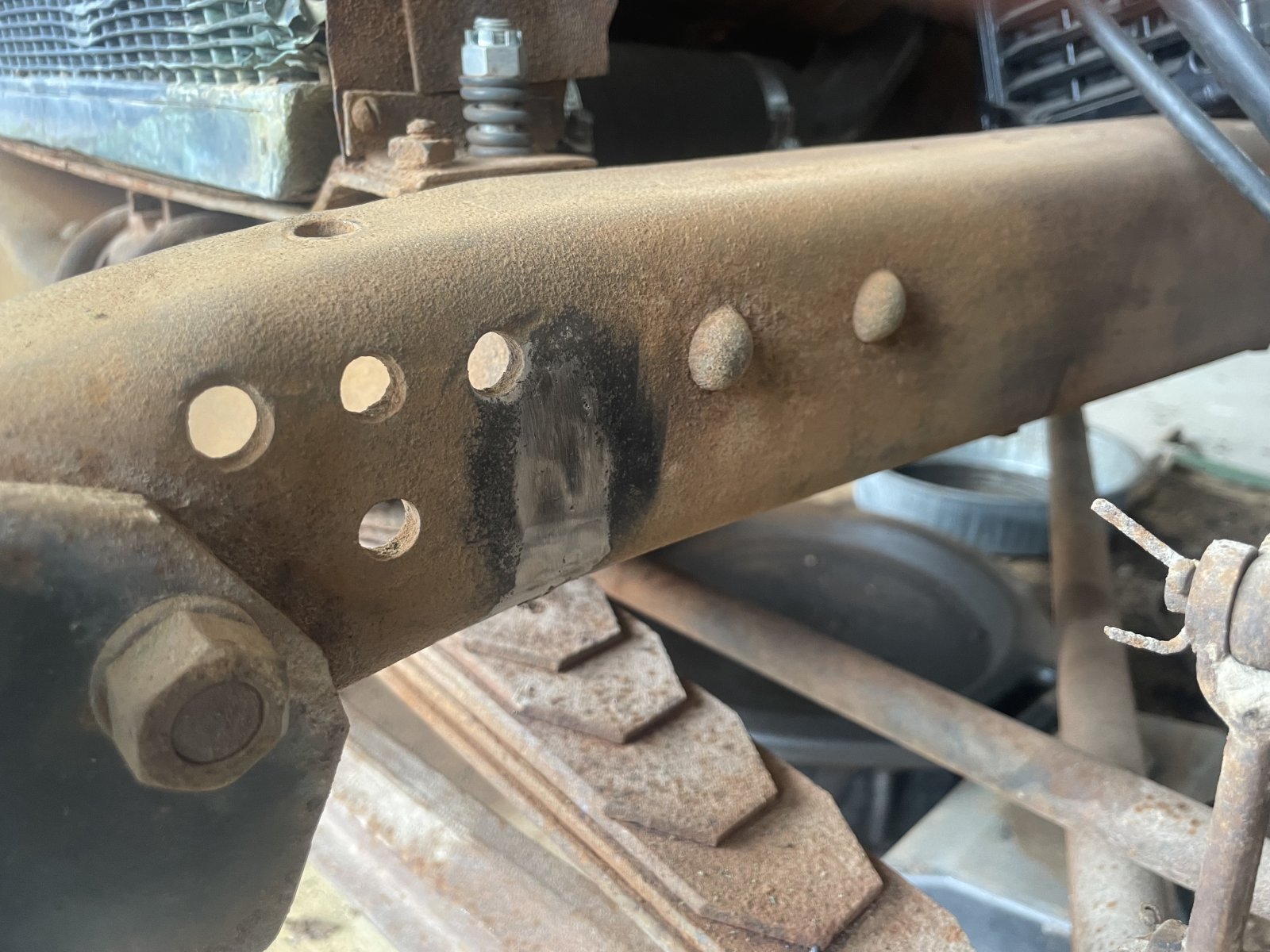

    Been plugging away... time limited but getting 30 minutes to an hour each day to accomplish small tasks on this truck is helping it come along pretty good.
    While removing hardware I was reminded that this was once just an old truck and keeping it moving was more important than doing it right... the fenders were brazed to the frame in a couple spots and the bolts for the front fender braces were welded to the braces. The frame rails are mostly cleaned up and ready for paint. Have a couple spots inside the rails I need to give a little more attention to.
    Unbelievably, two of those nuts just unscrewed like nothing was wrong with them. The third one had to be ground out. On the other side, they all just came right off.

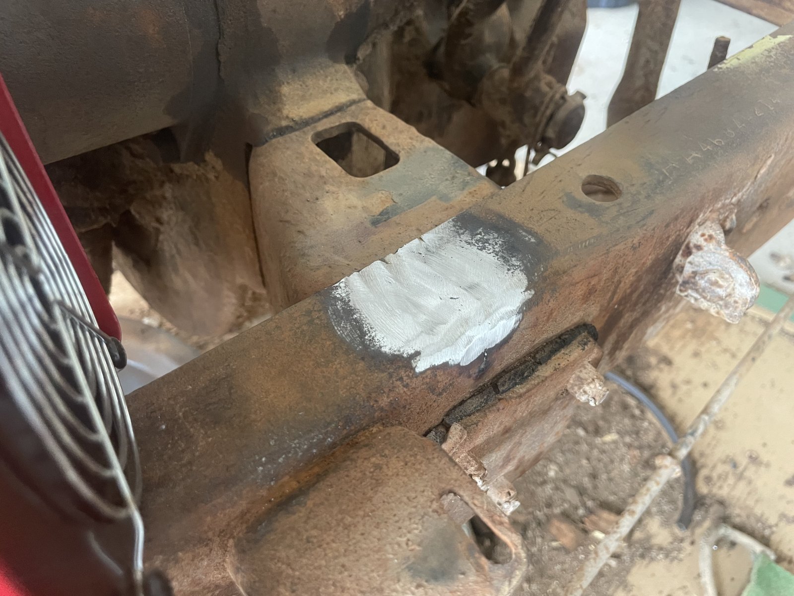

    There is a crack in front of the crossmember on both sides. I know this is a relatively normal crack for Model As due to frame flexing & the stiffness created by the bumper. I think it propagated extra high on this truck because of the huge *** bumper and the use of a winch (we are pretty sure it had a winch). I'm just gonna V it out and fill it with 7018.

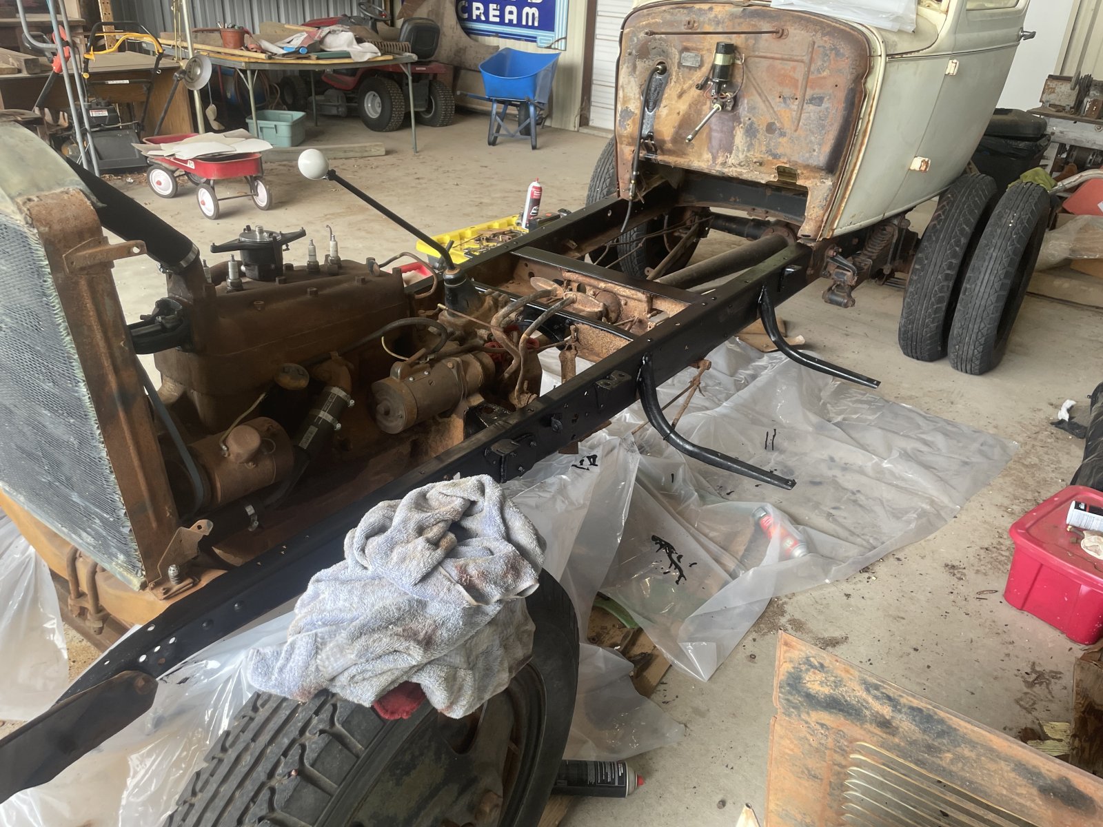

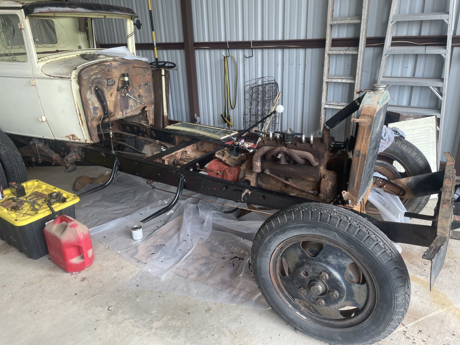

    Finally got a winning combination of weather & time, so I went by after work with Saul and got to work. First things first - welding!
    I fixed up the couple of issues the frame had before we put some paint down...
    Suuuper happy with the way this Eastwood ch***is paint went down. That's the outside of the front section done - inside next!
