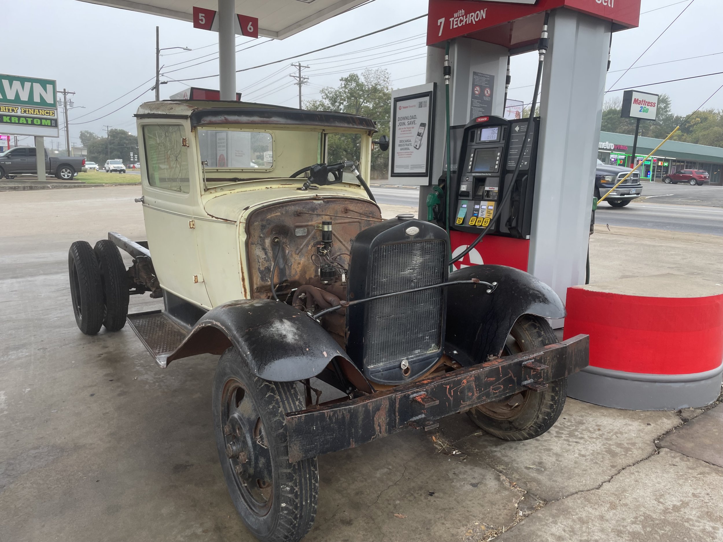

    For truck use, you want torque. If it's to remain visually stock, you aren't going fast (brakes, suspension). Repowering would be best served with a small diesel. Say something that powered a generator.
    osage orange likes this.
  2. trevorsworth
    Joined: Aug 3, 2020
    Posts: 2,109
    trevorsworth
    That little ecoboost puts out like three times the torque of the banger lol. I would probably be retaining the stock rear end, it can handle 65 mph with OD which is as fast as I'd want to go in this truck.
    I considered a ***mins 4BT but I don't think it would fit under the hood after measuring...
  3. RodStRace
    Joined: Dec 7, 2007
    Posts: 10,915
    RodStRace
    30.6″ in length, 24.6″ in width, and 37.7″ in height
    Yeah, that's not reasonable.
    That truck with a quarter ton on the back (500 pounds) would be a handful at 45!
  4. trevorsworth
    Joined: Aug 3, 2020
    Posts: 2,109
    trevorsworth
    I had it up to like 35 or 40 and it was tracking straight. Other than the square wheels and wobbly cab it seemed completely comfortable at speed. But the brakes are a big question mark.
    I haven't really driven the truck enough to get a feel for the brakes. Actually, I haven't touched them at all. They worked while yard driving and up and down a country road but I don't know how well they really perform.
    I know I have faith in the mechanical brakes on my other car after rebuilding, but that car weighs nothing... this truck is almost 5k unloaded. I have learned that the hydraulic brakes from later trucks (through 48 I believe I read) will bolt directly on to the AA spindles. So that's something to think about.

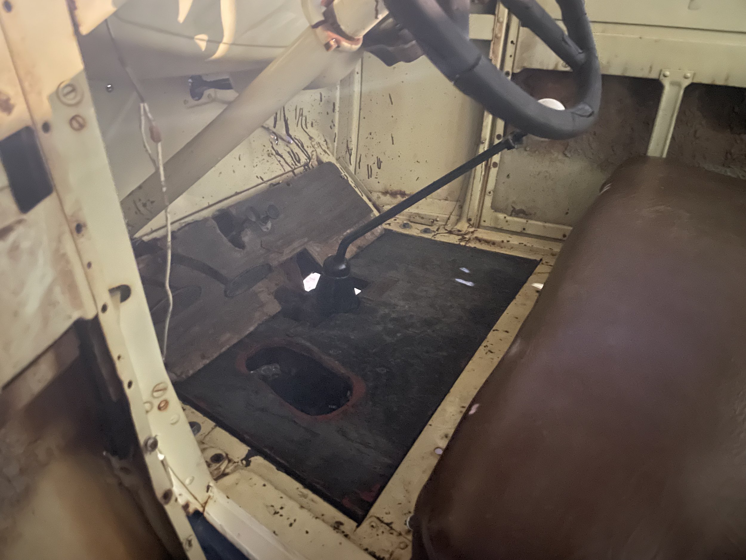

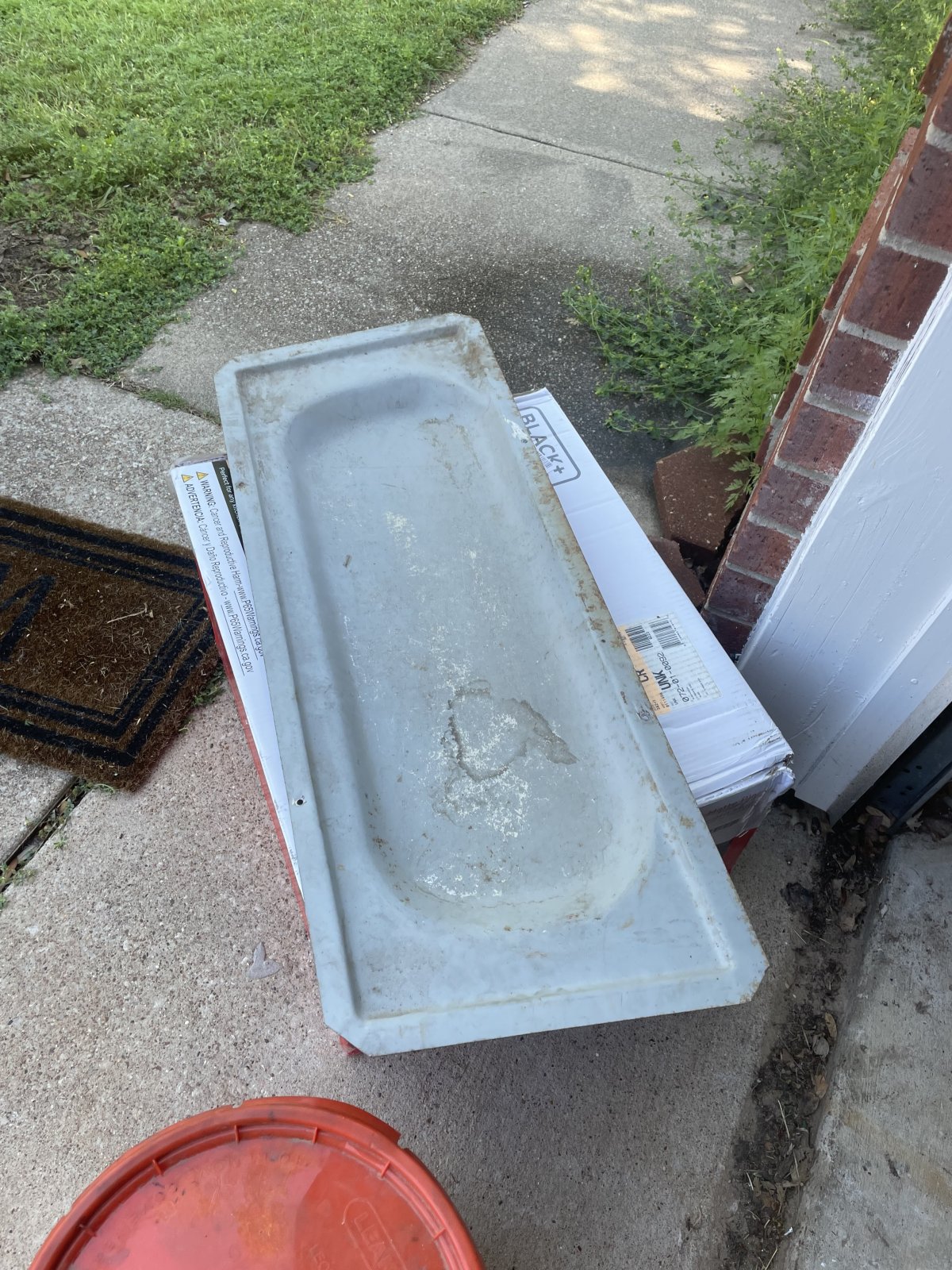

    Still haven't touched the truck, but while packing I did find a floor pan I thought I had given away which will fit my truck cab perfectly. Installing this will be the first thing I do once the cab is back in position.

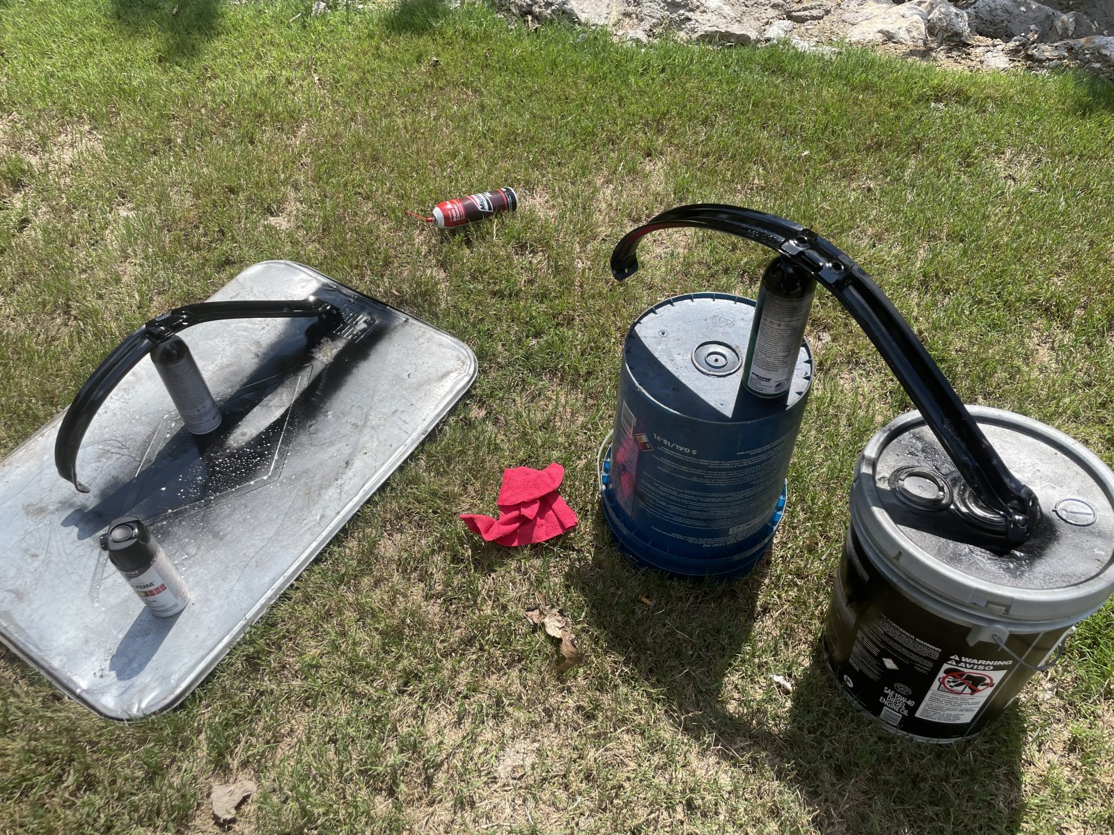

    Had time today (barely) to shoot some paint on the new fender braces. Supposedly later we are taking a shop field trip after work to get the fenders & cab mounted. With 6 pairs of hands that will hopefully go quickly. Update to come if that pans out.

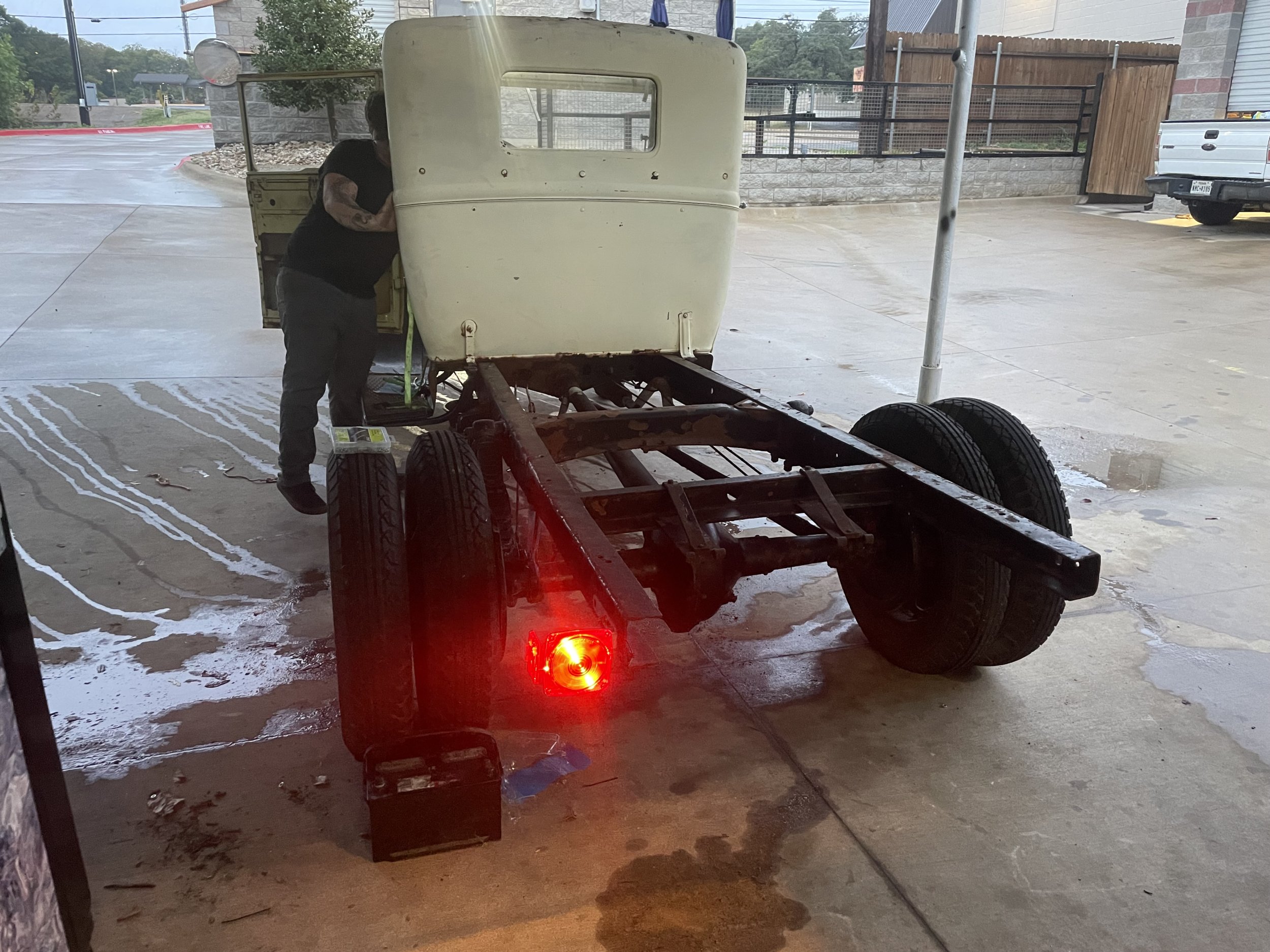

    OK... haven't touched the truck since last time I posted but we are done building the new building at work and the owner told me to bring it to the shop so we can get it done on company time... should be some progress happening from now on.
  24. trevorsworth
    Joined: Aug 3, 2020
    Posts: 2,109
    trevorsworth
    Cab is bolted down. Tomorrow or Wednesday we will have it running/driving again, then it'll be wood time.

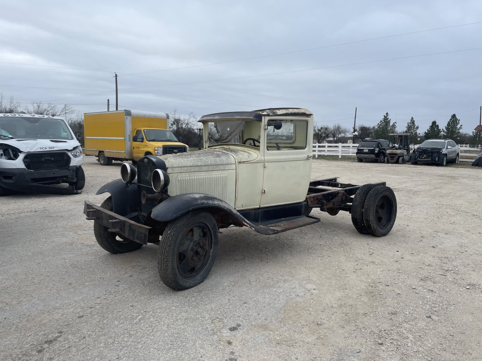

    I pulled in to work this morning knowing today was the day.
    We've got some stormy weather coming up so the truck had to be able to haul itself into a garage.
    It didn't take long to get it going. The Marvel carburetor I built didn't work so I slapped the leaky Tillotson from my very first Model A on and...
    So what do you do when your 100 year old truck proves that it will run for 5 minutes after sitting for 54 years? Put some air in the tires and hit the road...

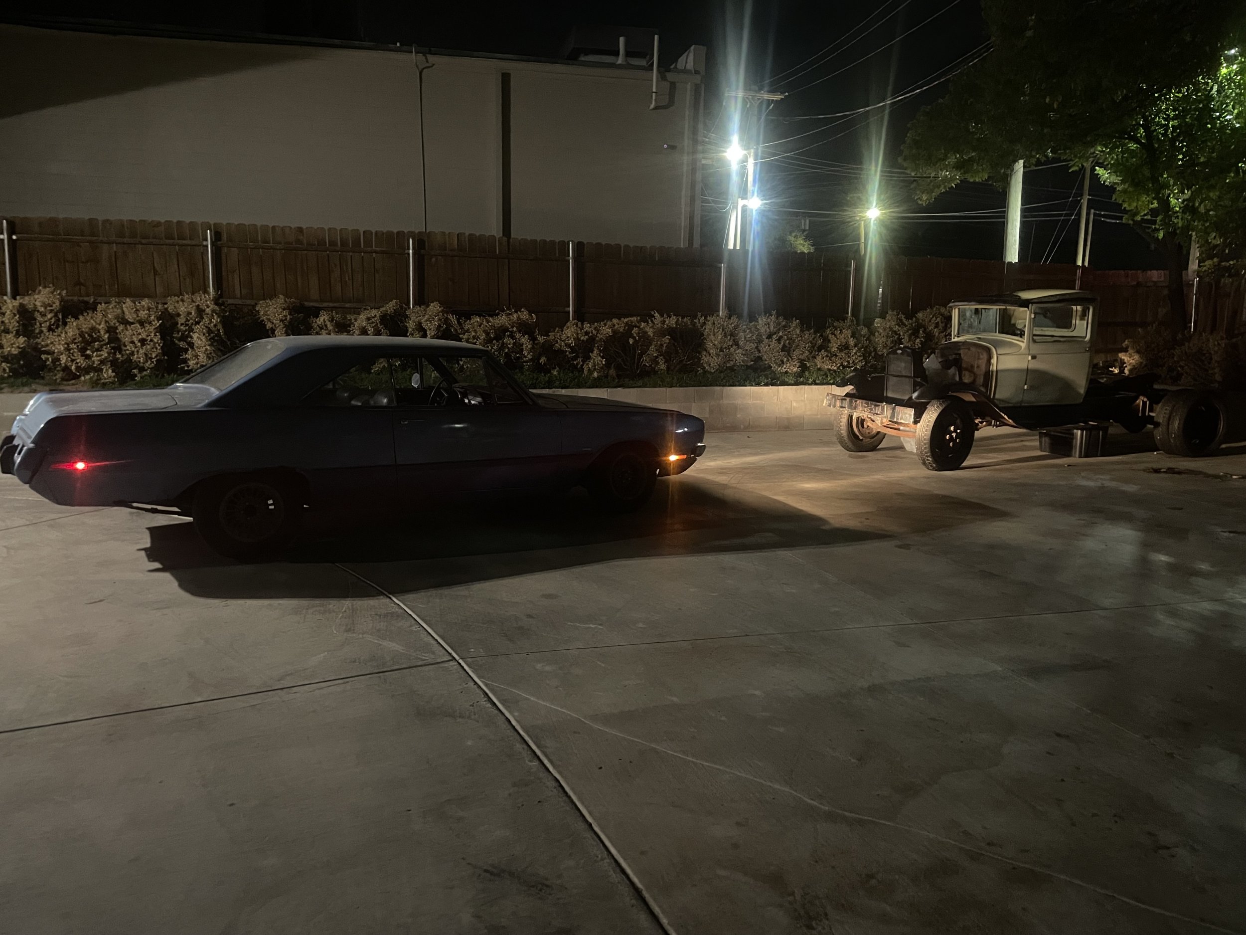

    The machine gods giveth, the machine gods taketh away... was hauling *** home on the interstate in the Dart and the throttle cable snapped lol. I turned the idle up as high as it would go and drove 15 minutes home like that...
