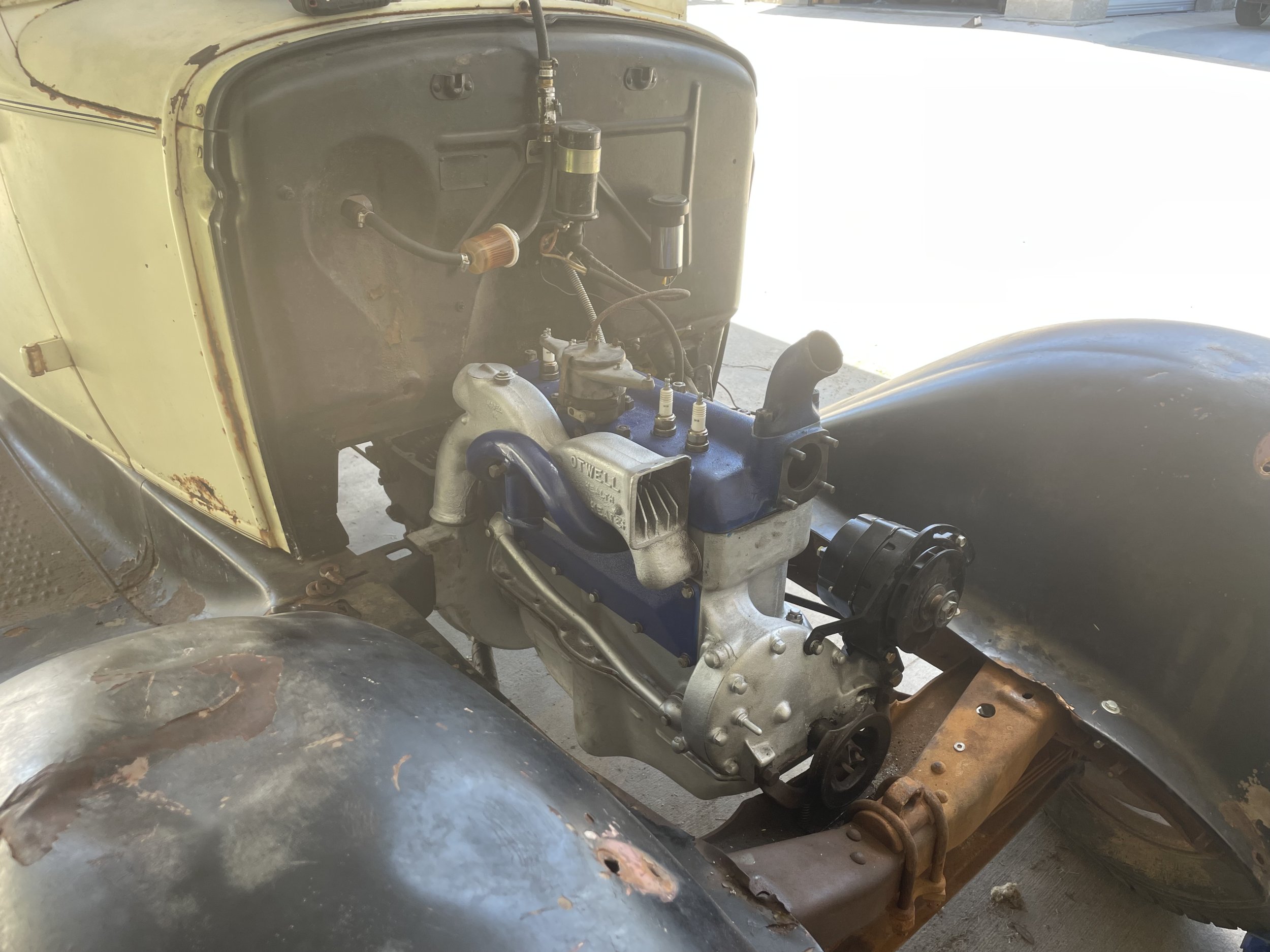

    Had a really long and smooth drive today including a tow for a stranded Suburban that was waiting on AAA but stuck facing up a hill at an intersection. But upon returning the truck was ******* oil like nobody's business. The oil level is quite a bit higher than it was after changing it the other day so I am ***uming the head gasket finally let go and I have oil up above the rear main. Not overheating but I do see a lot of yellow sludge ac***ulated in the filler neck... so we are doing the head gasket one day this week.
    I "should" have done this already but it will hopefully be easier now that there have been a few hundred heat cycles since sitting up for decades.

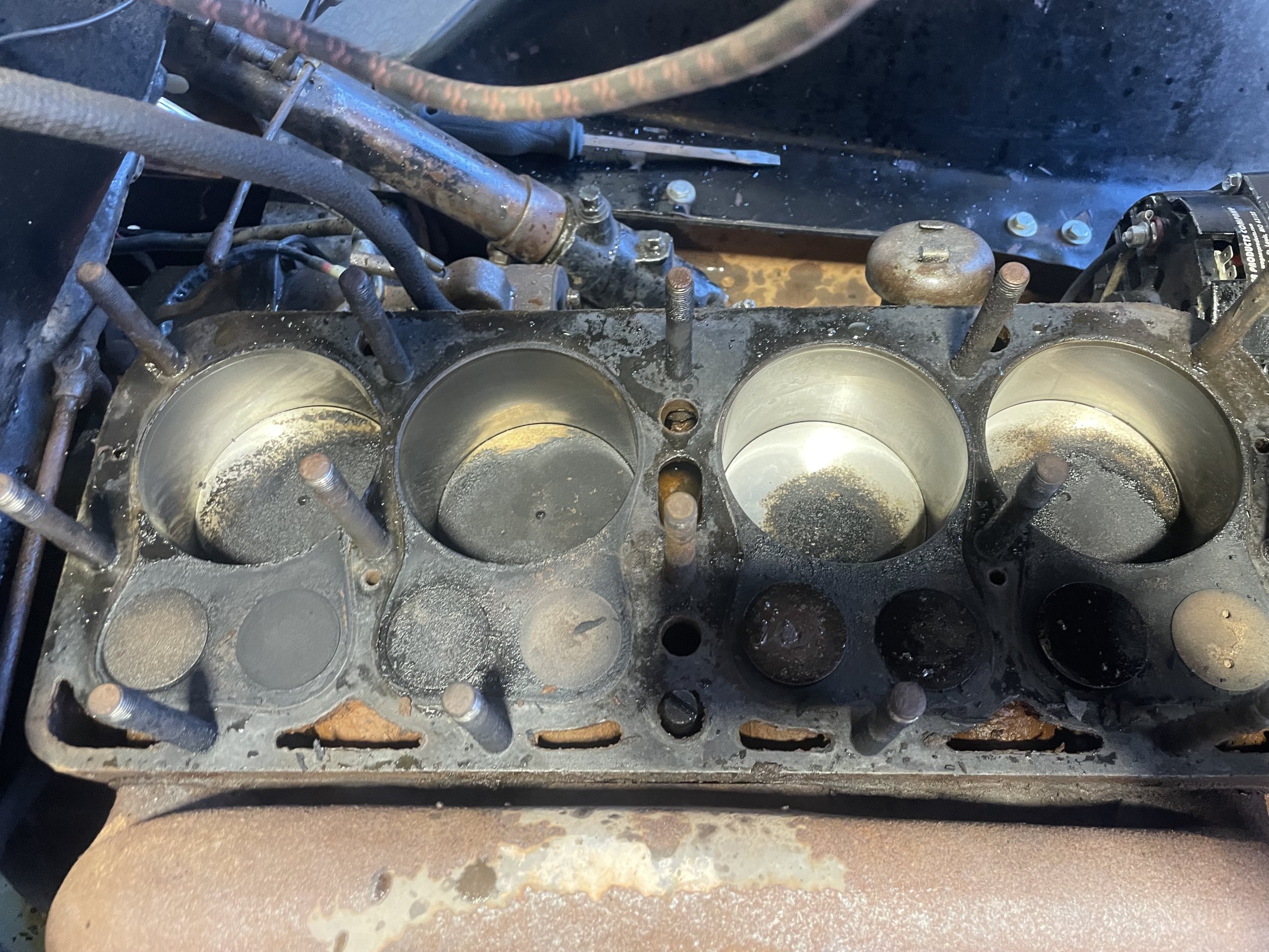

    Looks better than I expected in here, but the head gasket was definitely blown & came out in 3 pieces. It was as easy to remove as I'd hoped - let it warm up this morning while spraying the nuts with PB periodically and everything popped right apart - so now it's just cleaning and re***embly.
    I filled the water jacket with evaporust. Expensive but it needs it.

    Great to hear! I was hoping it wouldn't fight you. Looks like pretty even burn and no obvious toasted valves either. Can you get a straight edge to check? Looks like #2 was where it leaked, between it and #3.

    Yep, #2 had the worst of it. It looks good to me overall... The head is straight so once the evaporust works on the water jacket for a while I'll get everything cleaned & bolted back up. I was not expecting this engine to be this clean inside!

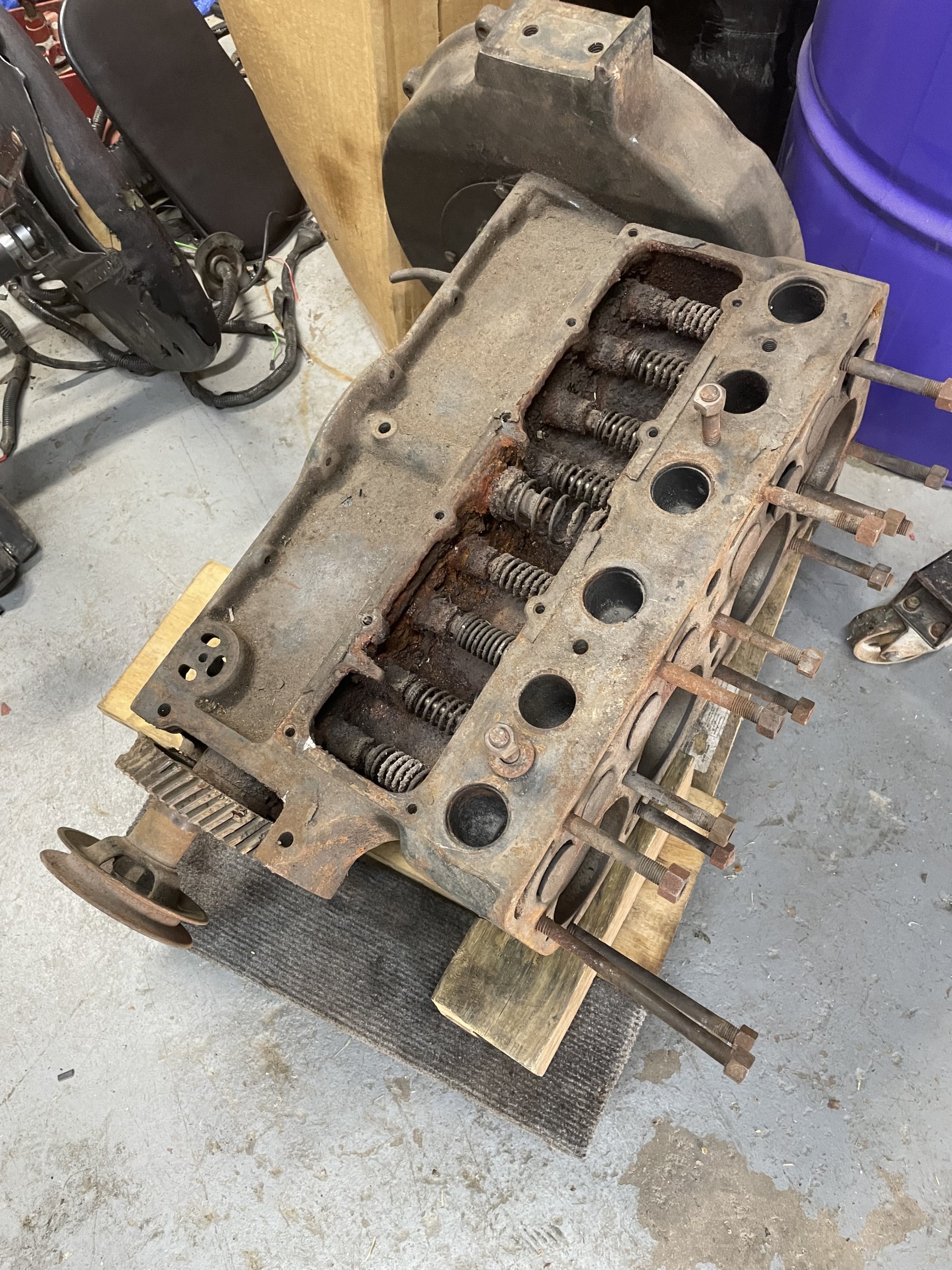

    IMG_1047.jpeg IMG_1048.jpeg IMG_1071.jpeg IMG_1073.jpeg IMG_1078.jpeg IMG_1077.jpeg IMG_1079.jpeg

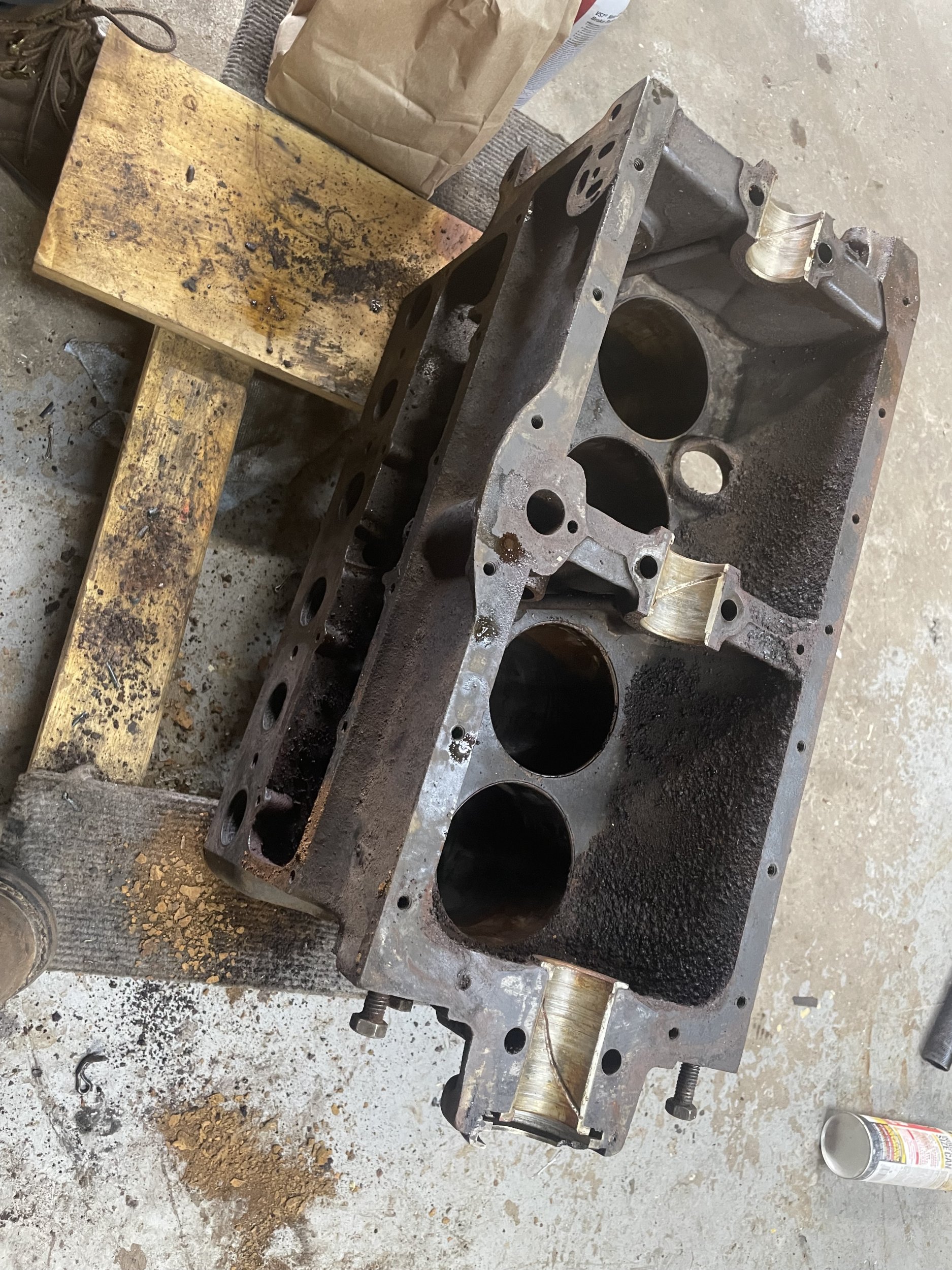

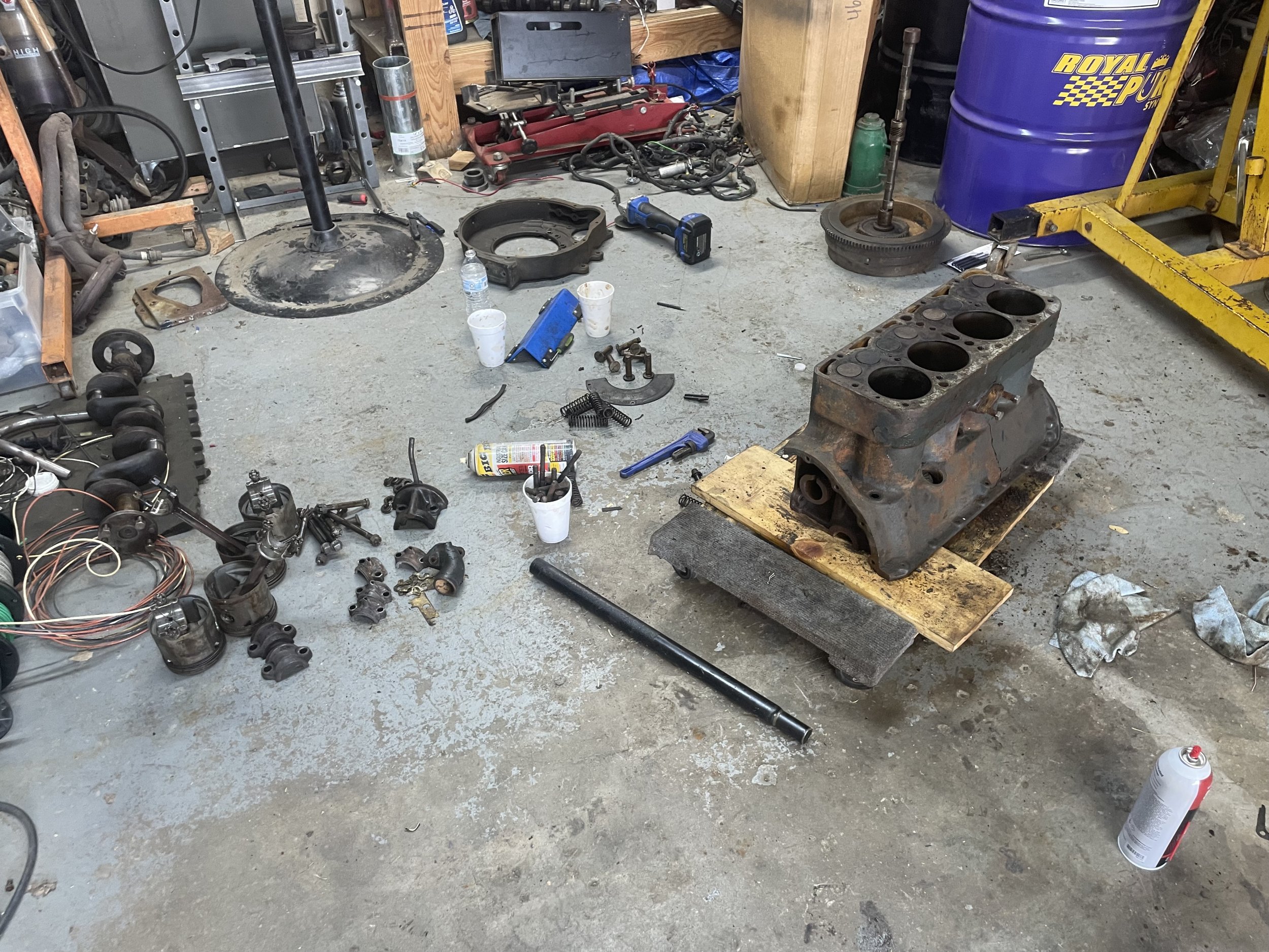

    My friend & always-on-call Model A guru George found a short block in his shed and told me to come get it. It had been sitting for a while and got some water in the valve gallery but it's not too bad overall I think. I was careful not to spin the crank as it came apart and I believe these bearings look good - still had all the shims so should be lots of life in it. It has been sleeved, pistons do not seem to be stamped so I'm ***uming back to standard bore. Got everything out except the valve guides - I made a valve guide tool but it only worked once so will just order one. I will have a machine shop run through this & polish everything, hone it & deck it.
    Trying to figure out what all I should order and what is OK to salvage off the AA's engine...

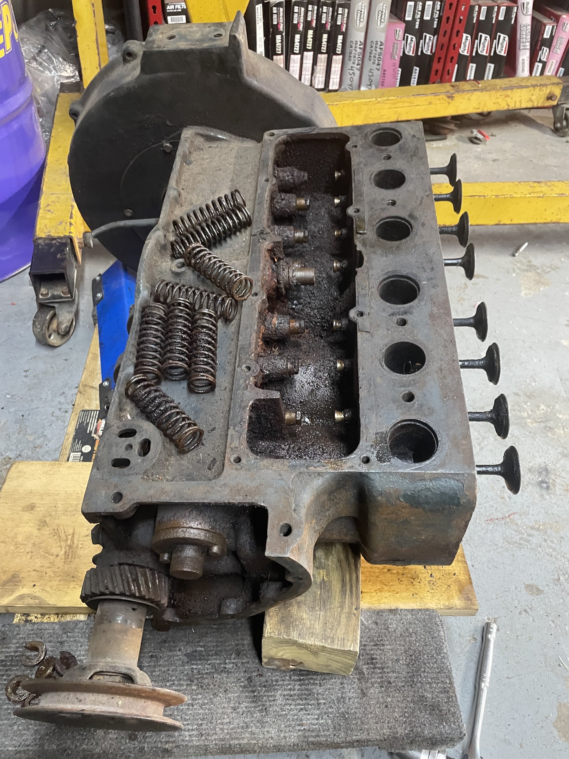

    Finally got the valve guide tool in & knocked out the remaining valve guides. Dropped the pile off at the machine shop this afternoon. They are going to clean it, deck it, hone it, polish the crank and cam, and re***emble the rotating ***embly for me. I will do the valvetrain myself.

    Thanks! I feel confident I could do the rotating ***embly but might as well let the machine shop set up the bearings while they have it. I don't want to have to do this twice.

    You should have them check the manifold surface too. Better to get it straight before all the rotating ***embly is in.
    Clean, clean and one more time. Every threaded hole, every gallery, every surface.
    Then do something, do another task then go back and recheck. Don't flat-rate it! :D
    With the big truck back in service, you won't have to do multiple trips in the roadster. Yeah, that's no fun! :D

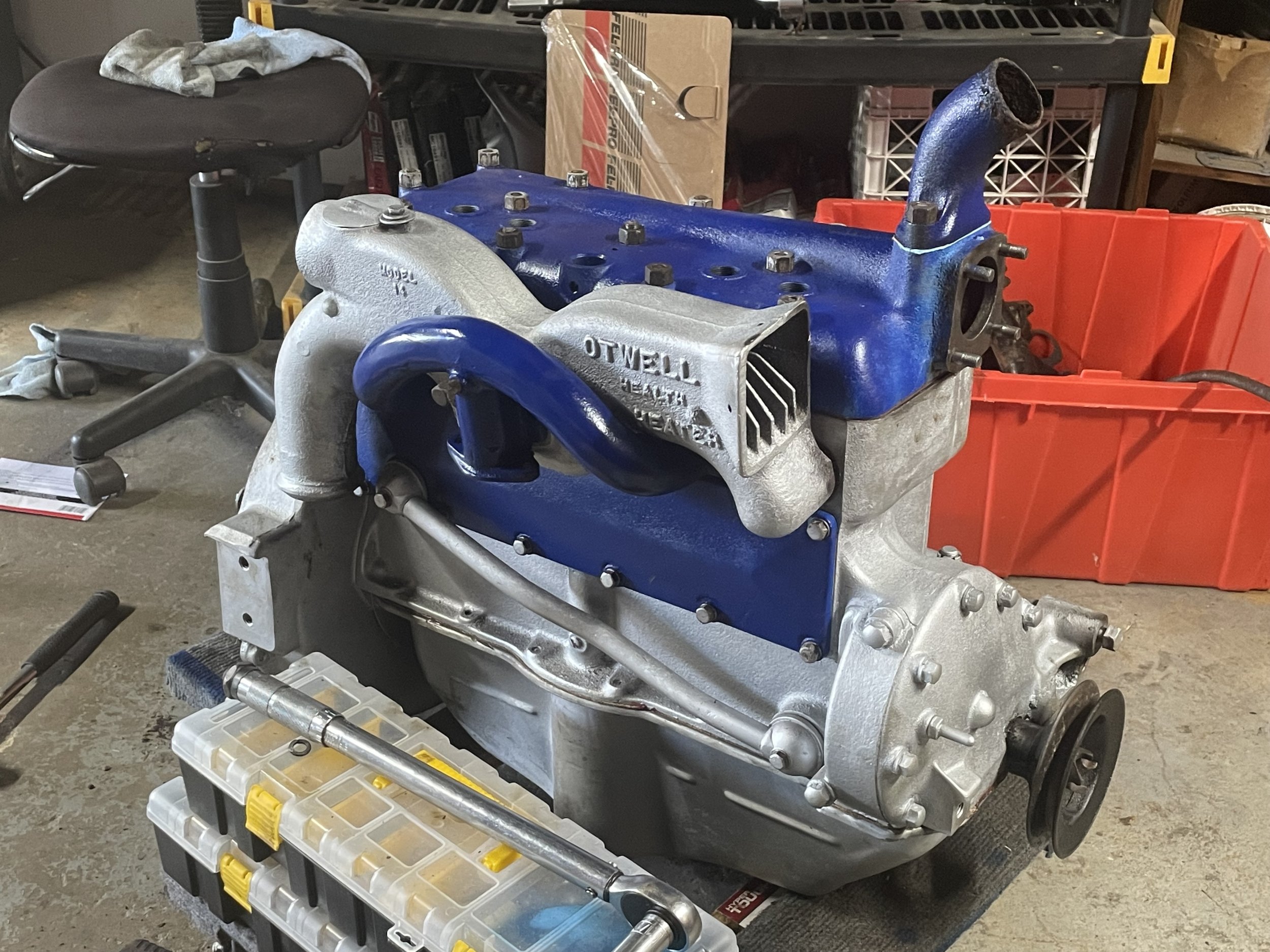

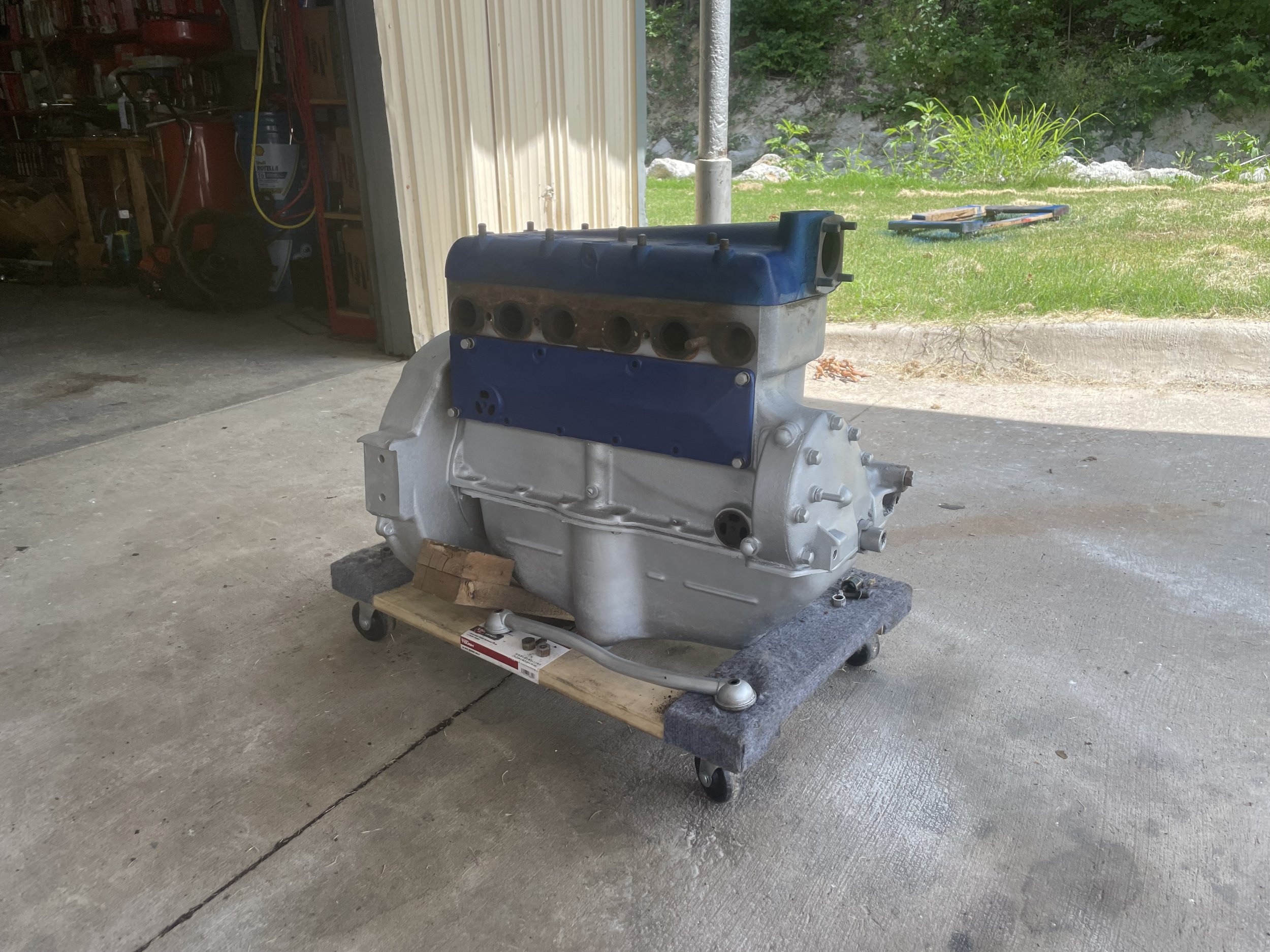

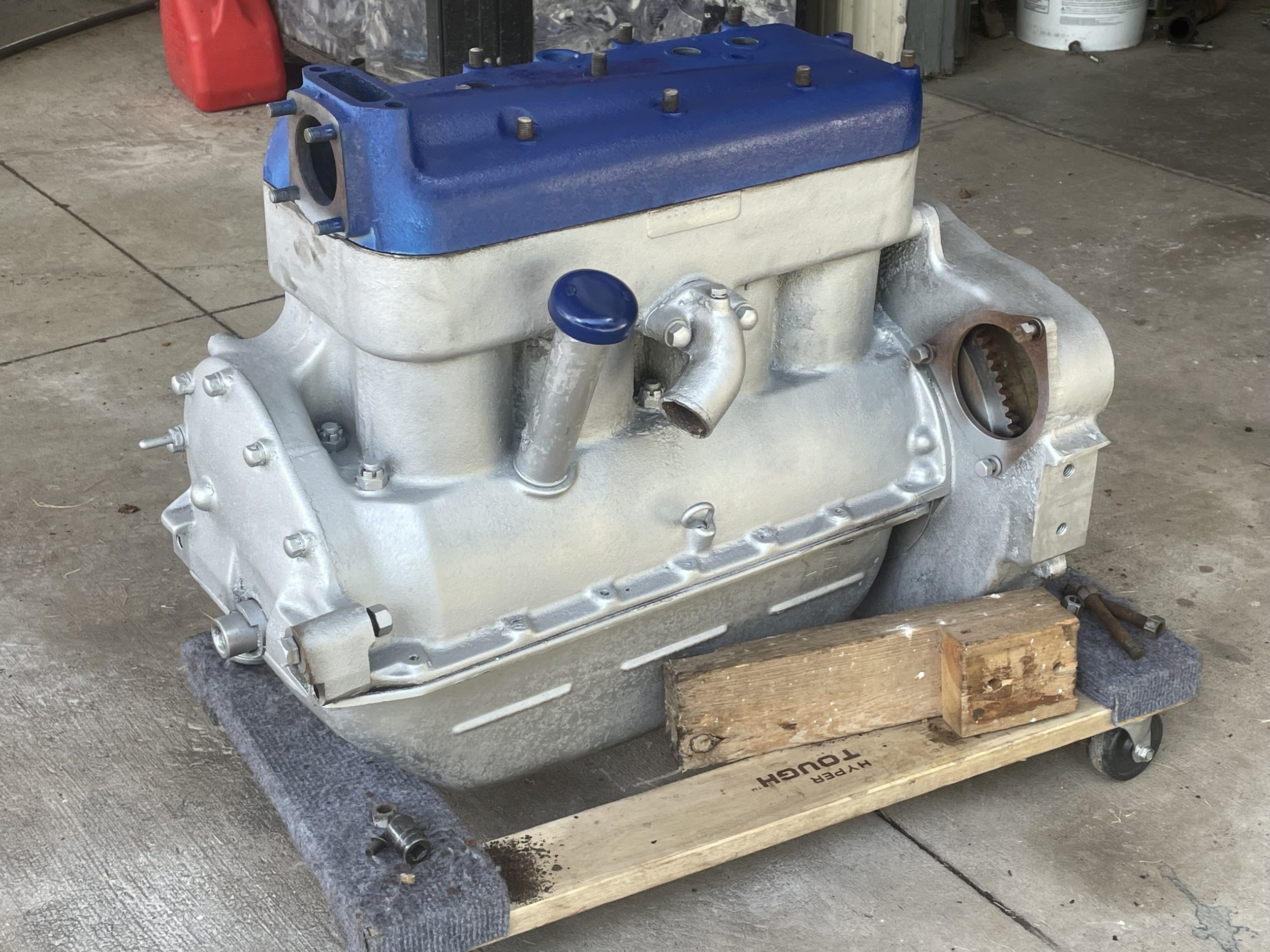

    Posted in my T RPU thread about the engine score, so I won't retread that ground here. However, we spent some time cleaning up the engine and painting it today, then cracked it open for real.
    This thing looks like I picked it up from the machine shop yesterday. I can't believe my eyes...
    The engine has an August '30 cast date and is bored .060 over. Since our target is to have it in the truck and running tomorrow, I didn't waste time looking for the correct Ford green paint and instead am going with silver and blue to keep it simple. I'll post a picture when it's back together.
