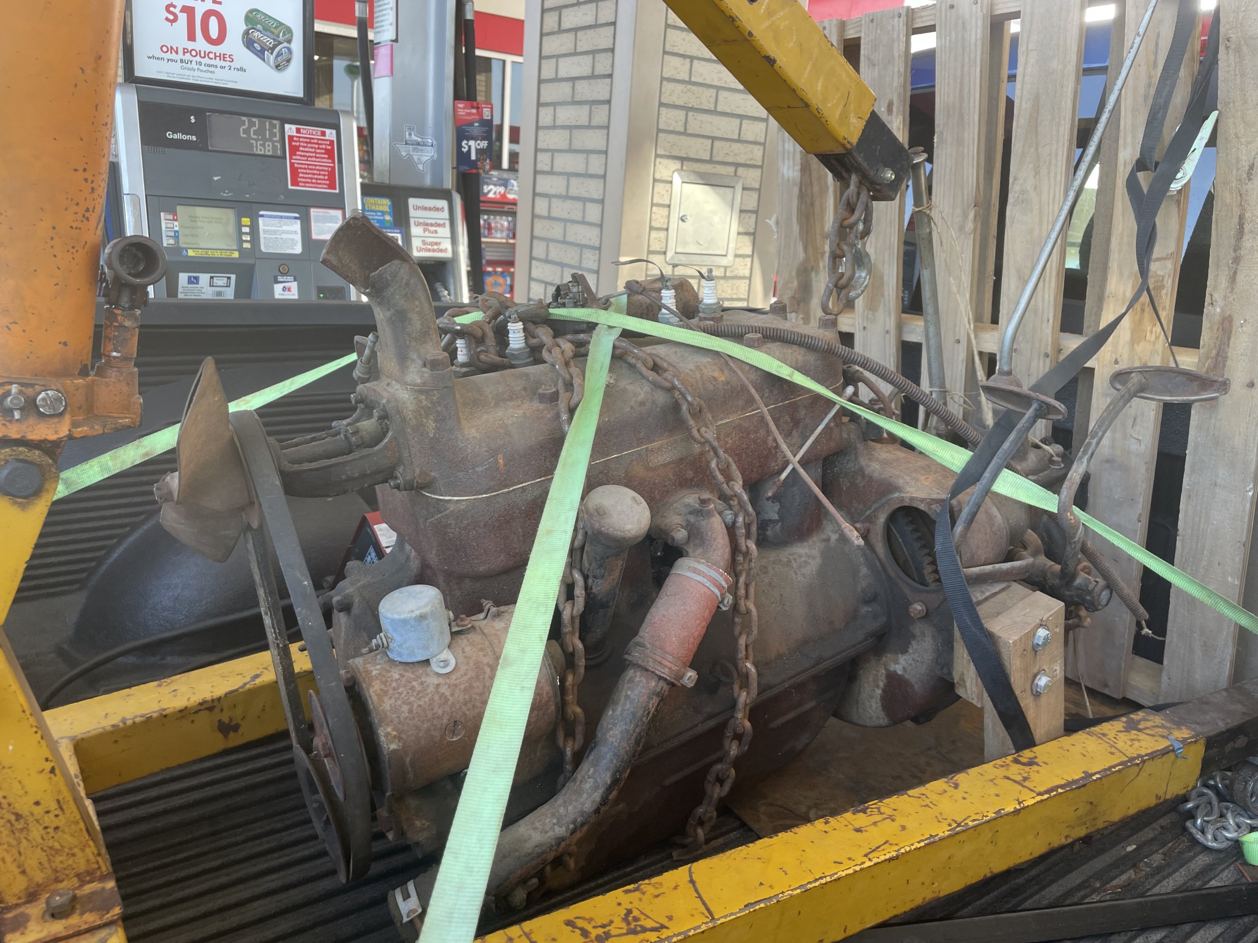

    Same carb - same timing adjustment - same clutch but feels different with different flywheel. I'd check part numbers and interchange (Ford Barn?)
    But check the basics first. Make sure they are all in spec.
    That said, I wonder if the cam is off. Car had 500 miles and the engine looked like this before.
    Was it pulled to hot rod, or was it a dog the whole time and the guy upgraded, or was it a part out?

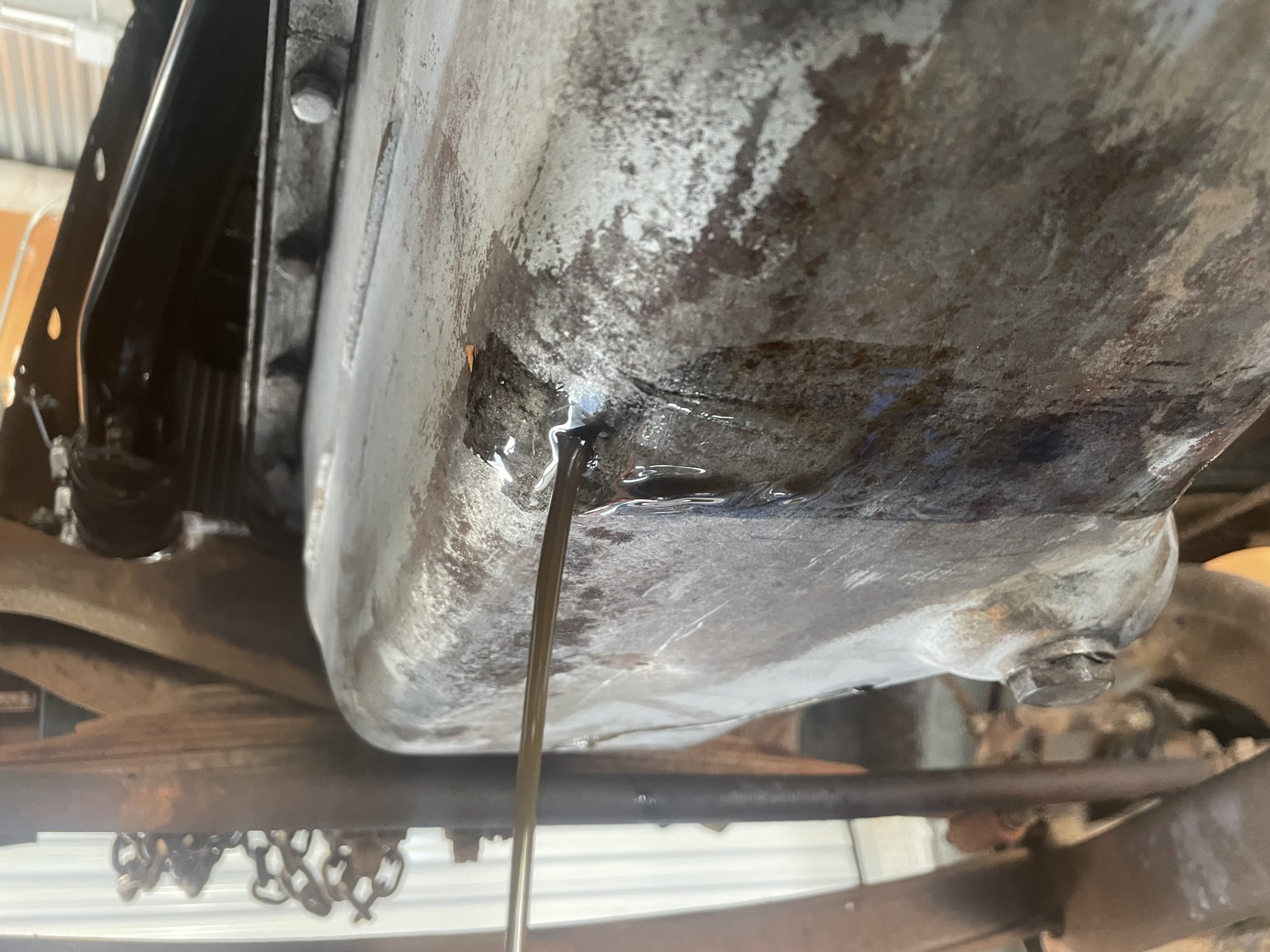

    But there's a pinhole in the oil pan. :rolleyes:

    And a hole in the radiator!!!! :mad:
  7. RodStRace
    Joined: Dec 7, 2007
    Posts: 10,915
    RodStRace
    Glad it was a basic, simple fix.
    JB Weld the pan. https://www.youtube.com/results?sp=mAEB&search_query=jb+weld+oil+pan
    Radiator should be properly repaired, if possible. Lower operating temp and low or no pressure, but the loss causes expensive problems.
    As for high compression, that's probably one of the easiest car engines to swap a head on.
    trevorsworth likes this.
  8. trevorsworth
    Joined: Aug 3, 2020
    Posts: 2,109
    trevorsworth
    This one doesn't need to be fast. I'm content with less compression to spare the bearings.
    The radiator is a cheapo aluminum ebay unit that I guess one of my guys accidentally broke either while taking it off or putting it on. No big deal there either. Just small irritations. We know the engine runs good now so it's all just accessory **** from here... but might be a little while before it all gets done.

    pinhole?
    nailhole?
    spikehole!
    How hard is it to pull in the ch***is? I've welded up pans on the engine. If possible, I'd pull them unless it's almost as much work as pulling the engine.
    Say a s10 v6 4x4:mad:
  12. trevorsworth
    Joined: Aug 3, 2020
    Posts: 2,109
    trevorsworth
    Honestly it's easier to do it in frame than to pull it lol. I think that's a rub hole from being moved around on the pan. I'm just trying to figure out if I need to split the engine off the transmission again to fix whatever's wrong with the clutch, unless nothing is wrong and it's supposed to have a feather light clutch, but that doesn't seem right.

    You can pull the pan in the truck and work on the clutch via the inspection cover inside the truck cab.
