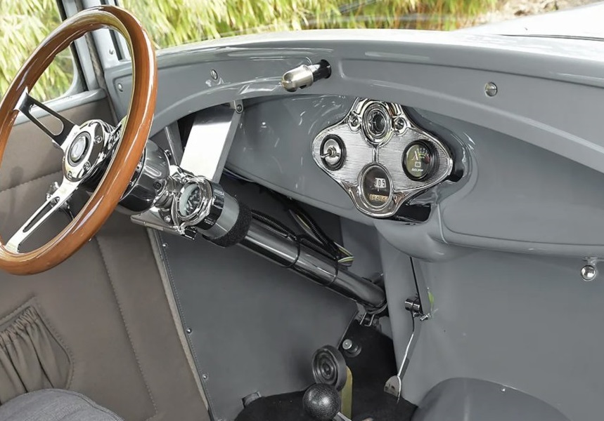

  1. First thing I might do is to swap out what was used for gauges.
    Brand must include 2 1/16 gauges, and I have six spots to fill.
    1. Oil Pressure
    2. Water Temperature
    3. Tach
    4. Vacuum
    5. Voltage
    6. Clock
    Does anyone have any recommendations on what brand to look at?

    so you have a plan for mounting more gauges? is it more traditional looking than this?
    or what?
  3. Plan on relocating the toggle switch that is used for dome light where the original ignition switch would have been and putting a gauge in there and then I have one of these that will add another two gauges.

    Since there's no need for a vacuum gauge, volt meter, or clock, it might look cleaner without them?
  5. Good point, but I might at least need to get rid of that toggle switch and replace it with a gauge.
    This is where the ignition switch is currently along with a pull for headlights and a toggle for the electrical fan on the radiator. (Fan will need to be changed to come on when a pre-determined temperature is reached)

    if it were my car, I'd probably put an oil pressure gauge and temp gauge in the main cluster, and make one of those lights near the ignition switch an idiot light for the charging system. I'd also do whatever it takes to get rid of the electric fan.

    With the cowl tank there is very little room behind the gauge bezel. The original gauges were not very deep, front to back.
    If you use the two hole gauge hanger, that is less an issue.
  13. Sorry but it still seems I would have to cut out the current panel to put gauges in those locations that the aristocrat has?
    Or does the whole panel from left to right get replaced?

    It bolts into the same holes as your other stock guage panel. I've never run one personally so besides the lead on a cut free idea, I am not going to be of much help. I believe the angle of the bezel allows for the additional guages

    The Aristocrat bezel installs over the original bezel.
    Unfortunately, it appears the reproduction Aristocrat is not longer available, and old originals have become pretty pricey.

    I myself don't like Aristocrat covers. They look too JC Whitney to me. I'm sure you can come up with some other arrangement that will look good.

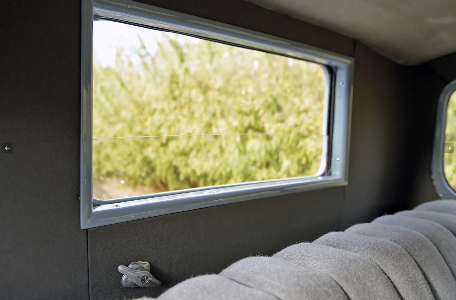

  24. Here is a picture for today, guess window goes done so you can communicate with some one in the rumble seat. Do non-rumble seat cars have this option?

  29. Plus get an different looking headlight knob and mount the switch in the column drop. Ignition switch (on/off), starter push ****on on stock dash also (switch where the toggle is now) and water temp gauge. Then make a small nice looking panel for the jeweled warning lights under the dash lip (oil, charge and high beam).
