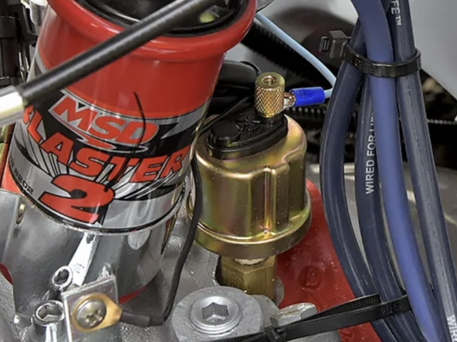

  10. Is this an oil pressure sending unit, not seen a part like this before?

  12. 05snopro440
    Joined: Mar 15, 2011
    Posts: 3,495
    05snopro440
    Looks like it. The knurled thumb screw is interesting.

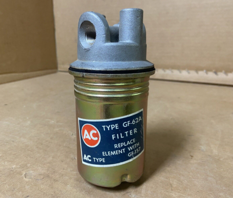

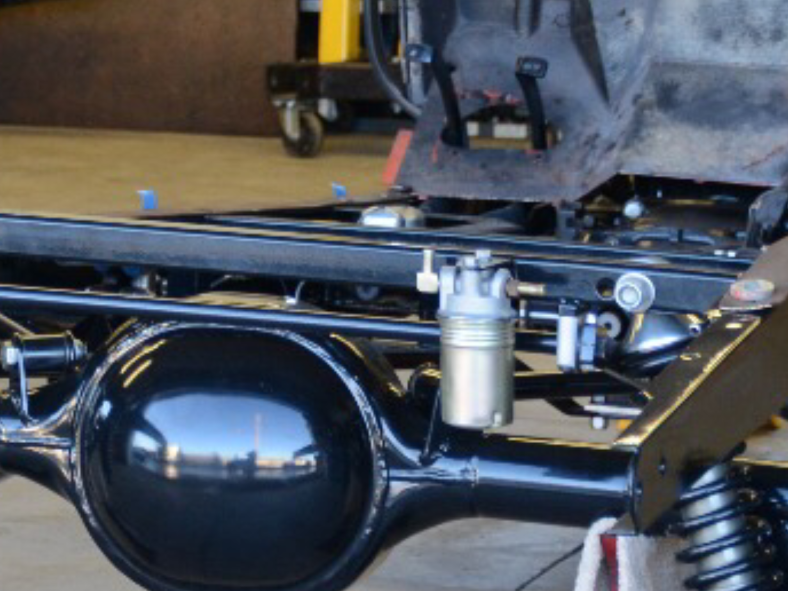

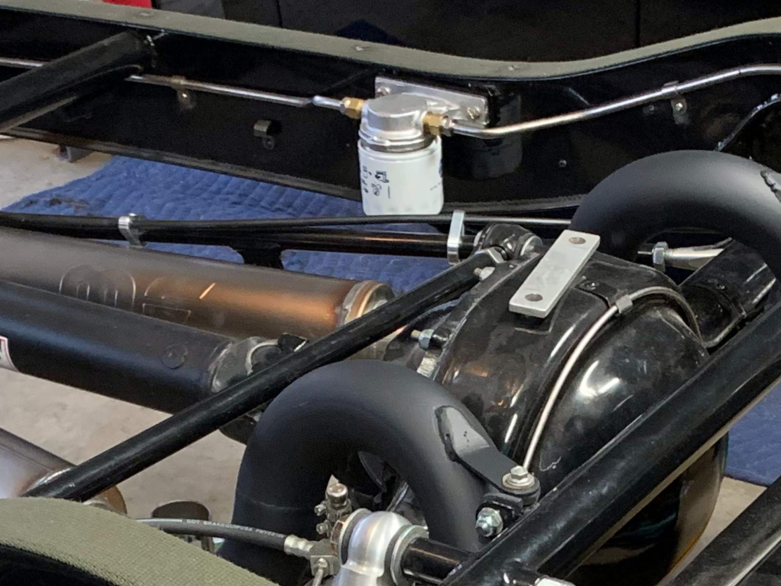

    If you ever move the tank rearward and then run the fuel line down the frame, I would highly recommend using a canister fuel filter as close to the tank as you can. I always use a delco (or delco style one like SoCal sells). Here’s some pics of the styles I’ve used.
