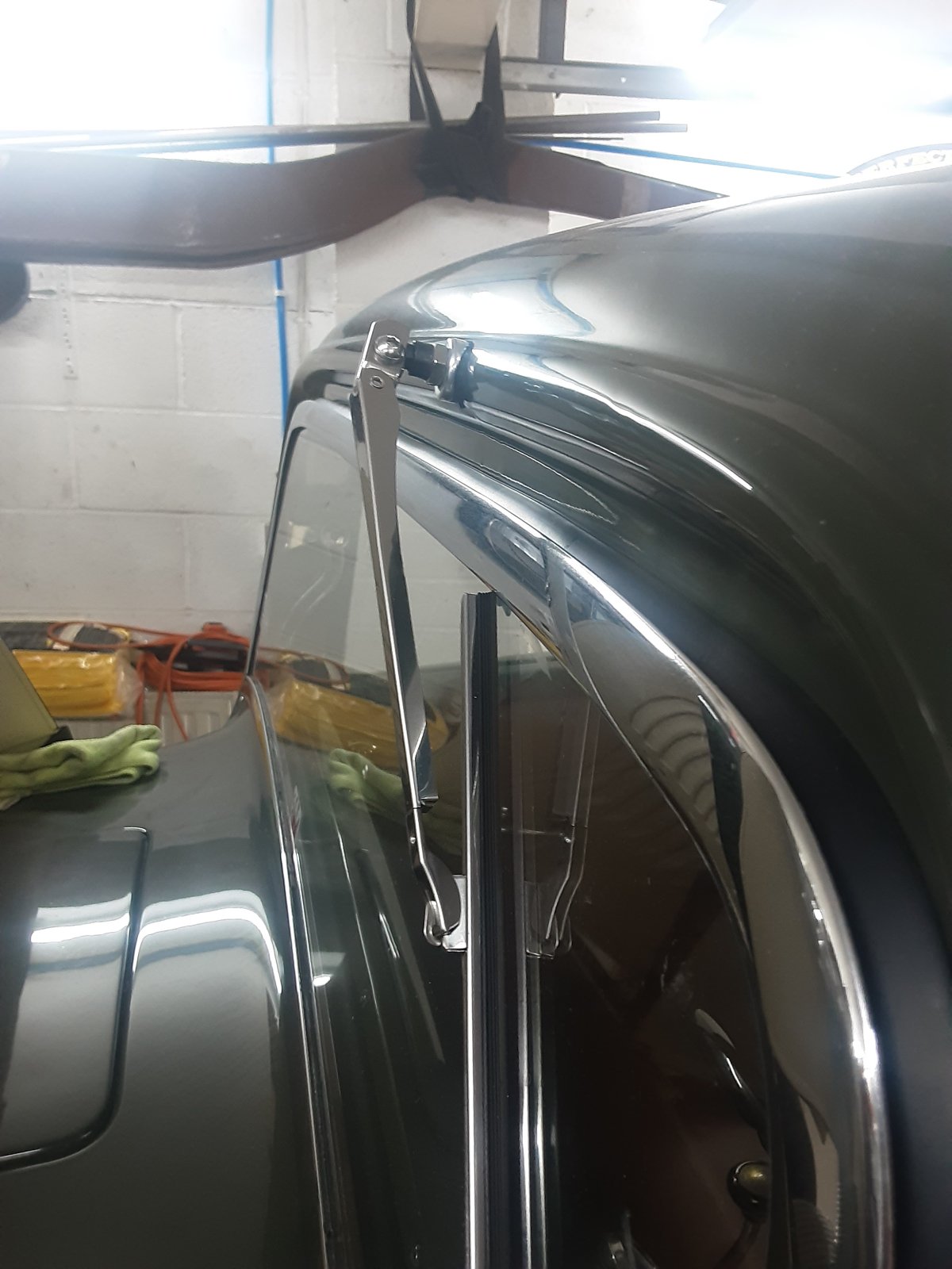

    Mines a 32 and I'm not sure of the detail of the upper screen area behind the visor on an A, but hope this helps.
    X38, Just Gary and RodStRace like this.

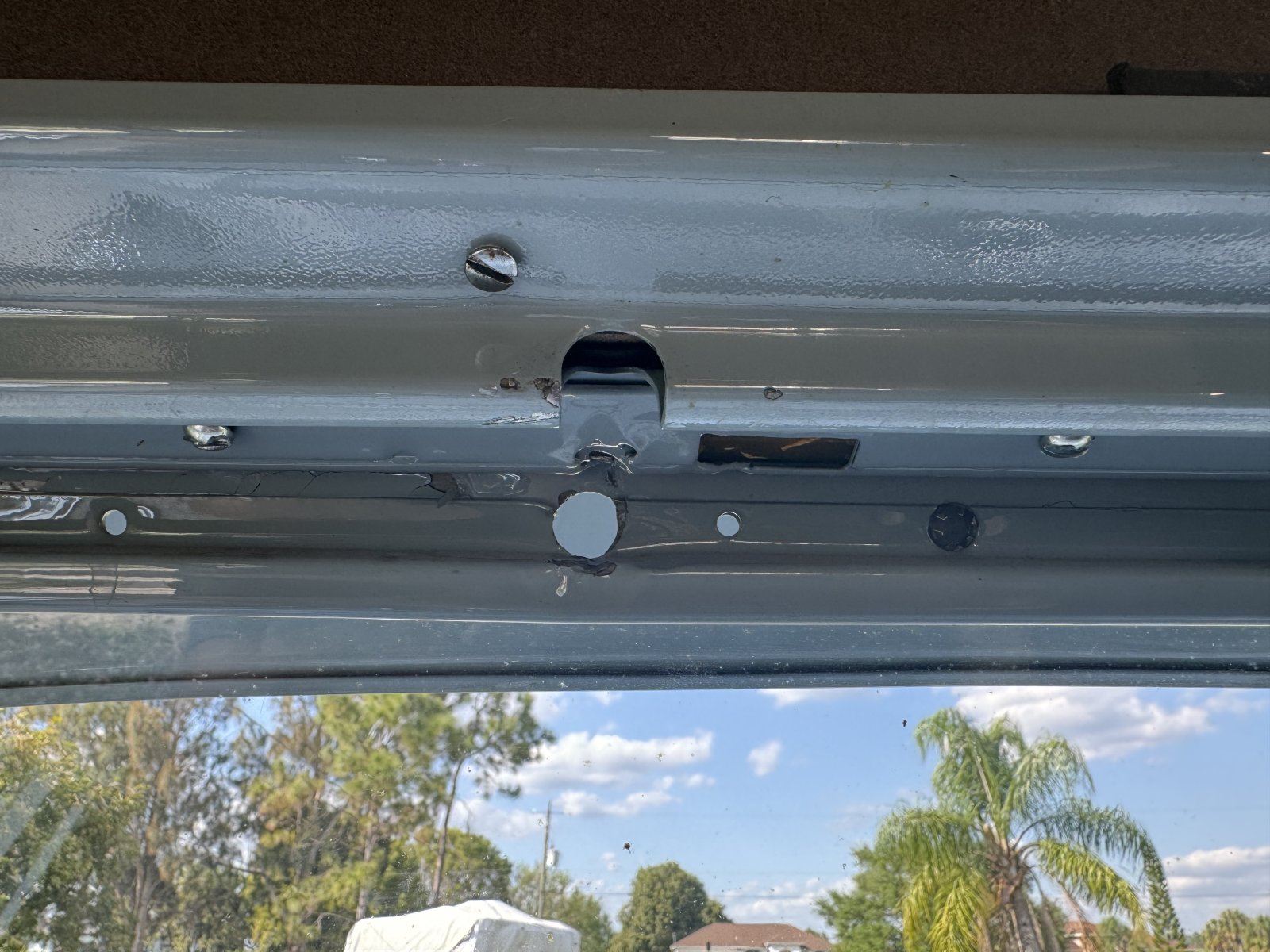

  3. Thanks, I see on yours it works but my shaft thru hole is in the windshield frame.

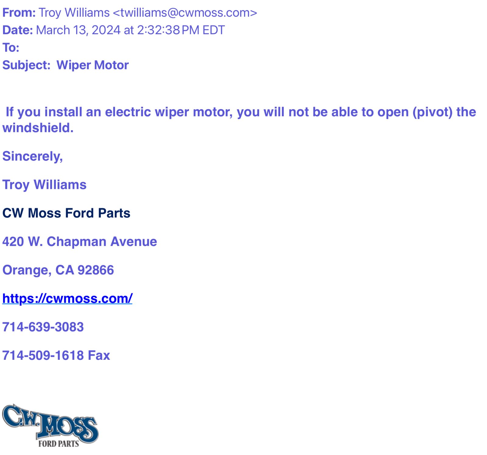

    I also just got the following from the vendor, and not opening the window for the airflow is not an option in SWFL.

    The Mighty Wiper has already been mentioned by @X38. The housing on those is very small in comparison with the one you have and could possibly be mounted to the screen frame. But it sounds like you really need AC, and Dynamat.

    On my Model A the wiper motor hole was in the header, above the windshield frame.
    Note, that was a slant window Victoria, which was designed without a visor.

    Whoever told you that from CW Moss is uninformed. That's bad info.
    A 2 B likes this.
  8. Not bad information. It is common sense that if a motor is mounted inside the car to a surface that does not rotate, and the shaft of the motor goes thru a windshield frame that rotates out that the shaft would snap off if the windshield were to rotate out to get some air flow thru the car.

    The universal wiper motor that you showed, mounts above the swing out windshield frame, in the windshield header.
    The wiper blade arm has a spring that allows the windshield to open.

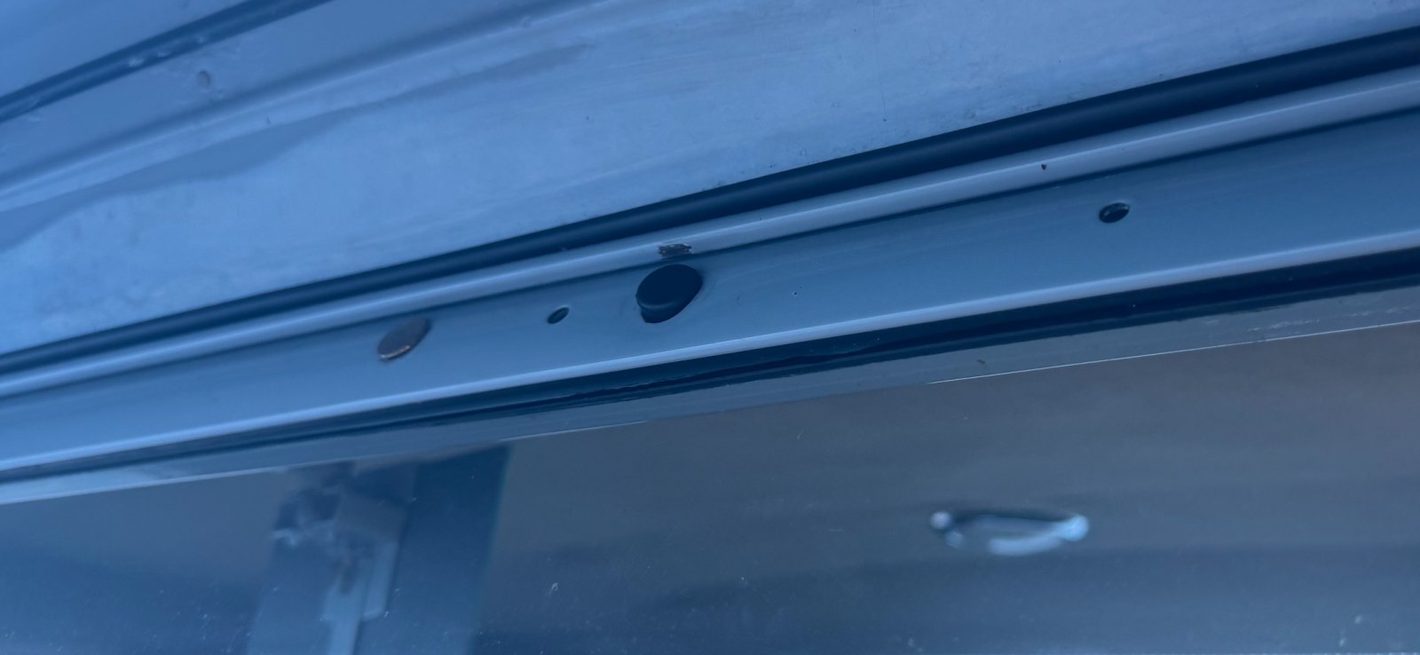

    Are the holes in the header what someone did to modify it in the past 93 years?

  14. Yes, that is the point I was trying to tell everyone, but my car has the shaft going through the frame of the tilt out window and why the one I bought couldn’t be used.

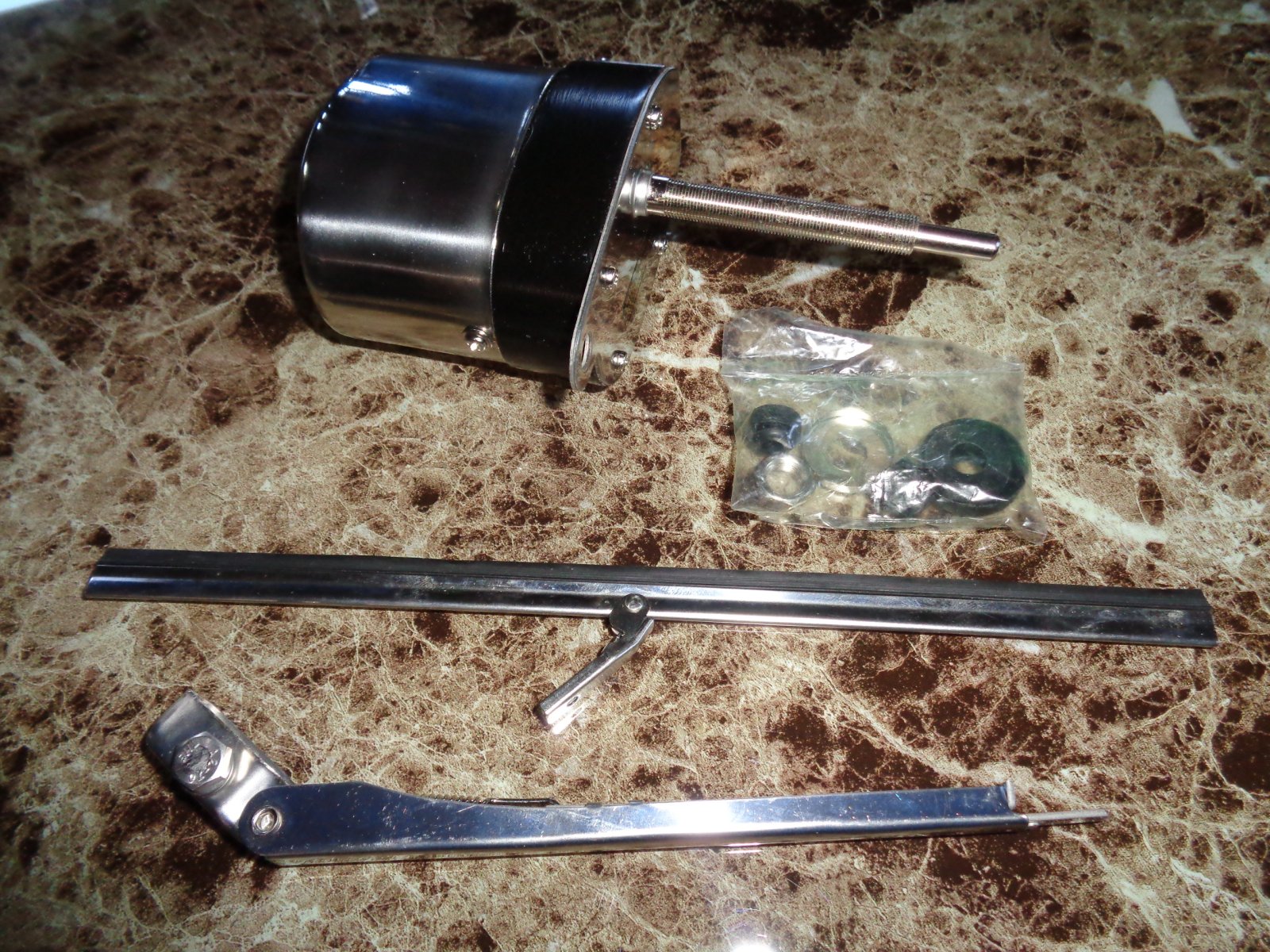

    Mine is apart for paint now but the wiper worked fine and the gl*** tilted out nicely. The wiper arm just articulates and the wiper blade stays planted on the windshield. There is not that much movement on the hinge side of the windshield.
    I bought a set of two of the stainless steel bodied 12V wipers that have shafts which you custom cut to the size you need. They come with all the hardware and rubber seals needed. It has been a while but I believe they are genuine chinesium from Ebay. I also use Rain-X but the wipers were a legal requirement. I took a pic of the wiper I haven't used yet.
    Edit: I forgot to mention that the shaft does go through the hole in the windshield frame but the wiper body is mounted to the metal trim which is in turn mounted under the wood header.
