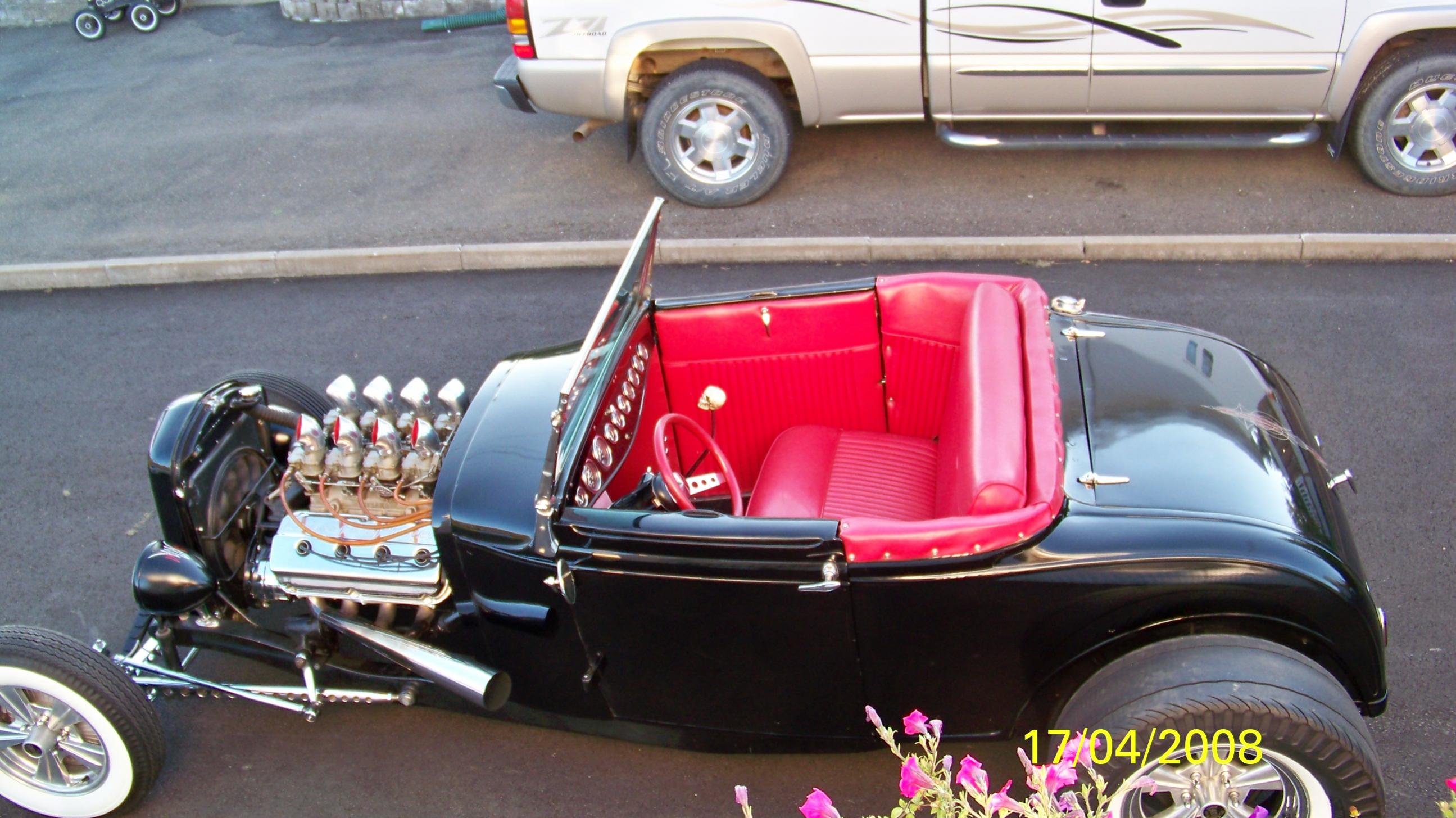

    your car is coming along great,when i got this car i tought it was built from a coupe, but later figured out why it looked so right, it is built from a sport coupe 30, here is a few photo's

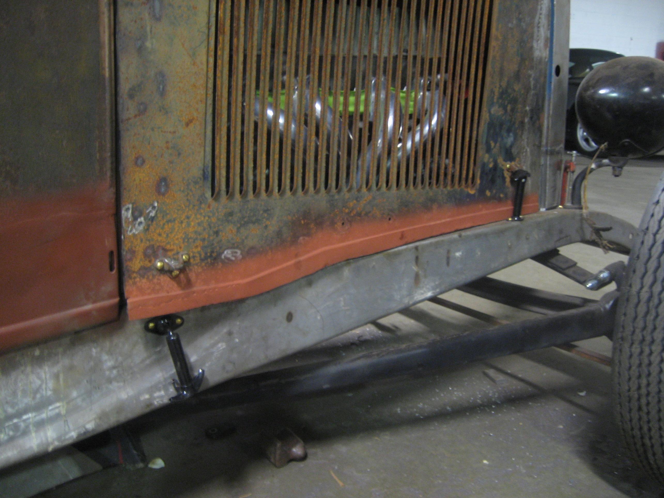

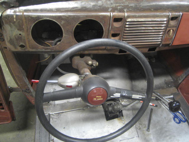

    Time for an update. I have finished the floors and firewall, steering and suspension is installed. Steering column has been shortened and body is almost ready to come off frame to finish out ch***is.
    Floors were hammered out by hand and shaped to the contour of the firewall. Still have to bead roll the floor pan under the seat to prevent oil canning. The firewall did not have to be cut. Mechanical fan is 1 inch away from surface of radiator cooling fins, so should be good without a shroud.
