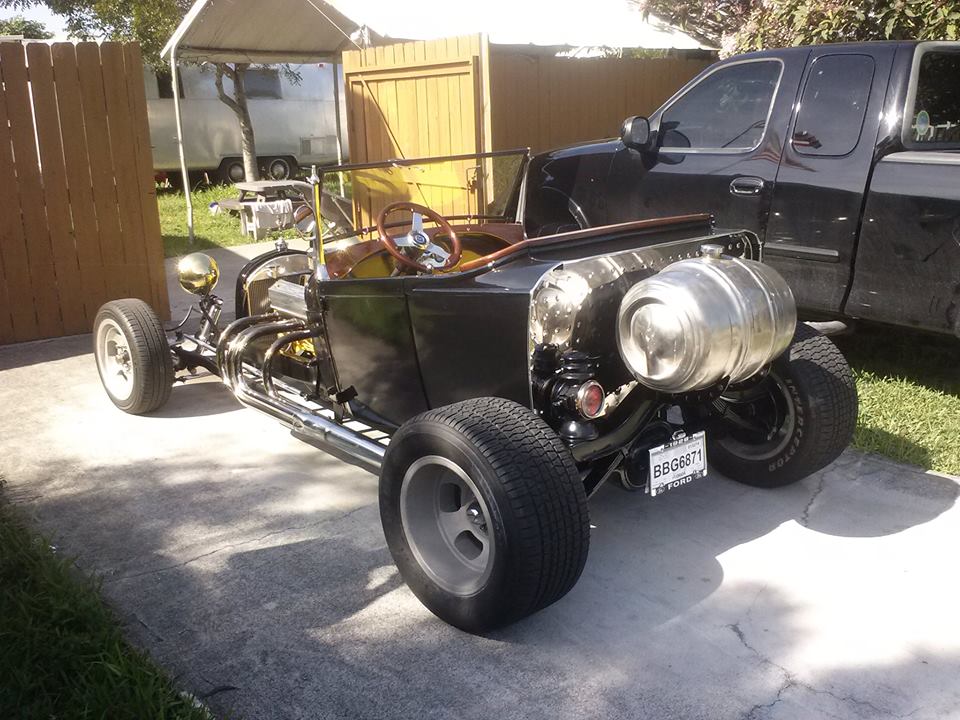

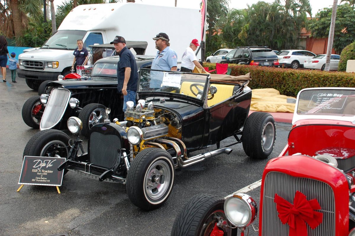

    I bobtailed my 1928A,it was crashed in rear,an as a teenager I just off the bad an built the good part. Intake is cut up driveshaft to make 4x2s. My updates over the years are adding yellow to inside,making chrome headers,an went to Alt. Also had to replace the steering colomn n wheel.

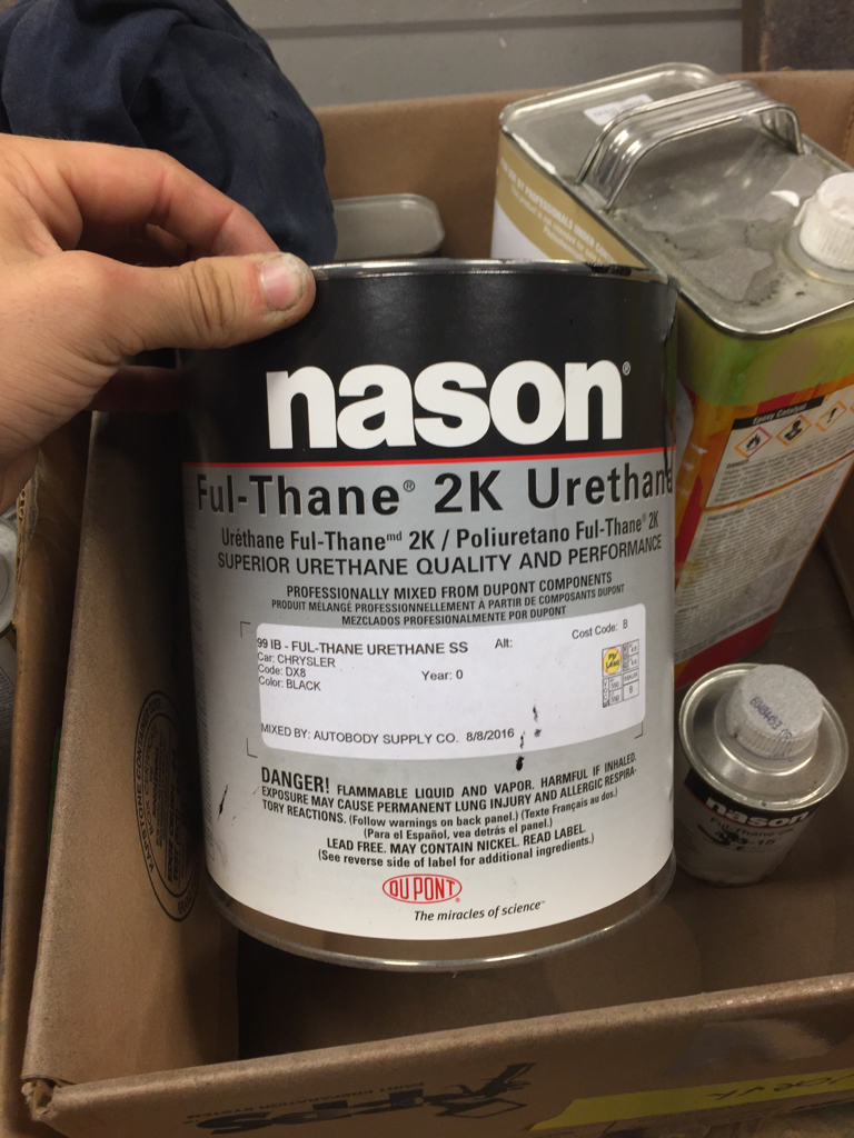

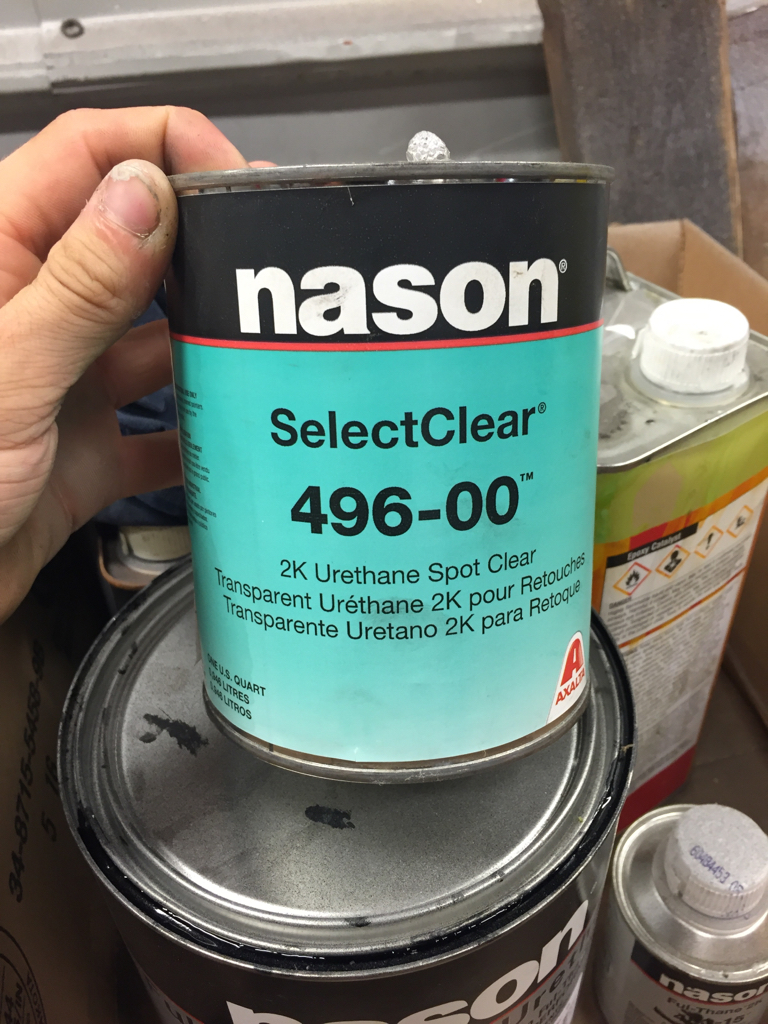

  2. Wait sorry that's what I used for something else on the car, I got them mixed up haha. For the rear end I used DuPont Chroma Base and then clear

  4. Woahhh, that's awesome!! Bummer to hear about it getting rear ended. Intake sounds very interesting, any pictures of it? No big deal if you don't. Very cool car!

    I did thread on my last restore some time ago,an it has some 4x2 intake stuff in it. About the bottom of page you can see a video of how they run. ; http://www.jalopyjournal.com/forum/...y-hotrod-28a-from-1959-rebuild.793393/page-15

  8. Very cool Dana, love the story. Thanks for sharing!! That picture of the roadster in '59 is too cool. Also I really like your sons Model T!! Your roadster seems to run pretty strong! Haha
