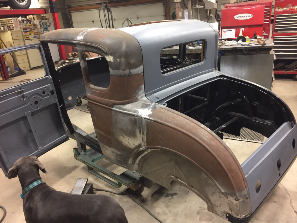

  11. Drivers side quarter panel is done. Man that was a lot of work! A total of 3 quarter panels and 3 patch panels to make one solid quarter panel. Glad that's over!
    Used the back half of this quarter panel
    Patching it up
    Had to pie cut in the middle of the new corner patch and add to it and reshape the bead cause it was too small (of course)
    The original quarter panel, the back half was really beat up and for some reason had a bunch of cuts in it?
    Time to start bringing these two pieces together
    All fitted and tacked in place
    Time to fix the chop. The previous owner didn't do a very good job at chopping it, atleast to our standards anyway. So we re did the chop with a better top piece .
    And for some reason someone cut this piece like this? Not sure why anyone would need to cut it like that, so we had to fix that too.
    Quarter panel is done! Now it's time to sandblast and seal it. That was a lot of cutting, welding, and test fitting. This car will now be known as "Frankenstein" haha

  27. Driver side quarter panel is on and wood kit is installed. Few little things to do before re shooting the whole body.
