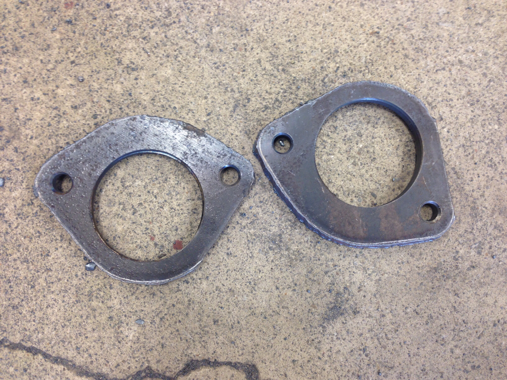

  4. Rear wishbone welded together with a gusset I made.
  5. Brackets I made to mount the rear wishbone and rear end together

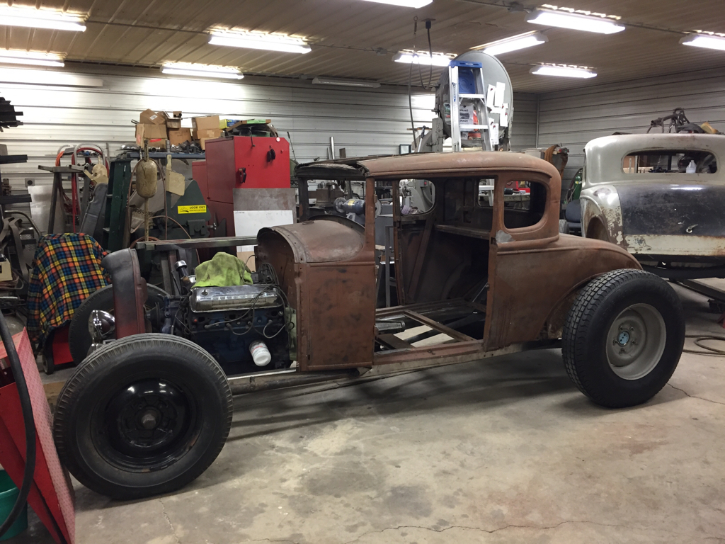

  22. Body on for the first time to see how everything fits. Not too happy with how it sits, going to raise the rear end and lower the front end. Rear spring isn't attached to the crossmember yet so we're going to play with the ride height. The '32 front axle is still undropped at this point.
