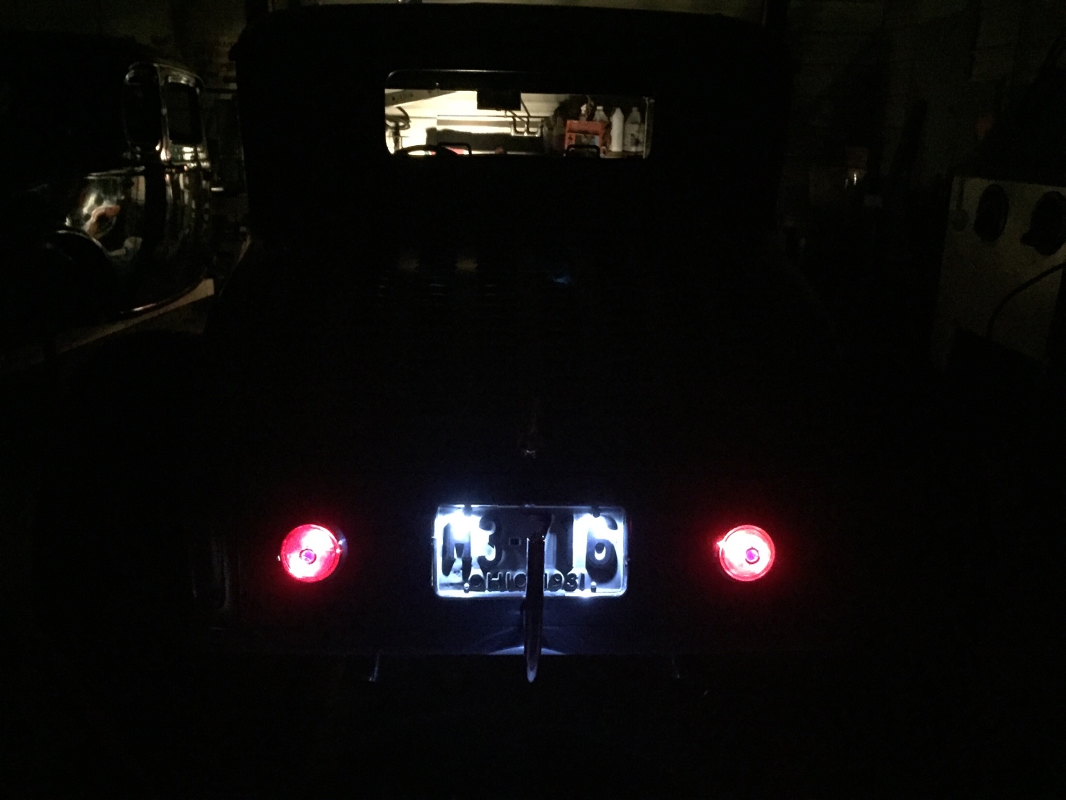

  2. Quick update on my coupe. It's almost road worthy, me and my dad are currently fighting an oil leak we can't seem to get to stop. The rear main seal is leaking badly, bad enough to where I can't drive it down the drive way without losing a quart of oil! We've replaced the rear main seal twice and the previous owner of this engine had replaced it in the past as well and still leaked for him. That's the only thing stopping me driving this thing! Anyone have a suggestion?? Thank you again for all of your kind words on my first build, I can't explain how happy I am to finally have my first hot rod almost done! (Well for now, they're never really done) Also very fortunate to have had my dad teach me everything I know about traditional hot rods and helping me build my dream car and my grandfather teaching me how to wire a car and helping me.
    On the bright side, all the electrical issues are figured out and the car starts right up and idles. It's running great and sounds great! So things could be a lot worse, it could not even be starting at all! It wants to be on the road but this oil leak has us stumped! So if anyone has any suggestions how to get the rear main seal in a 1955 272 Y Block Ford to quit leaking please let me know!!
    Here's some photos of all of the lights working.
